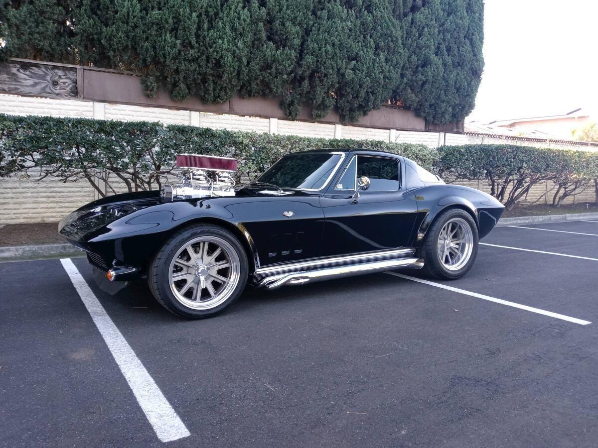

here it is but its a c2

Wow! That's a beautiful car! Make my C3 look like the ugly sister.

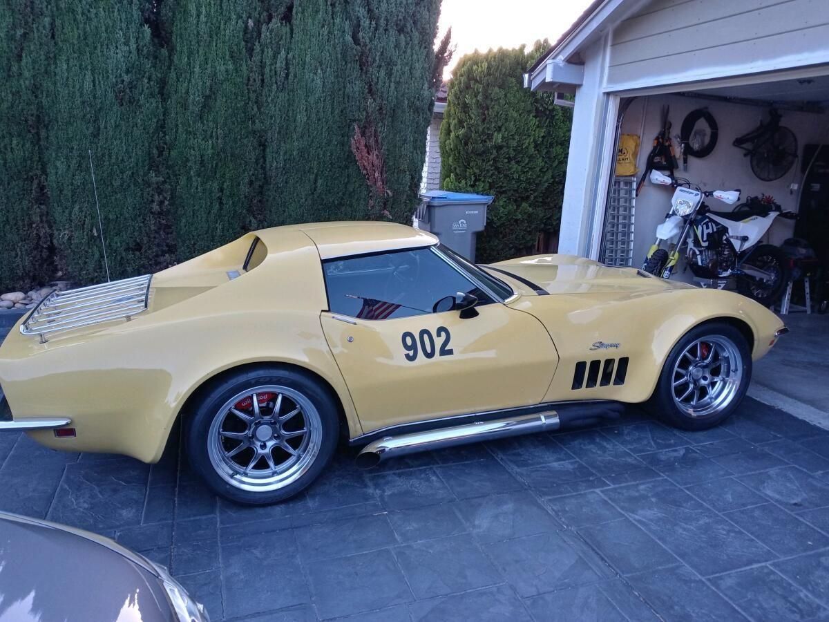

I do love my 69 mostly just autocross it though .
Wow. You are blessed my friend.
Both badass. I do like the 69 a little better.

Like them both. The C2 though...the restomod is in really good taste, some restomods go too far, that one is just right. How's the interior? If you get tired of it, let me know.

The c2 is everything brand new vansteele coil overs tko 600 ididit tilt wheel borgeson box vintage air all new in and out .
