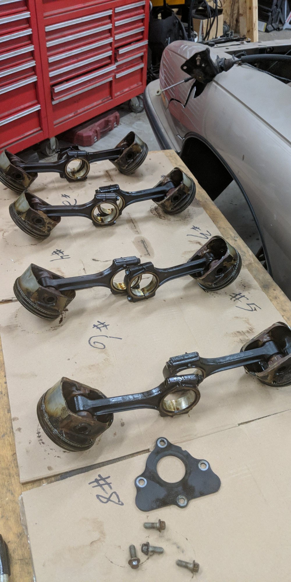

Got all the rods and pistons out. Bagged and labeled a lot of bolts. I can't get the rear cover off because I don't have my engine hoist. I need to get it back from my cousin. I am ready to pull main caps and the crank once I get the rear cover off.

Pwnage, you have any more pictures of the pistons? Looks like that motor has some miles on it.

I can take more pictures of them. They do look pretty worn

Curious if you have looked into LS2 pistons with the LS3 valve reliefs.
Any chance you have a product link? I looked online but didn't come up with anything

The only pistons I found are from Mahle PT# L92314030F04 and 4.030 bore/3.622 stroke, but they are pricey. If I purchased those beauties I will also get a set of the fancy H-beam rods also. Of course it would be a near bullet proof bottom end motor at that point, ready for some boost.
https://www.texas-speed.com/p-1140-m...ength-4cc.aspx
You could also just buy the standard bore LS3 pistons 4.065 bore and get 376 cid, LS3 pistons are going to be half the price of those forged Mahle.
Typically you can find the Ls2/LQ9 pistons half price of the LS3 pistons, but then you would have to machine in valve reliefs which would weaken the piston some.
