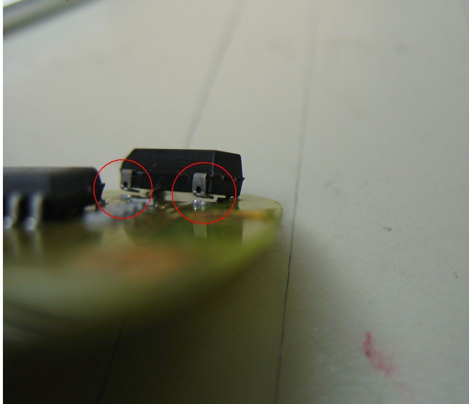

Here are a couple of pictures of the open solder joints I found on my FOB.
I just had the exact same issue with my key fob. This forum is awesome.

EXCELLENT PICTURES!!!!!!!!!!!!
