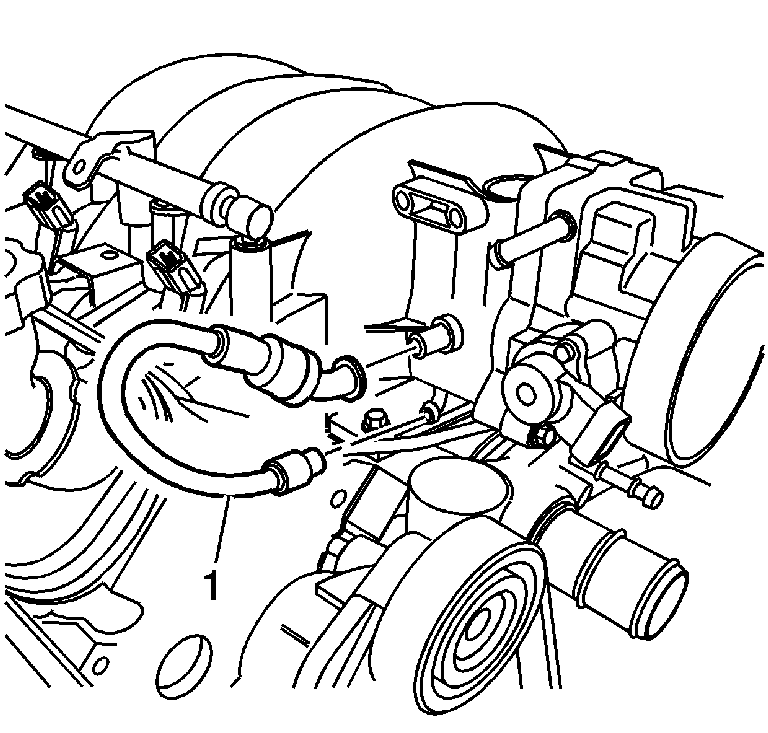

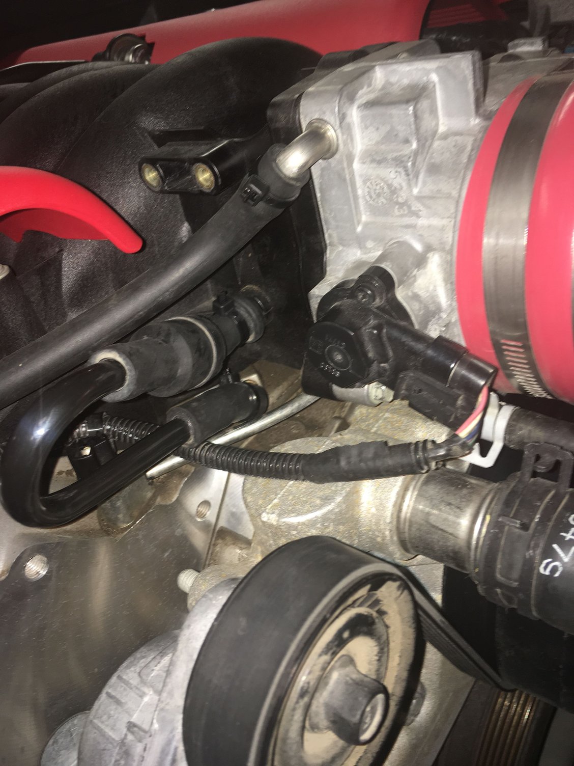

Alright so it's been a few months, and I still have this problem lol. So, I have checked all the vacuum lines to my knowledge, they all seems good except for one. From my understanding it is the PCV valve that goes from the front of the intake manifold to somewhere. But it was loose and could have been leaking from here. I zip tied it down, but I am not sure if I put it back on the correct way, I may have reverse it... also from looking online it seems it could be possible that it's bad and/or should I install a oil catch there as well? Also I couldn't really find anything with the specific one that I have.
Old Aug 1, 2017 | 09:27 PM
vettenuts's Avatar
vettenuts
Joined: Mar 1999
Posts: 22,025
Likes: 192
From: At the beach in little Rhody
Lower hose is going from valley cover (where air is metered under the cover) to the intake manifold. Other hose is the filtered air intake to the PCV system, i.e., its the clean air feeding the PCV.
Alright thanks for the info. I did some googling and found a picture that shows that it is indeed connected the right way. Before it was swapped around. Hopefully everything will work now, I hope to get it off jack stands this weekend and take it for a drive.
