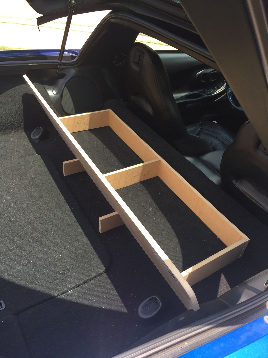

I ordered 48sqft of 50mil butyl/aluminum sheeting.
I am currently building a 1/2 height divider, 12" high, it is level with the top of the tub with the hatch open, Im incorporating a cargo/storage unit into the divider.
Depending how that goes, I will order some neoprene.

Started building the divider, just gotta wait on the carpet to be delivered..
The roof panel still fits back there fine..

Pics look good. I've thought of making my own, too. Interesting design with the angled back. Is this a drop in design, or are you securing it somehow?
What are you doing for finish? Carpet? Matching to factory? Other?
I decided on the laid back angle to match the angle of the backing behind the seats.
I have no plans to secure it, it is removable, it is shape fitted to the wheel wells so it cant really go anywhere side to side, and once its carpeted (im using black subwoofer carpet) it will be a fairly tight fit.
I added the two small pieces at the back to stop it from potentially flipping backwards.
I have driven with it in the car as is, and even though I dont drive on the limit, I am known to not slow down for corners. and it didnt move at all.
My motivation behind building this was purely costs. while Im not poor, I like making my own stuff when I can save.
I was thinking about buying a divider that I had seen, and a cargo organizer, but together they were almost $250.
My unit once completed will be approx $40 and will be one unit rather than two separate pieces.
1/2" MDF 4' x 2' $10
8' x 4' Black speaker carpet $17.99
Spray Adhesive $9.99
Plus a few screws and wood glue I had in my garage..
