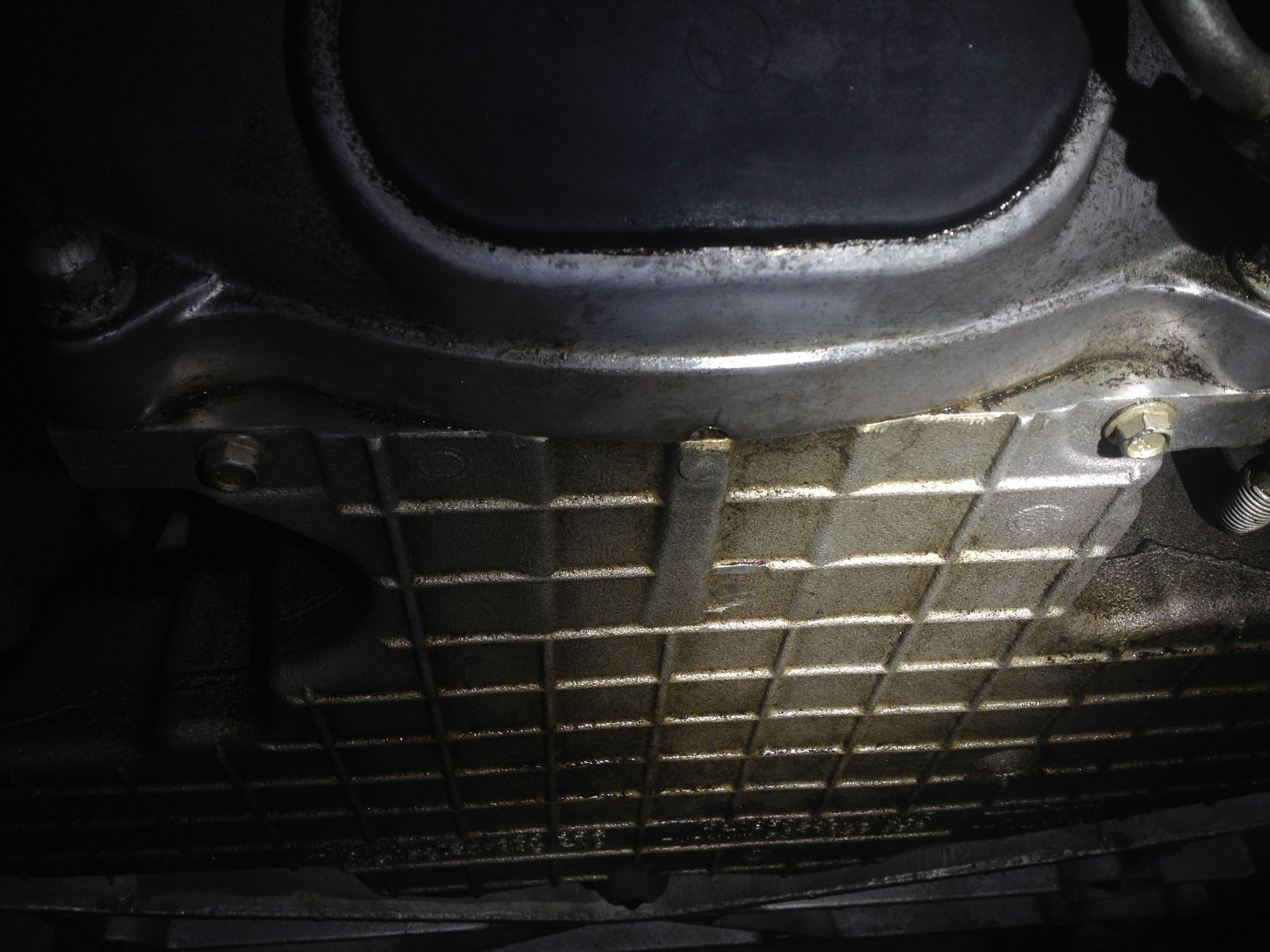

While i was changing my oil on my 99 vert i thought i would check and tighten the oil pan bolts and i found a couple and this one in particular was finger loose and when i started to tighten it it felt as if it either broke or stripped.
(it is the small bolt on the right side in the pic.)
am i screwed? it did not fall out, i instantly stopped turning and it just stayed in place. how long is the bolt? is it treaded into the block?
i've searched online for some info on it but came up a big nothing.
i have used the car since and all seems fine so far, but my foot is alot lighter now. does it need to be fixed pronto?
thanks

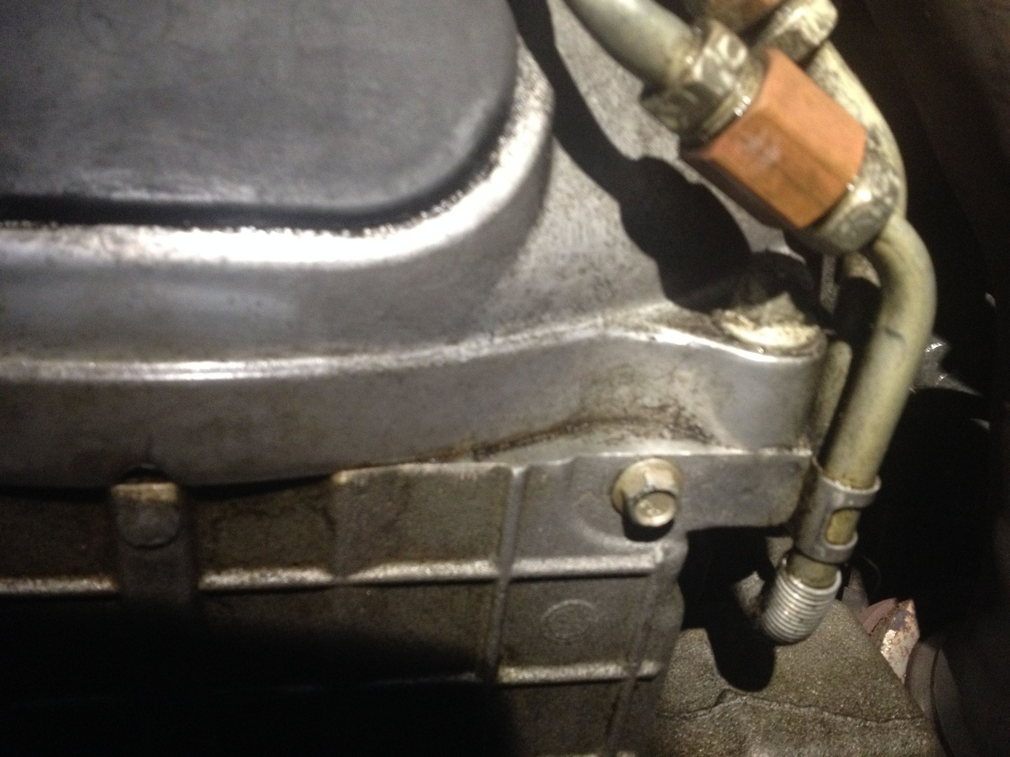

Appears you are not alone.
Rear Oil Pan Bolts_1
Rear Oil Pan Bolts_2

That is a VERY LONG fastener and YES, you are NOT going to be happy!
Only way to fix it is to remove the pan, helicoil the damaged hole. If it were me, I would helicoil BOTH cause they strip out easily.

I plan on taking it to mount st helens this weekend and am hoping it stays in place and not just fall out and leak oil while driving. That would be a bummer. Im thinking if it hasn't leaked in the 20 miles iv'e put on it i may be in the clear for the road trip which is about 240 miles round trip. (Fingers crossed.)
Now i know what i'll be doing this off season.
I think i will put some sealant around the bolt head just to keep it from
falling out (just a temporary fix) until winter. Is that a wise idea?
I'm curious, what is the worst that could happen if it fell out?
I would hate to be so far from home if all hell broke loose.

If you are only concern about it falling out you could tape it up with some foil tape. Whether its a good idea to drive it that way I don't know.

There are probably numerous cars with loose or stripped rear bolts.
If it isn't given you issues. don't mess with it!

That has been my thought. If you ever separate the torque tube from the engine, I would very much consider fixing it as I would think moving things around may start a leak.

Thats what im thinking too, i may just apply some sealer around it until the day comes when it can be properly repaired. As long as the tranny doesnt drop or oil pour out im not going to sweat it much. Researching the issue it seams that im not the only one who's encountered this problem. I do appreciate all the feedback here and am applying that knowledge but have a ways to go since this is my first corvette but not the first car iv'e worked on, but it is the most interesting and i'm loving every minute of it.

Not to freak you out but... the trick with fixing that is you need to get the oil pan off. Which means you have to pull the motor or drop the subframe while supporting the motor as the mounts attach to the subframe.

Ive done a complete connecting rod bearing replacement on all 8 cylinders with the engine in the car.
Fixing that can be done without engine removal BUT,, you have to be creative and think WAY WAY ahead.
Once you have the oil pan off, putting a helicoil in that damaged hole is pretty straight forward.

I wonder if there are good (unused) threads beyond that bolt. If the bolt is so loose you are concerned of it falling out, you could remove it, clean out the hole w/brakleen, explore/measure the depth of hole with a stiff wire, & use a longer bolt. If no good threads are in there, replace the bolt with a stud & red loctite. after the loctite hardens, use a polyloc nut & washer.

I'm still up for what Bill Curlee said about leaving good enough alone. But, if you just have to fix it, along with what JBB said. If the hole is drilled further up you can run a tap in there and get a couple of more threads that way. If you have to cut the leads off the tap so you can bottom it out as deep as possible.
