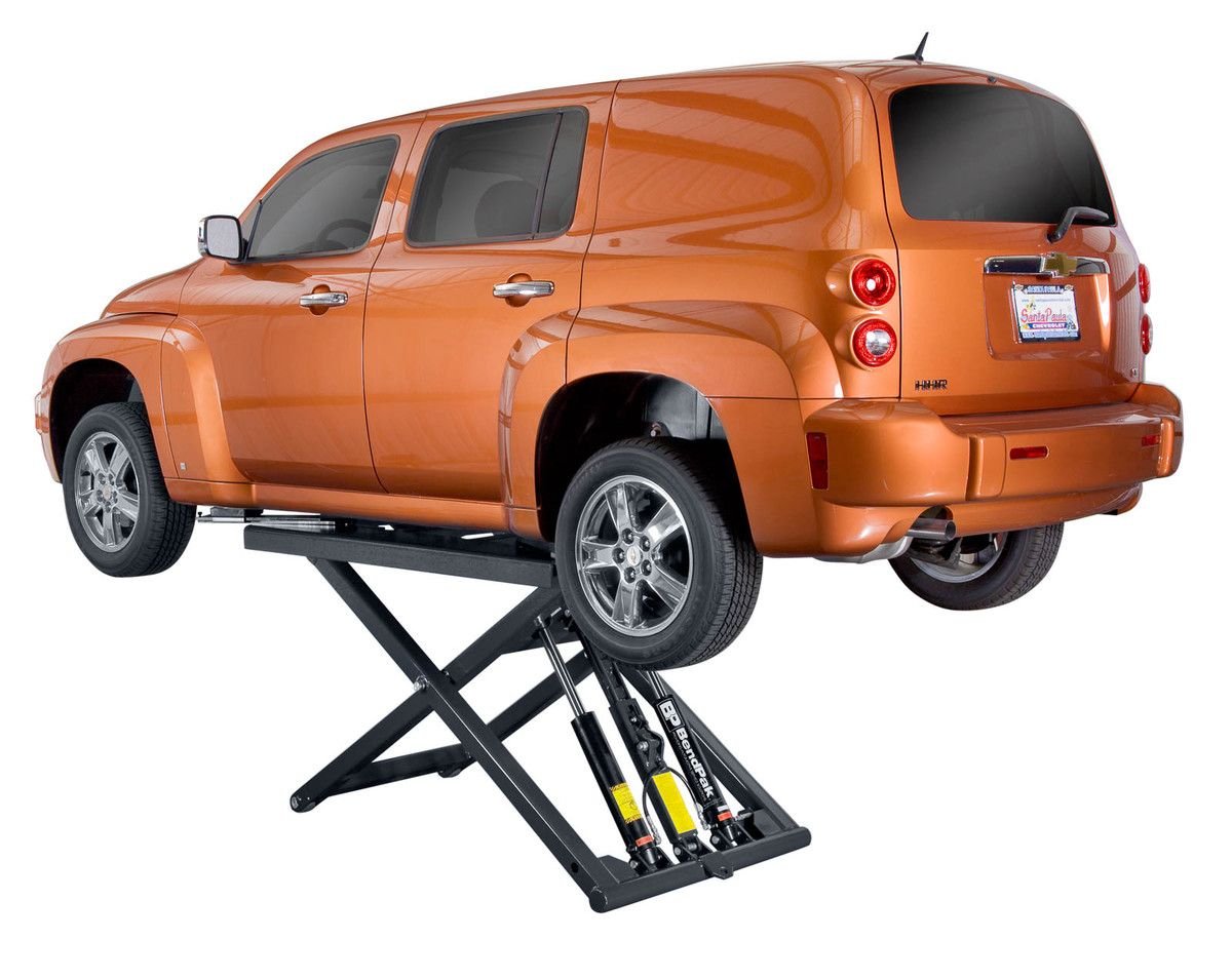

This is something I've looked at too. I currently don't even have a garage but I'm hoping that changes soon. If and when I do have one again a lift will be one of my first acquisitions. My issue with the Quick Jack even though they are compact and really handy they are only low rise with a maximum lift height of 20 to 21.5 inches which means that my stiff achy aging body still has to work on my knees and on the floor.
Attached is a picture of a portable medium rise BendPak 6,000 lb. scissors lift with a lift height of 48 inches that is more practical since you would spend more time on your feet than on your knees or back and be able to sit upright underneath. This scissors lift is also designed so that it has an open throat on one end so there is no obstruction of cross members on one end. Depending on how you position the vehicle you would have unobstructed access from underneath.
The collapsed height of the unit is 4.75 inches and garages with an 8 or 9 foot ceiling would permit many vehicles to be lifted to near the maximum 4 feet, the Corvette for sure even with an 8 foot ceiling.
