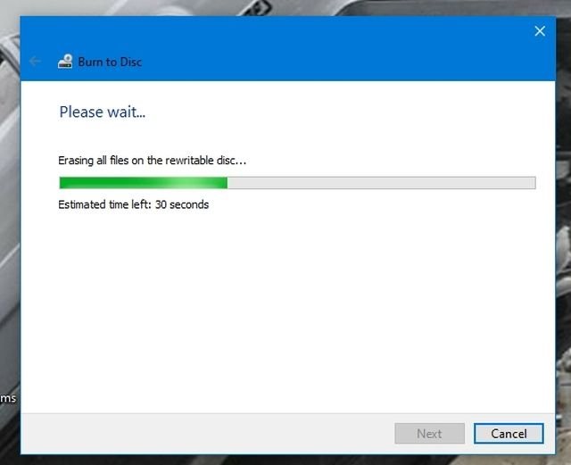

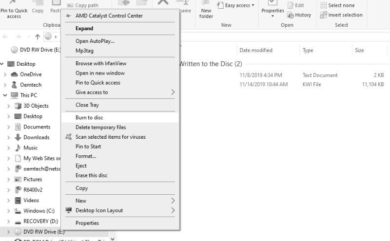

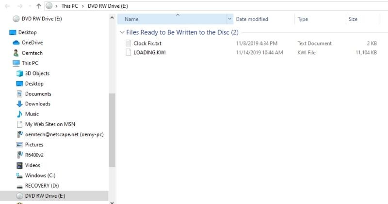

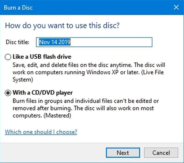

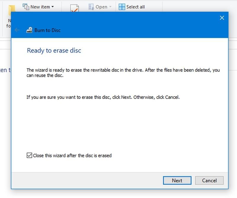

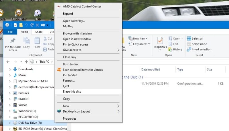

How to
1. Get a CD-RW disk and insert it into the DVD/CD drive.
2. Win 10 may give you this menu.
3. Click NEXT, then select the DVD/CD drive and select Erase Disc
Select Next
Erasing

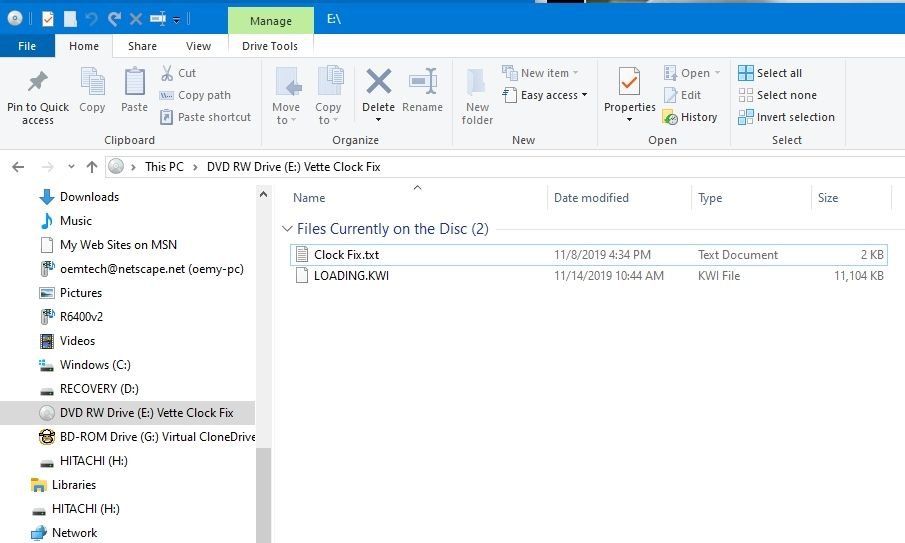

4. Go to the directory that you unzipped the update file to and the file/files you want to burn to the disk. Now drag
them to the DVD/CD drive and drop them there.
Note - I made a copy of the instructions as a Text file.

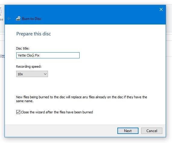

5. Select the DVD/CD and select the Burn to disc
5. Enter a CD label and select NEXT

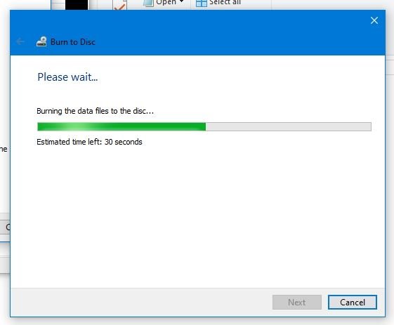

Disc burn screen
6. Your done and now you can go out to the car and do the install.

Do not Format the CD. When you do this it is setting it up for read and write access. Windows is trying to set it up to act as a mounted disk. Say no to formatting and just burn the file direct. If it asks you how you want the disk used, like a USB or a CD. Select CD. Operating systems do a lot of things to make our lives easy, this includes file management. They hide many of the steps we used to have to do manually and make things appear the same. I forgot this while fixing my radio and initially tried using a DVD RW. It did not work. then I remembered that DVDs have a specific format. In the case of the NAV head unit, it interprets a DVD disk as a map disk. It does not look for the file. When you load a CD, it is not looking for a windows formatted drive, it is looking only for a specific file type.
Anyway,
I hope this helps. Burn it to CD with out formatting, close it as one time use (Non USB or read writeable)
