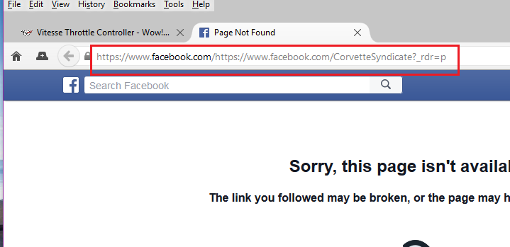

Glad to see you're a vendor now Ahmed. FYI, your Facebook link in your profile is incorrect.

FB page worked for me......

That's because he's fixed it. Oddly enough, your page does the same thing.

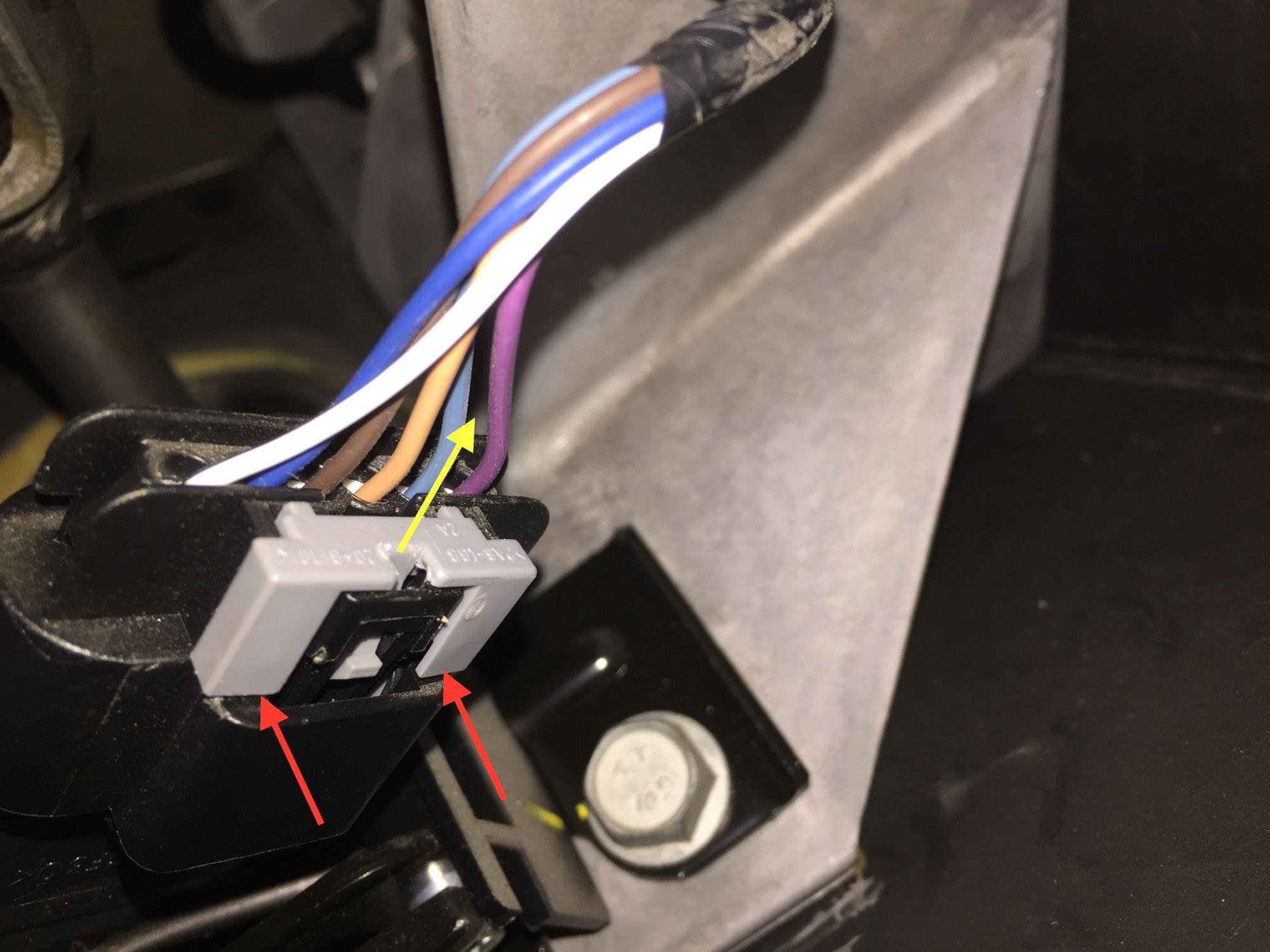

Does anybody know how to remove the gray pin?? I've been at it for about 30 minutes now.

Just pull on it, its just a lock. Pull and push on the connector tab to unlock the plug

On the connector? You just pull it out (Up in the picture). Same direction as the wires run. You can stick a screw driver at the base of it where it meets the black part of the housing to help get it moving.

Tried squeezing on it and pulling on it. No go!!

Small screw drivers where the red arrows are. Moves in the direction the yellow one is going.

Thank you Schpenxel for the very useful photo tip. I was able to remove it.
