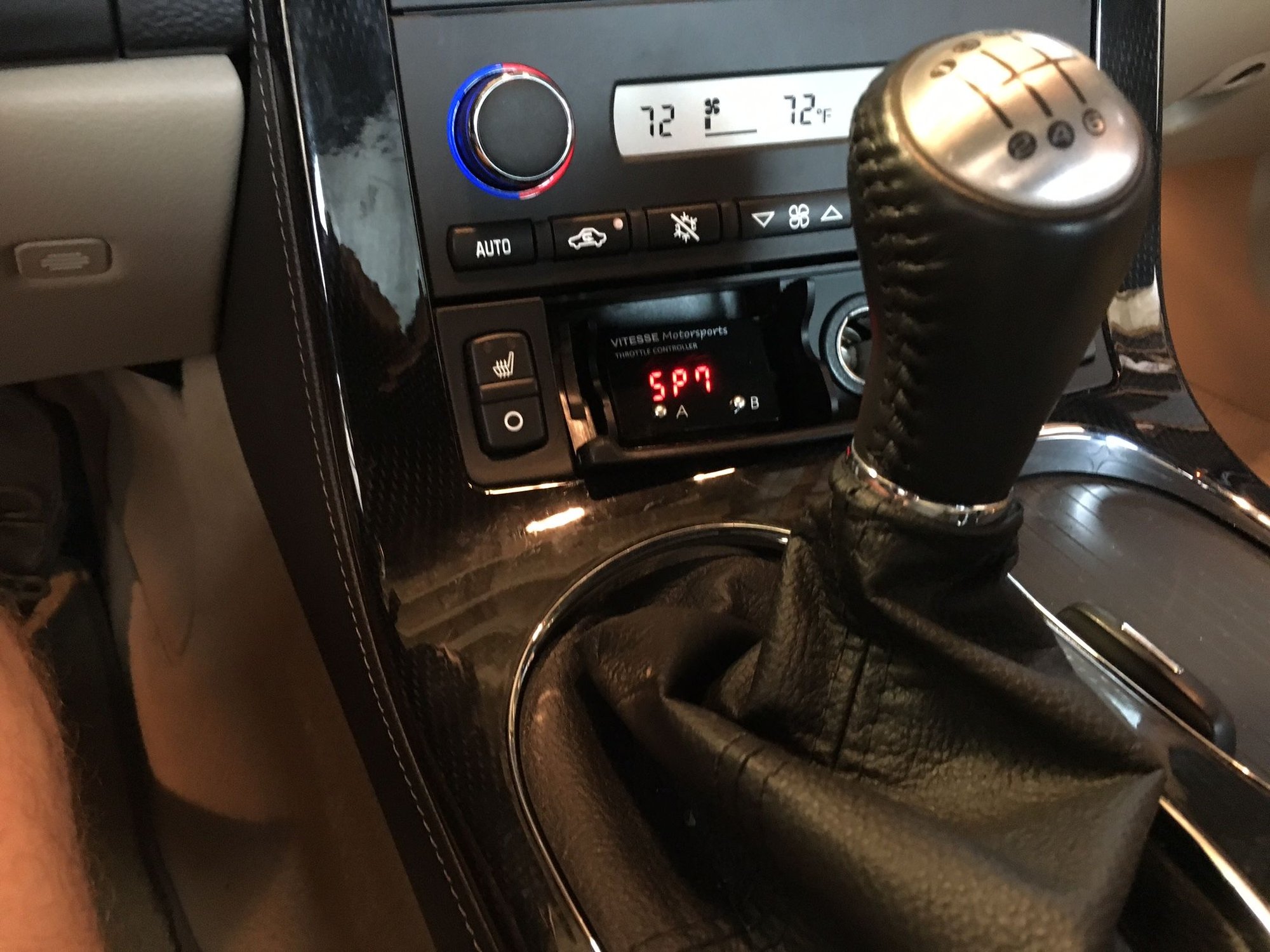

I installed it today and it works as advertised. Definitely worth the price. The best part is when you forget it's there and it surprises you( in a good way). Looks like my magic sleep number is going to be 7.

A big shout out to WasVette. I used your method and love the look and functionality. It is a great approach. Thank you for the PM with helpful tips. My ashtray door does close with the control pad in it but it gets funky lwhen I try to re-open it. I will just leave it open.

Need For Speed - My pleasure! Glad it went smoothly. Make sure you have enough slack on the wire coming out of the controller. That should be the only reason for the door hesitating to open unless something was compromised during the install (spring etc).
Looks great and the picture orientation is actually correct (unlike mine from my previous posts).
