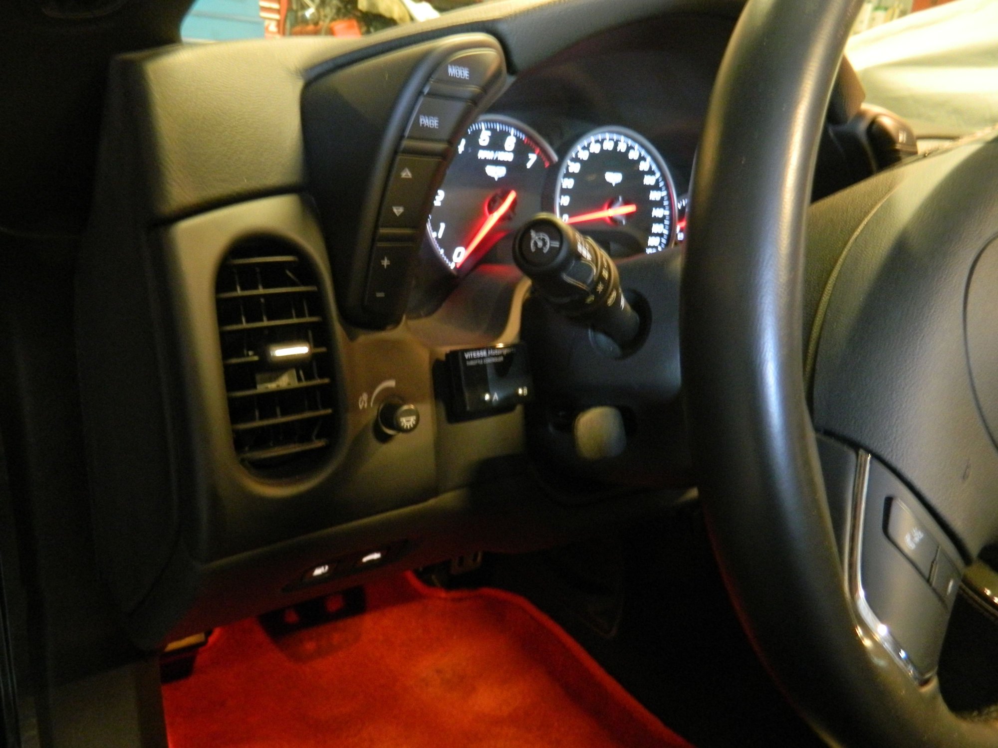

I used Velcro to attach mine to the left of the column, ran the wires behind the knee panel. No visible wiring, and I can see/adjust it while driving.

Both sides though are hidden because of the stearing wheel.

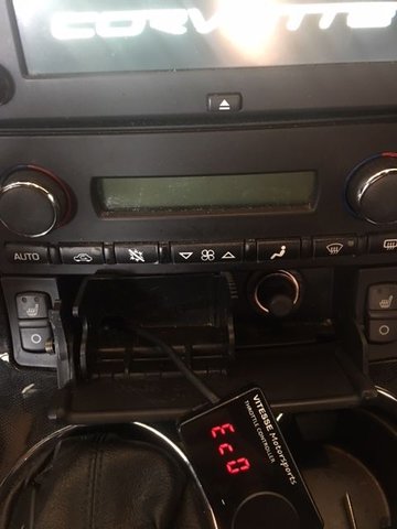

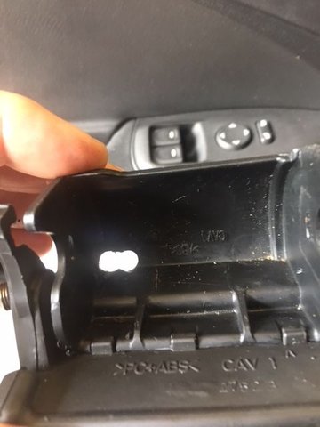

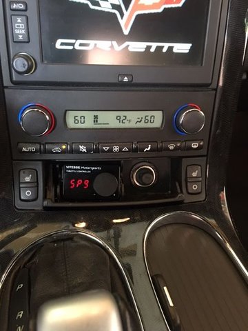

And here's the finished product. I can now see it clearly when driving and also conceal it when I want to. Beside the wheel I couldn't see it since the wheel is so large on the sides. And up to the upper left (tried that too) the sun hit it and it was hard to read. This is perfect!
Above are the steps: 1) remove ashtray 2) remove tray unit 3) drill hole in back corner (if you pull the unit later - not sure why you would do that - then the inserted ash tray covers up the hole.) 4) run the wires through it and re-plug it in 5) reinsert ash tray unit 6) put strong double-sided tape on the left and right side 7) Enjoy!

I mounted mine in the ash tray too. Now my on.y issue is the ash tray lid will either not open completely or not close completely. I suspect the cable is getting in the way. Maybe too much slack cable just behind the ash tray holder? Anyone have (and corrected) this issue?
Mine closes and opens fine, but I do need to play around with the spring. I may not have put that back together the same. I just have to pull it out.
Did you drill a hole in the back of the tray or loop it around the back?

I drilled a hole in the back like you did
