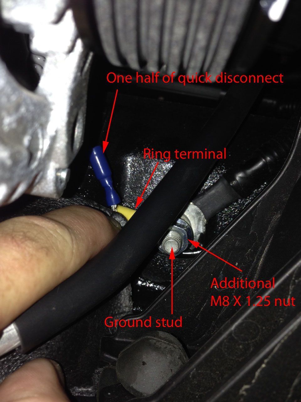

Here are a couple of pics of the engine compartment ground lug. It is much easier to add an additional M8 X 1.25 nut to the existing stud than to remove the original nut (access issues). Ignore extraneous text as these pics were for another project.
I wish I had thought of putting a nut on that stud instead of taking it out. I ended up dropping and losing it, and it took about an hour to find it. As I mentioned in my other post, I had to take the right front wheel off in order to find it. I wish I had seen your post before I ran into that problem. Thanks,
Norm
