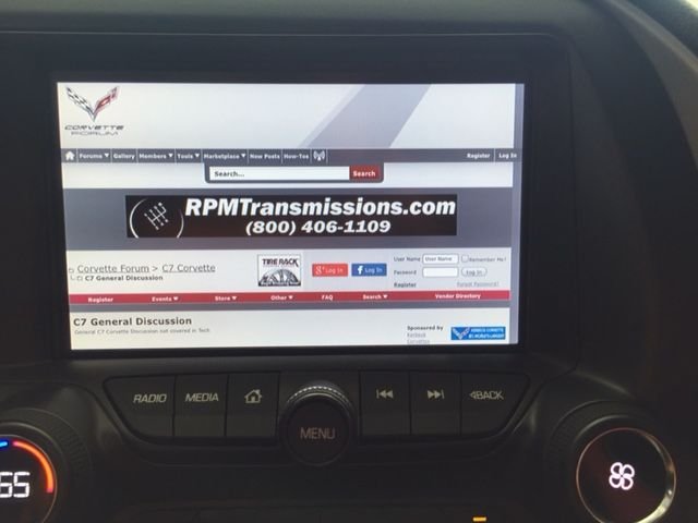

I connected this morning and got this:
HDMI cord works perfectly!

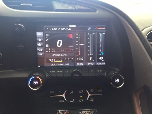

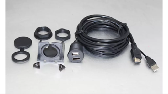

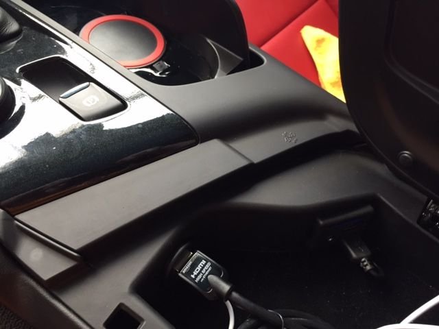

Big thanks to Elmer, followed his install guide today. HDMI mirroring works great on my iphone and ipad. My install was a bit more involved since I placed a HDMI outlet in the center console box. I was installing a Qi charger for my phone so had the console apart anyways. Someone posted the HDMI cable combo, I ended up buying part from eBay for $15. It was an IMC HDMI-USB-CBL dash mount extension. I ended up just taking the 12v outlet in the center console out (held on by two clips) and the HDMI/USB outlet slid right in like a glove. Pics below showing the outlet and Dashcommand app mirroring.
