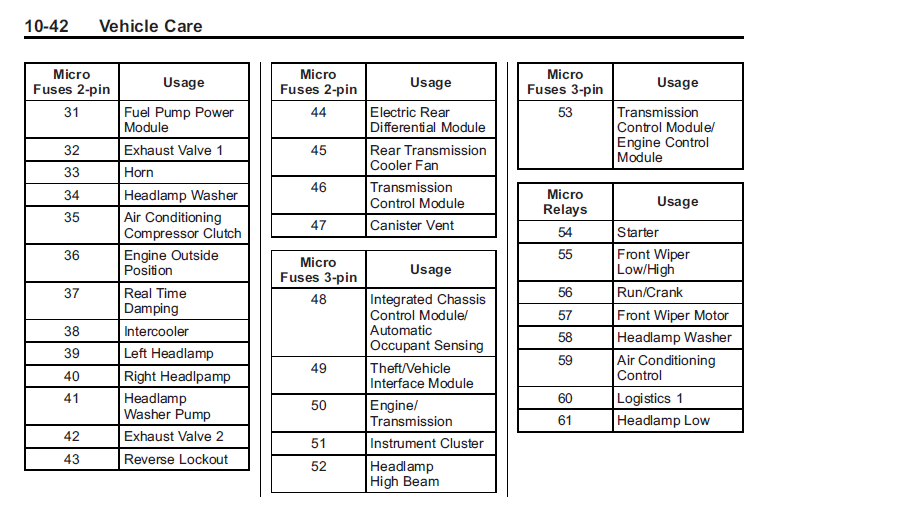

No, he said the exhaust valve fuse is in the wrong location, it's not.

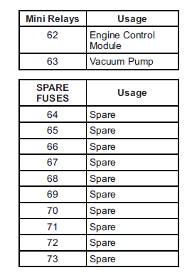

Originally Posted by springer-
I noticed a problem with your car while looking at you pictures. The fuse that operates you exhaust bypass is in the wrong place.
I'm sorry but you are mistaken, See Location on pic and on map pic.

Originally Posted by red 1
The fuse you indicate is for exhaust valve and the location you show it going to is nothing but a spare location. look at your diagram in the fuse box cover or your owners manual.
You are correct in everything you state. And I forget not everyone likes a throaty exhaust sound. If you like the sound when you step on it a little (when the exhaust valve opens) then you might try moving the fuse as that will leave the valves open all the time. IMO, it makes the car sound like it should. However your tastes and mine may be different. The original comment was meant "tongue in cheek".
He understood exactly what I was saying. Sorry for the confusion. I did actually move mine from the 42 to the spare so that circuit would not work anymore. No engine codes, no problems, just a little louder and more open exhaust. It was the best 60 second modification I have ever made and the least expensive thing I have ever done to a Vette!
