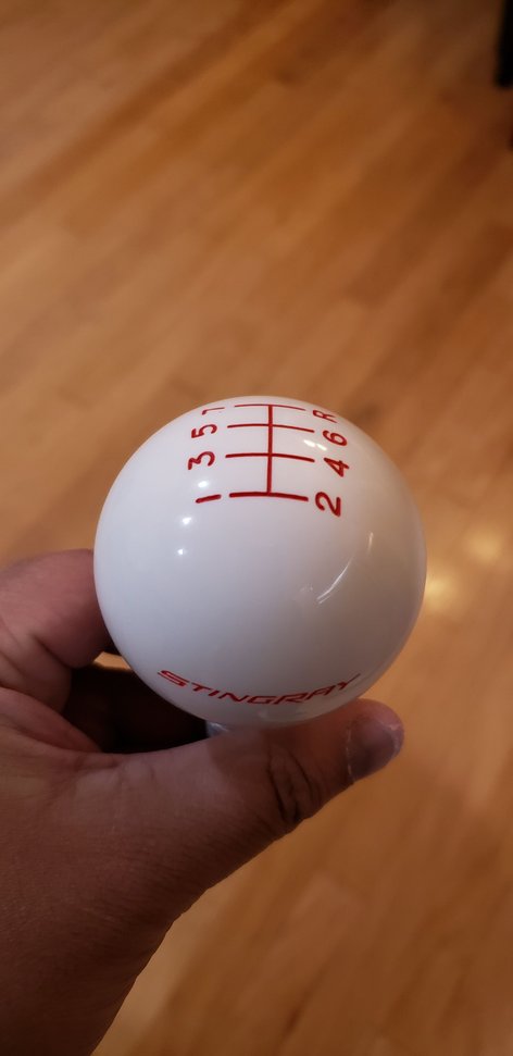

Got mine today but it's not weighted
Anyone can comment on their experience for the RPI **** on stock shifter, it will be shorter but may not help with the shifting as it's not weighted
nice one . Is it at least heavier than stock ****? Try it out. Or are you going to send it back?
I will try it out first but expected it to be heavier from the pics I saw
