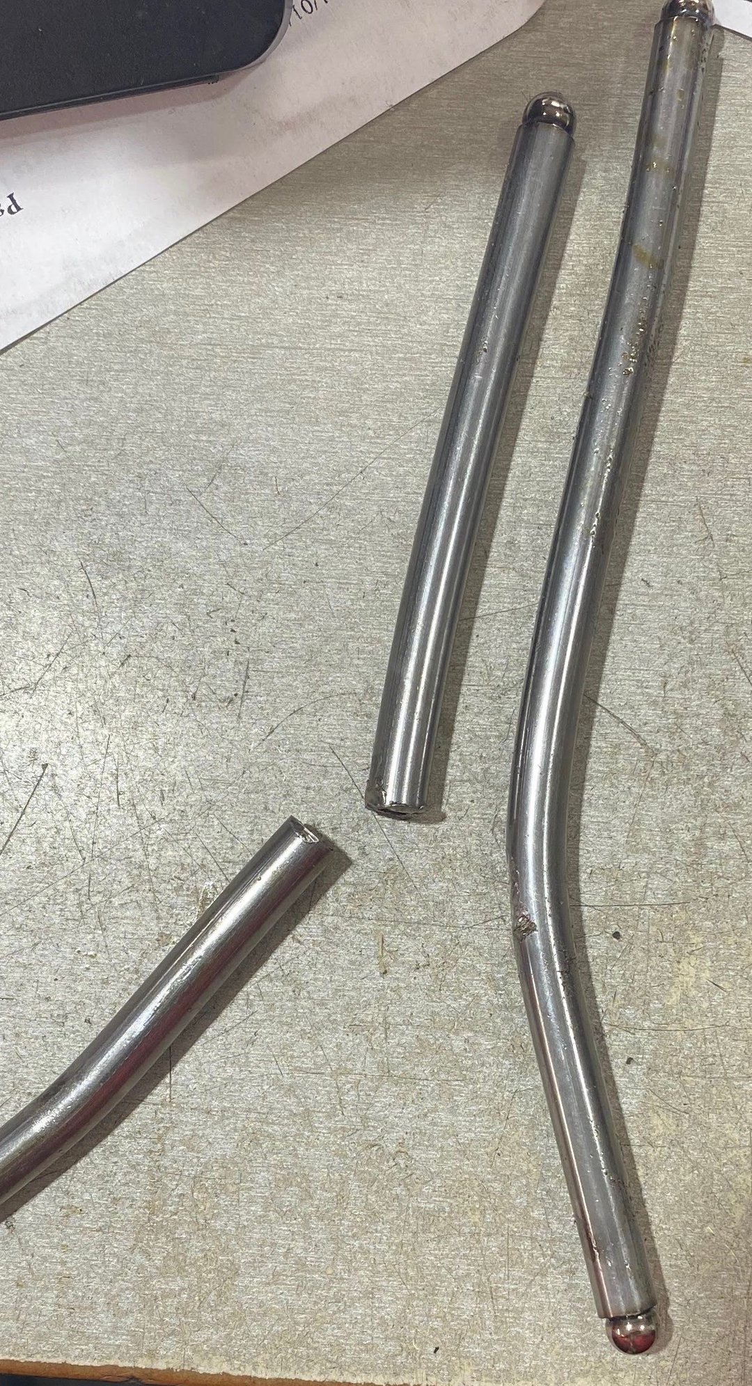

Well it happen to me after only getting the car 2 months ago (C8 Z51 HTC). Driving normally along the highway, car warning alarms went off and car started stalling and vibrating. Limped into nearest dealer and got the terrible news that the push rod snapped in half and the entire engine needs to be dropped. Not what I would expect from a brand new car that has only been driven as a daily. Very disappointed. Especially since this is my 2nd C8 after trading in the coup for the convertible. Never had this experience with Porsche or any other car brand for that matter.
Curious - Are you in the range of VINs impacted by the bad rods and recall?

Default Broken and bent rods

Was the root cause of the bent and broken rods the valve springs?

Originally Posted by fltex43
Are those from the same cylinder?
Those look like an effect from something else (like a dropped valve).

from what I understood it was due to a bad batch of supply rods affecting a specific range of VINs - not design related. I sense it could have happened to any C8 model year. Anyone please feel free to correct where necessary. Thanks.
