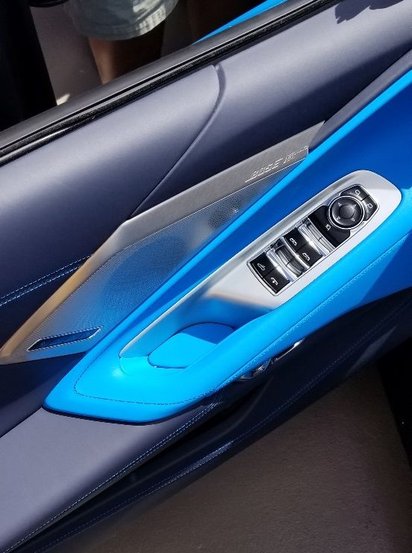

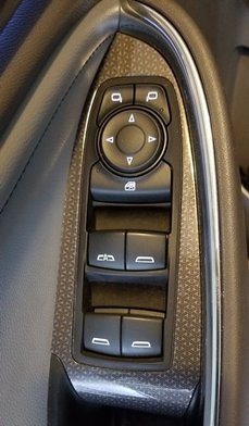

Apparently, unlike many here, I don't have a Mahal. I don't know if it is the same issue, but unfortunately many auto manufacturers "reuse" parts from year to year and model to model. The only thing that changes is a digit in the part number and add a zero or two to the price. Lincoln vs Mercury. Chevy vs GM .... I love my 2016 Malibu, but it has had a host of electronic wizardry that is atrocious, but fortunately all were fixed (replaced) under warranty.
The latest are the brake anti-slip light coming on at random and then disappearing after 3-5 drives (restarts) and now the Fuel gauge problem mentioned here. BTW, Malibu is garaged (until C8 arrives) and only 2 years old so the rotors are not flaking with rust .... AND now the fuel gauge problem mentioned here. Again a few dives and GONE.... so far only 1 time.
The picture of the C8 driver door mirror button panel (blue) is identical to my Malibu (grey). I'm sure this part is 1/4 of the C8 price at my Chevy or Gm dealership. Picture is from the convertible reveal at KSC last year! Hope its not the only one for 2020. It almost made me spend the extra $7500, but I personally like the lines and glass engine "hood" of the coupe better. That's why they make vanilla and chocolate ice cream before anyone takes issue with coupe vs convertible - BOTH are C8s!.

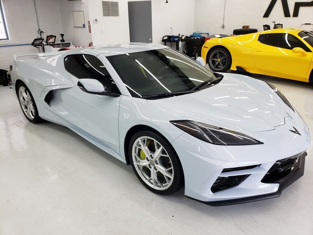

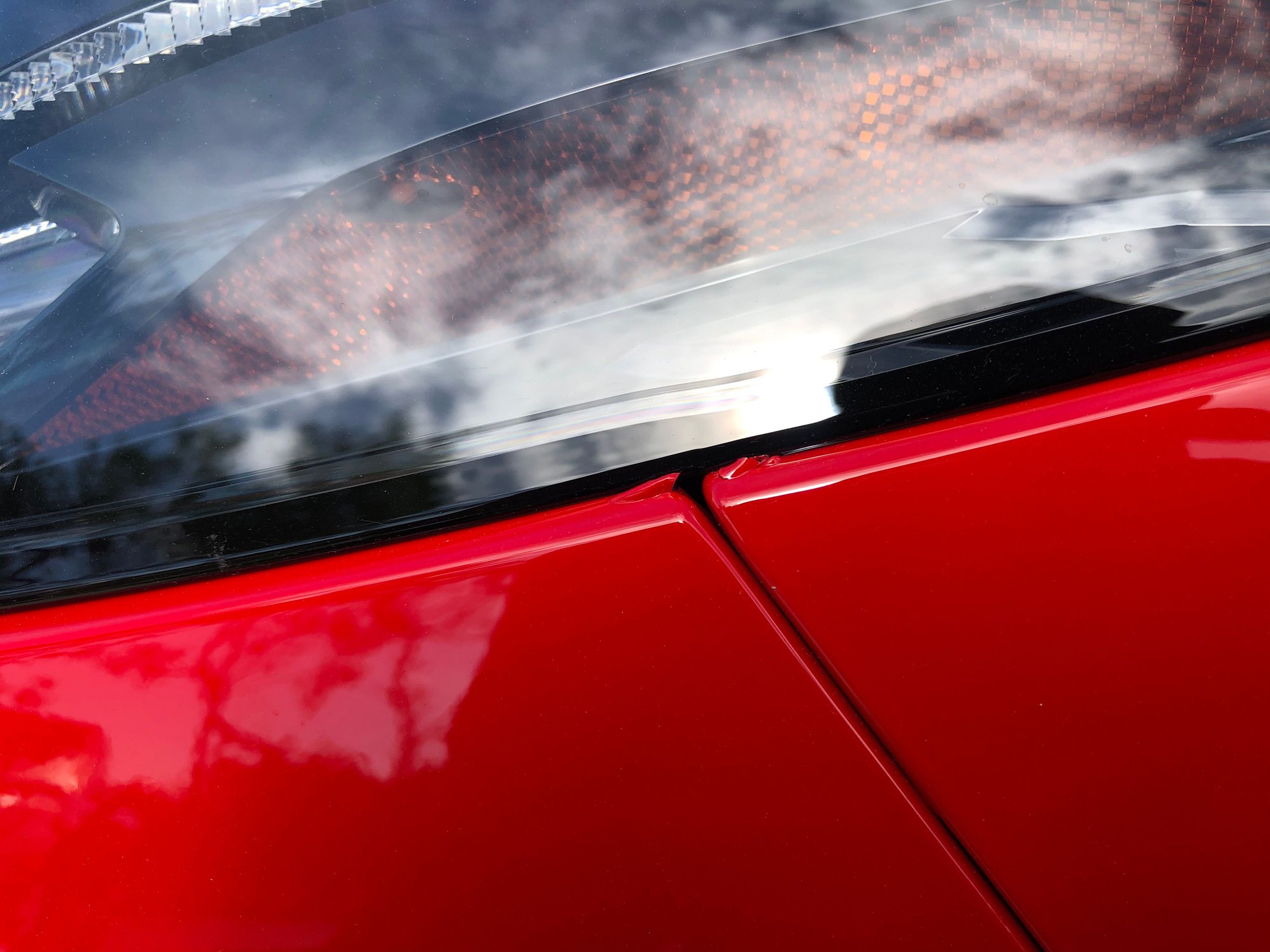

Here's a CMG with the paint lifting by the headlight/fender. Rubbing.
I mentioned this before but was waiting for my buddy the detailer to grab a pic of it. This owner doesn't care about it. He's putting about 25k in performance mods into it.
So long as it was that one area it wouldn't kill me... professional touch up and move on. If it propagated and started to peel like a 90s Dodge product.... then we'd have a serious issue.
So is this a fitment issue (headlight rubs fender) and not a paint run or over-spray problem?

What it is is ridiculous. That's what it is. The panels expand and contract quite a bit. The headlight doesn't. So when the tolerances are ultra tight? You risk this probably at assembly. I bet a micro fraction left or right with that headlight mounting AND your rubbing panels. And then they expand and contract and eventually paint lifts.
Many including myself chalked it up to adhesion but how much adhesion is enough in an area that rubs like that against something else that isnt flexible?
I like the adhesion argument better on C7 issues but even then it was always where the panels met. It has to be the composite panels.

Adhesion issue... properly stuck paint will just rub dull, not start to peel away.
