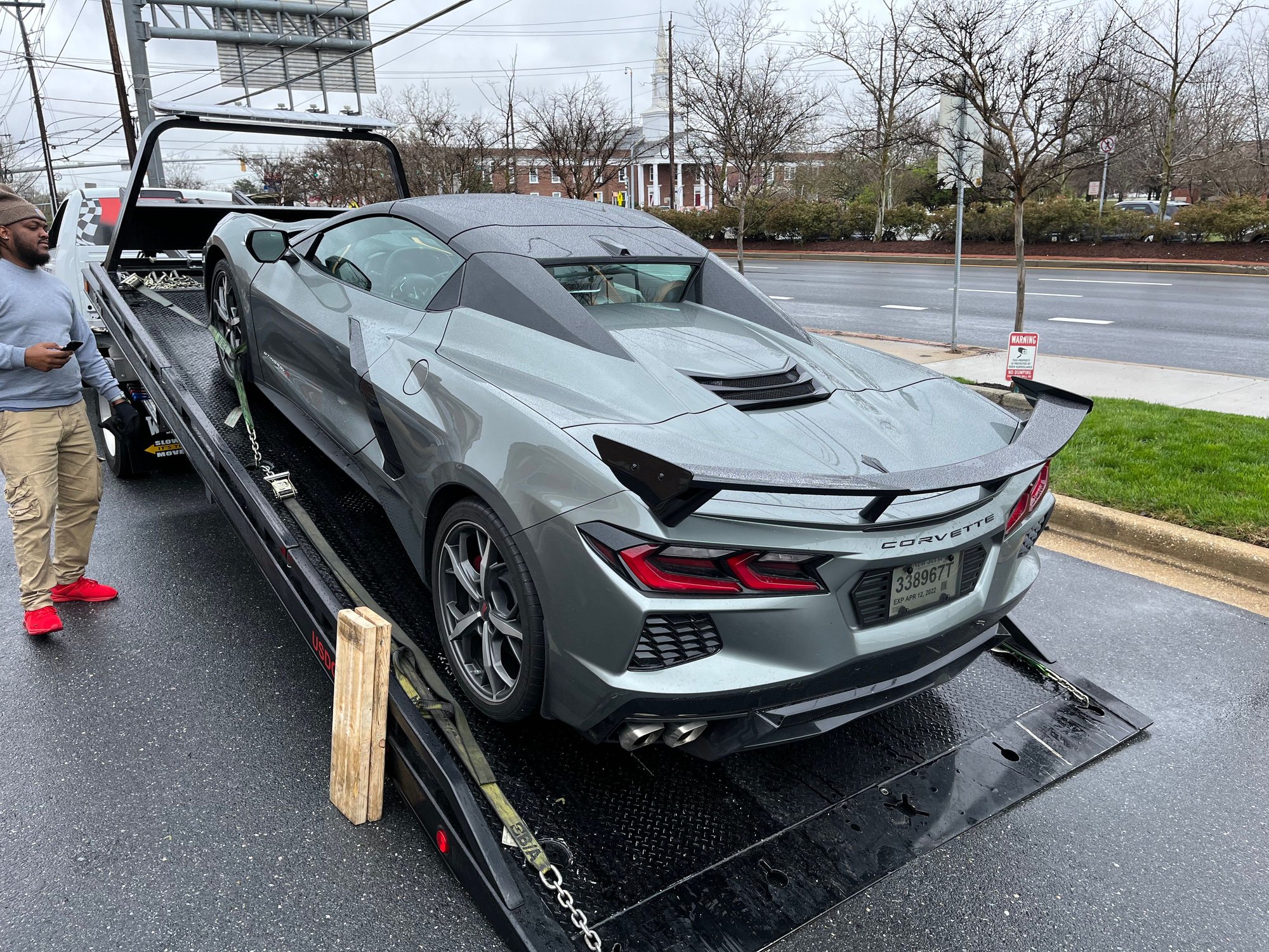

10 days post delivery similar
noticed cruise control suddenly stopped working. Then noticed check engine light followed by engine repeatedly stopping, then transmission shift weirdness, then massive loud fans in rear while parked.
codes p0101, u060f, u1346
took to Criswell. They have never seen this. Coincidentally today a bulletin comes out (PIE0681) about exactly this. Seemingly new failure mode people are seeing?
hopefully I’m not starting a 6month repair journey. Fingers crossed.
I didn’t have tow hook. Driver was uncomfortable connecting to the points called out in book. He preferred I drive it on. Luckily the car ran enough for that. With a couple wood blocks we were able to pull it off even without front lift. No scraping. That being said, I’m buying tow hook now for next time.

Likes: 78
Update on codes p0101, u060f, u1346 and GMs new bulletin to address it PIE0681
yesterday they are concluding that there was a water intrusion issue and that the mass airflow sensor needs replacement. Easy and an available Part. Hopefully I get it back next week. Fingers crossed.

Mass airflow sensor replacement fixed my issues. Got it back today
