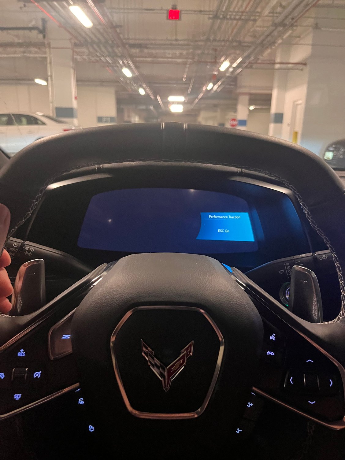

Screen glitch after most recent update. I am driving in my garage and this is how it looks. It was completely black after turning on/off car multiple times. I turned on Z mode to see if it would get the dash to turn on and got get this to come up but then it wouldn’t go away. Driving, reverse, parking, trying a bunch of **** in the touchscreen menu but nothing worked. Was worried I was gonna have to drive for my thanksgiving plans with no speedometer, “sorry officer I REALLY don’t know how fast I’m going”
What worked was fully turning car off, and walking away with fob. Just turning off and even walking around the car wasn’t enough. You need fully off. My next step was gonna be to pop the battery.
20 min of my life I’ll never get back
If this happens again, try this to erase the car/computer cache. Start the car. Shut the car off. Then open the drivers side door for 90 seconds (and you have to have it open for no less than 90 seconds). Close door, start the car and the computer cache has now been reset. Watch the video using the link below at the 1:44:46 mark.
What this does is to clear out the computers cache and hopefully correct the problem.
