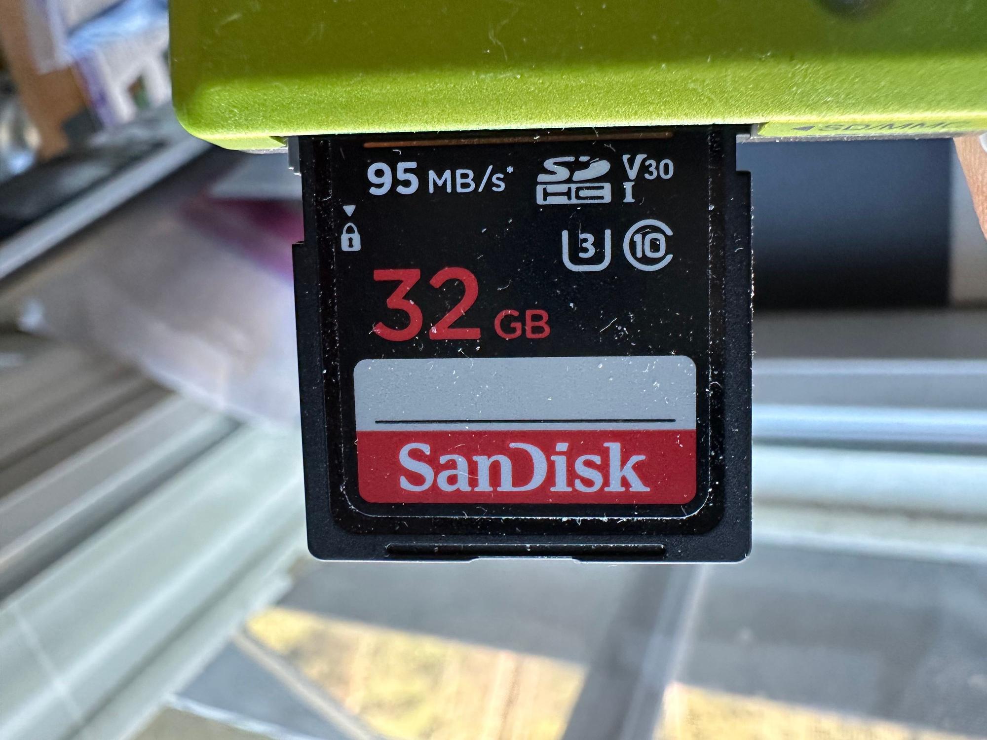

NOTE the number 3 inside the U shape on the label. I believe this is what the PDR needs.

Default Card Used by Spring Mountain
It is a bit dusty from hanging off the back of my computer monitor, but it was the version provided at the Ron Fellows driving session I attended.

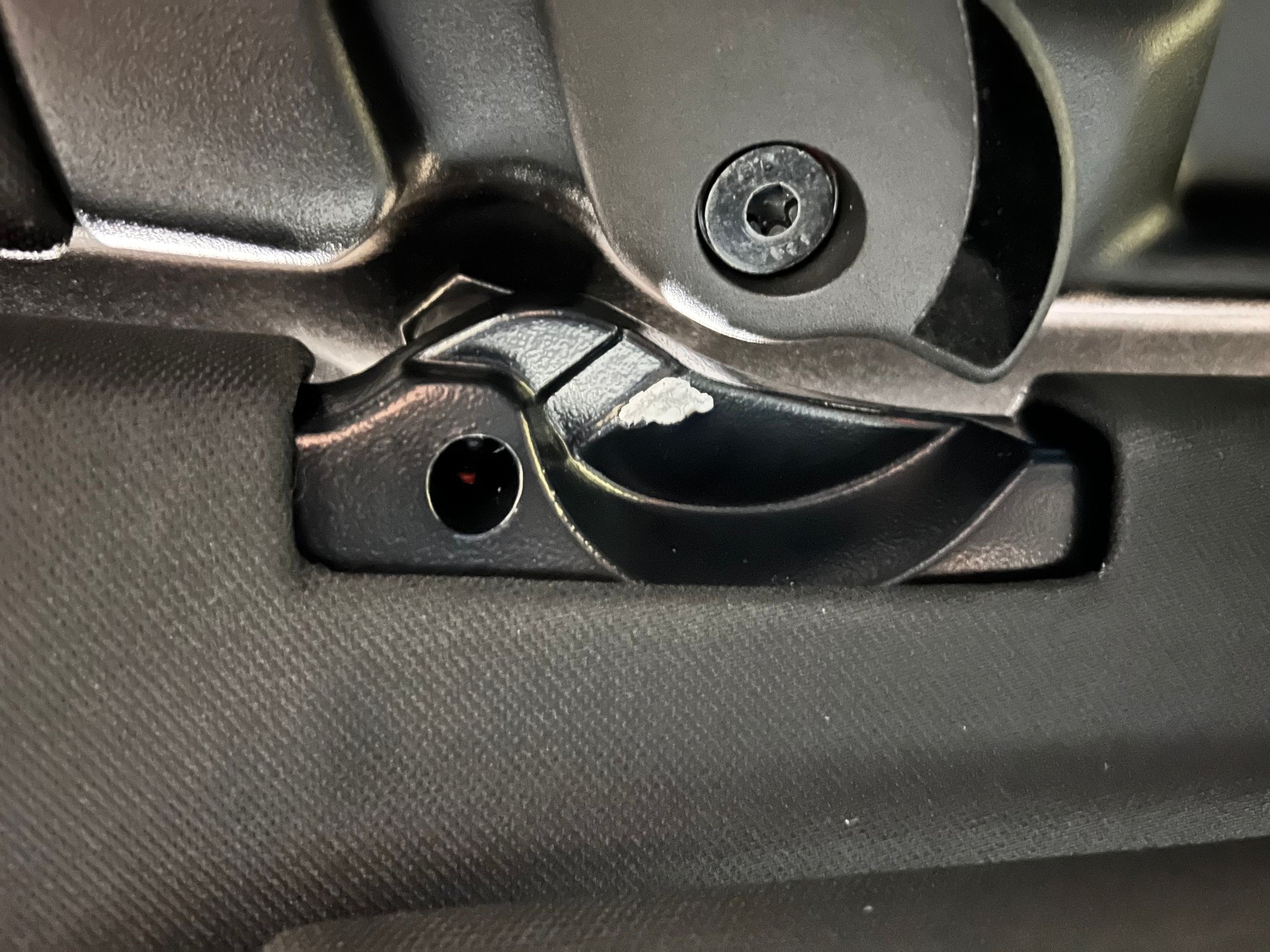

Default black paint by removable top latch is chipping
I finally got my car back and was trying out the removable top when the black paint by the latch chipped off when relatching.
I’m pretty sure that there is no easy fix, but it sure is annoying.
Try a black sharpie
