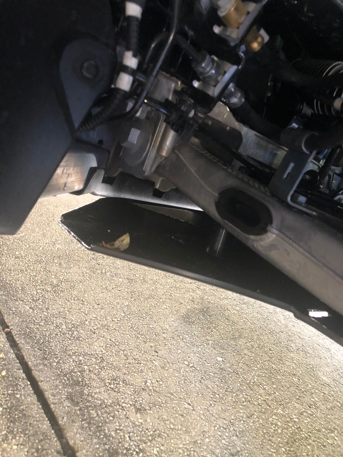

I picked up my car at the museum and it was incredible. We did as much of the bourbon trail as possible. Most were closed. We arrived home yesterday and I put my car in the garage. I pulled it out today to wash it and found a puddle of fluid behind and inside the right front tire. The color of the fluid was clear and maybe golden. There is a plate/cover inside of the right front tire that is wet with what I think is the same fluid. I think it might be brake fluid. Any ideas?

Get it checked out if it is brake fluid your paint is jeopardy - not good. Good Luck...
Do you have front lift?
