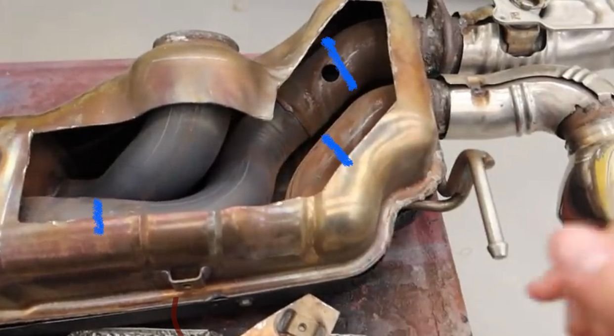

Don't use stealth on track. It can put too much heat in the muffler. When the valves are closed it forces the exhaust through a small hole in the main pipe into the muffler chamber and out the inner tips. Some tracks have noise limits so some people may be inclined to try it if they got flagged by the decibel meter.
