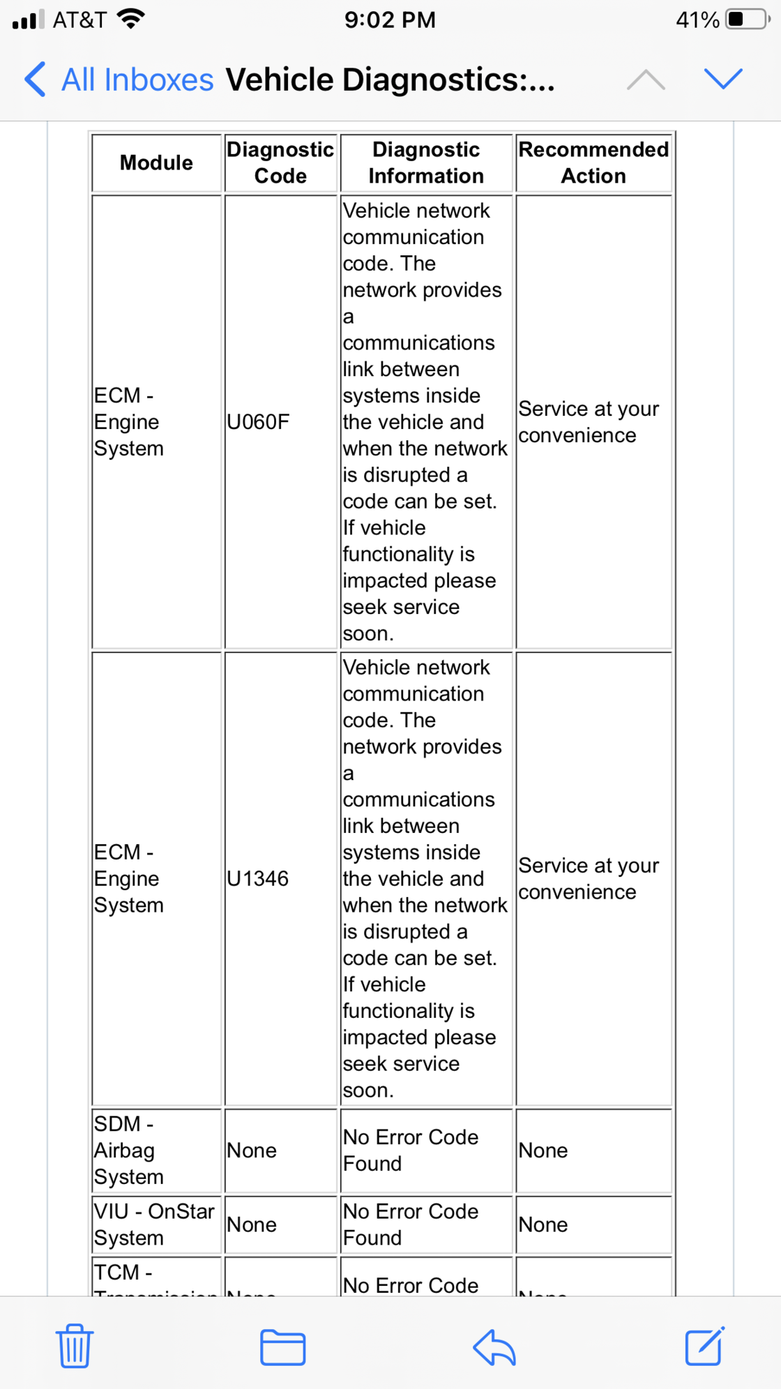

Default Car is dead in my garage
Went out to start my 10 day old C8HTC with 650 miles. Pushed start button, engine cranked then it shut off. I thought maybe I inadvertently hit the start button twice and the second push of the button shut it down so tried again, more carefully.
Same thing. Started, then shut down. Only this time I noticed a slight engine whine before it shut down.
And I had a check engine
Called Onstar and they said they would send a diagnostic email and transfer me to tech support. They did send the email but dropped the call three times, confirming that OnStar is worthless. Something I already knew.
I will attach a screenshot of the diagnostic report but note it says I can service at my convenience unless it impacts operation of the vehicle. Yeah. Not starting qualifies as operation of the vehicle.
What a bummer.

Originally Posted by JoeB3
Sorry to hear that Greg. That’s a new one to me. I’m hoping you at least have it at home and are not traveling with it. While keeping current in this forum (and this thread particularly) along the several month wait for my car I had fears like that for my drive home from the museum after taking delivery. Sorry you’ve having a bad experience so quickly out of the gate. Will definitely be interested to hear how this develops.
It’s safely in my garage right now. Like a big-*** paperweight. I just talked with Onstar/Chevy roadside assistance and they are going to pick it up at 0700 on Tuesday.
Don’t want to be overly pessimistic but I think this is a serious problem. Like new engine serious.
But I’m hoping for the best.
UPDATE:
Simple fix. MAF sensor connector came loose. Reconnected and on the way to pick it up now.

Well, not as simple as I thought. Went to pick it up and the the service tech drove it around and shut it off. I heard the fan running and knew it shouldn’t be running in that 30 second drive. I restarted it and the CEL was on.
It might have been a MAF sensor issue and still might be. But it isn’t fixed.
