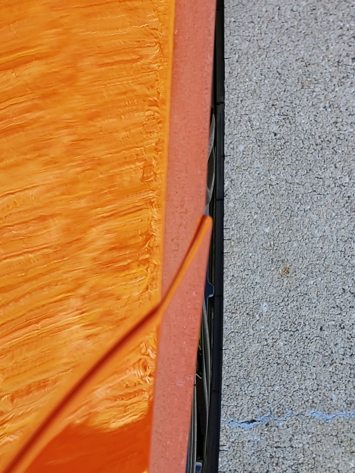

Originally Posted by dohabandit
Pictures of my rear bumper alignment issue. Anyone know if you can just force this into alignment or is there a proper fix for this?
Bad side
Did you ever get this fixed? I have the same issue.
Yep, the Chevy dealer body shop took care of it. They said it was easy to fix.

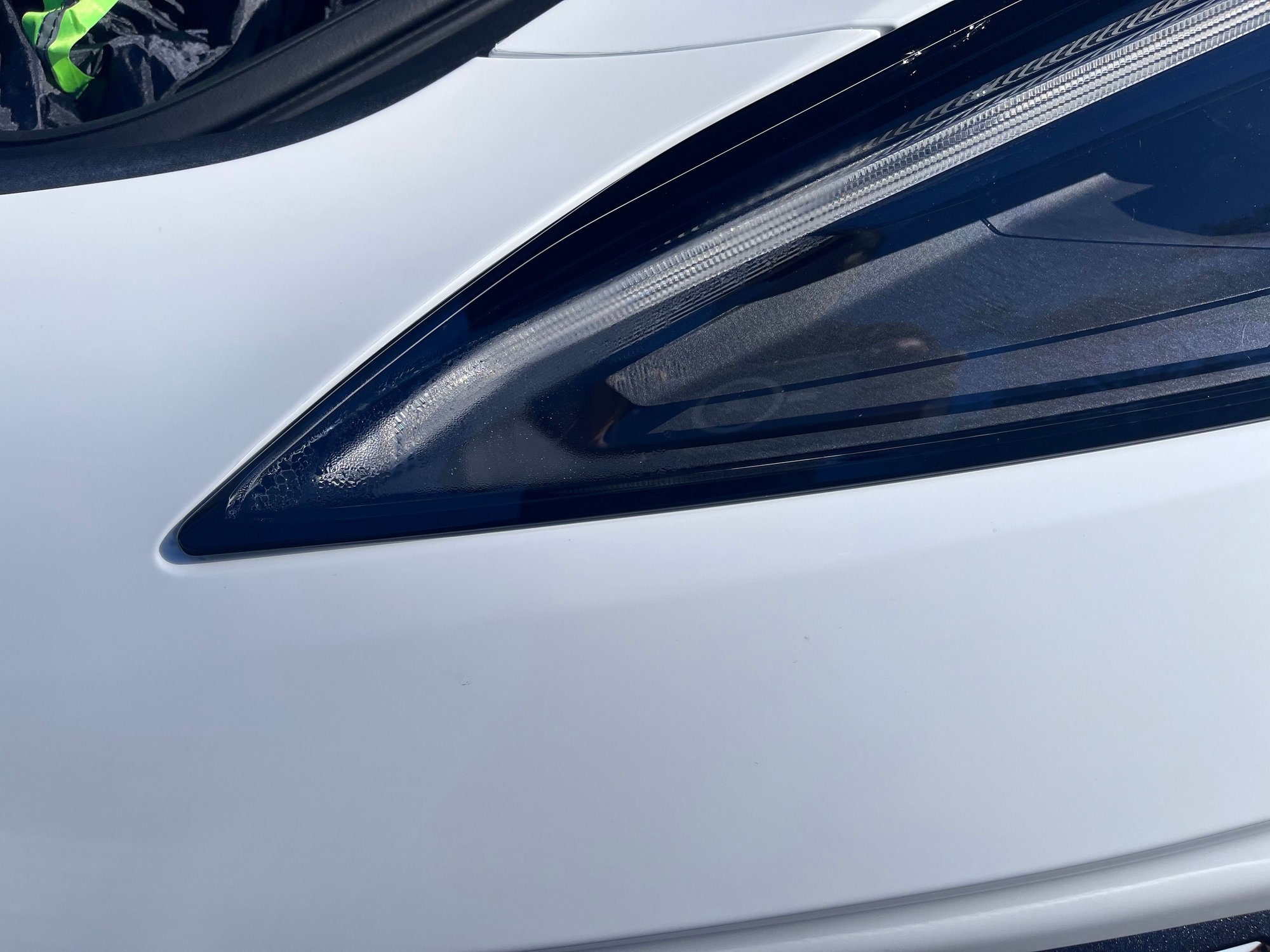

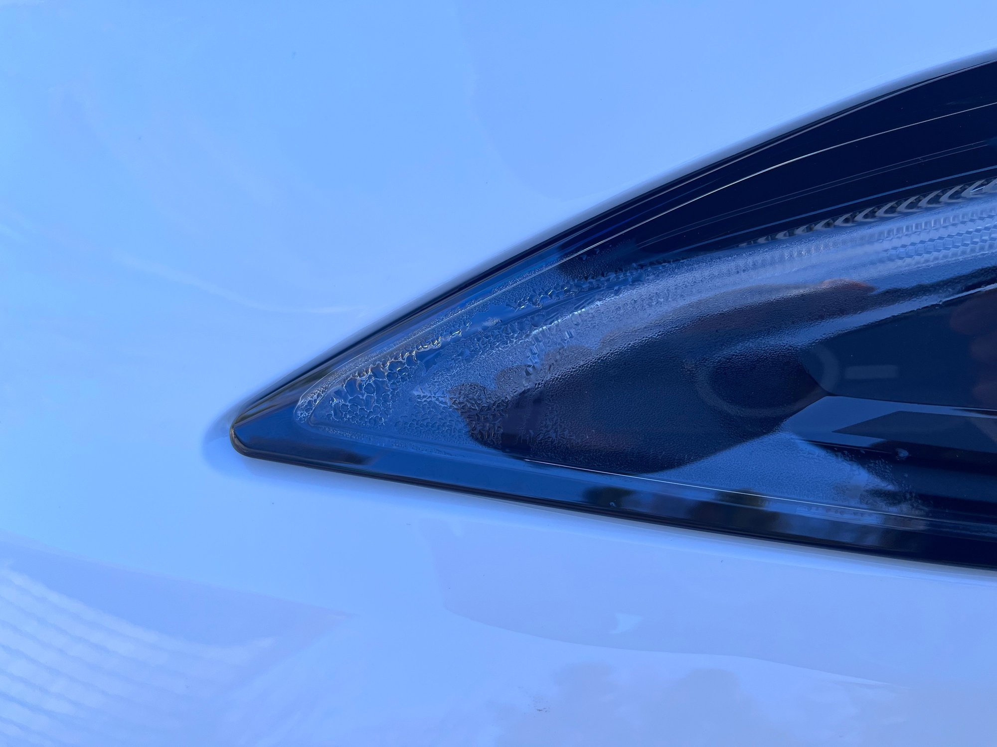

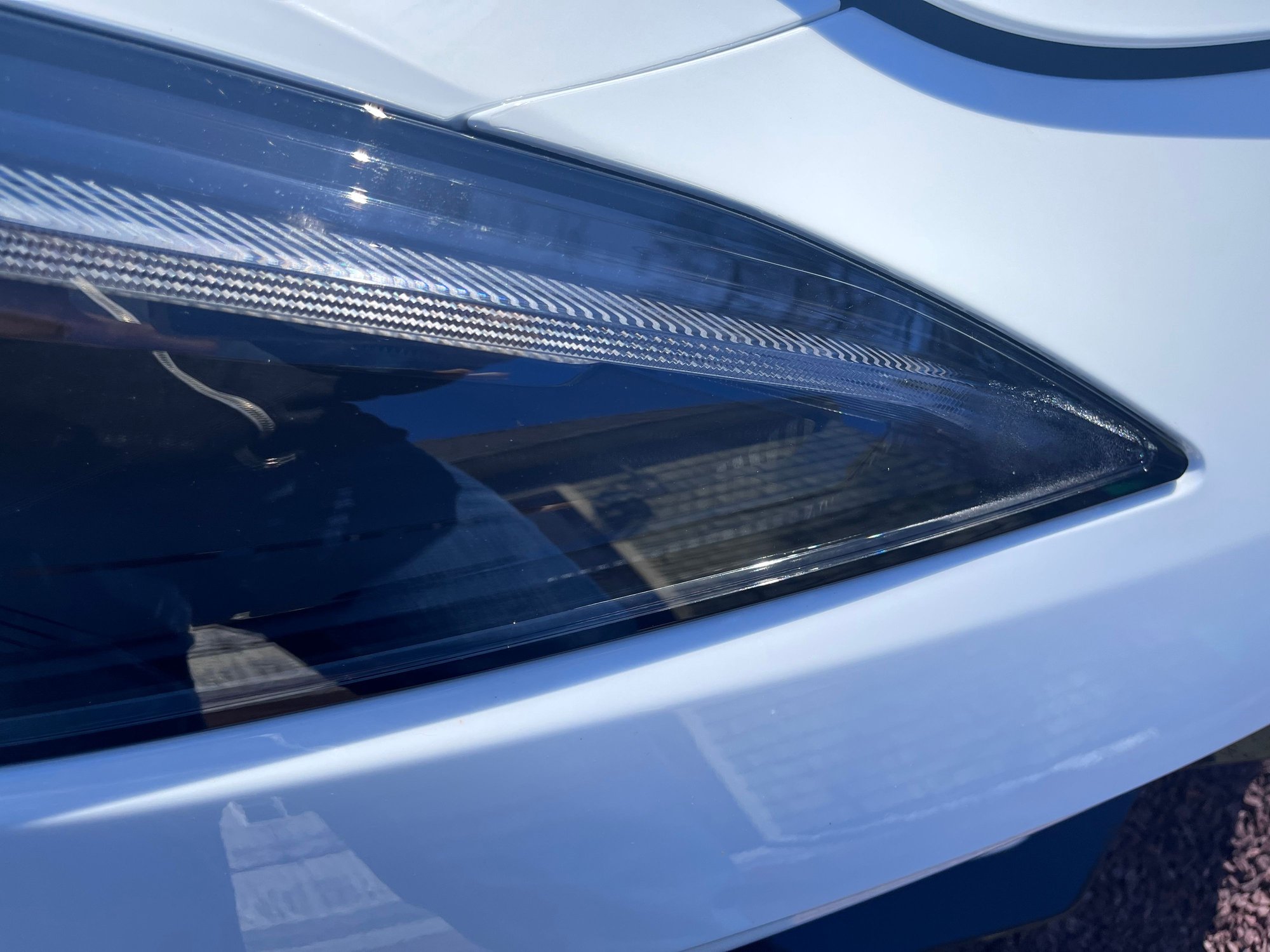

Anyone else have issues with headlights taking in water ? Drivers side is full of moisture . Maybe a recall item ?
Streaks or actual moisture? Maybe post some pics?
