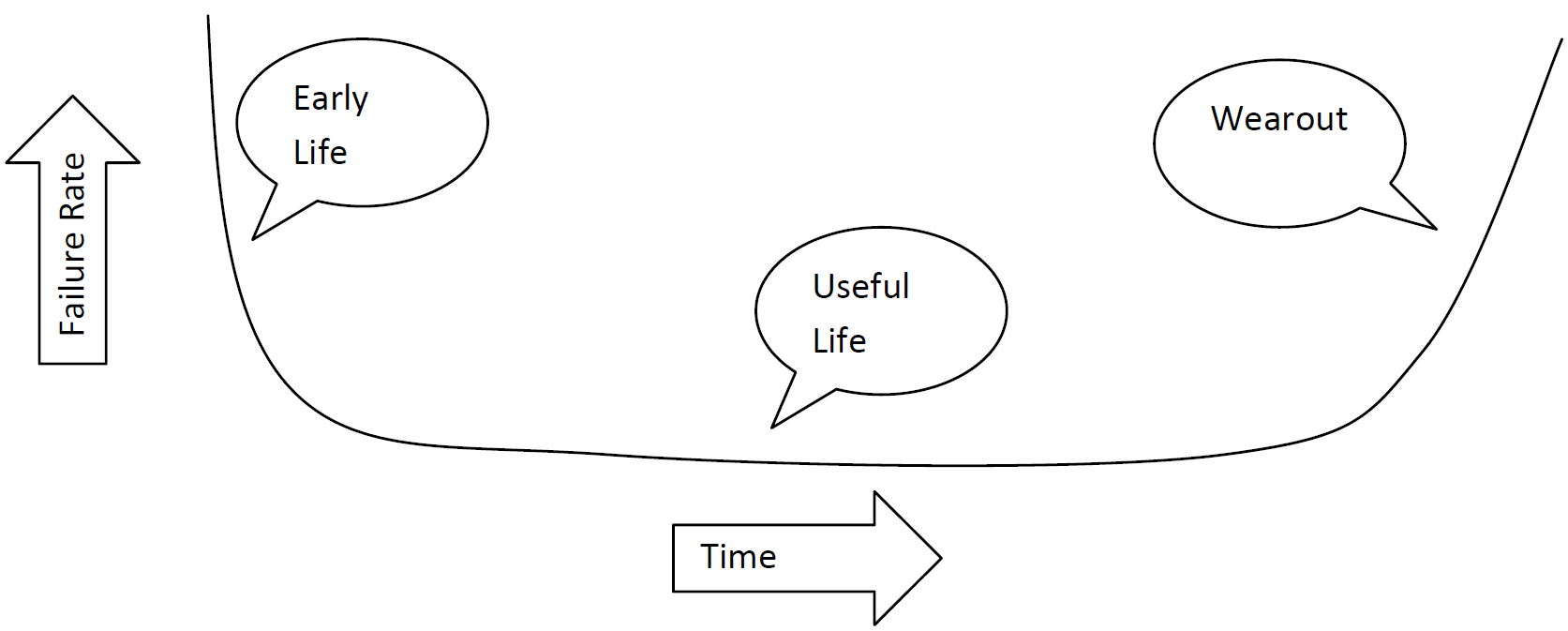

The C8 issues you hear about are boosted via selection bias though.
Always remember the failure rate "bathtub". You will always see the highest failure rate up early, then a much lower failure rate over lifetime before components start to exceed their design/anticipated lifespan.

I did one of these for an aircraft fuel pump once (it was difficult getting good data). It was pretty much as shown, except the bathtub had a bit of a hill in the middle. Never did figure out why.

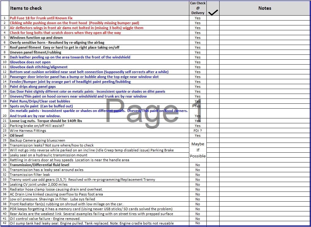

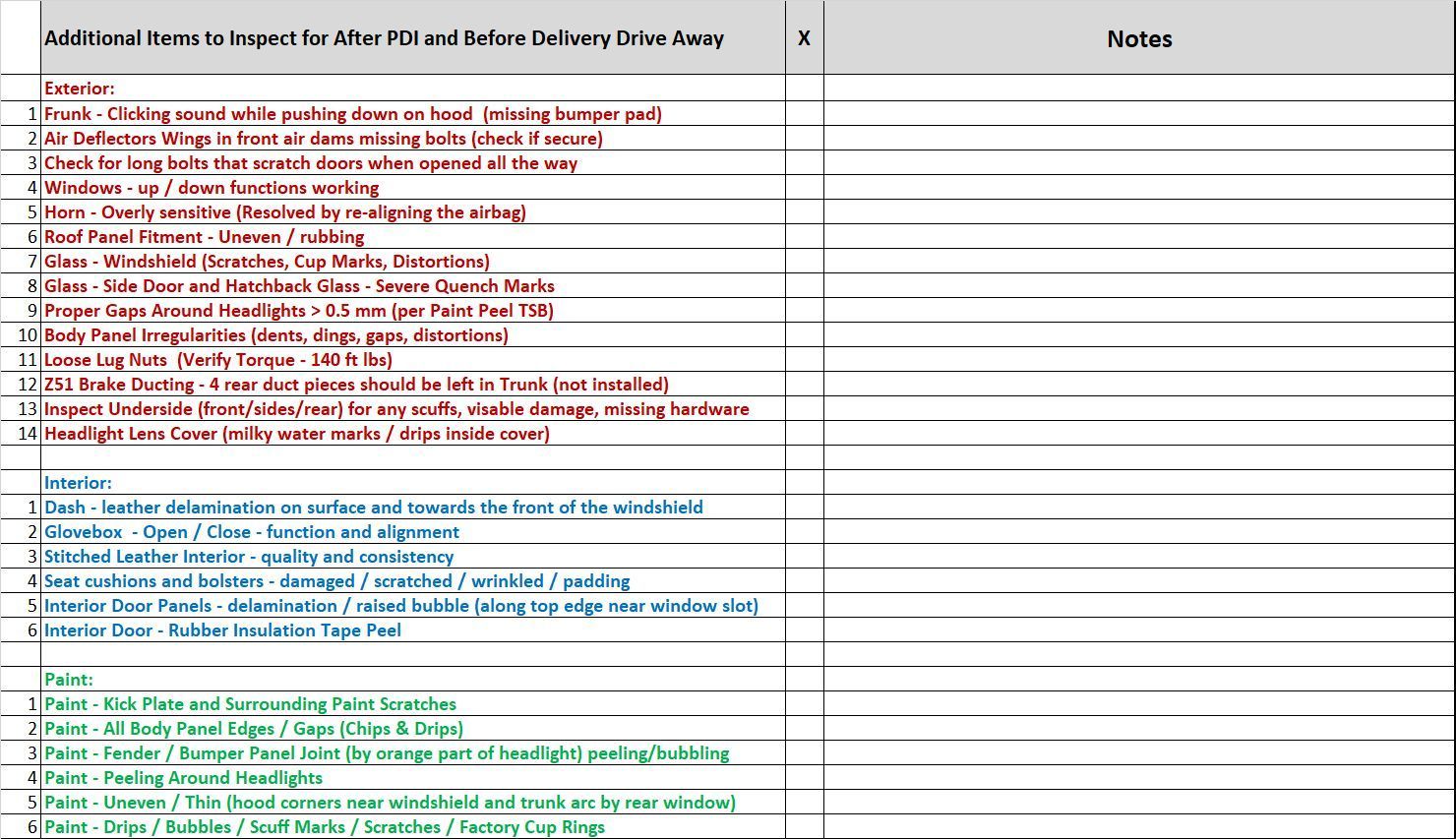

I always find it helpful to bring a checklist with me to do my "post" PDI inspections during the Delivery as I find it can be somewhat distracting during the delivery process and the checklist allows me to stay focused...I'd rather catch things during this time to make sure these things are well documented and left with the Dealer for corrections...
I've gathered quite a bit of info over the past months thanks to other members who posted here on our forum and have compiled a list of problems that people reported finding either during delivery or immediately after getting home when the adrenaline has subsided, and they've had more time and a clearer mind to look at things with a greater focus....
Here is my list so far...I'm hoping that others can chime in and add items you may have discovered after your delivery inspection...Keep in mind that this is not the PDI list, but additional items often overlooked or not looked at all during PDI..
TIA

Great List....thanks I'll bring it up to Macmulkin next week ...here are a few other items I can think of ..most of which appear to be resolved;
Valve springs breaking-engine failure
Transmission leaks/shifting problems
Bose amplifier gets wet under passenger floor mat-no audio turning directional sound
Convertible top no aligned

You should also look for milky water marks INSIDE the front headlight lens assemblies. You can see some threads here about it. Once you see them, you can't unsee them and the entire front of the car has to be removed to correct the issue. My dealer advised me to WAIT and have it repaired later on. Not sure that is a good idea, I am going to ask them to put that into writing for me.
I also had damage to the underside of the coupe trunk lid AFTER it was painted black that appears to be caused by the jig assembly they use a BGA. So I am guessing it is possible others have had this damage occur as well. If you want some pics send me a DM.

One of the many reasons for a local delivery - UNLESS they S^CK, Overpriced, Too long for order to delivery.
We had a 40+ list for the 2020MY - Not everyone had every problem. It was a total for the entire year. many 1 offs.
I do not know what still applies, but I'd check anyways.
