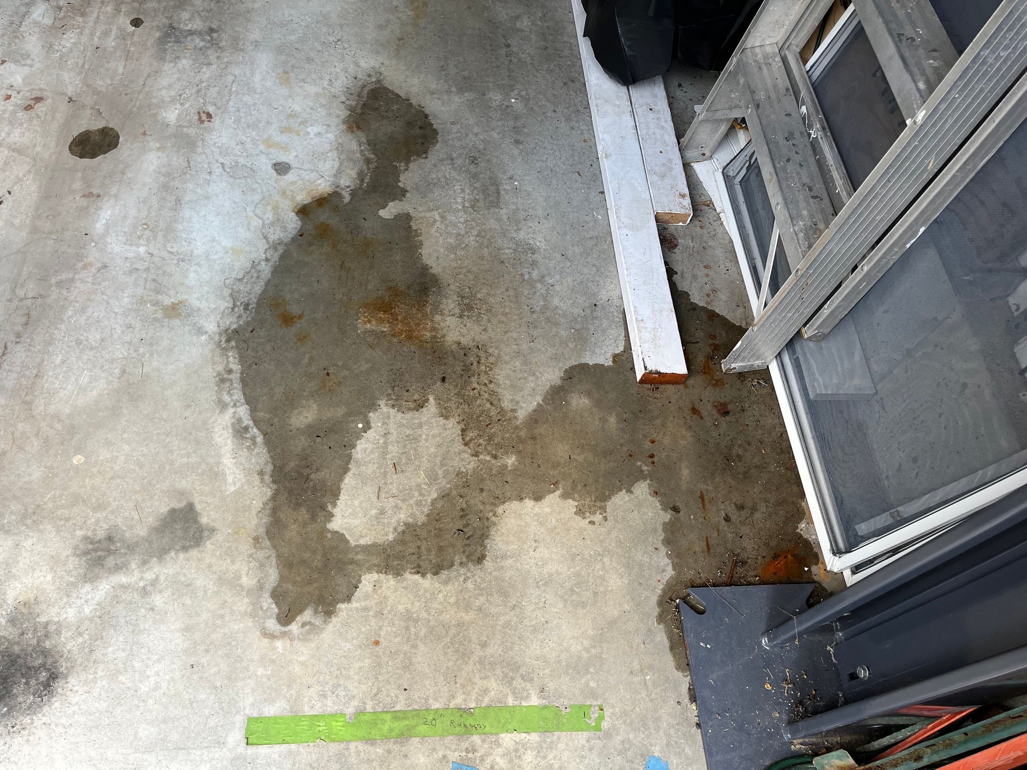

Originally Posted by C5C6C7C8
2020 HTC with 5K plus miles. 25 mile, 40 minute ride, top down, AC on, medium humidity. Parked in garage and 4 hours later this puddle is observed. Also a few small moisture patches down the centerline of the car. Feels like water, no smell, I even tasted it…..a tad salty.
Never saw this amount at this location before.
Opinions and ideas welcome.
My opinion: AC condensation. The evaporator condensation drains into the center tunnel and the water finds the easiest path out.
Or possibly condensation from a weep hole in the exhaust.

[QUOTE=RKCRLR;1605310640]My opinion: AC condensation. The evaporator condensation drains into the center tunnel and the water finds the easiest path out.
I agree, most likely AC condensation that had pooled in the center tunnel. Nice to know that you don’t have one of the cars that had the moisture drain into the passenger foot well.
