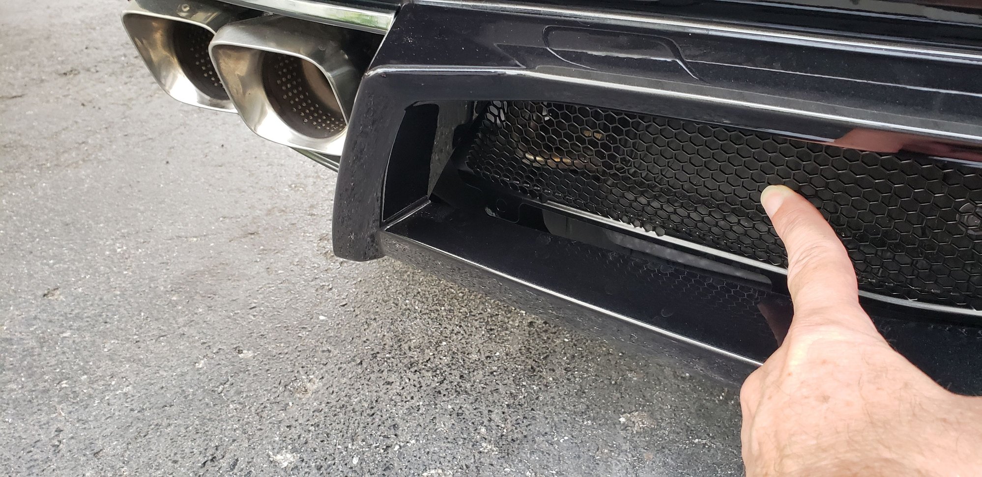

Hey everyone!
My C8 arrived on Thursday, so far it everything I hoped for and more.
Here is the issue I’m posting. Kept hearing a rattle from the rear, found it this afternoon. There is a screen in the lower rear fascia. I found a screw missing, see my attached picture.
