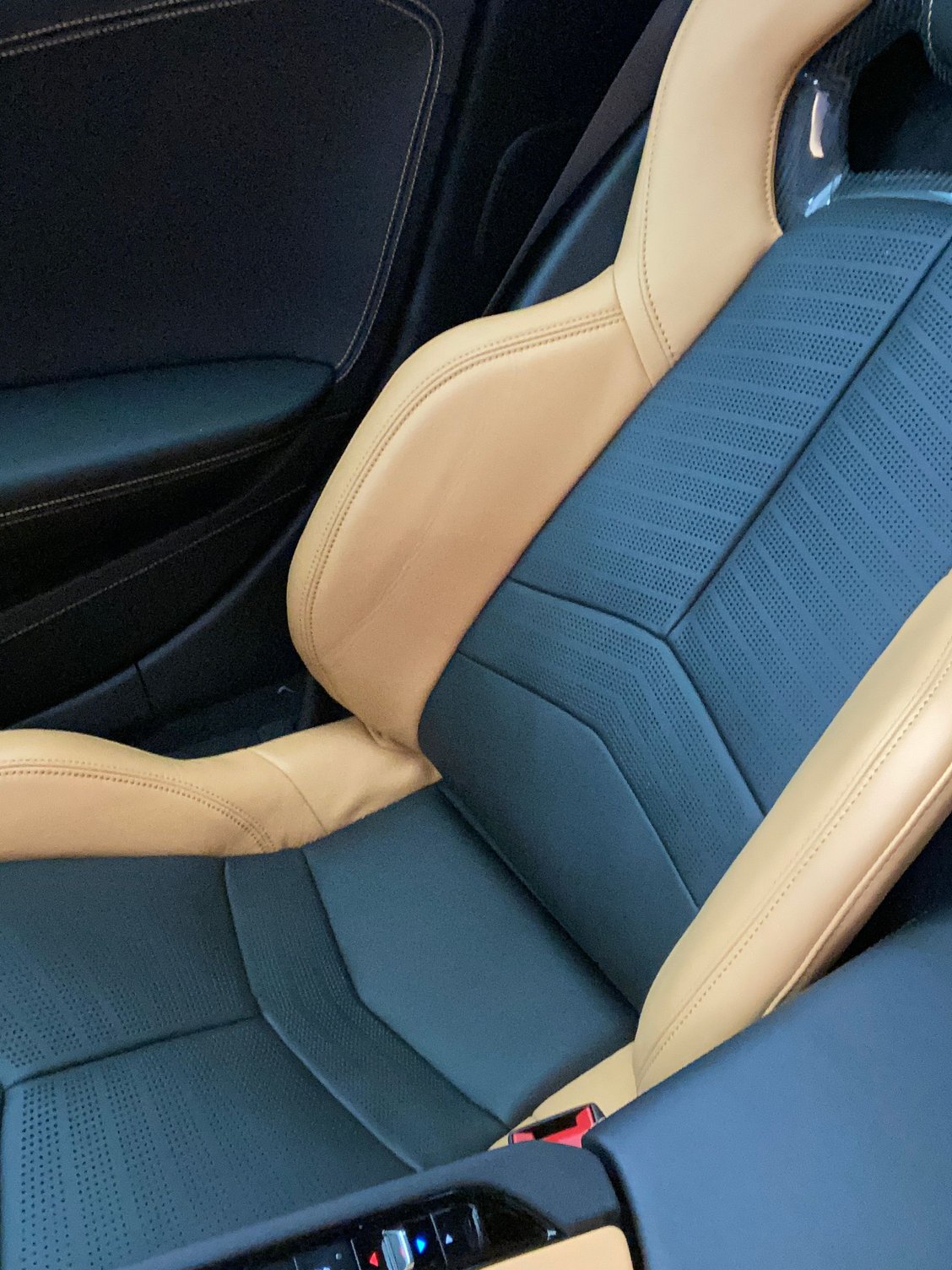

Just picked up my new C8 yesterday, 2LT interior. Love the car, getting used to it. Look at the passenger seat....appears that there is not enough cushioning/padding in the seat and it's wrinkled. I've seen this on other posts, so I was not completely surprised, but I wish the quality control caught this and did something about it. The stitching on the dashboard has one spot that is not exact.
I'm in the auto industry and I understand why this happens, but if I'm GM, I rectify this asap.

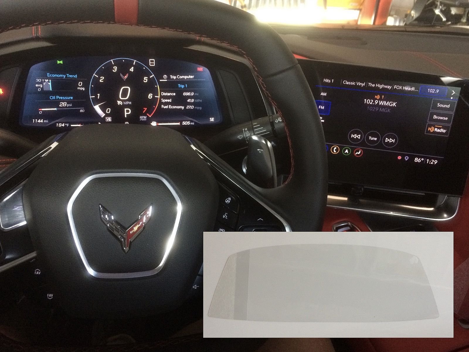

Suffered through the Info screen issue on my ‘14 C7 thus having it replaced under warranty. So I’m sensitive to this issue but it has not reoccurred on my ‘20 C8 with about 1.2k miles. But there has been a longitudinal off color stripe on the left side of my dash screen that I attributed to glare from the driver’s side window. Today a bubble appeared smack dab in the middle of the dash screen. At first panic struck and I thought “O No, not again”. But subsequent reasoning revealed the cause. A protective plastic cover was not removed and took until now for me to noticed. The screen brilliance looks to have doubled. So double check that yours has been removed.
I smell a class action lawsuit! 😃
