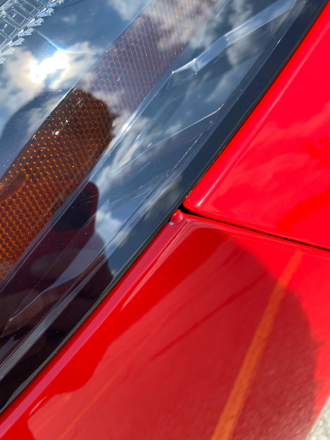

Old Jun 22, 2020 | 02:04 PM
  #308
carriccp's Avatar
carriccp
Joined: Mar 2012
Posts: 1,095
Likes: 703
Argh...
Old Jun 22, 2020 | 04:11 PM
  #309
tdrake2020's Avatar
tdrake2020
Joined: Mar 2020
Posts: 575
Likes: 324
Originally Posted by carriccp
Argh...
How long did you have it before this paint problem showed up?

Old Jun 23, 2020 | 12:14 AM
  #311
carriccp's Avatar
carriccp
Joined: Mar 2012
Posts: 1,095
Likes: 703
I have had it since March, but only 880 miles due to COVID and working from home. Based on the comments I'm seeing on Facebook, it's a pretty common issue in this spot.
Old Jun 23, 2020 | 12:35 AM
  #312
sprayer's Avatar
sprayer
Joined: Feb 2017
Posts: 1,778
Likes: 902
That is a pain in the butt. GM have known about this issue since the C7 days. Now even with the new $500million paint plant it is still an issue. Not good.
So much for the GM will fix it this time aroundo, not good enough.
Old Jun 23, 2020 | 02:15 PM
  #313
carriccp's Avatar
carriccp
Joined: Mar 2012
Posts: 1,095
Likes: 703
There is apparently a bulletin out for GM to fix affected cars, and the plant is fixing at the assembly level. Unfortunately mine is covered in PPF, which wouldn't be covered during the repair, so I'm not about to have it ripped off to repaint the bumper and pay to have new film applied at my cost. Sucks, but I guess I'll touch it up and move on.
