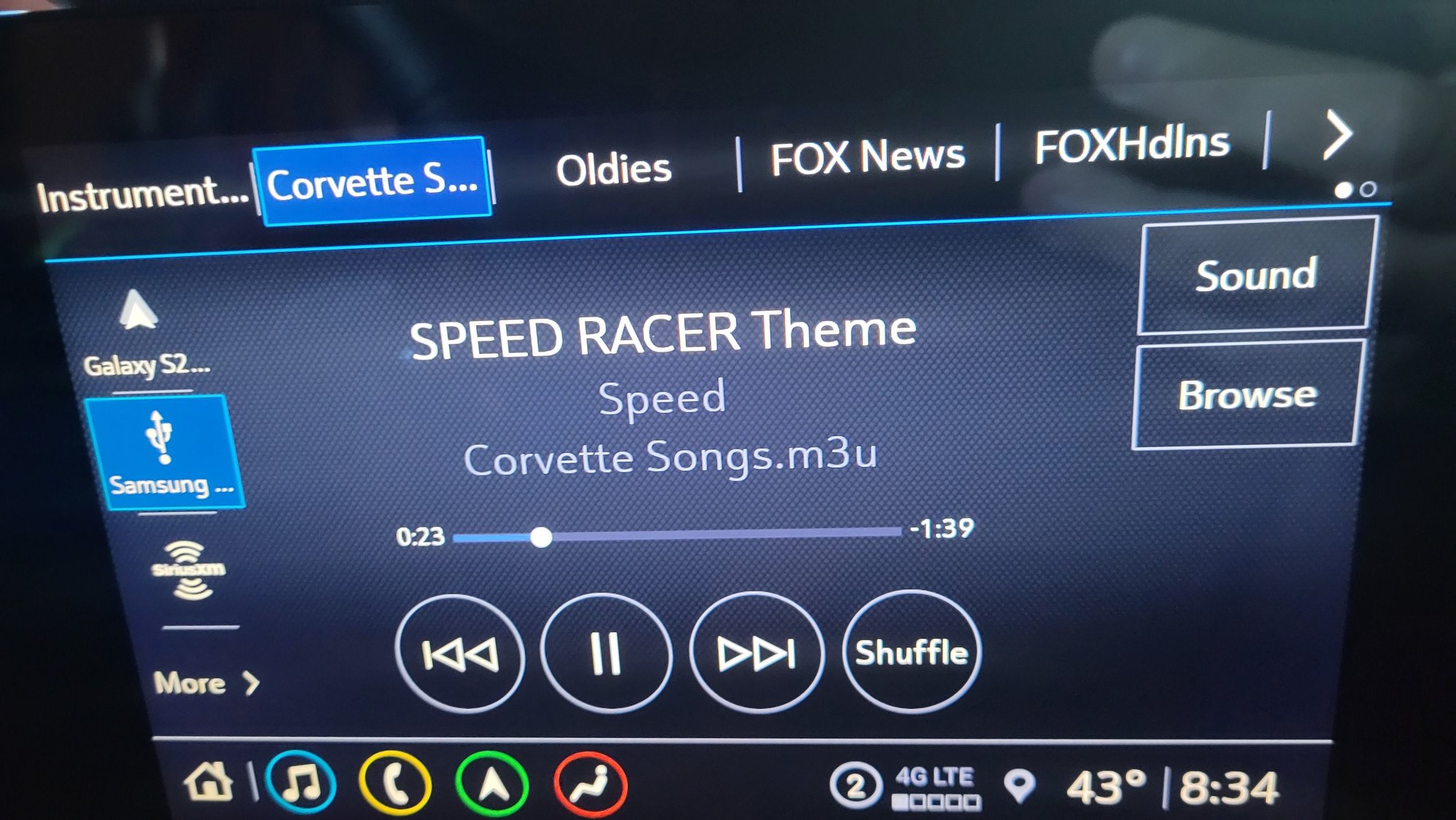

Problem 2. This is me being stupid, but I can't figure out how to turn shuffle on/off for my usb music..
The "Shuffle" button clearly shows up for me when playing music from the USB. See photo. The "Shuffle" button shows up after I "Browse" and select either "Songs", "Playlists", etc. and something begins to play. You tap it to turn it on or off.
Is yours a 2023? I heard they used a new OS for the 2024's and mine looks slightly different as it's missing that shuffle button for example.
That said I did manage to find it after fiddling around this morning. What I had to do was click an individual song and in that song's menu there's an option to shuffle. It's a weird place for it to be imo, not that it's something I'll be clicking a lot anyways. But I expected to be something like your pic.

Originally Posted by lyri
Is yours a 2023? What I had to do was click an individual song and in that song's menu there's an option to shuffle. It's a weird place for it to be imo, not that it's something I'll be clicking a lot anyways. But I expected to be something like your pic.
Mine is a 2023. I too have to select a song and then see the shuffle button. It will shuffle within a playlist if a playlist is selected first, or within an Artist if you are browsing by Artist, or Album, if browsing by Album. In all cases you must then select a song to see the shuffle button. If you search by song then it will shuffle across all songs. There are pros and cons to this methodology. It does provide greater flexibility with the shuffle feature the way it is implemented, but to your point it may not be intuitive.
