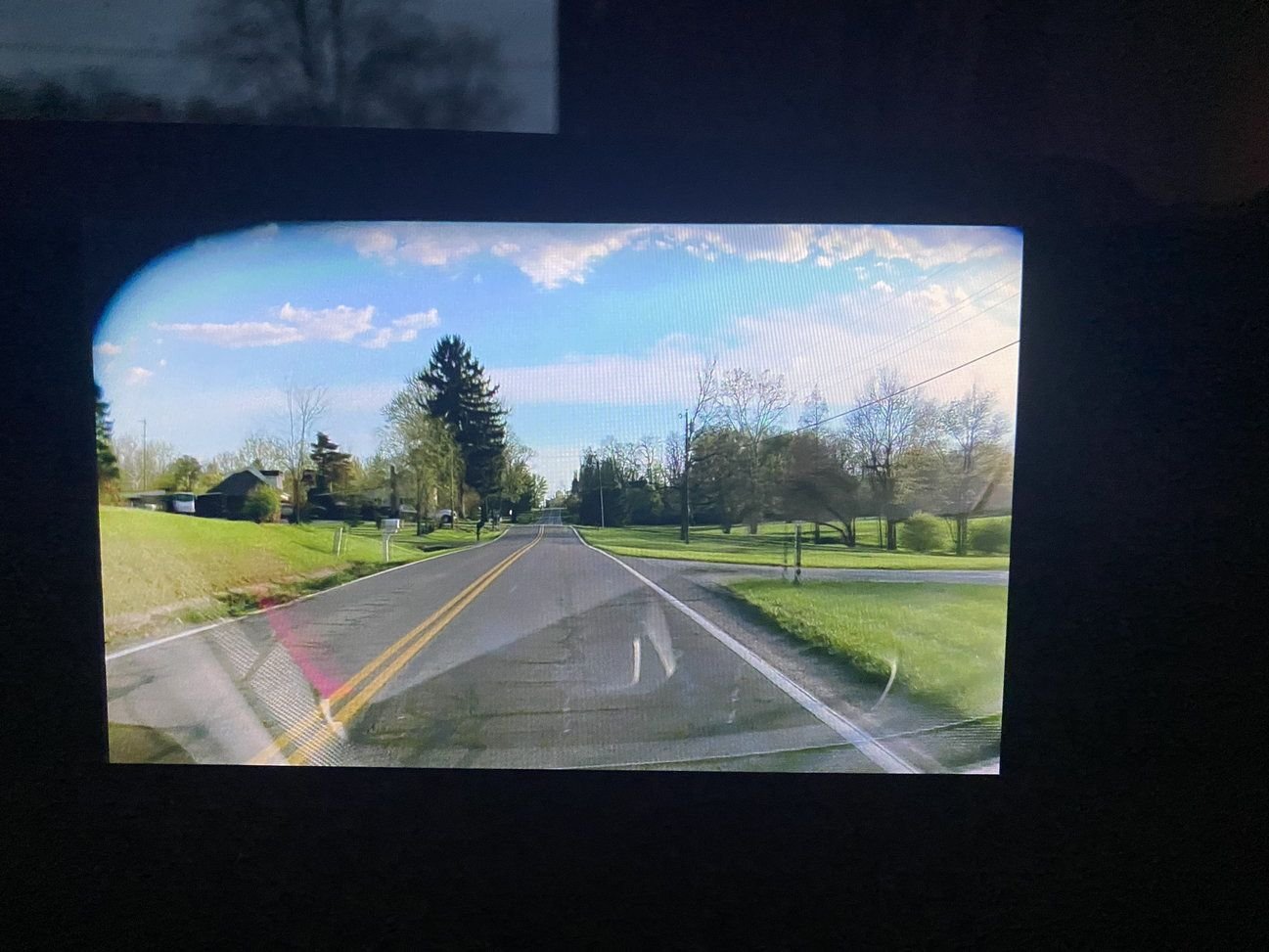

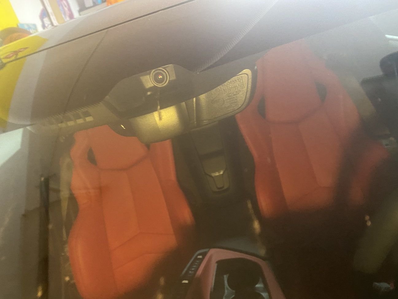

I have PDR shadow in the upper left corner. It’s not obstructed in any way, even went back to view new delivery day and it was there, just didn’t notice. I seem to be only one with this, so maybe a bad lens.
Performance Data Recorder? Is this like a dashcamera?

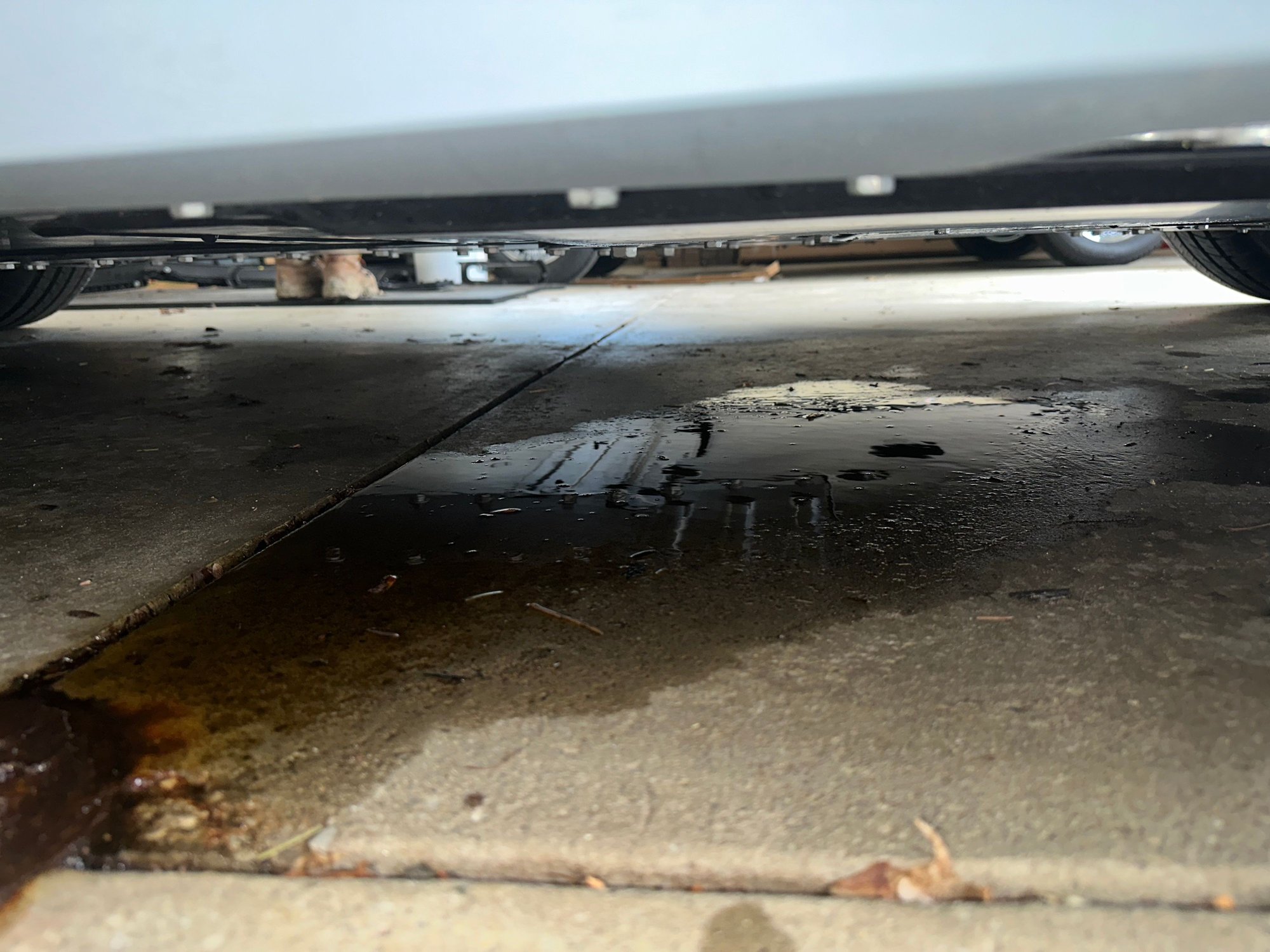

Default 2023 C8 - 90 miles Oil Leak
any ideas of this oil leak 90 miles on the car. Taken out twice for two drives.
This is my third C8 first two had zero issues

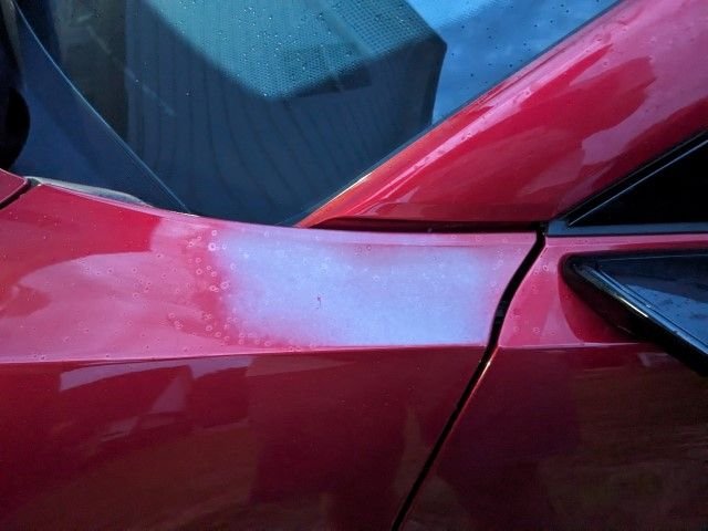

Default Weird paint problem
After the first rain on my '23 Red Mist Coupe, weird white spots started to appear on the front left fender in front of the driver side mirror:
after rain
after rain
with morning dew
Cutting through the puzzlement of various people at the dealership, the paint guy said it looks like they forgot a bit of clear coat. The mid-layer (this is a tint coat) is hygroscopic.
The funny part is that as soon as it dries, it looks almost perfectly normal. Once I know it's there, I can tell the paint is not as bright, but for the ~2 months I had the car before it started raining (including a couple of times I washed it by hand), I had not noticed anything. It takes about 20 minutes of water staying on the paint for it to start looking white and very soft.
The first time I saw it, by the time I drove to the dealer (about 10 miles) it was dry and you could not see anything.
Repainting the fender will be done under warranty, but it's taking a while. I brought the car last Monday June 26th and it's not ready yet, I should have it tomorrow July 5th.. They took the bumper off to remove the fender. Interestingly, the service technician asked me if I had noticed the door did not open all the way. I said no, I am careful not to force anything and I stop as soon as I feel resistance. He pointed out a small scratch on the driver door because one of the screws securing the fender (the one that goes in the green circle in the picture below) was too long and the door was actually stopping against that screw instead of the normal door stop. If I had pushed all the way, I would have caused more damage, but still there was a small scratch on the door which they are fixing as well. I am glad he was thorough. Honestly I can't fault QA for not noticing that a bit of clear coat was missing, but the wrong screw hitting the door is something I would not expect to see by the time the car gets to the customer because you just have to look at it to see it's the wrong screw, and the service technician immediately noticed there was something wrong with the door.
after rain
after rain
with morning dew
that sucks .. thanks for the post…keep us updated and post pics of the finished product🤙😎
