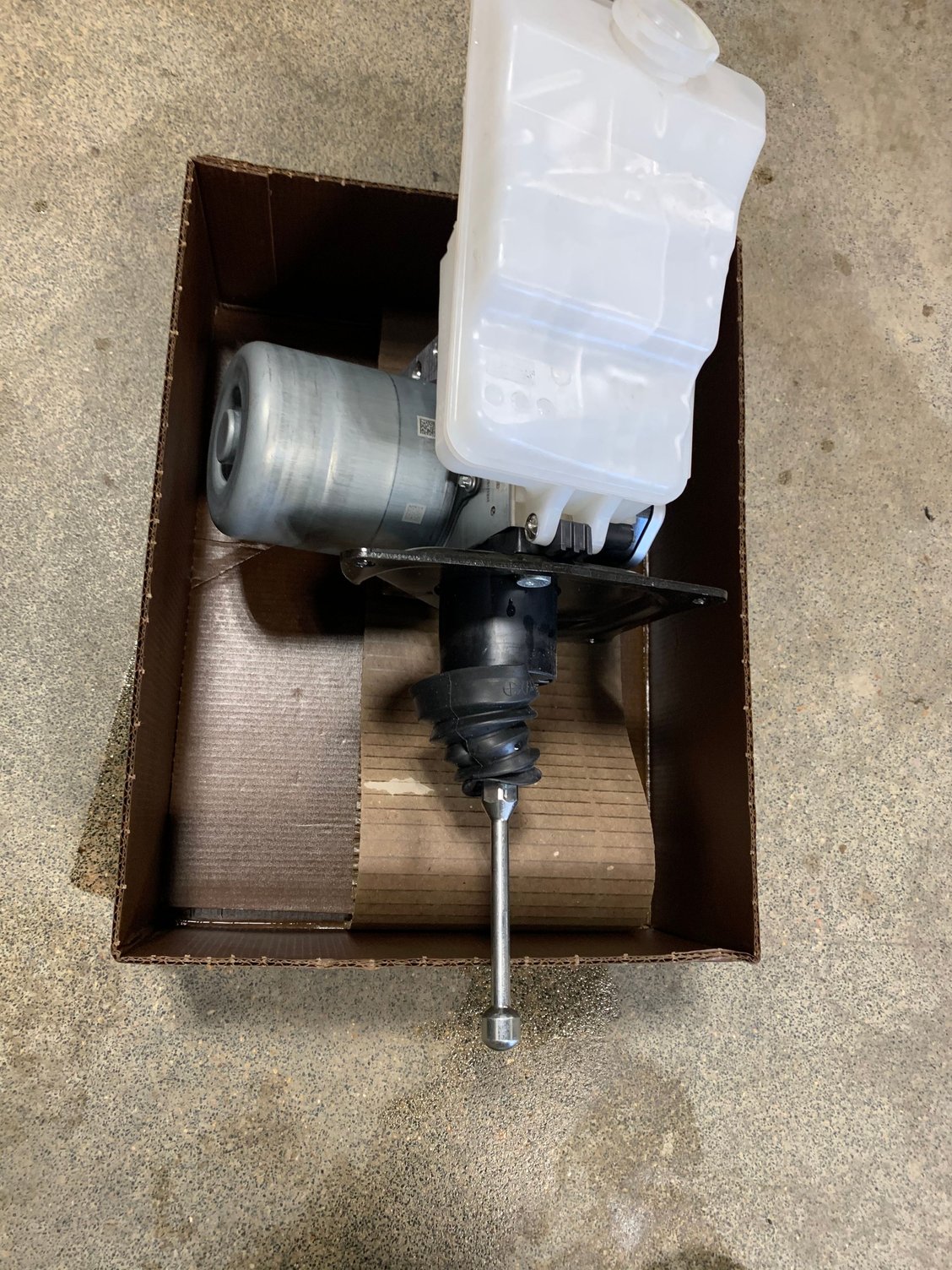

Default I just had my brake update done.
Originally Posted by RapidC84B
@semperfi1946 it was 38 cars in the first 3000 VINs. Stop the bullshit.
They replaced the entire brake booster. Has to wait on new tank as seal isn’t a serviceable item.
