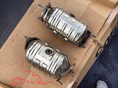

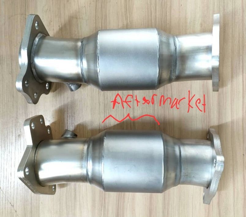

Originally Posted by C7Me
Also, can someone please post a picture of the stock cats? I'd like to see what they look like compared to the 2M ones.
They are around 2" larger in diameter which means ALOT more flow volume than the more inexpensive Gesi and no name options (hjs are 5.75 I believe). This would mean stock volume was approximately .087 ft3 and aftermarket Gesi or 2m about .049 ft3. 44 percent smaller.
In other words you'd have to run a 380cpsi or less sport cat to just equal the flow of a stock cat.
This assumes the length of the cores are the same between stock and aftermarket.
They're not.
Stock...
Aftermarket 1....
So you'd need to calculate that out too.
Note that the above calculations ignore the catalytic core design itself and only speaks to the cell count. There are ceramic cores, metallic cores, spiral wound cores etc as the prices go up.

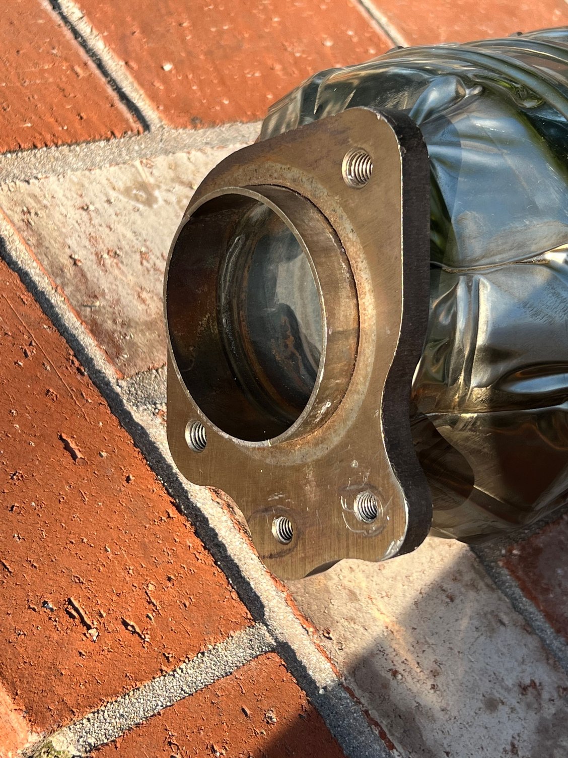

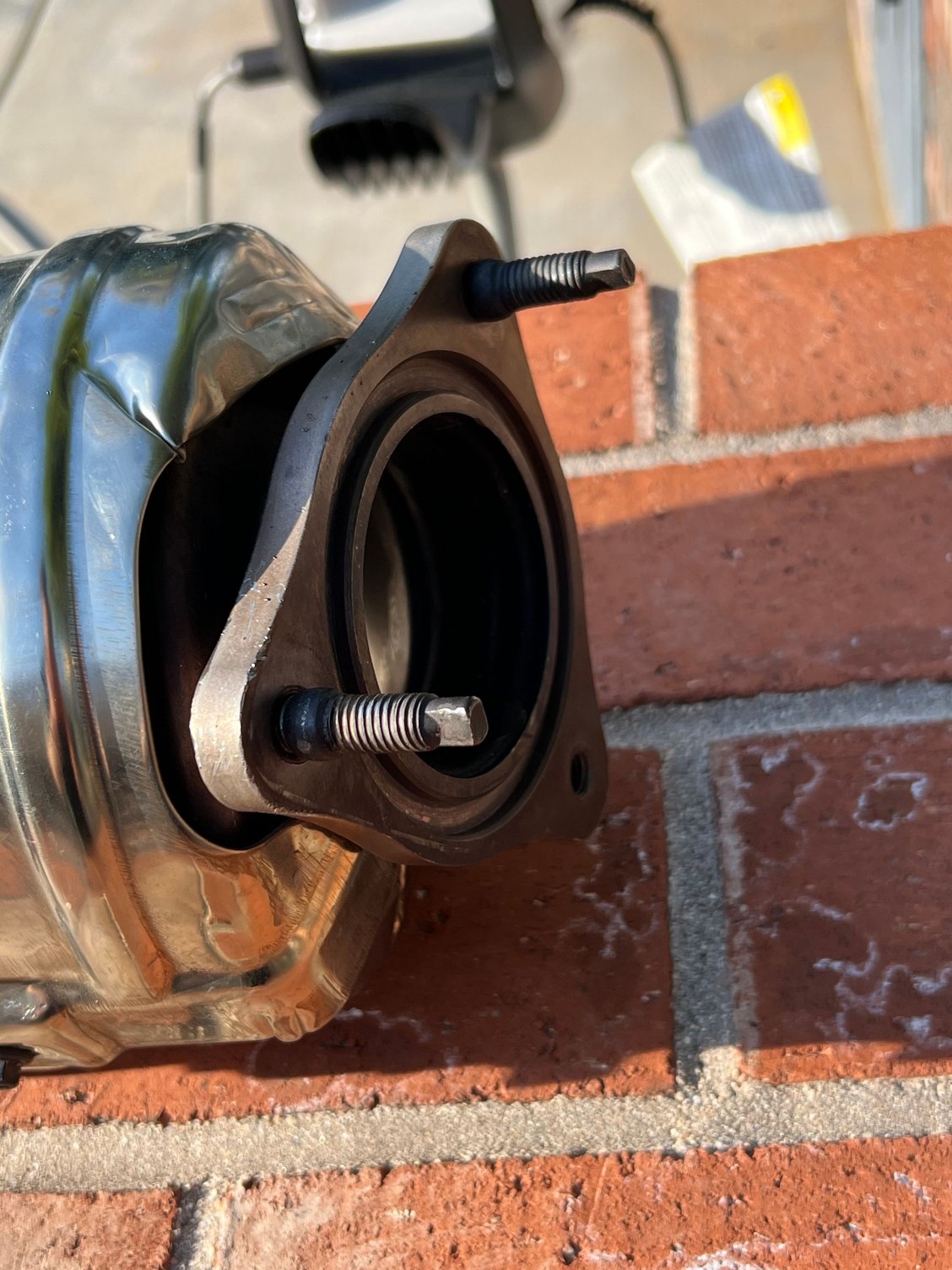

Sorry for thread jacking , does anybody have the OEM cat studs I could buy of them ? I have the pics attached below.
Just need the missing studs
Same with these ones.

I actually might... Will check my toolbox today. I know I removed mine prior to shipping but can't recall if I saved them or tossed in the trash. I know at least one of mine was bent though.
*Edit*
I have 1 stud and all the bolts.
