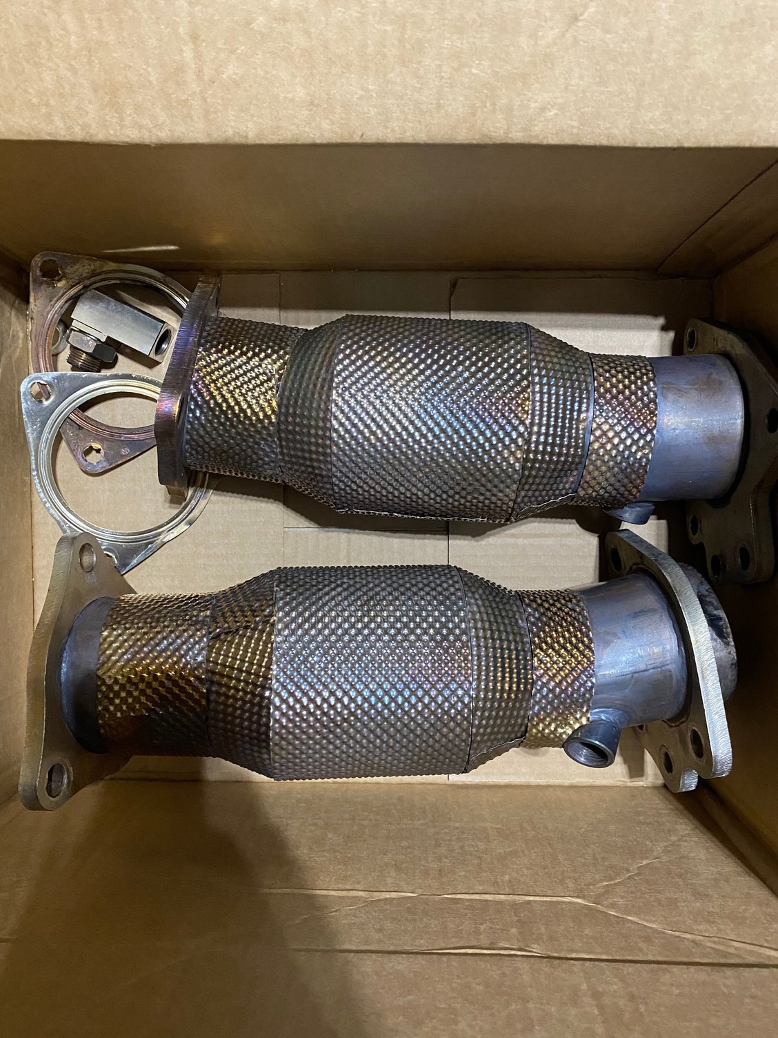

I bought some used 2M sport cats from someone on here, but it didn't have the nuts/bolts/washers included. Can someone please tell me how many and what size nuts/bolts/washers I will need to complete the install. Thanks in advance!

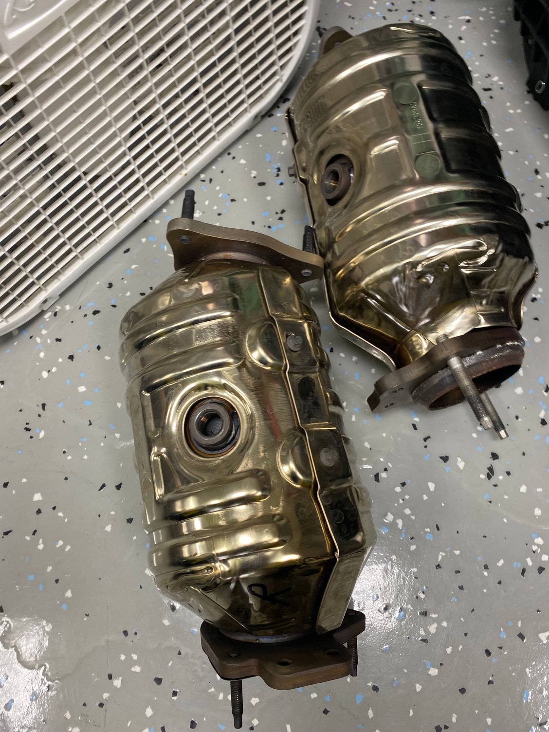

Also, can someone please post a picture of the stock cats? I'd like to see what they look like compared to the 2M ones.

Old Mar 29, 2023 | 12:44 PM

After looking at the 2M sport cats on their website, they look smooth on the outside. I received these with the honeycomb pattern on them. They don’t look like the 2M ones. Did I get scammed??
