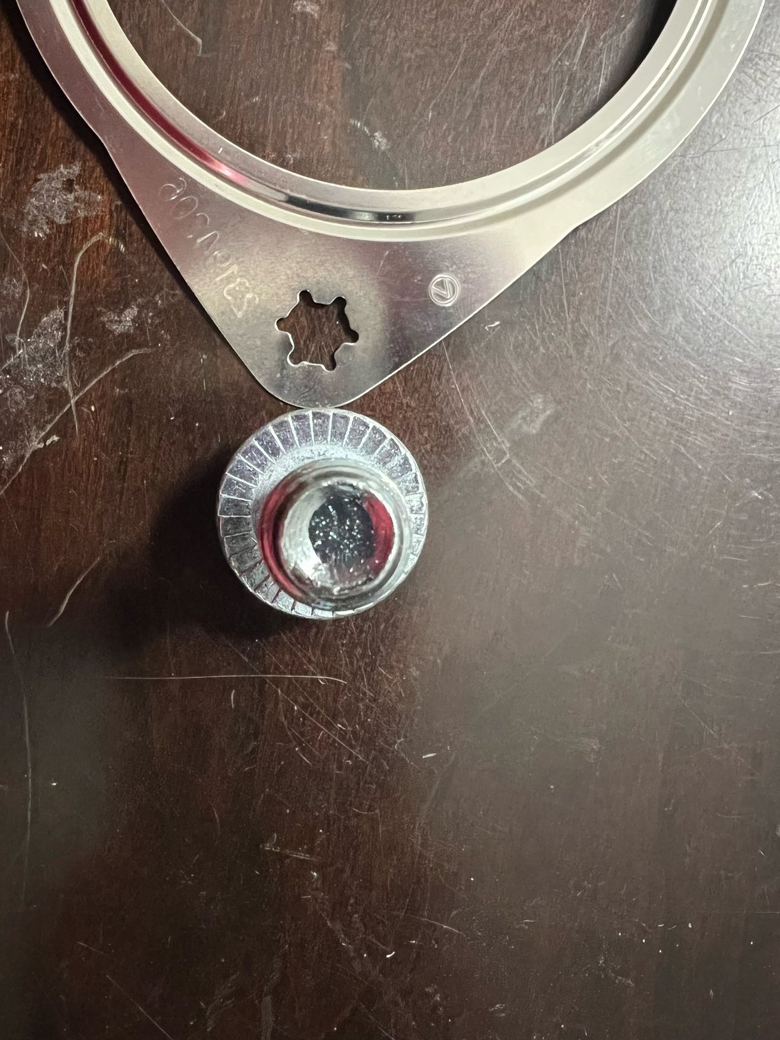

Those are the gasket i ordered triangle style gaskets part # 23194206. Now I did order the headers and cats and they came with 1/2 bolts for the collectors.
Picture showing the gasket bolt hole that will need to be open up or use a smaller bolt.
Thank you sir. That is exactly what I needed to see. So, do I need three of these for the cat delete pipes? Do I use my existing gasket for the fourth?
yes, 3 for the install and reuse the driver side rear donut style. I’m going to buy this in a 1/2 or 5/16 to try and open up the bolt holes.

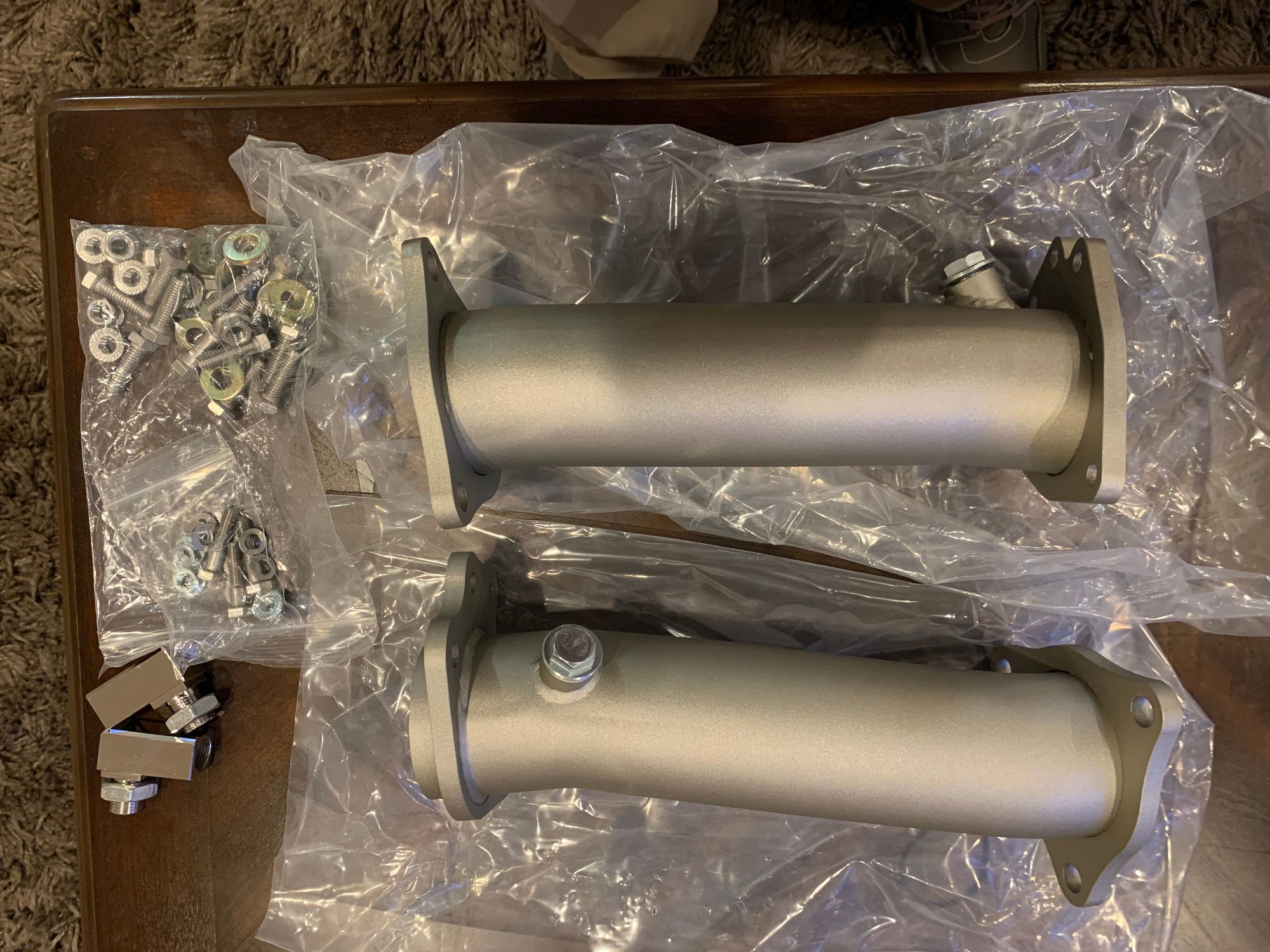

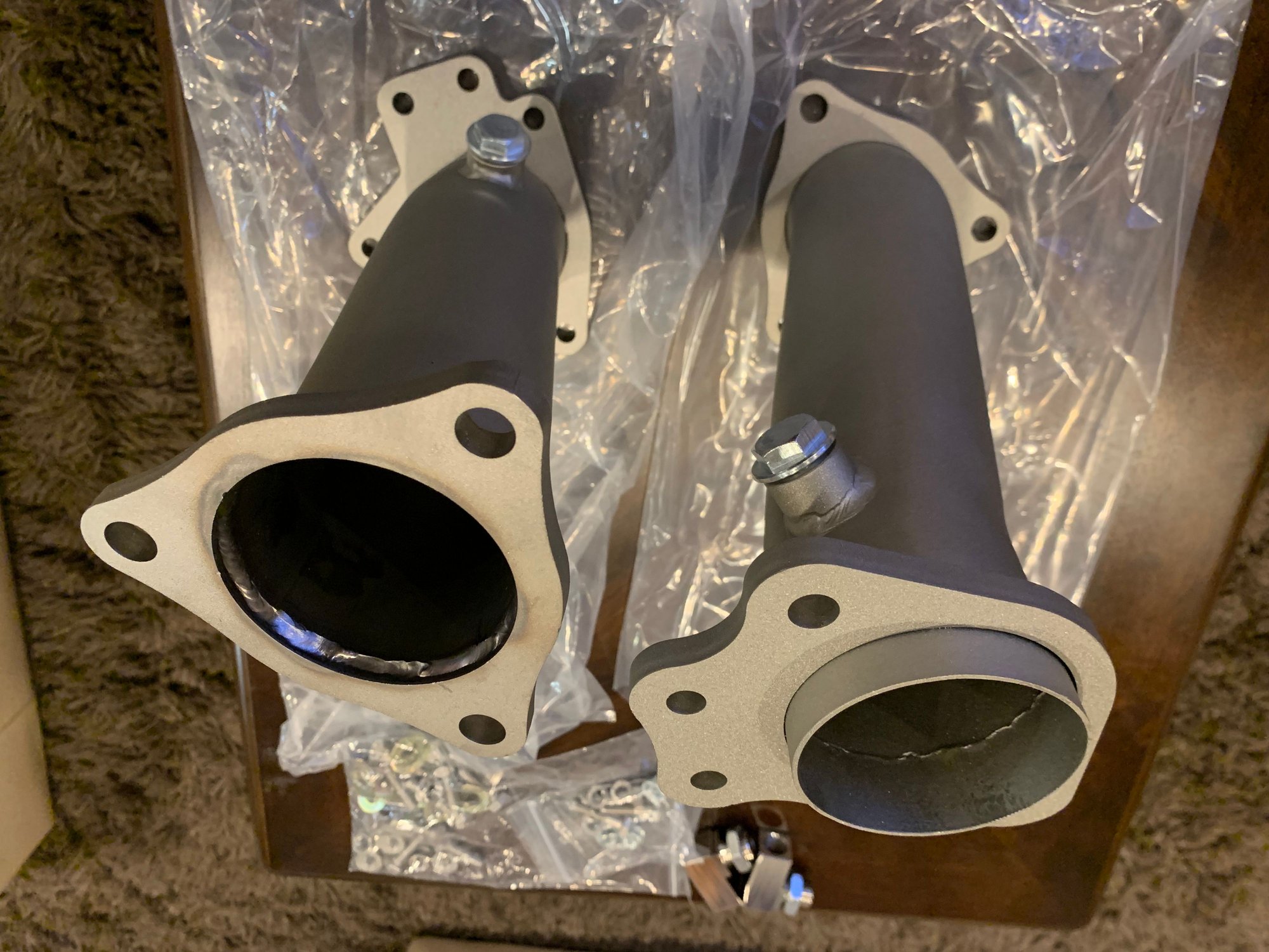

i ordered Sunday night. They arrived today, Wednesday! Of course they are right here in Cali, but wow! Lots of bolts, nuts, O2 sensor extenders, but no instructions. Quality is great!
I’m auto crossing the C3 this weekend, so it’s my next weekend project. I have a HTC and I watched a few you tube videos. I think I’ll remove the rear bumper, again, and the rear trunk lid. Then put the car on my two post lift, and try to do this without removing the air box. I’ll take pictures.

They are in. A very difficult pita install. The rear bumper has to come off. The airbox has to come out, the header heat shields have to come out. I tried. Took me about 20 hours over three days. Hire a professional if you can afford it. You need a strong magnet and will have to remove the lower tray. Many screws and tools will fall into the engine compartment. You also need very skinny fingers capable of 30 ft lb torque.
But........It sure as hell is worth it. The sound is awesome. WOT and Redline are amazing,........ in tour mode. Z mode is hairy as hell. This is the way a mid engine exotic car should sound. My only complaint is the very conservative 6500 rpm redline. I take my 427s to 7000rpm regularly. I'm manually shifting more just to hear the shifts at higher rpms, and the downshifts.
MakeErLoud's videos were very helpful because I have a HTC. NO CEL so far.
