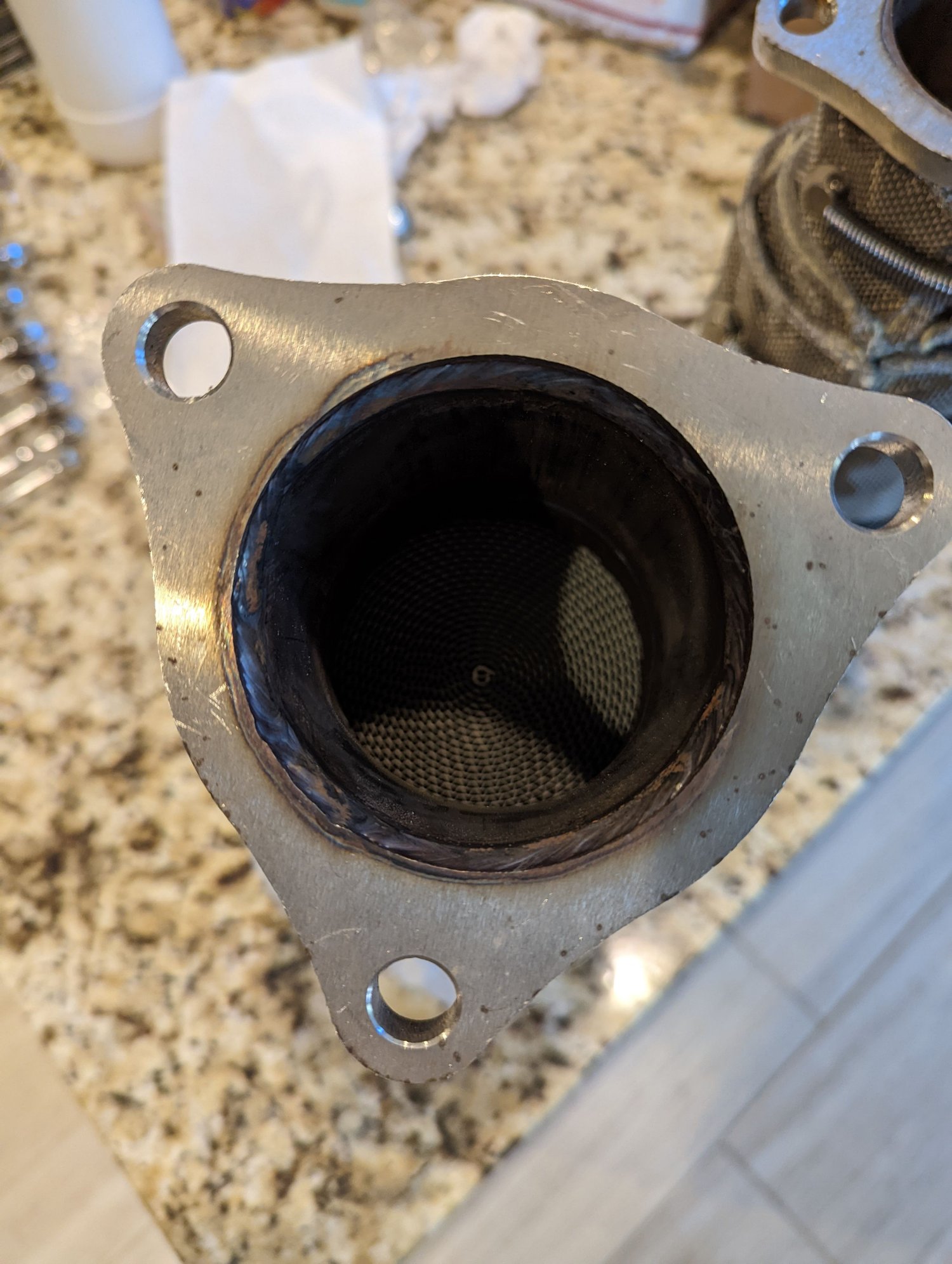

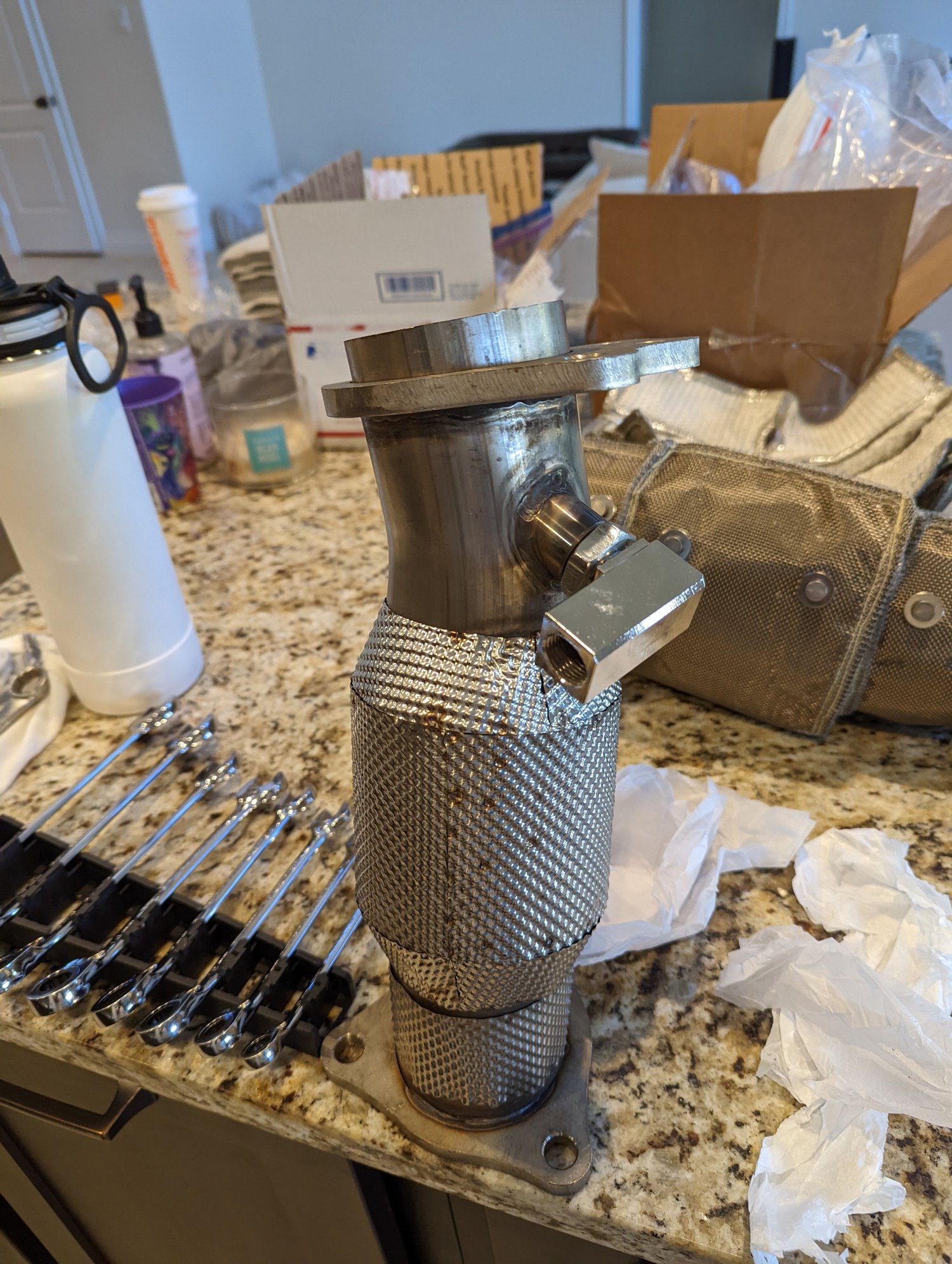

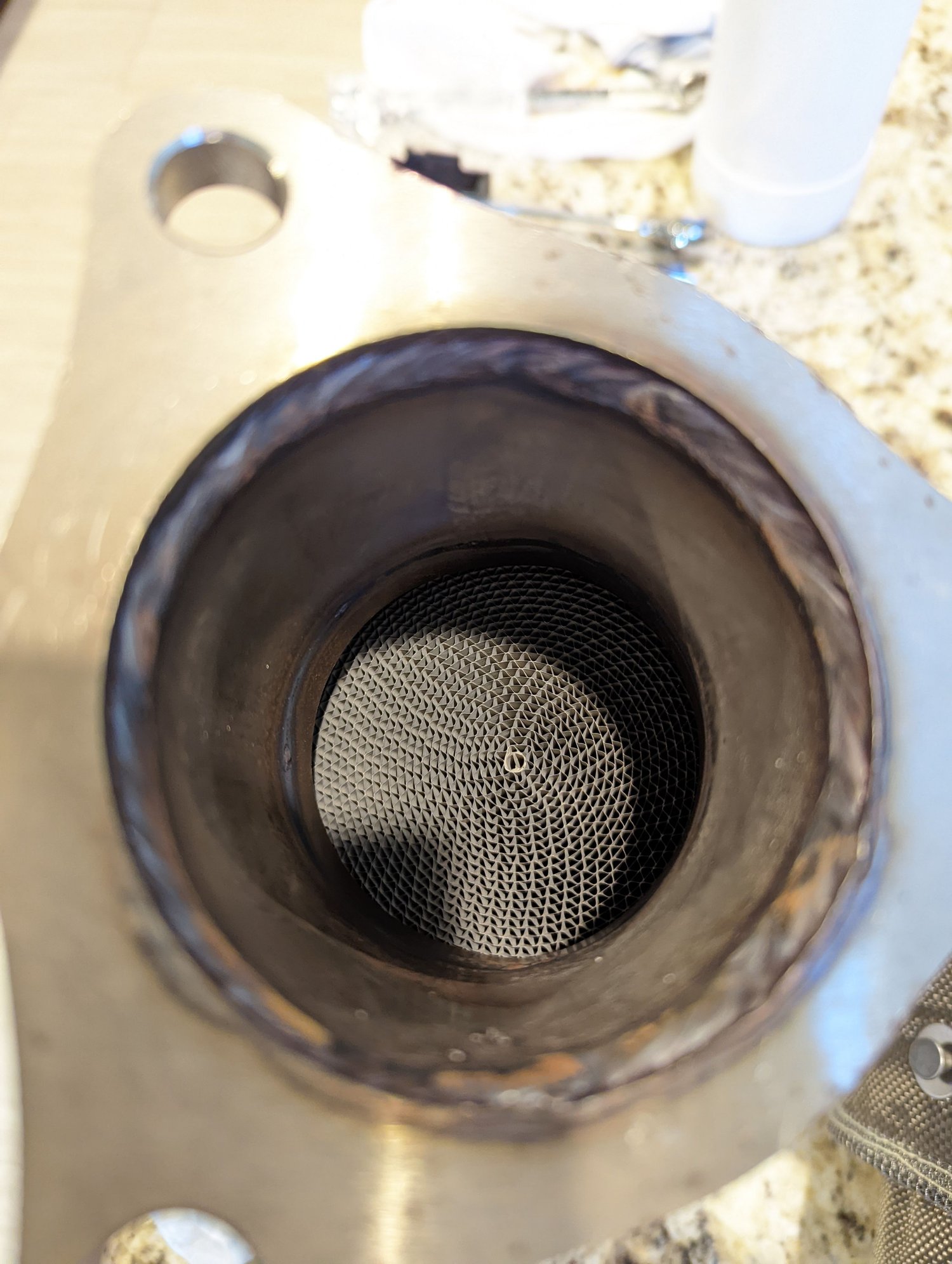

Got my 2M fabrication sports cats in the mail today. Packaging sucked but the box did make it in one piece somehow so that's good. It looks like they've added a heat shield that's spot welded to the cat which was a nice surprise. Not entirely sure if the kevlar sleeves are needed anymore. Unfortunately if anyone was thinking of getting them ceramic coated you're out for luck. The nicest part of these cats is the sleeves to be honest. The welds are all pretty sloppy and the finish leaves alot to be desired. The flanges are not smooth like they are in the pics on their site. They did include the O2 extenders and all the hardware required. For less than half the price of the competition I'm pretty happy with the quality. Other than smoothness of the mating surfaces, and the extra heat shielding, everything quality wise matches up with the website pics. Hoping to pick up the car tomorrow where it will go to get ppf put on. Will try to install these next week but I have family visiting so that might be tough. I'll keep this thread updated as I go. My biggest issue might be that I ordered replacement gaskets that might not fit. The welds on corsa cat flanges are way nicer than these. I'll find out soon enough. Also, I've got tons of kevlar fibers on my hands now. Should of worn gloves. 😟

You wouldn't happen to have any pics of the gaskets?

Looks like pretty decent heat shielding for free. Wonder how that is attached though?
it looks like they had a bunch of spot welds all around. One of the welds was already loose out of the box probably from getting beat up during shipping though. They stuffed those things in a box that was way too small for them with no protection whatsoever.
I wish I did, sorry I don’t.

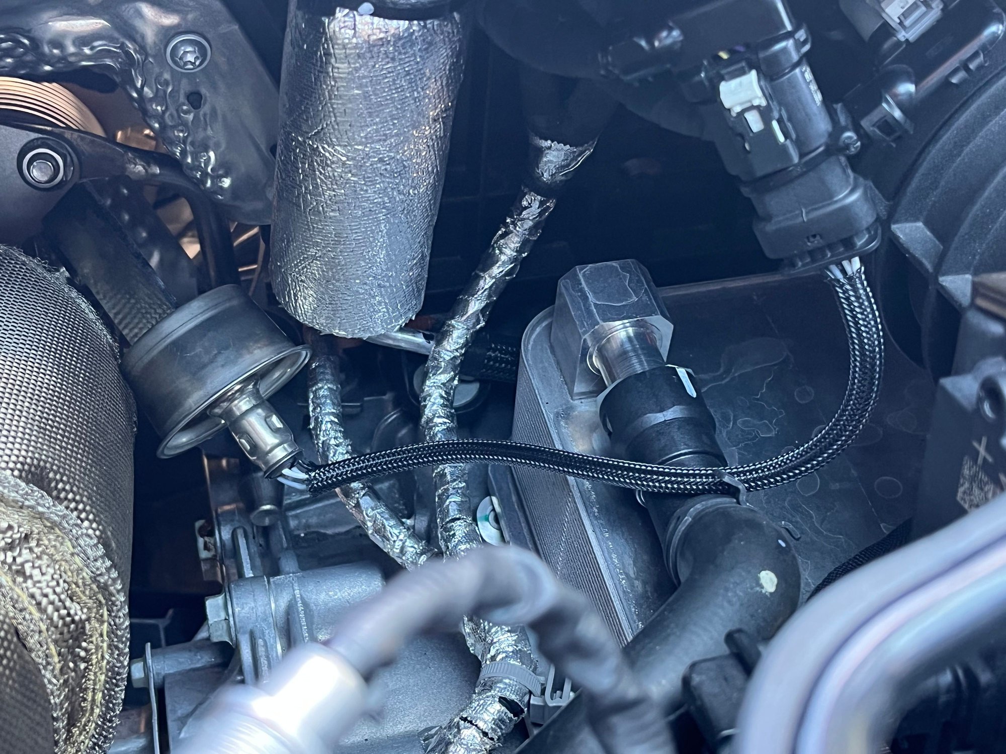

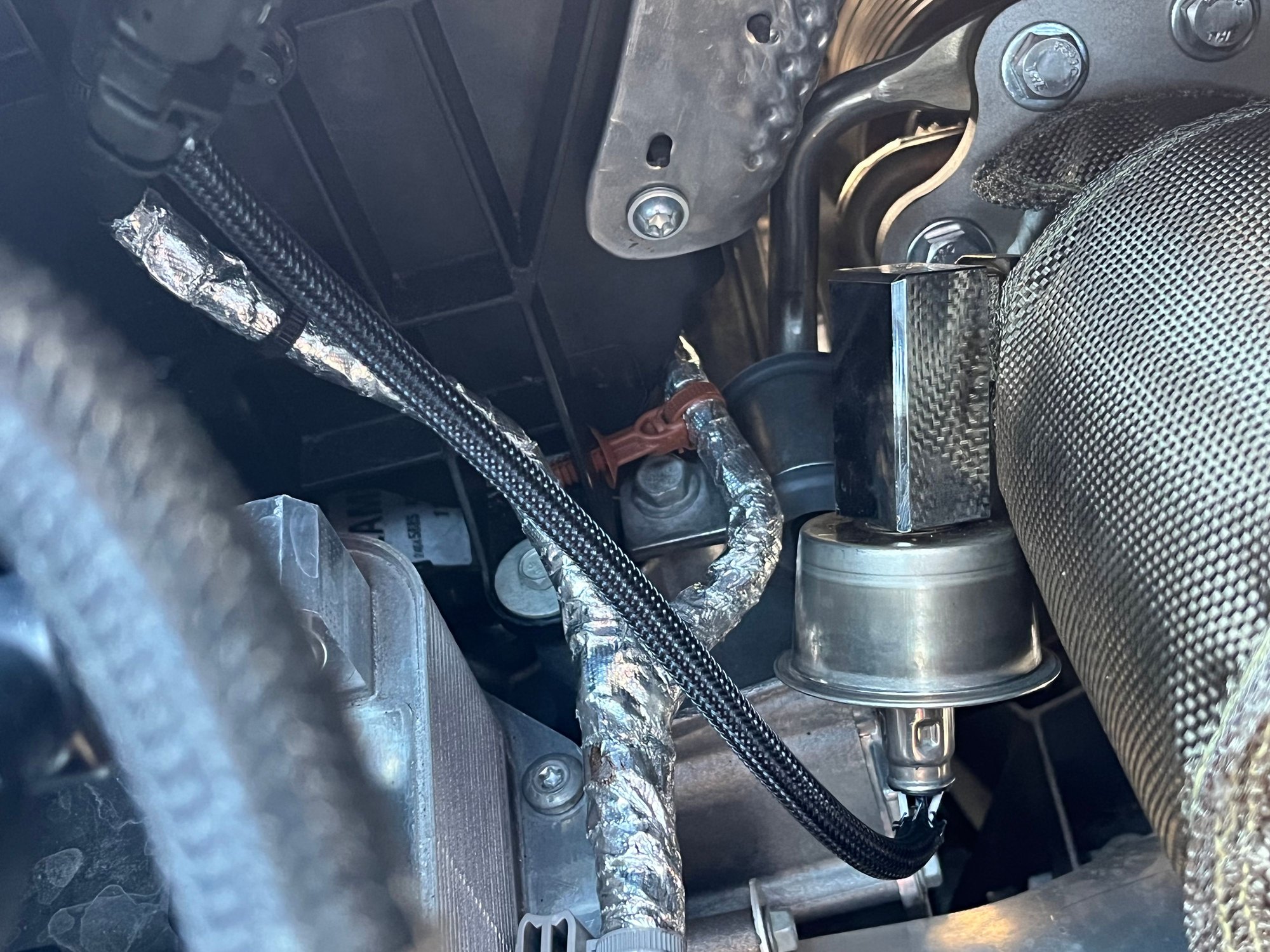

Doesn’t look like it, but here are pictures of both sides just in case.

Your issue is with the right side o2 sensor that's plugged into the extender. Is plugged in fully on the harness side? Is in on tightly? The wire looks good. It's not getting the proper reading so you're getting the fault code. Pretty sure the trim fault code is because of the O2 sensor fault.
Right side as in passenger side right? I’ll unplug and plug it back in.
