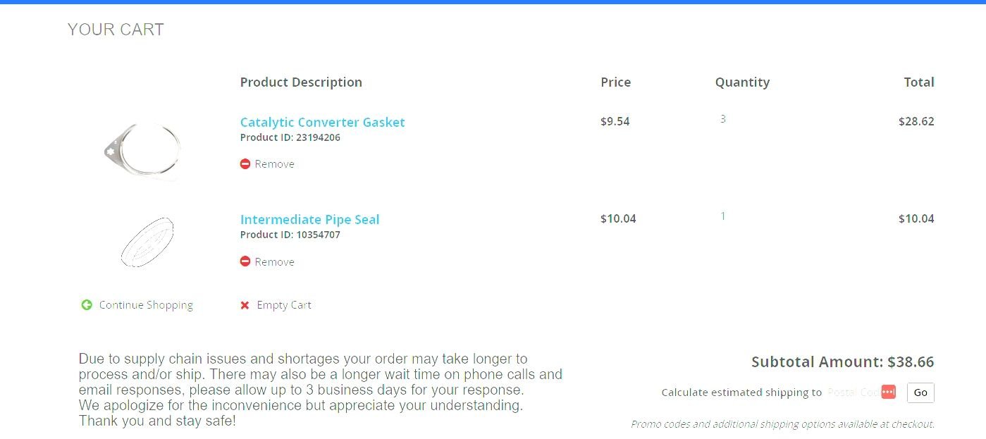

I read the post about gaskets and rings for the bypass pipes. It's still unclear how many triangle and ring gaskets I need to purchase for the 2M 200 cel cats. I will be having a shop doing this and want to make sure I provide them with all parts required so things don't get delayed. Also, any recommendations on less expensive blankets than 2M's $270 set? WTF are blankets so expensive? While the cats may have precious metal, the blankets don't! I know many are running without blankets, if I can score some cheap, I'll use them to hide the ugly *** cat shielding these ship with now.
Dont feel bad, I made a thread about such about a month ago as it was unclear to me too. Replies were.................................... . I still dont know exact answer, lol.

You need 3 triangle and 1 donut. And for heat shielding just use exhaust wrap/tape. That’s what I used and haven’t had any issues.
Happen to have the needed GM part numbers?
I reused my donut.
here is the link to the triangle gaskets.
also you will need
(12) M10x40mm Stainless Bolts
(12) M10 Washers
(12) M10 Lock Washers
just do yourself a favor and go to ace hardware and get them now lol

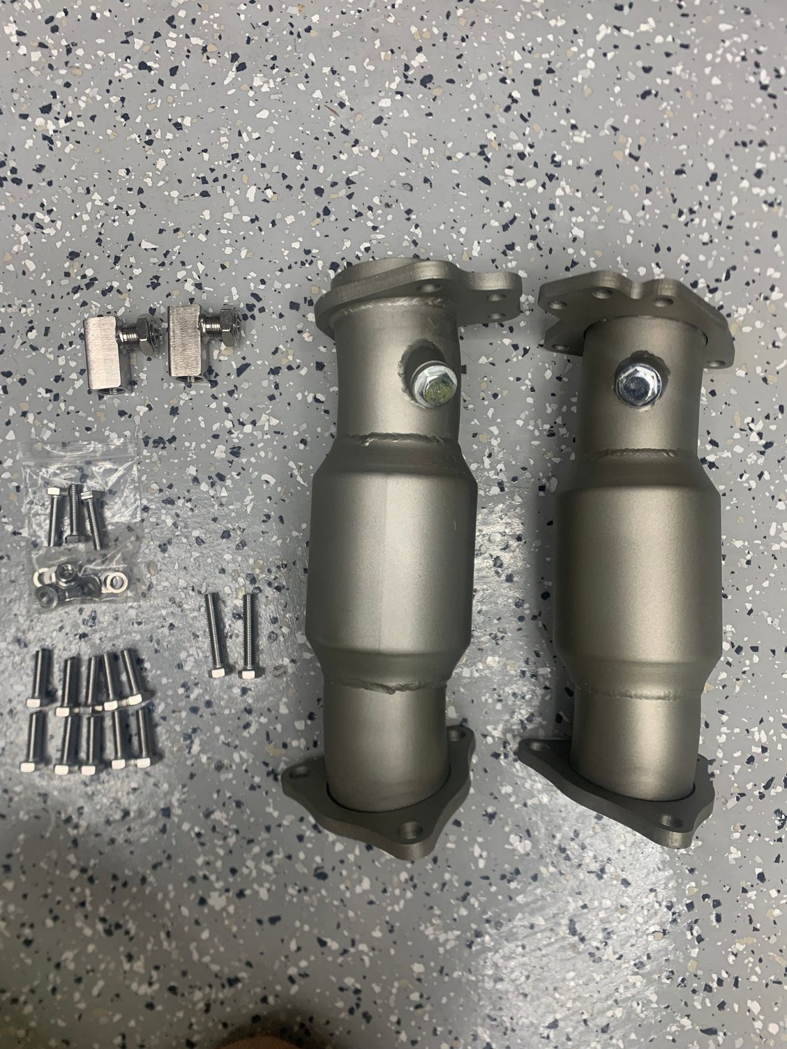

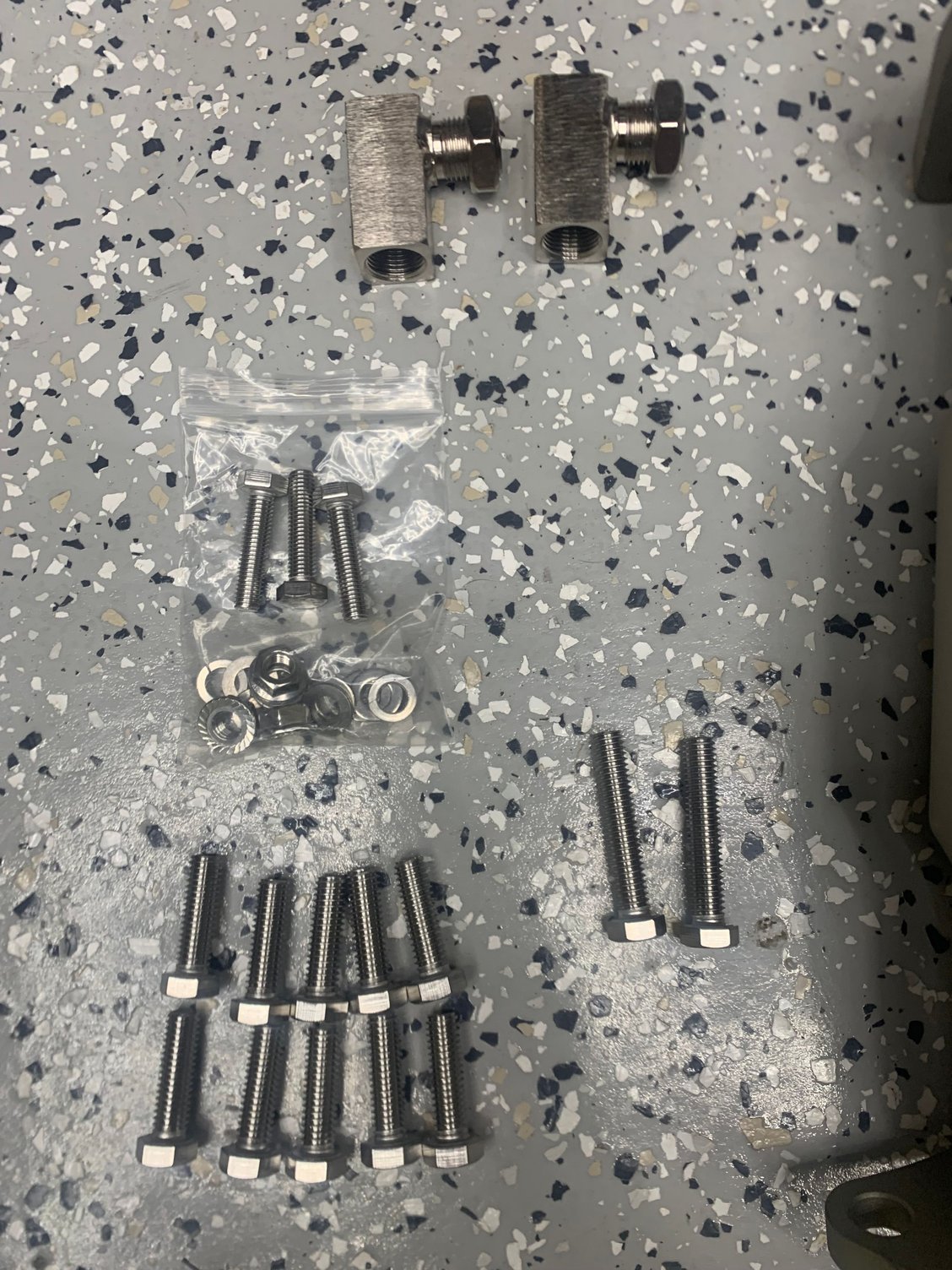

Righto - I’m in Australia and about to do this so we don’t have many shops capable of C8 work yet.. and if we do they are hours away..
I have a few questions…
They supply 15 bolts.. (2 long, 10 shorter and 3 in a separate pack that’s smaller and slightly thinner than the rest)
Who can help me out with placement of these bolts as in which go where?
I’ve read on a few forums ppl changing all the bolts for longer ones.. Worth doing?
Also do the supplied o2 spacers work on a coupe well? Or should I grab the mini cat spacers instead?
Cheers 🍻
Cheers 🍻
Do yourself a favor and get better hardware, the stuff they supply is trash. The nuts are likely fine but I would replace the bolts with flange heads so that you do not need to use a seperate ill fitting washer. The same hardware came with my Cat Delete pipes. Also, put anti seize on the bolts, those stainless bolts will gall if you do not.
