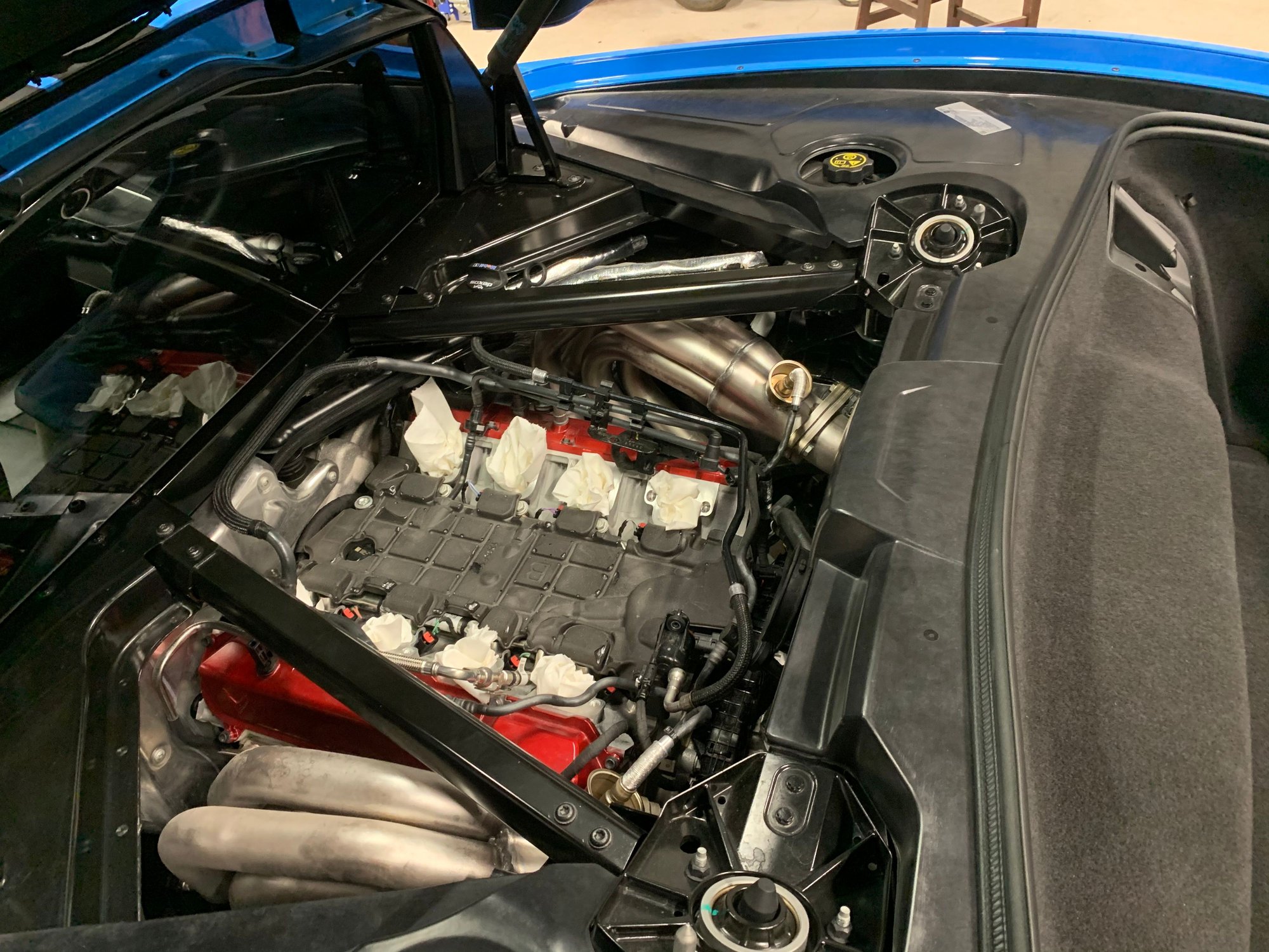

Finally put my video together... here's the headers / sport cats installed. I didn't rev with stock... realized later I should have. I think I was about to start the install and didn't want to heat everything up too much!
It really does sound great when driving, pops sound great when under throttle and shifting!
Like it's been said before I had CEL which is very disappointing. I bought 45 degree angle spacers for $40 (with "catalysts") instead of $65 from 2M. I think they fit better than the the 2M ones since they are 45 degrees. These are about $20-40 all over online (amazon, ebay, etc. Pretty sure they are all identical).
What they looked like when they arrived:
I took them apart to see how they all fit together (Everything is just screwed together).
What they look like installed. O2 Cables have plenty of space to wiggle around, I think the heat is "far enough away". I would have preferred to wrap them to some degree to ensure heat stays where it's supposed to but I don't think it matters at all.

That's awesome, let us know if that solved the CEL issue.

I've driven it probably 100-150 miles since I added the spacers and no issues yet. Still frustrated I had to install them with the cats...but that's life. I question if there was a bad batch of cats or if they started using cheaper ones after the first batch came out.
