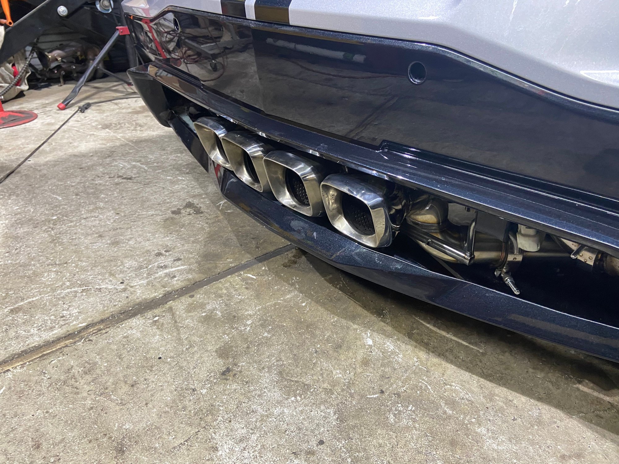

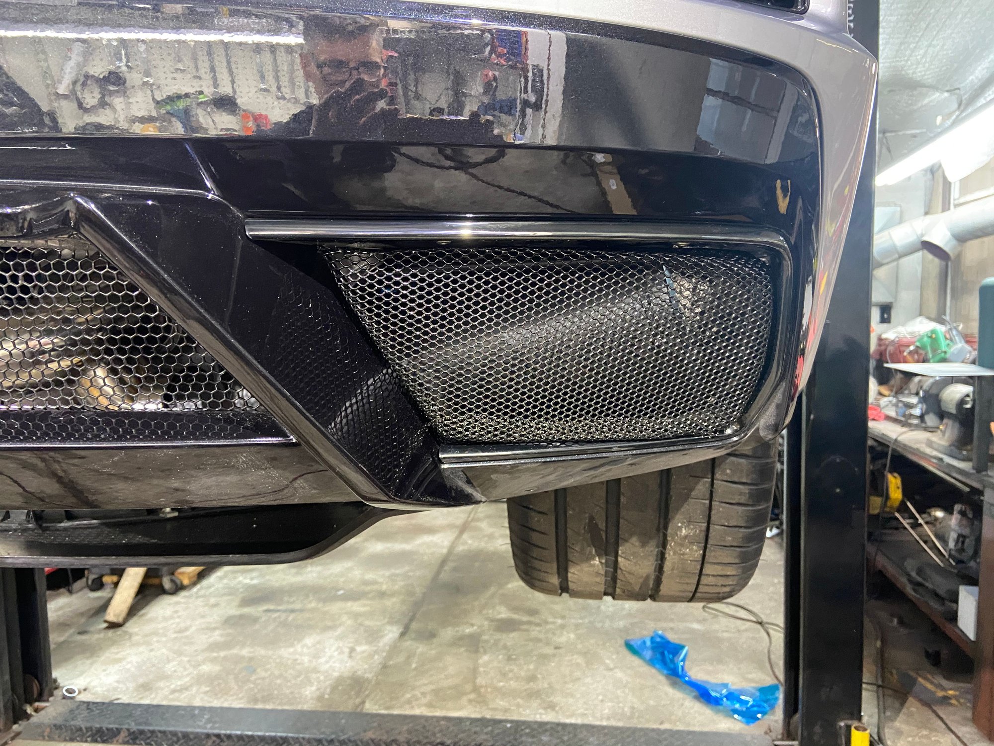

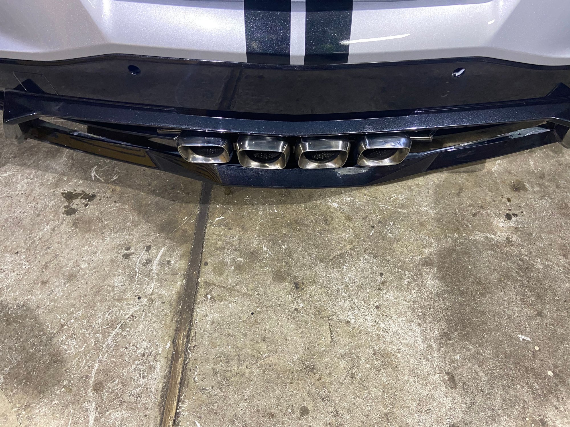

I always wrapped my converters. Never had one die early. But then again I do not keep my cars long. Here is a picture of my American racing headers . I wrapped them with the titanium lava wrap. From Amazon.
I also had my headers cats and mufflers and mid pipes jet coated. Then I wrapped them. I know it’s a little over kill. But you need to keep the engine compartment cool as possible.
This is a one off exhaust with 2 mufflers and it’s center exit. Like c5-6&7.
This is the left muffler. It’s jet coated black
This is the right side. The black muffler is behind the screen.
Awesome, how much wrap did that take? Looks like 2" width.

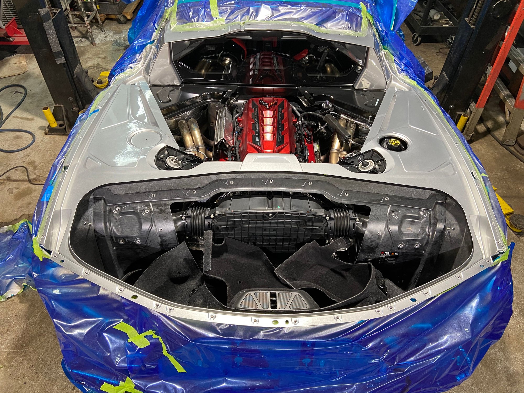

So....Can we get a shot from the rear with the center exit exhaust and a pic of the engine compartment? Thanks in advance-just planning ahead...!!

It’s not done yet. I removed the square tips. And replaced them with borla tips Naturally I had to modify the rear diffuser to except the center exit exhaust. So it’s now being made into carbon fiber. After I get it back I will post some finished pics with a video.

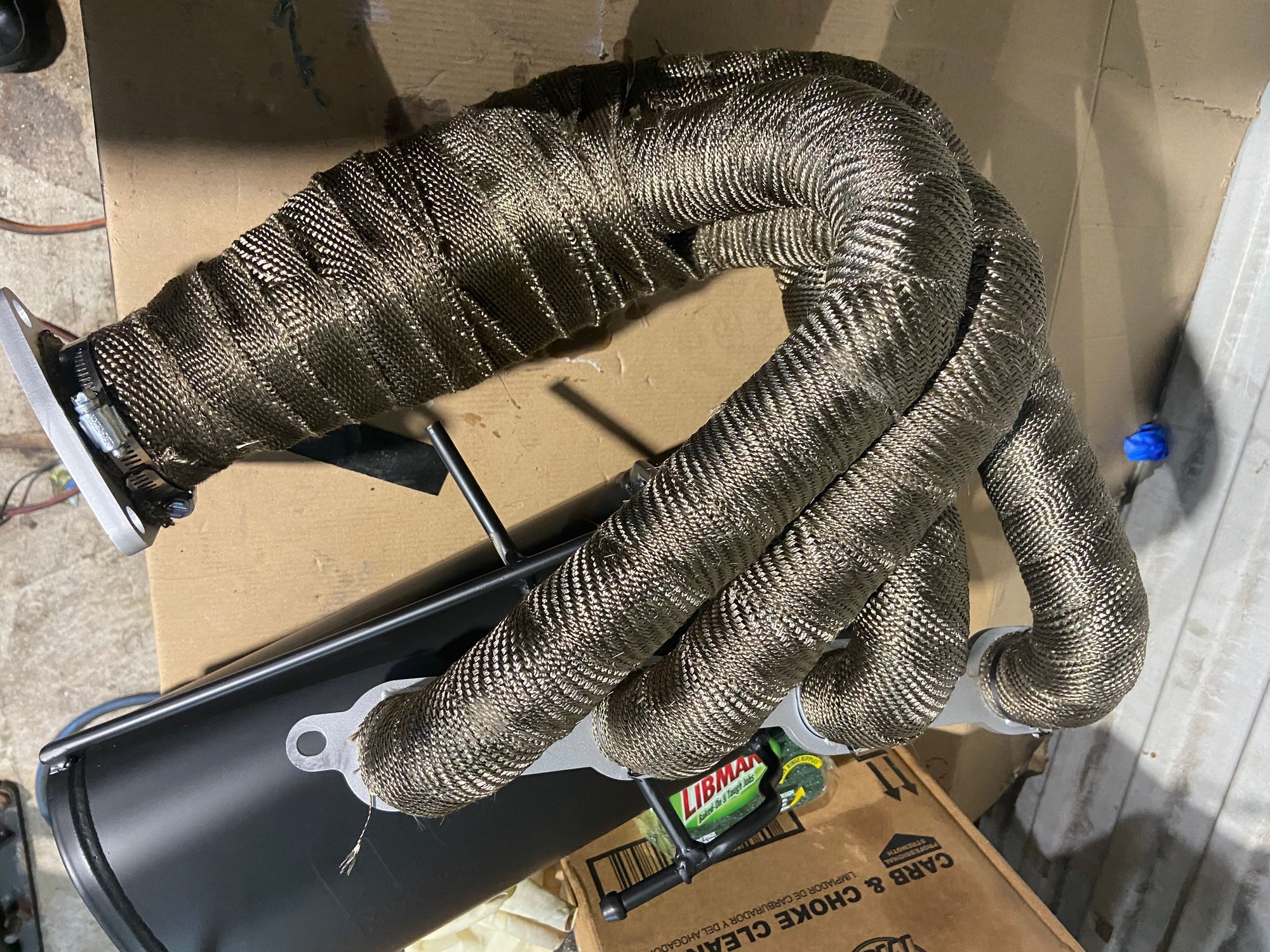

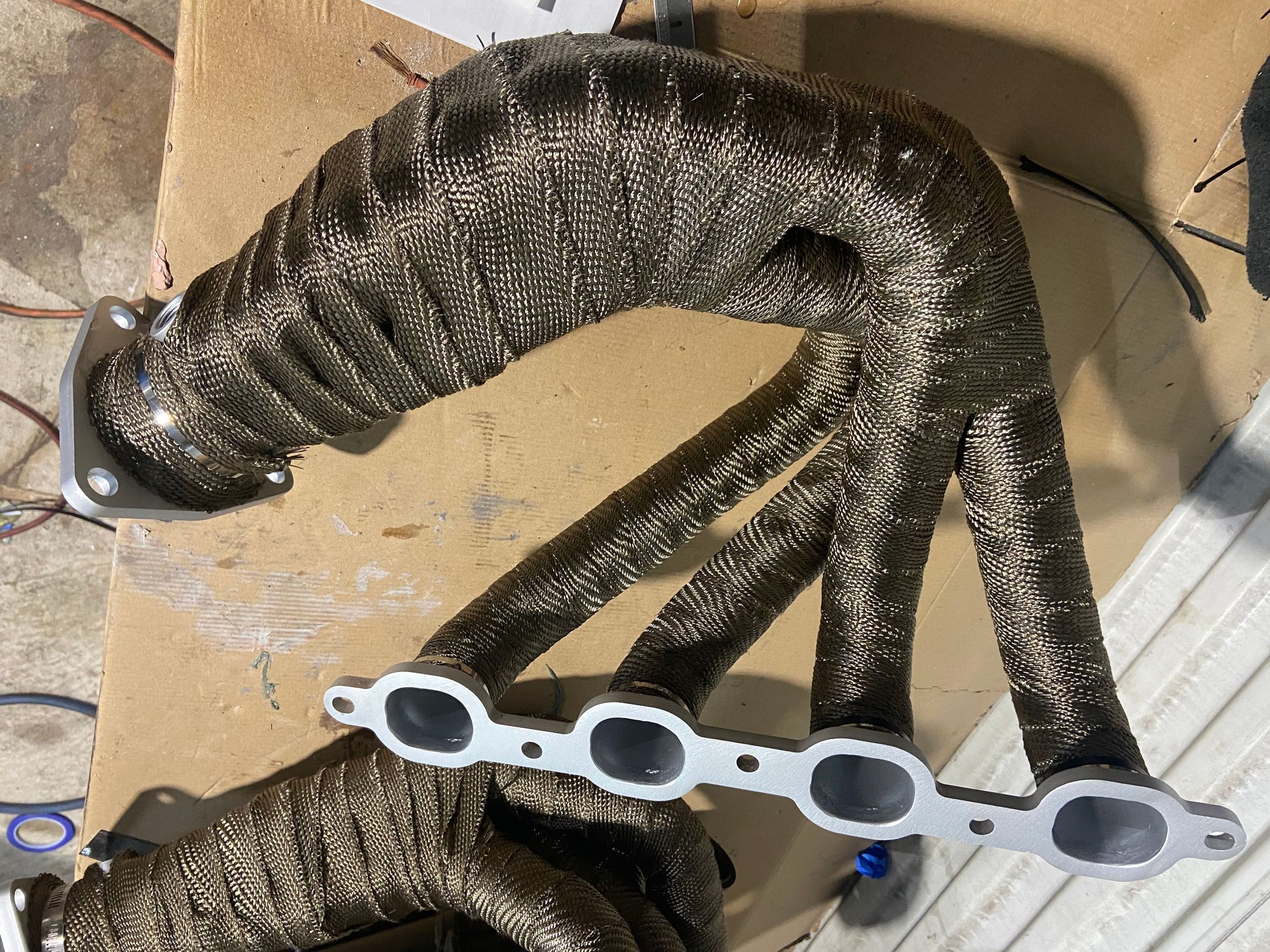

They arrived on friday and I got it all wrapped on Friday/Sat (used 3x 2"x50' rolls) then removed the old ones on Sat afternoon/evening and installed them on Sunday morning. Sounds great, no idea on performance. Took them for more of a drive today and they sound great. I tried to get a video of the popping with a gopro and it was all wind noise.
