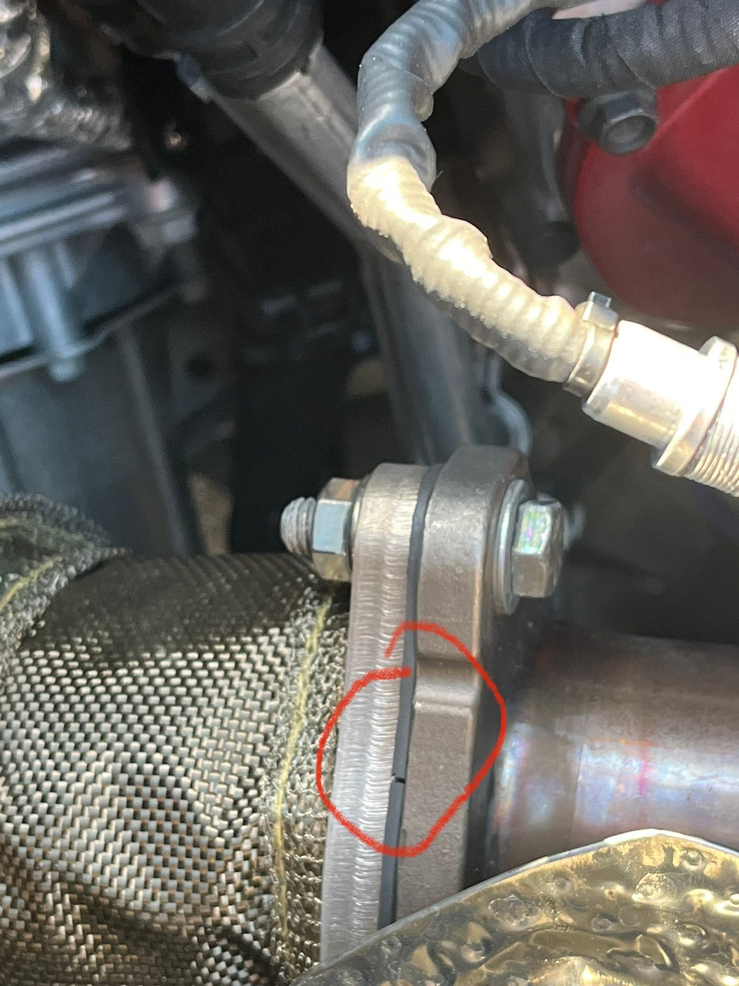

There's an exhaust leak! Just a gasket failure, easy fix, hopefully, the shop won't have to take the whole thing apart, and can be done relatively easily. If you're purchasing these Cats, I'd advise purchasing the gaskets separately! I feel the air escaping when I hover my finger over the crack.
Did the installer make that gasket? That doesn't look like a manufactured gasket to me.
That was the gasket provided by 2M. Upon further investigation, it seems like most people purchase gaskets separately because of its quality.
