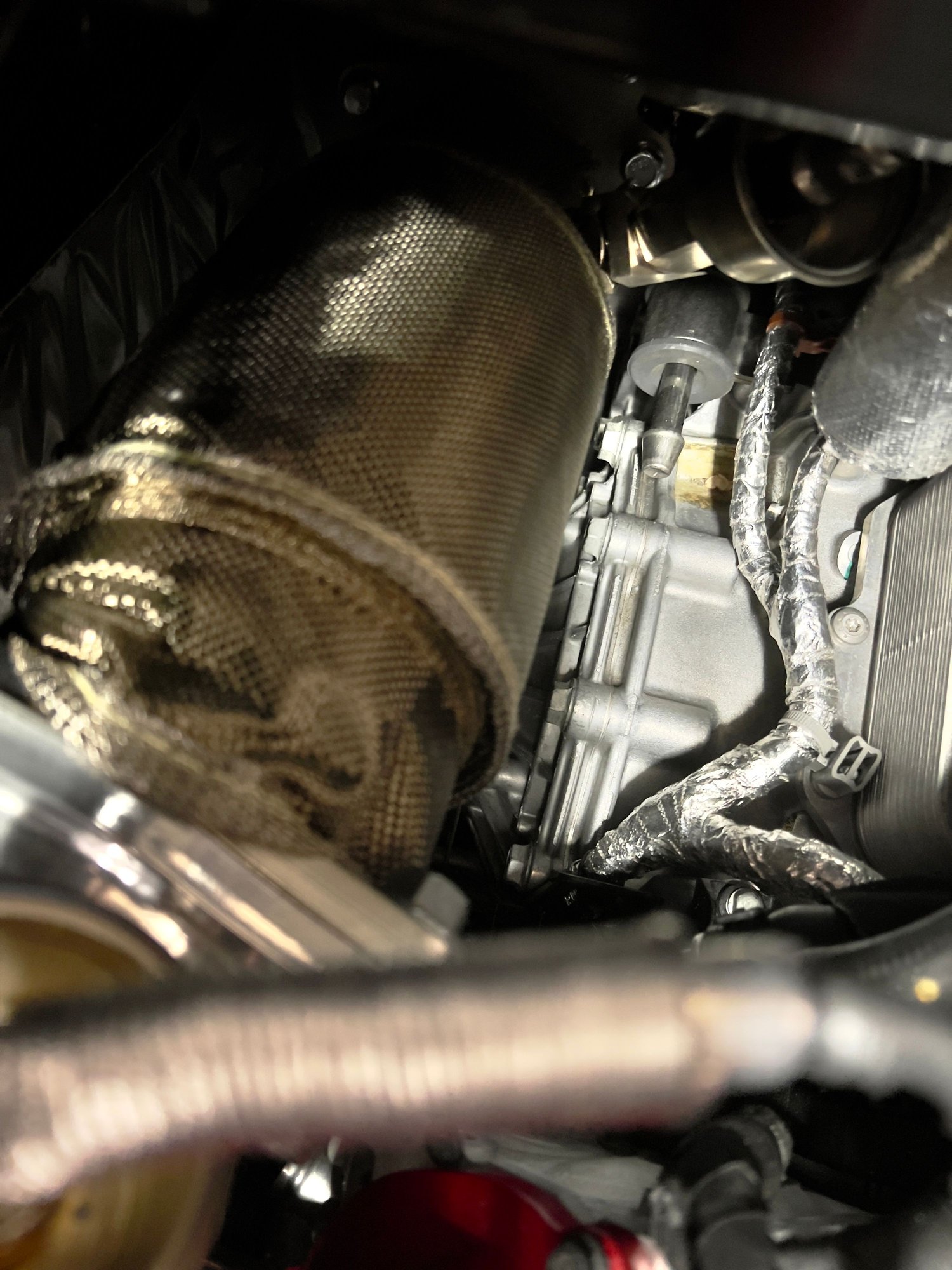

Ive had the cats for six months hanging out in my office waiting for me to install them. I was dreading doing the work and I'll say I was hating it all the way through during the install. Took me about 11 hours in 1 day and ended up with bruises on my forearms because of the those freaking exhaust heat shield bolts. The cat bolts were so tight that I thought I was going to break a 1/2" extension at one point. Ive done extensive work on cars and this job was up there in the this sucks category. Start up after job completion was totally worth it though. I'm never doing that job again. 🤣
I will say taking the trunk lid off helped alot. I just marked the hinge positions with chalk before removing the bolts. Worked perfect and super easy to wipe off after the job was done.

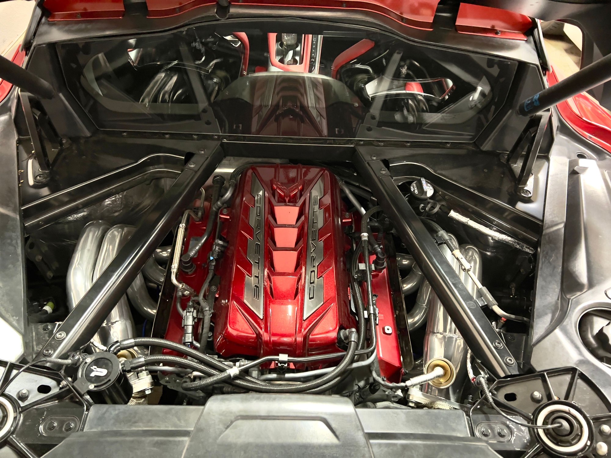

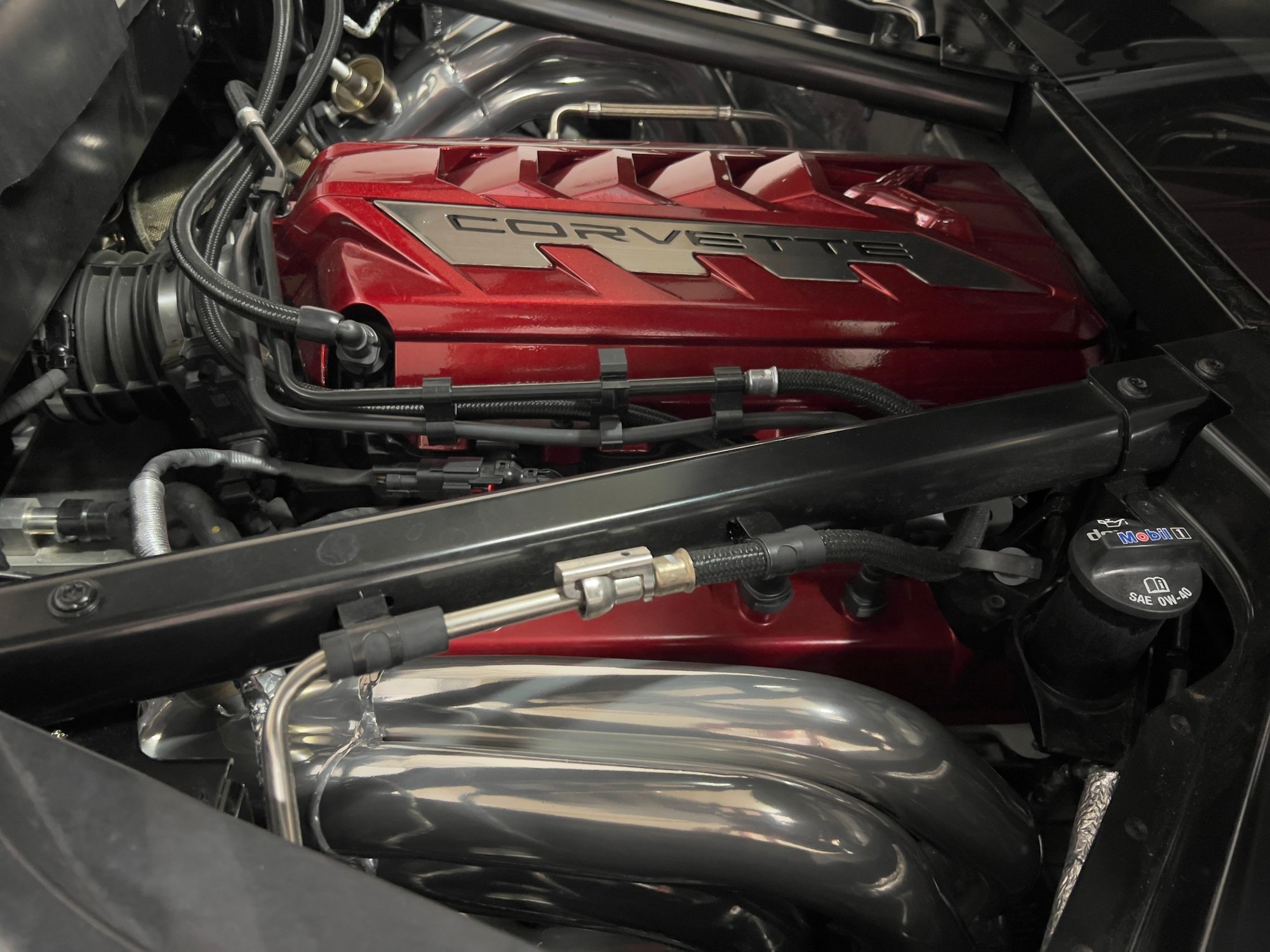

Finally have my 2M headers and Stainless Works Cats installed.
The coating on those looks outstanding, compared to raw stainless steel.

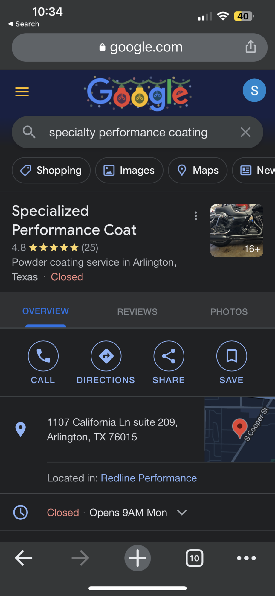

A local shop did them for me. $275 inside and out.
Michael @ SPC does great work and is fairly priced.
I trust him, Ruben @ SoCal Porting, and Scott @ SSPowderCoating in Brookings, SD.
