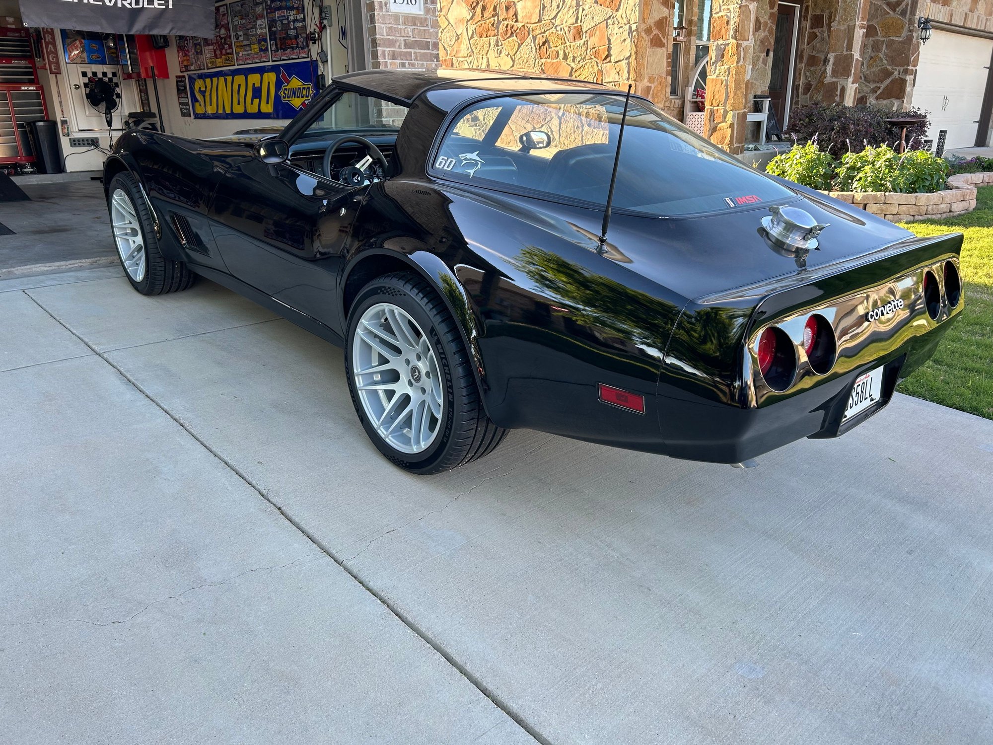

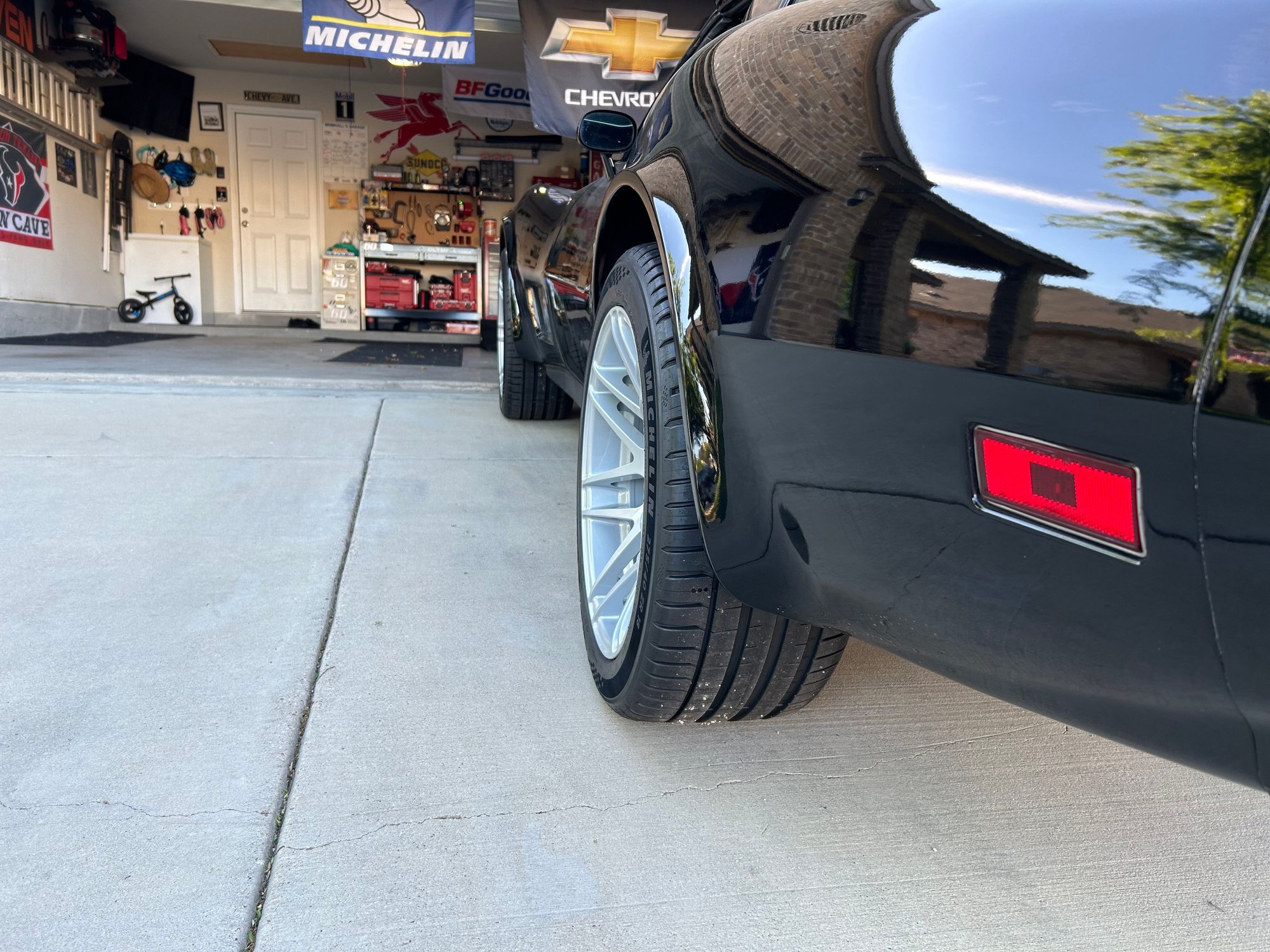

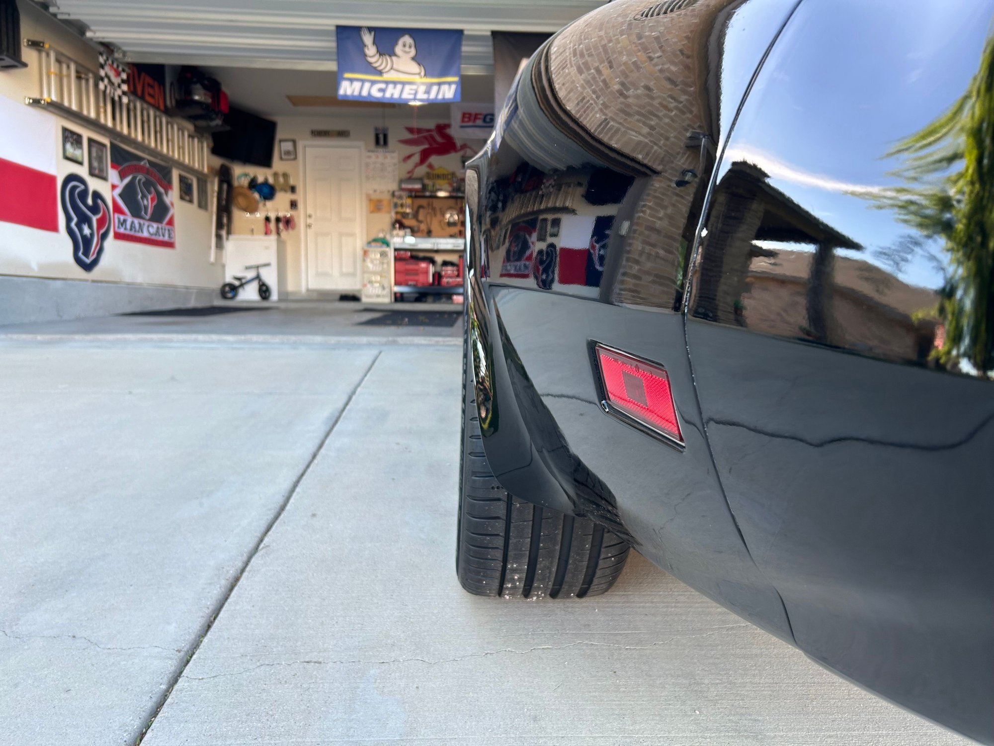

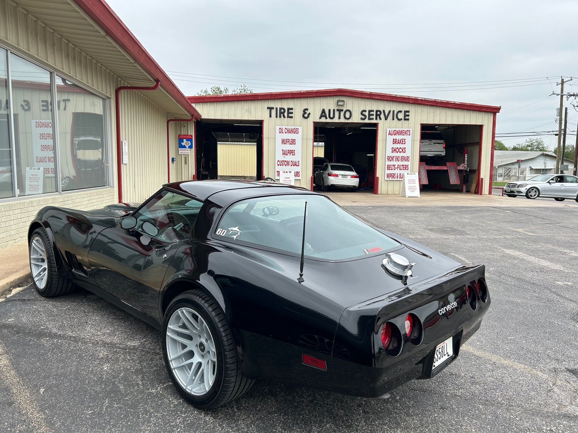

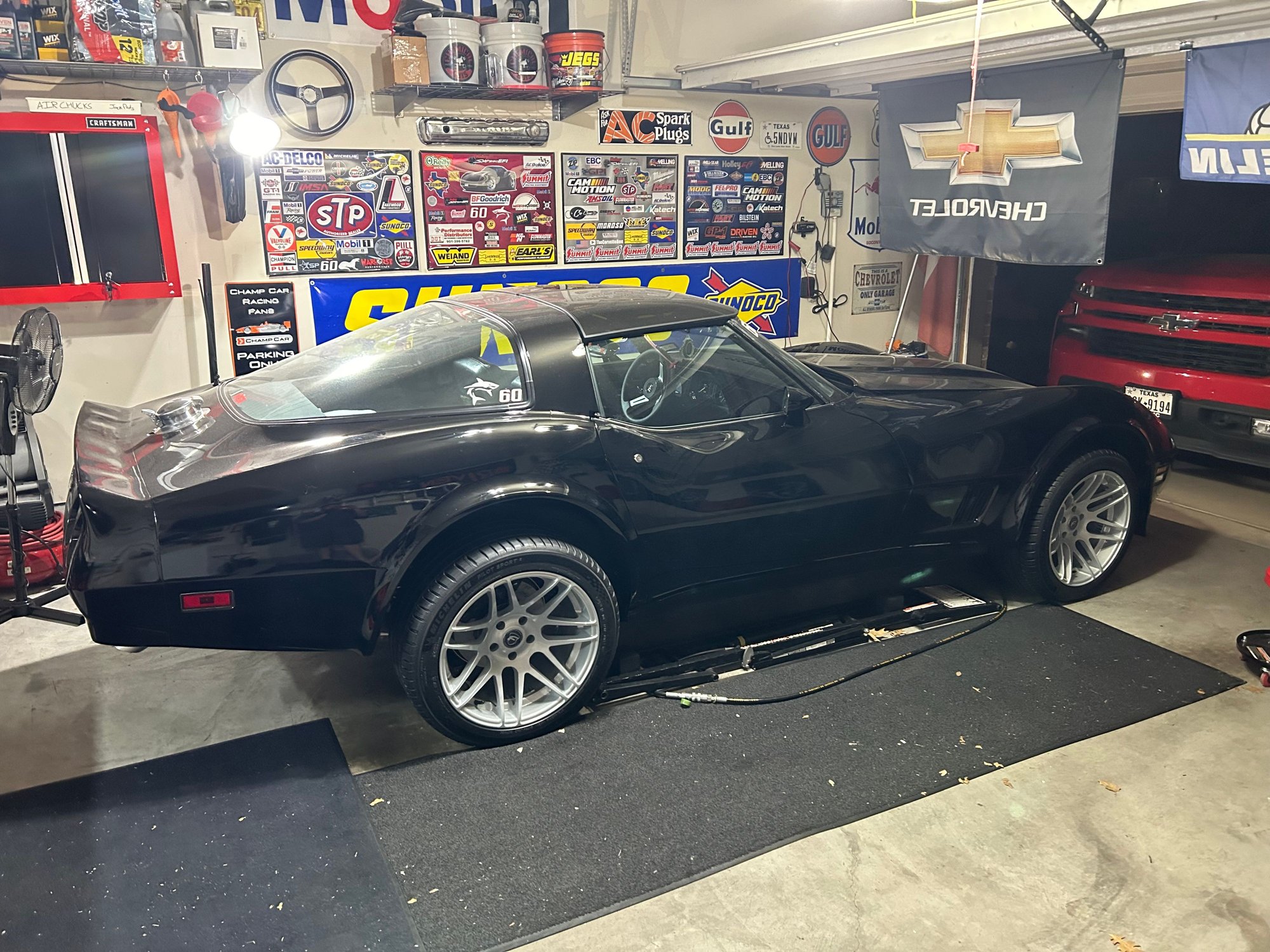

Better photos are coming after the suspension settles, an alignment, and a detail. But I just set my '80 on the ground on its new wheels and tires for the first time last night.
Forgestar F14's in 18x9.5 (-12mm offset/4.75" backspace) bright silver finish with Michelin Pilot Sport 5's in 275/40ZR18 all around. Stock brakes, factory Gymkhana suspension front and rear. Bilstein Sports front and rear. No mods, just new parts.

Originally Posted by Z0Tex
Settled (mostly) and aligned...
Quality Tire. Belton, TX

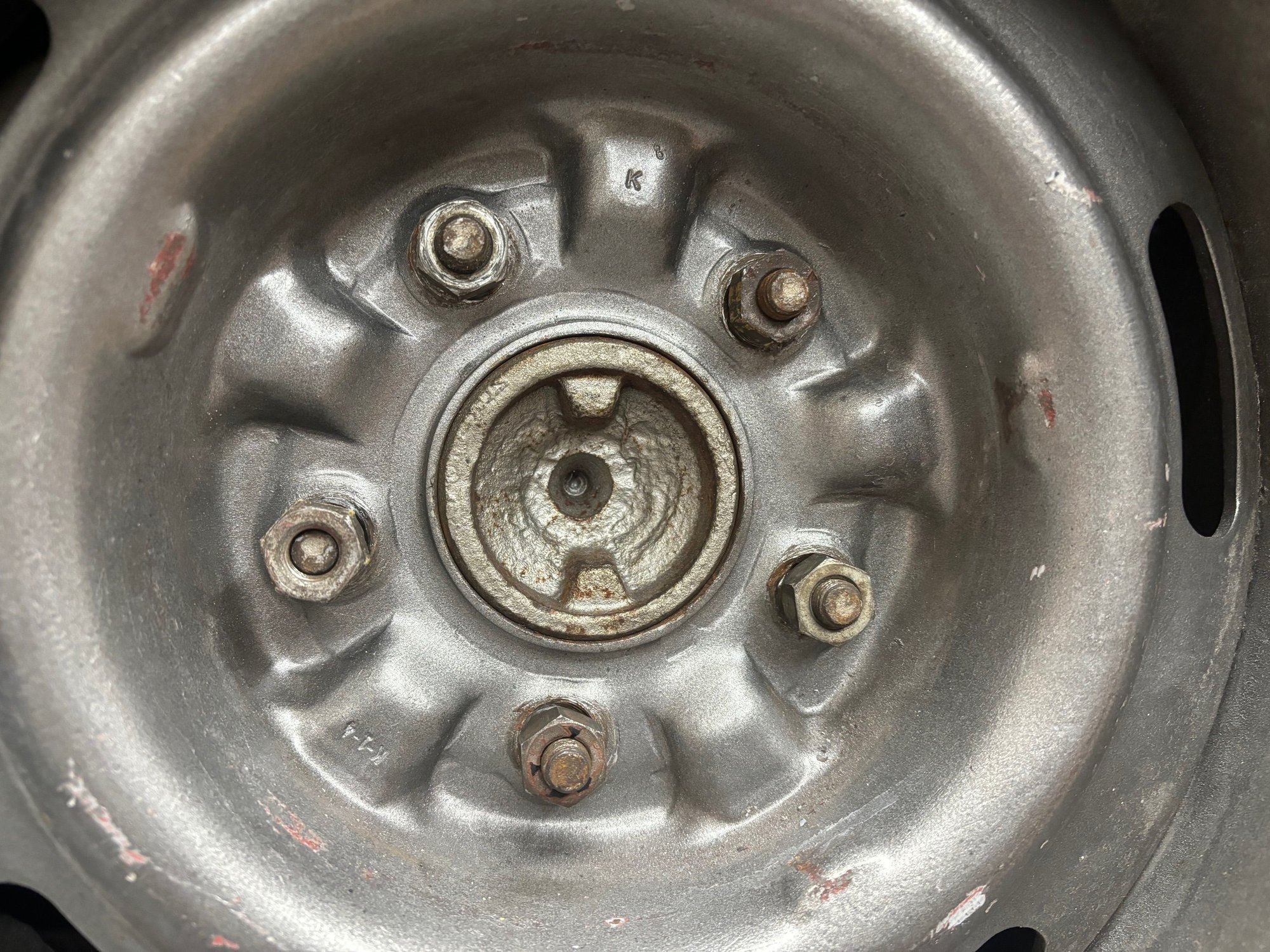

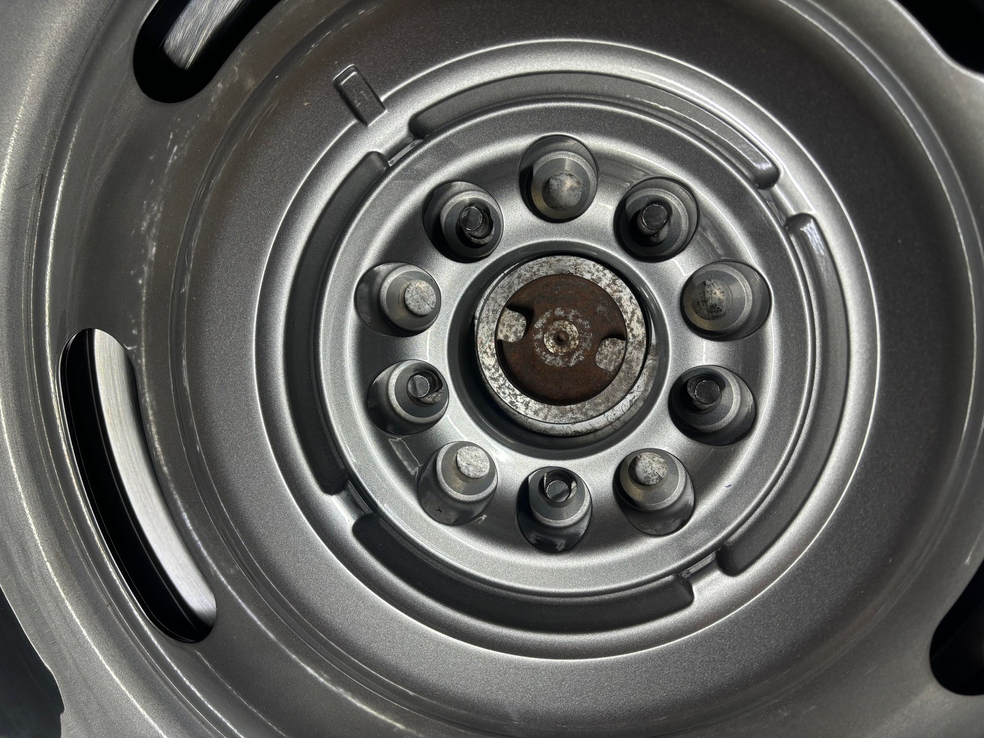

Did you guys install the wheels as Lug centric, or did you use a hug centric ring to line up the hub?
I'm not loving the gap on these lug centric 2-piece wheels.
That sure looks wrong. You're going to have to measure the eccentricity somehow. Have you tried bolting it in at a different rotation point?

Oh looks like they do not have the lug nuts on it yet.
They are what centers it.
Looks like they need tapered lug nuts.
If you are concerned, mount the wheel, not tire, torque down, then run a pointer (coat hanger?) to the wheel lip or better where the tire bead sits.
Should be 1/16" runout or better. Like 1 mm.
Yeah, I think they will center up when torqued down, I'm just not used to lug centric wheels. Not sure if this bore size is correct, will measure the bore tomorrow.
I'm just fitting them before I mount tires because after that they cannot be returned.
Seems to be similar to my wheels (Vision 55). I used both Hub Centric Rings (83mm to 71.5mm) and these Cragar lug nuts; https://www.jegs.com/i/Cragar/260/27...LB0Byz1N6eFUST

Thanks for the recommendation.
I tried all the wheels to make sure they fit and they do. I snugged up the lug nuts hand tight and as expected the wheel centered up fine.
Ordered Centric rings yesterday, wheels are American Racing two piece rally.
