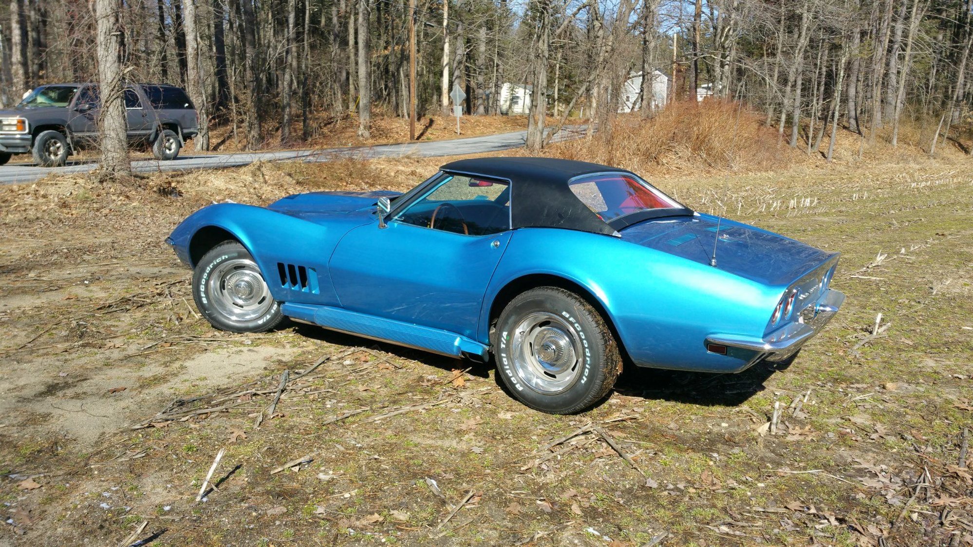

I just checked my tires and I have 225/70R/15 BFG.
I checked one tire that is off right now with level and tape
that is not on the 73 and it was 27". One on the 73 measured
26.5". Is this what you would expect?
This is how they look:
Donnie

Hi Donnie,
I would expect the 225-70 to measure about 27.4"
This generally means it's a little 'taller' and a little 'wider' than the original F70.
This is why many people who don't want the 'fat tire' look really like the 225-70 tire. It does a good job of filling the wheel-well opening.
I like the look of the tires on your car…. they're some-what old school looking but do a much better job of filling the wheel well than the original F70's size tires do.

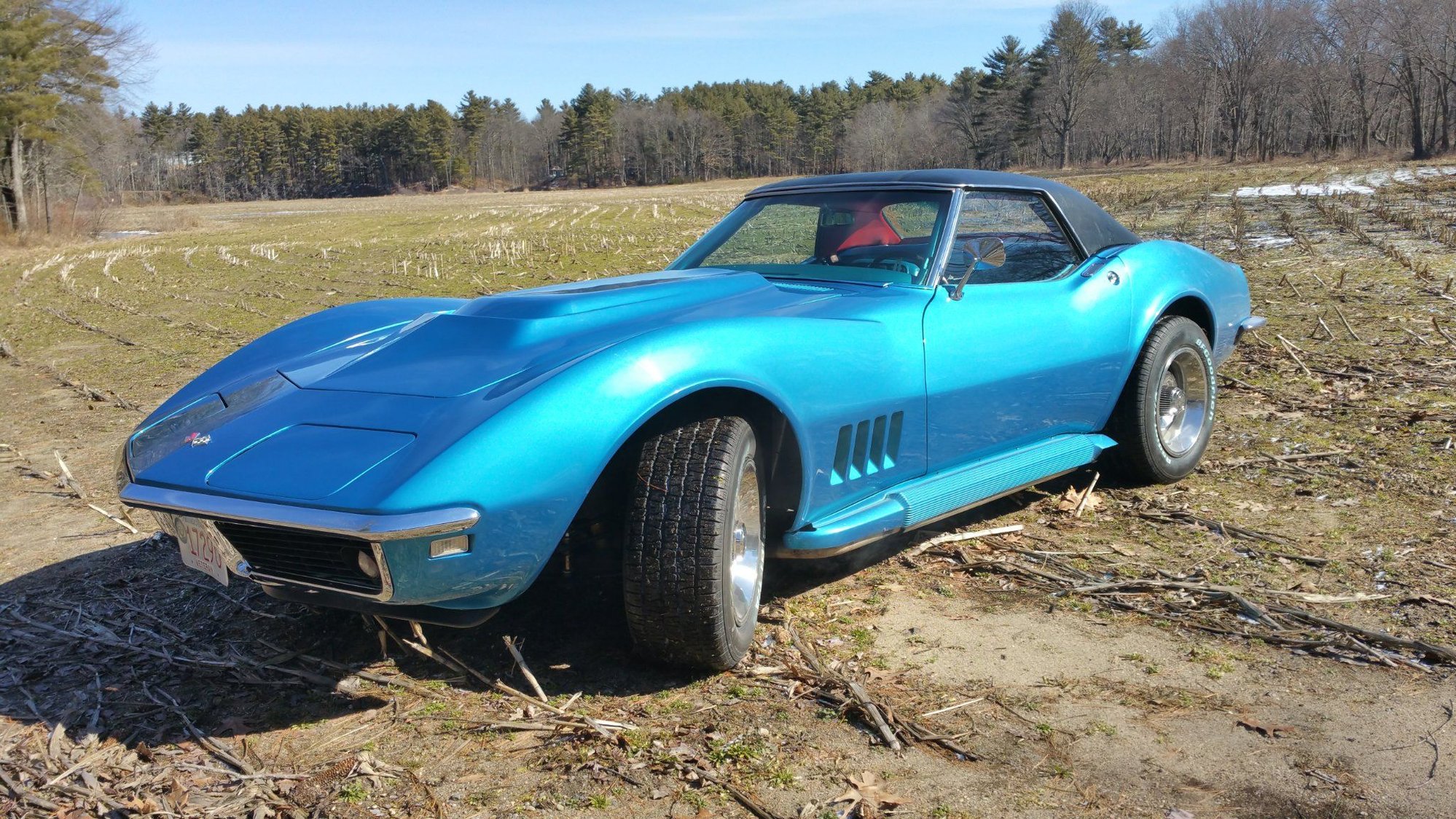

I put 235/70/15 Cooper Cobra's on my 75 this winter. I took it to get a 4 wheel alignment today and everything is good to go. My new Coopers measure 27.9" tall with 30 psi and handle much much better than the 245/60/15 TA Radials I took off. I can't see why they wouldn't work for you also.
Jerry

Here is a picture of my 75 with the 235/70R15 Coopers on it. I am not sure if there is a difference in clearances between 71 and 75 but there and more qualified people on the forum to answer that question. I like the stance and character of the taller tire and didn't have and rubbing on the 50 or so miles since I got it out this Spring. My 75 came equipped with G70R/15 when new so there is only about 1/2 inch difference in diameter from what I have now. Good luck with your ride, the season is upon us.
Jerry
