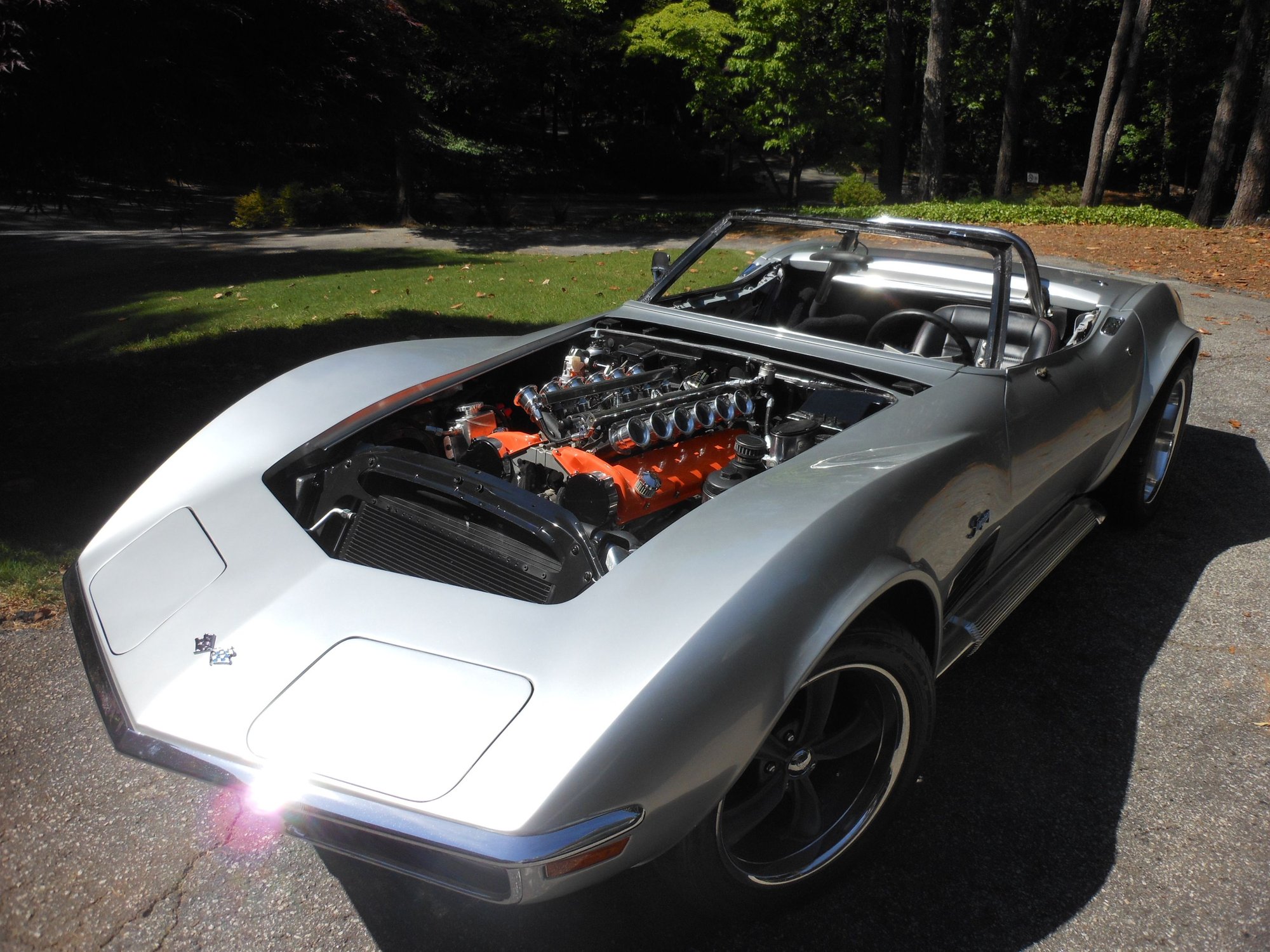

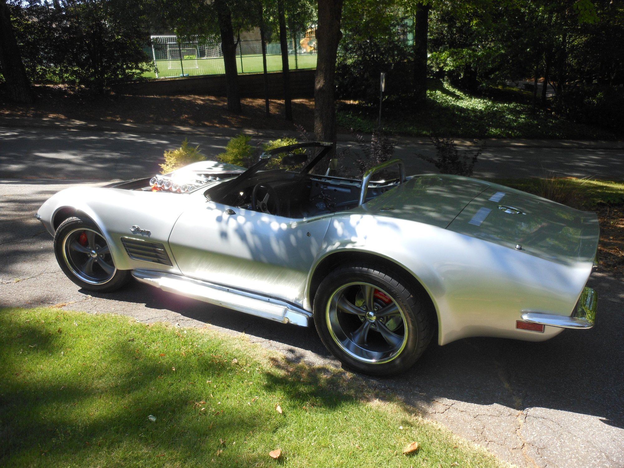

A big day in the neighborhood-
Drove my car all the way to the top of my driveway!!!!
Notes to self-
1) bolt down the seat!!!
2) fix bolt on sidepipe- nyloc?
3) work on clutch linkage- engages to soon
4) adjust latch on drivers door
So tomorrow - I hope to be driving around the neighborhood!!!
I'm really happy with the electric power steering- shifter is right where it feels good. It's finally coming together.

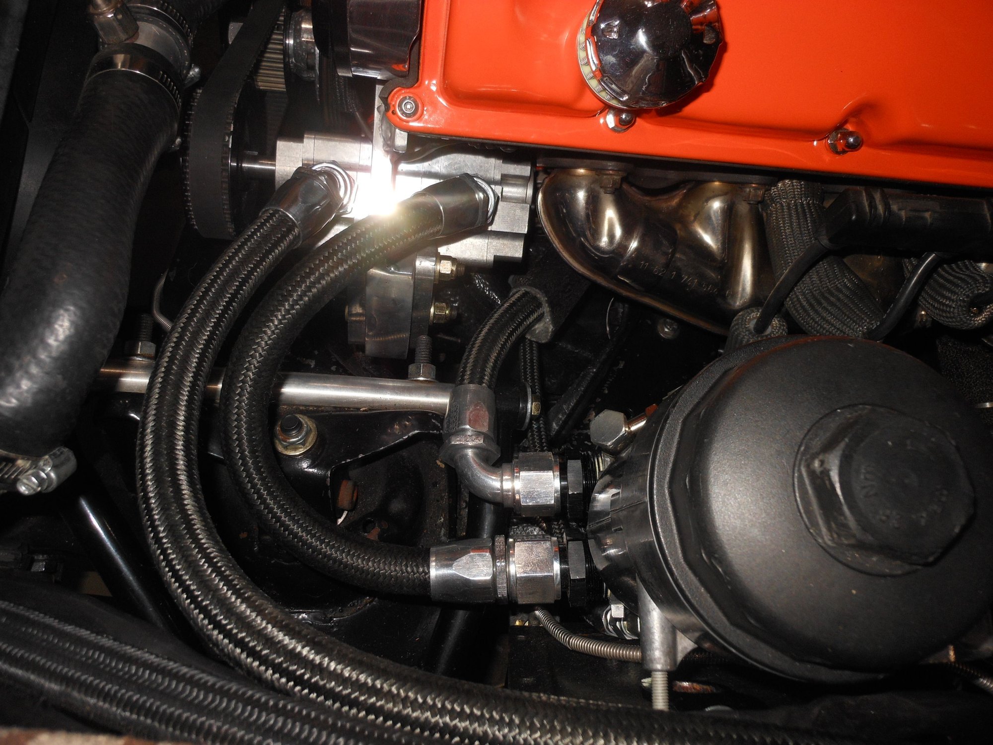

Still have a drip of oil on the back of the pan- changing the breather system to the catch can solved filling it up after a couple of revs. The oil filter canister's new AN to NPT fitting solved the leak there.
I have already ordered another oil pan gasket ( only $15) just in case.
Proof- it drove up the driveway!!!
AlsoPics of just some of my progress since last post-

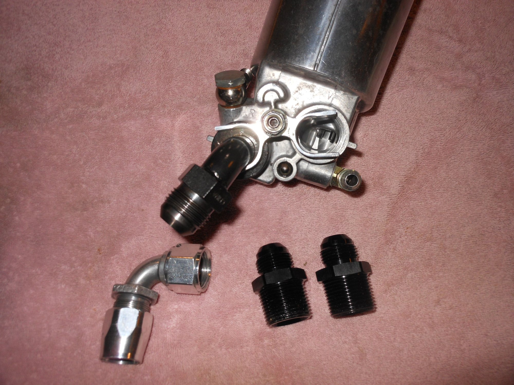

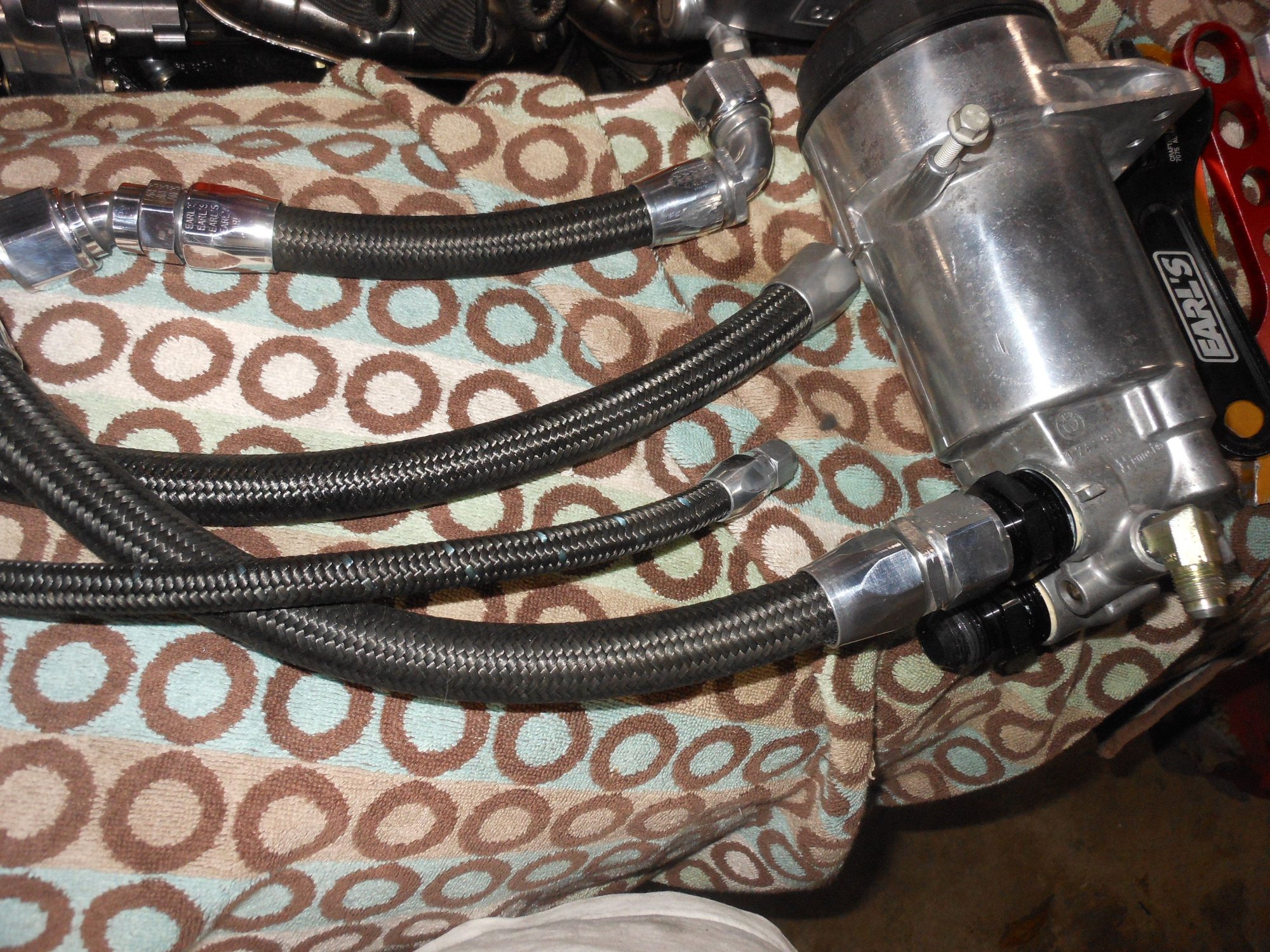

AN fittings on oil canister- also redid the hoses so they can flex more when the engine is running-

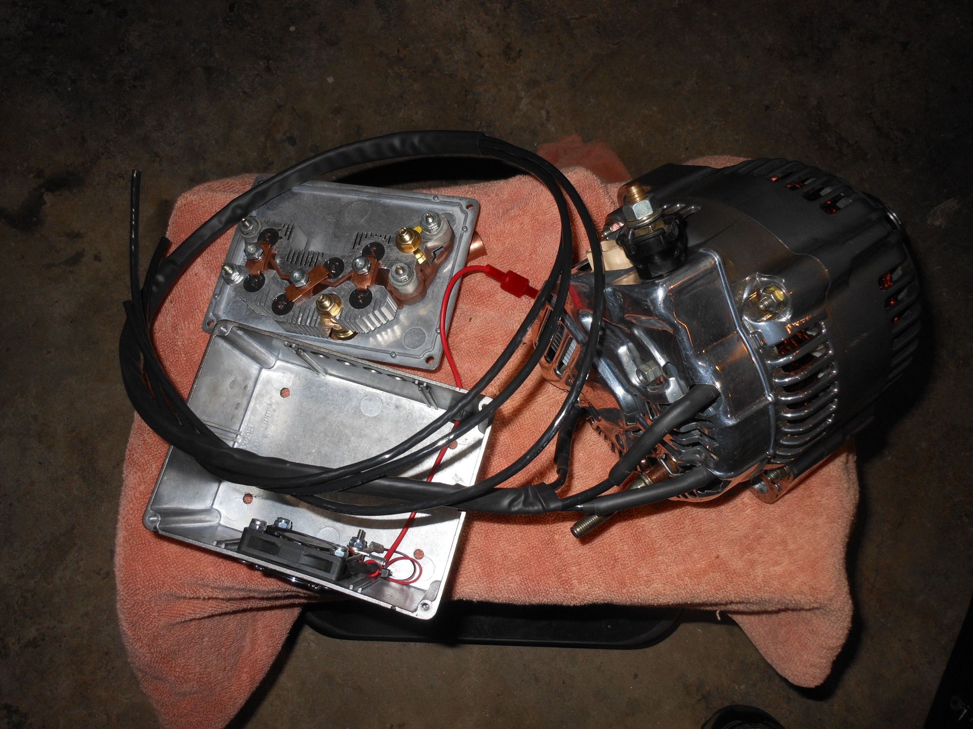

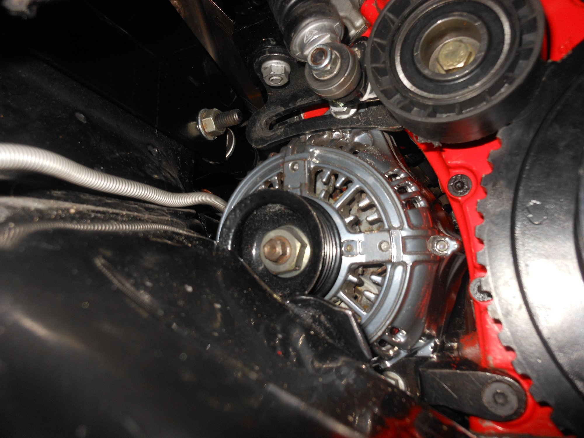

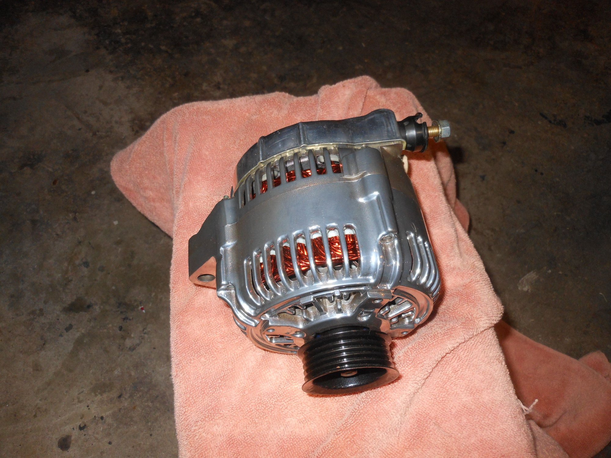

New upgraded - custom built alternator- twin rectifiers- Internal and external fan cooled!!!
Yep- a really tight fit!!!!

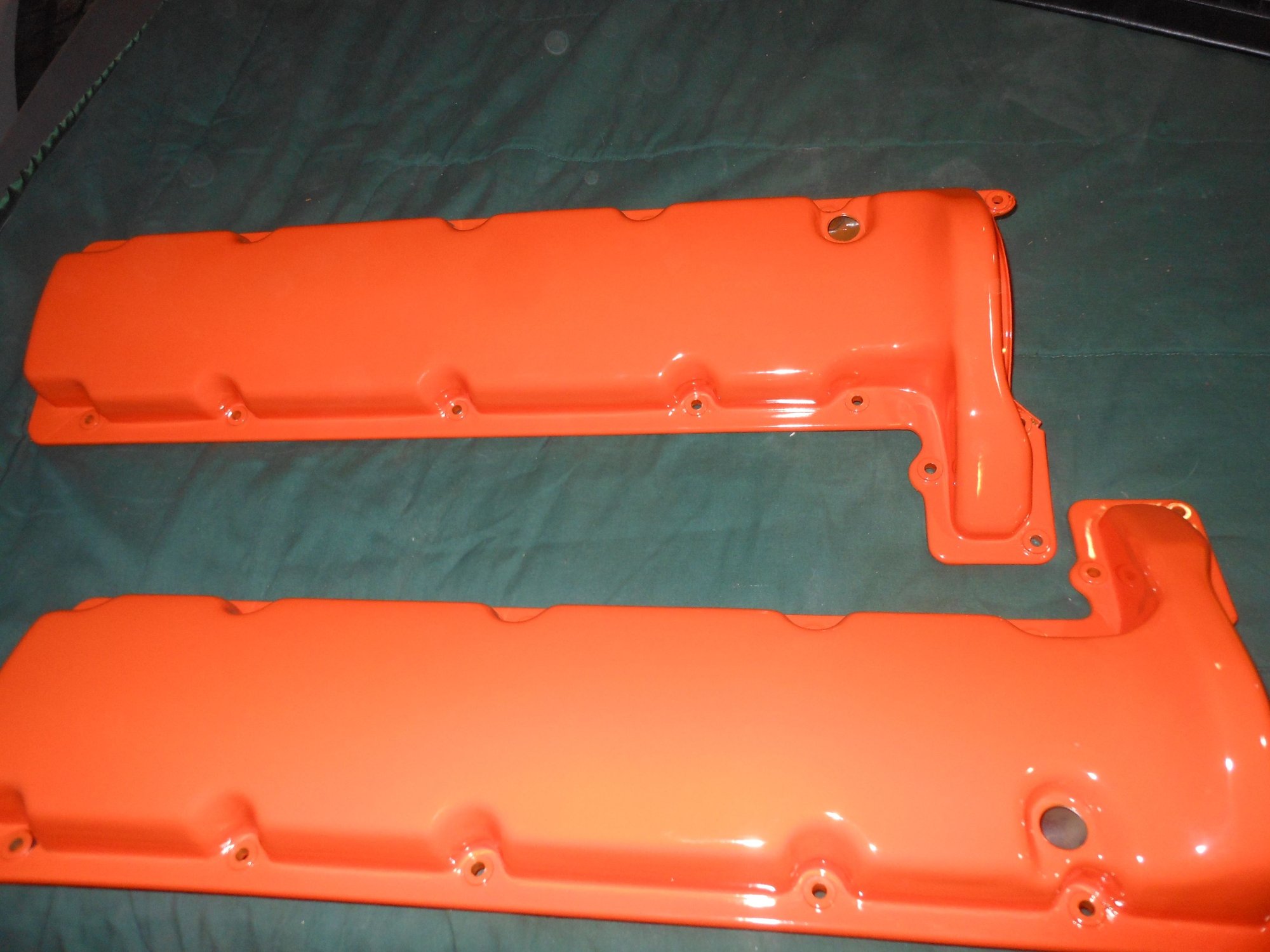

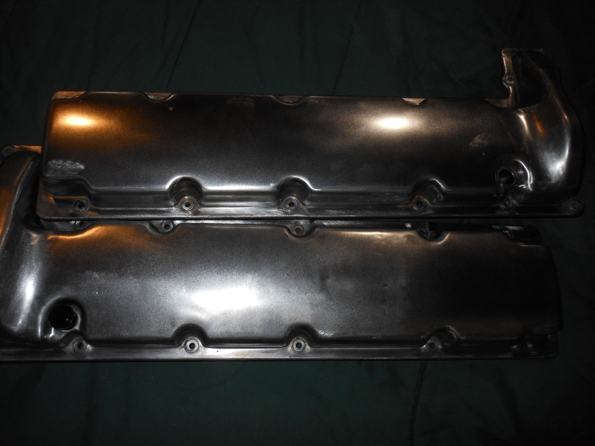

Valve covers- cleaned them up- and had them powdercoated-

I don't know HOW you could fit that alternator where you did! The biggest thing I could get to fit in that location was a Kabota fork lift alternator. Nice job with the whole project!
Hey CY-
I milled it down a bit!!! It's good for 155A full tilt- and about 80A at idle.
Originally I had a GEO Storm w/ AC alt there that was only good for about 90A.
