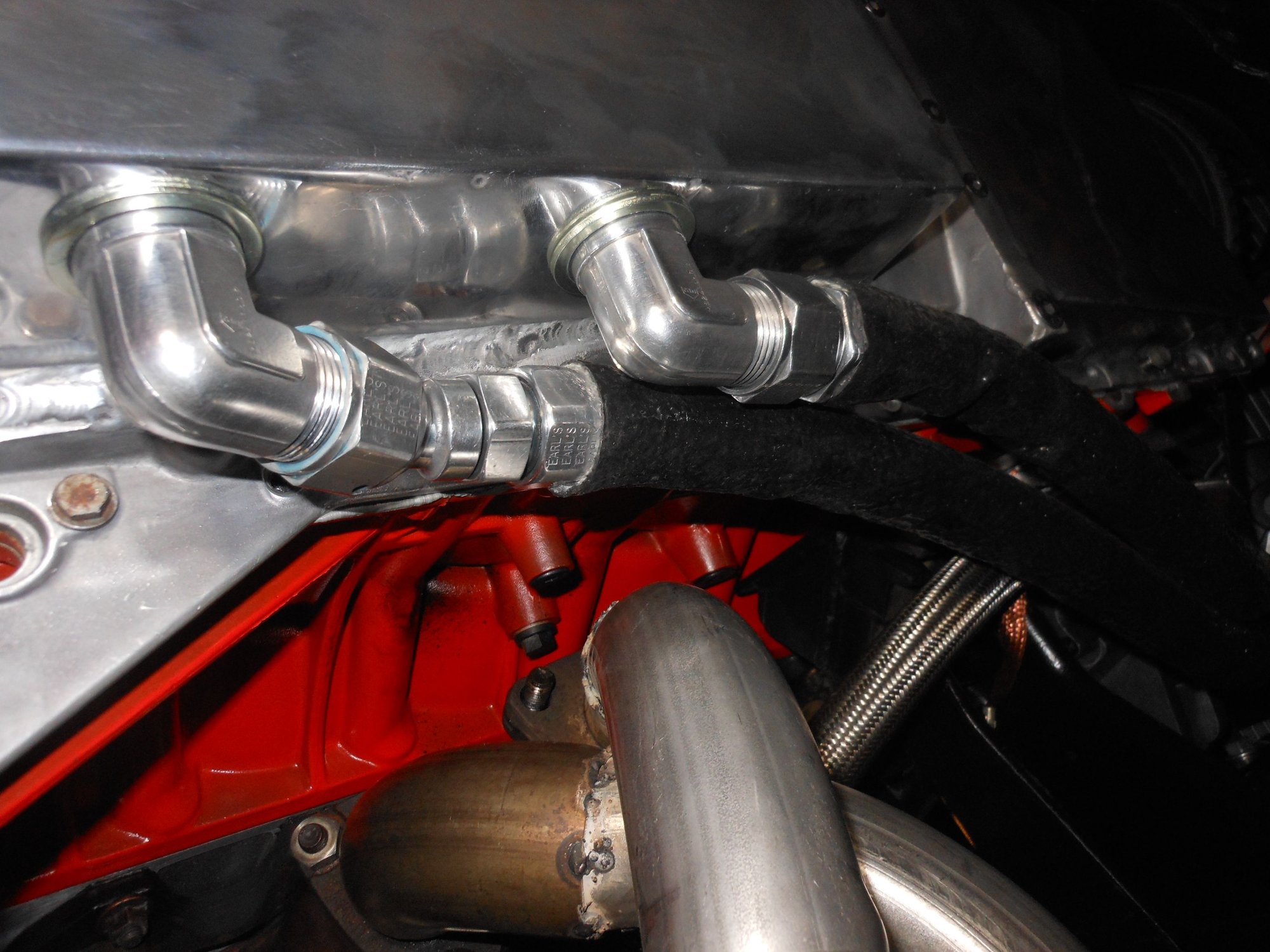

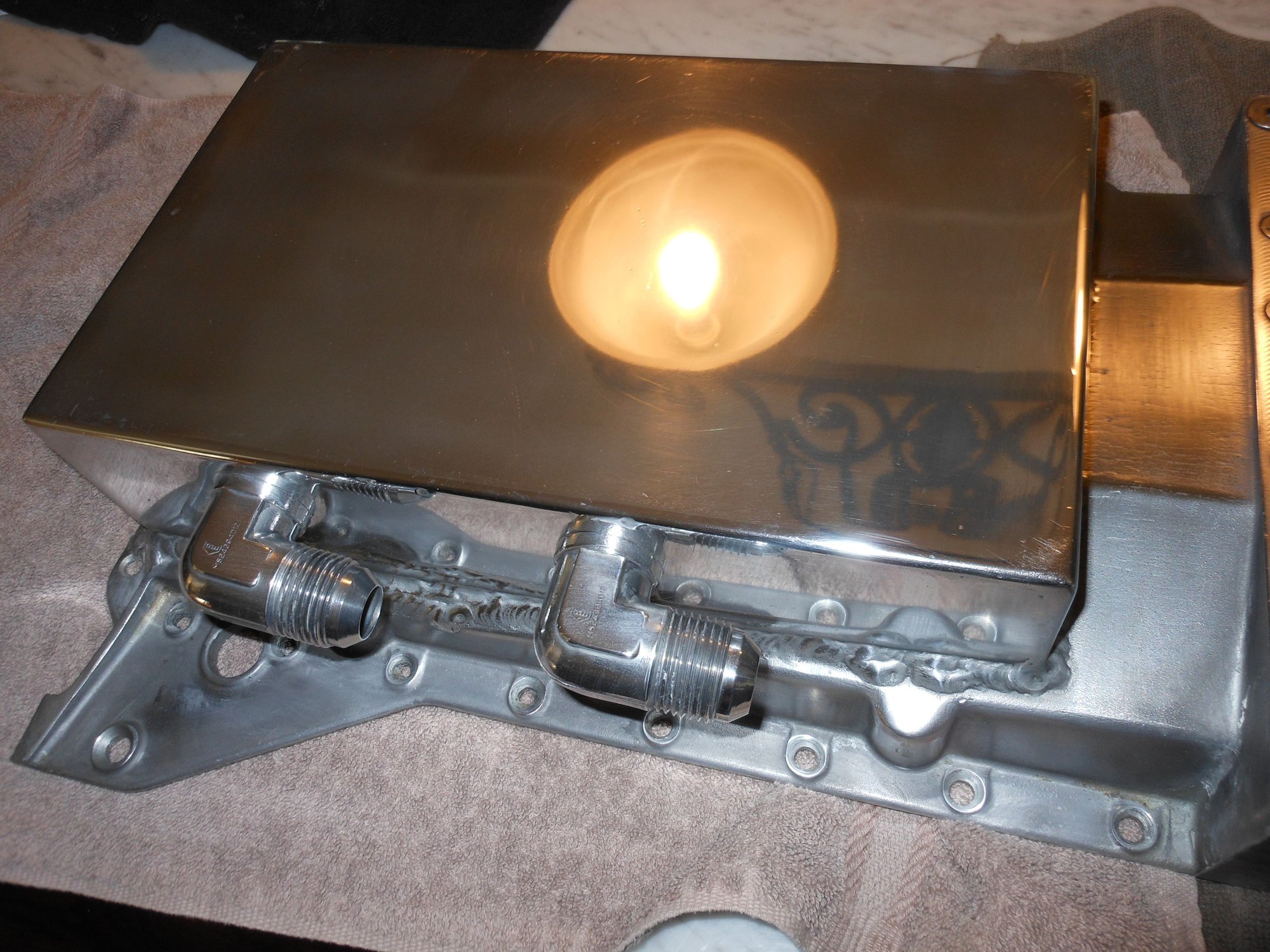

The exhaust and oil lines where having a tough time coexisting...
Dropped the pan- and got some 90º fitting-polished up while I was at it....
Put some heat shield on the oil lines- now fit nice and tight against the block-Don't look too closely at the exhaust...that was some steel I had laying around for mock up...

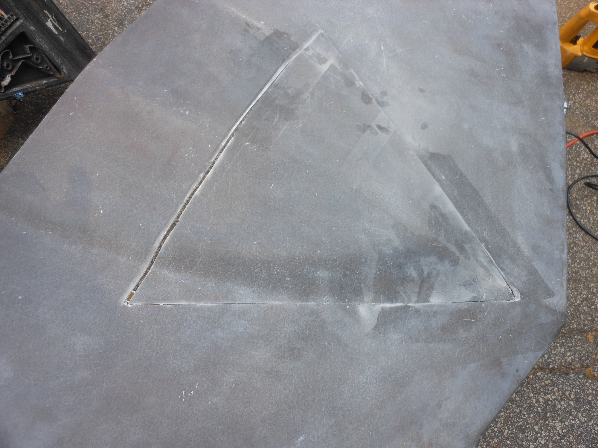

The project I'm messing with right now- is getting nice clean-cool air to the engine-without having a big airbox covering the polished velocity stacks.
I really like the look of this hood vent/scoop
So here's a start on mine-
Here's the airbox mocked up- Idea is to make it part of the hood and have the rubber gaskets seal the stacks- just have two gaskets right now...need about 10 more!!
Looking at having the airbox incorporate into the hood as well...

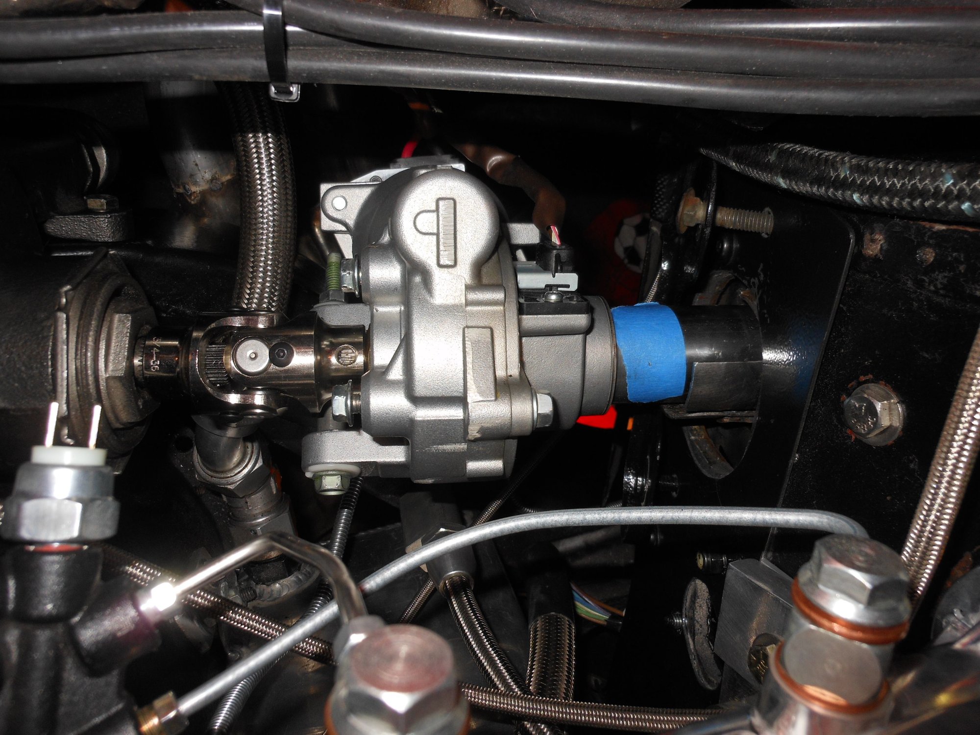

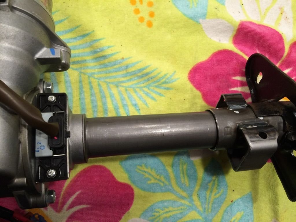

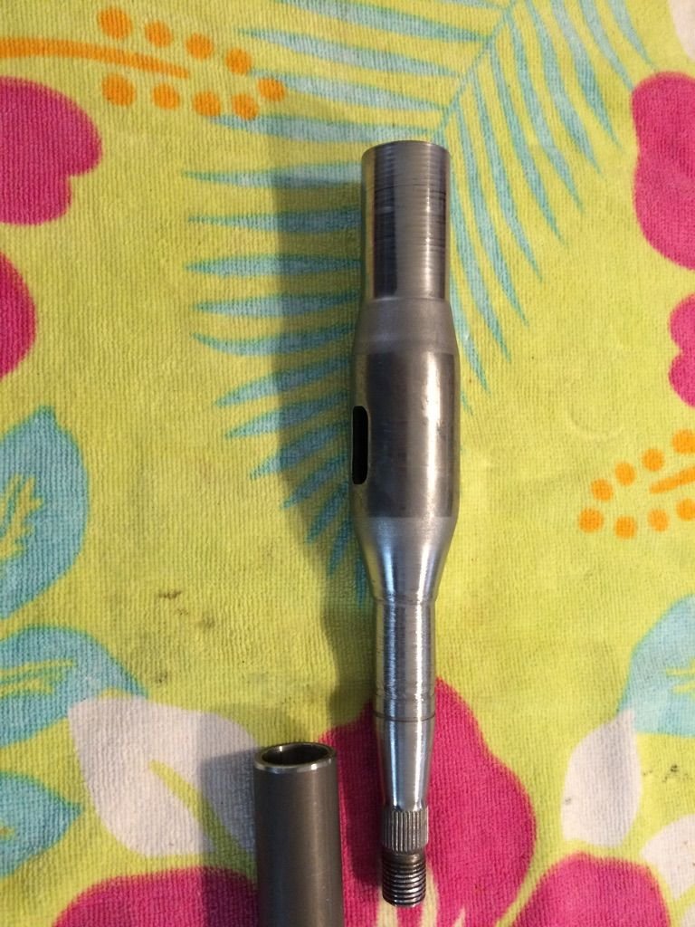

Electric Power Steering
I'm using one from a 2010-12 Nissan Cube- Including the adapter-I'm in a little over a $100.
Had to mod the steering column-and found a u-joint that would accommodate the Nissan electric assist motor to connect with the stock box- Just have to connect to power/ground /ignition and mount a control box.
Here's a great read on "How to" electric power steering-
https://www.corvetteforum.com/forums...nd-videos.html
Here's what I have run into-
1) If you want to have the collapsible steering shaft- taking the column apart and cutting is required.
1b) If you don't want to retain the collapsible steering column- Taking apart the column and cutting is required!!!
1c) Tilt-Tele- that's going to take even more work...
2) You have just about 9" between the firewall and stock steering box- if you are running a manual trans - you will need to convert to a hydraulic as there is no room for the Z-bar....
3)You will loose the reverse lock-
Here's my cutting-
Stock shaft- blue tape indicates firewall
Stock shaft cut- and inner stack shaft was cut to retain collapsible. Nissan steering wheel adapter
Nissan adapter turned down to fit cut-down OEM shaft
This will get welded
Fits into motor's torque sensor tube
Looking into the column-
Nissan bracket- fits almost perfect in the OEM column. A little more work (probably notch the OEM column) and it will be welded to the firewall bracket.
Here's what it looks like- motor slides into column- just have to design a mount to the frame for the motor.
Control module-

Had a leak behind the waterpump ( used air to check for leaks)- it was a NPT fitting that I had blocked off- impossible to get at...So started taking of the front oil pump drive - serp drive and then decided to go to Harbor Freight and get some sacrificial tools. I grinded a couple sockets and hex key up and was able to get to it.
Leak stopped...however found my bran new radiator cap on my expansion tank was leaking- a spray bottle with soapy water found it.
Got a really nice piece off eBay for under $20-
I got an AN fitting welded to the new radiator-
And while I was at it- I redid the angle of the tensioner on the serp drive- got a new pulley (smaller) and made a new bracket out of aluminum-
