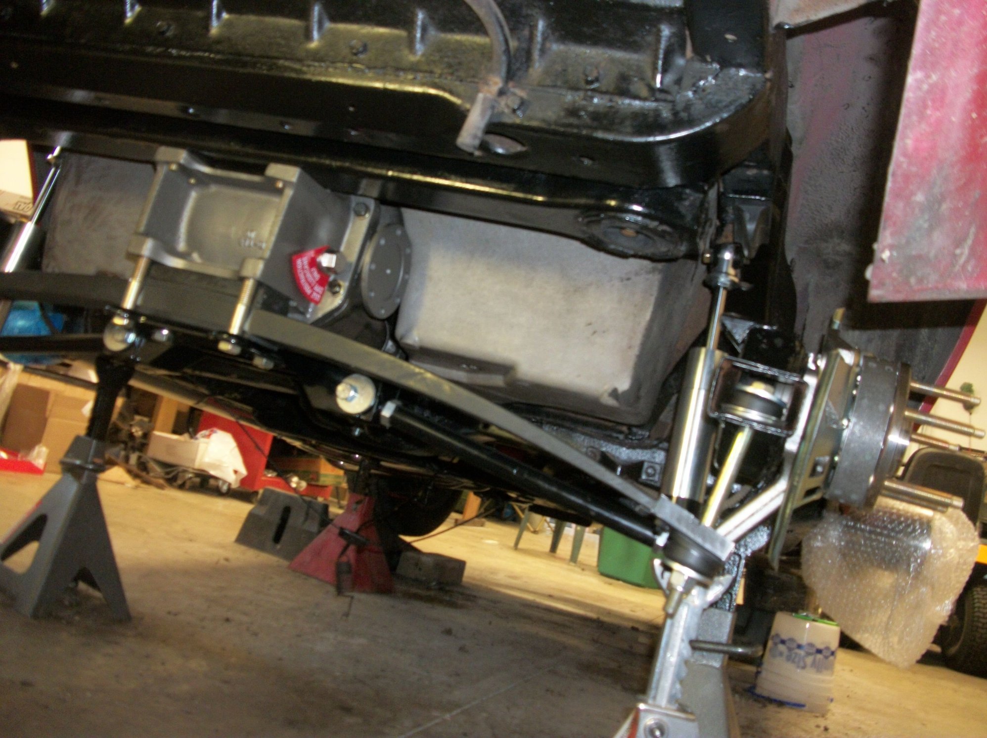

One trailing arm in.

Installed spring and shocks. Time to make safety loops and get to work on brakes.
