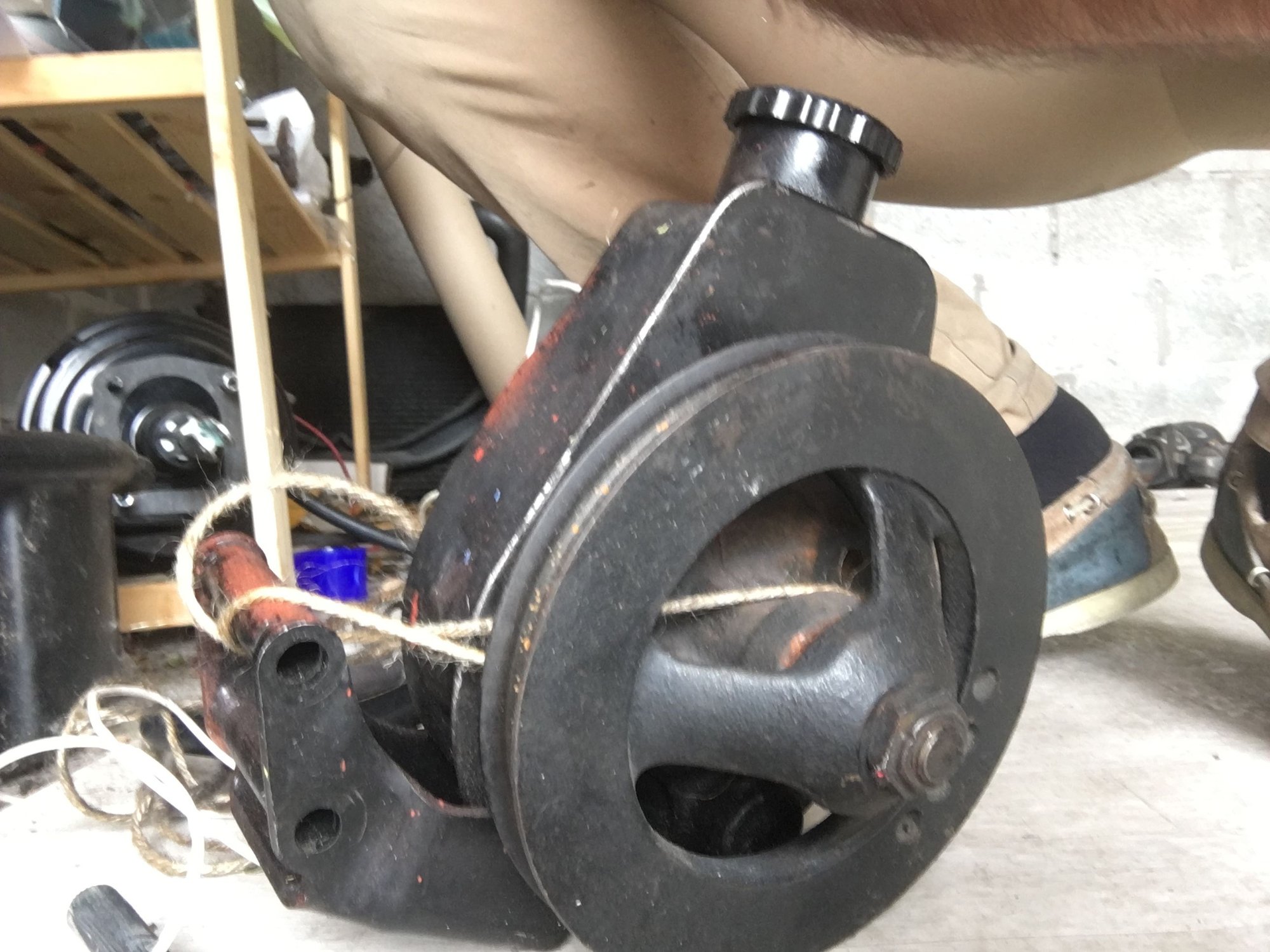

Next the power steering pump came off. I plan to do a Borgeson conversion since I’m here... so might as well drop it now.

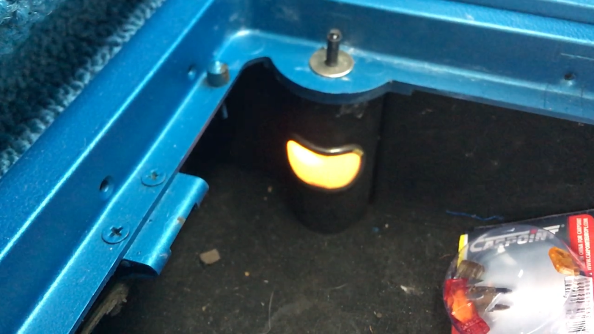

Fan capacitor restored and functional

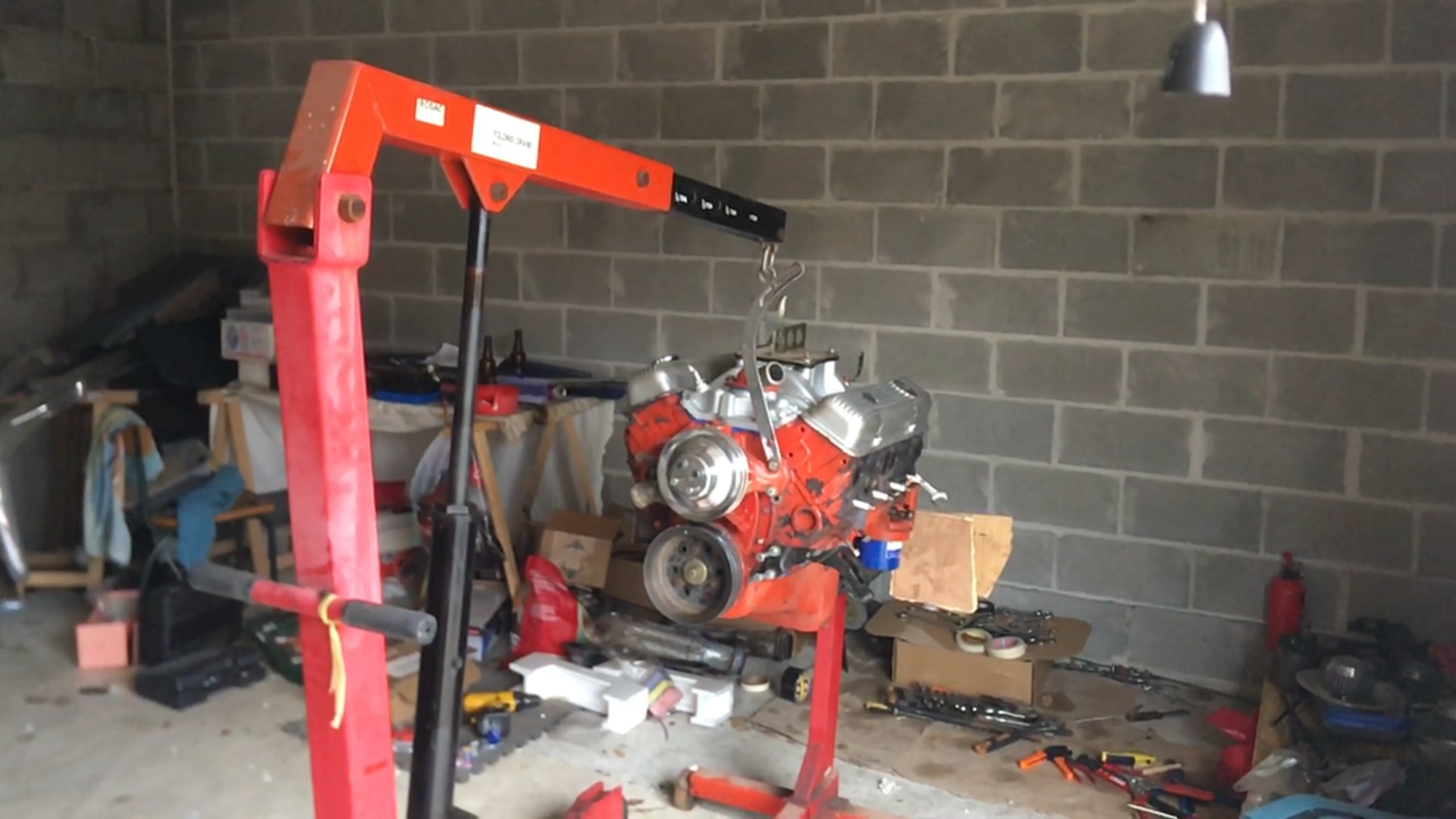

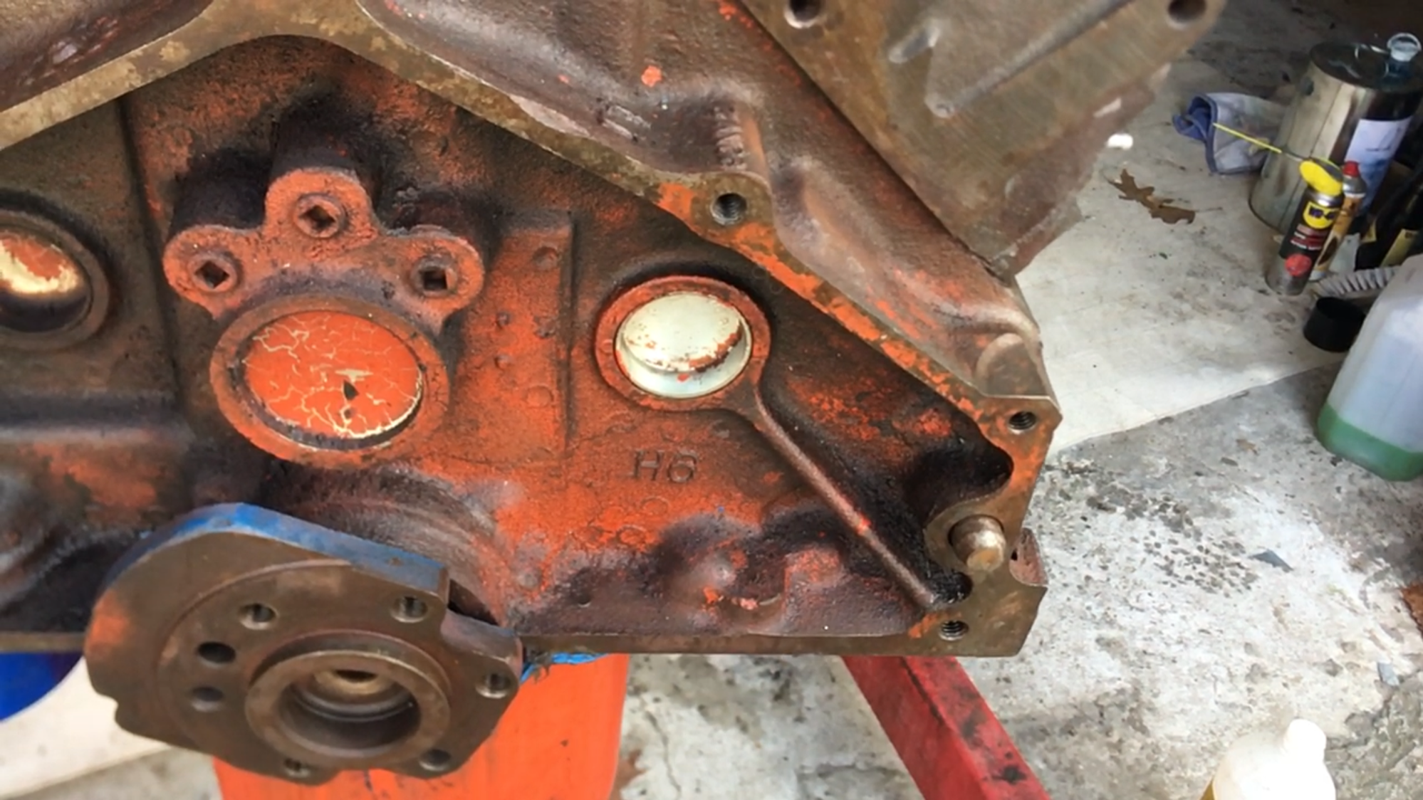

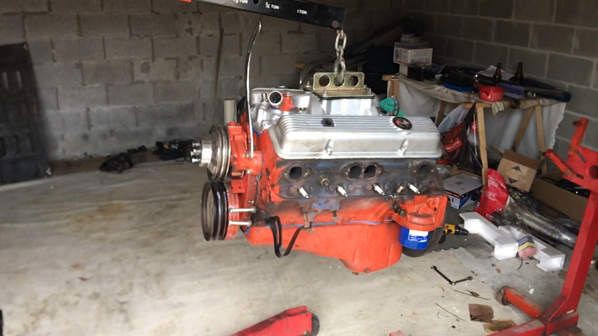

Tidying up the engine but not super cleaning and detailing. I am not sure I want to invest in this lump. Like the cylinder walls, the freeze plugs look fresh. So the jury is still out.
This fella will be going ou to the machine shop to get resurfaced

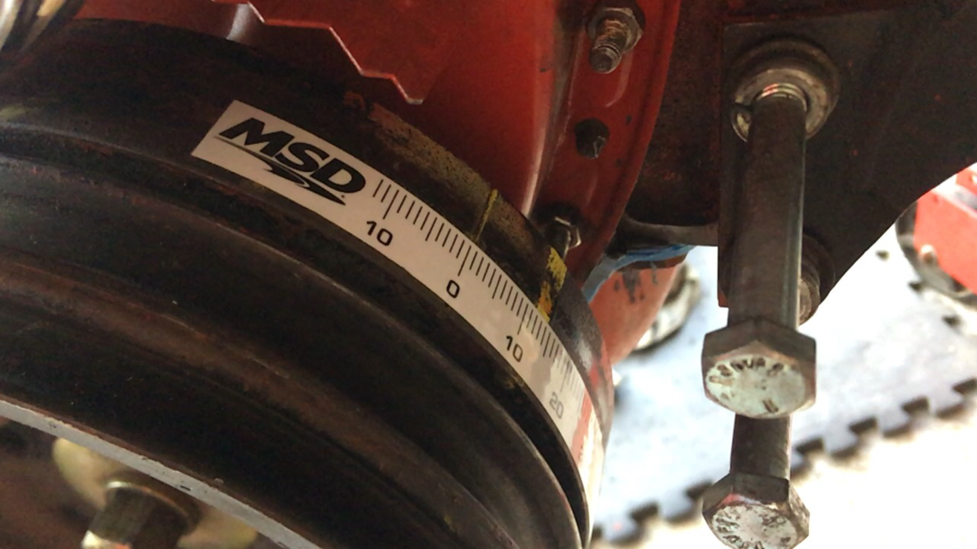

Timing tape to make my life easier when tuning
Nice plugs

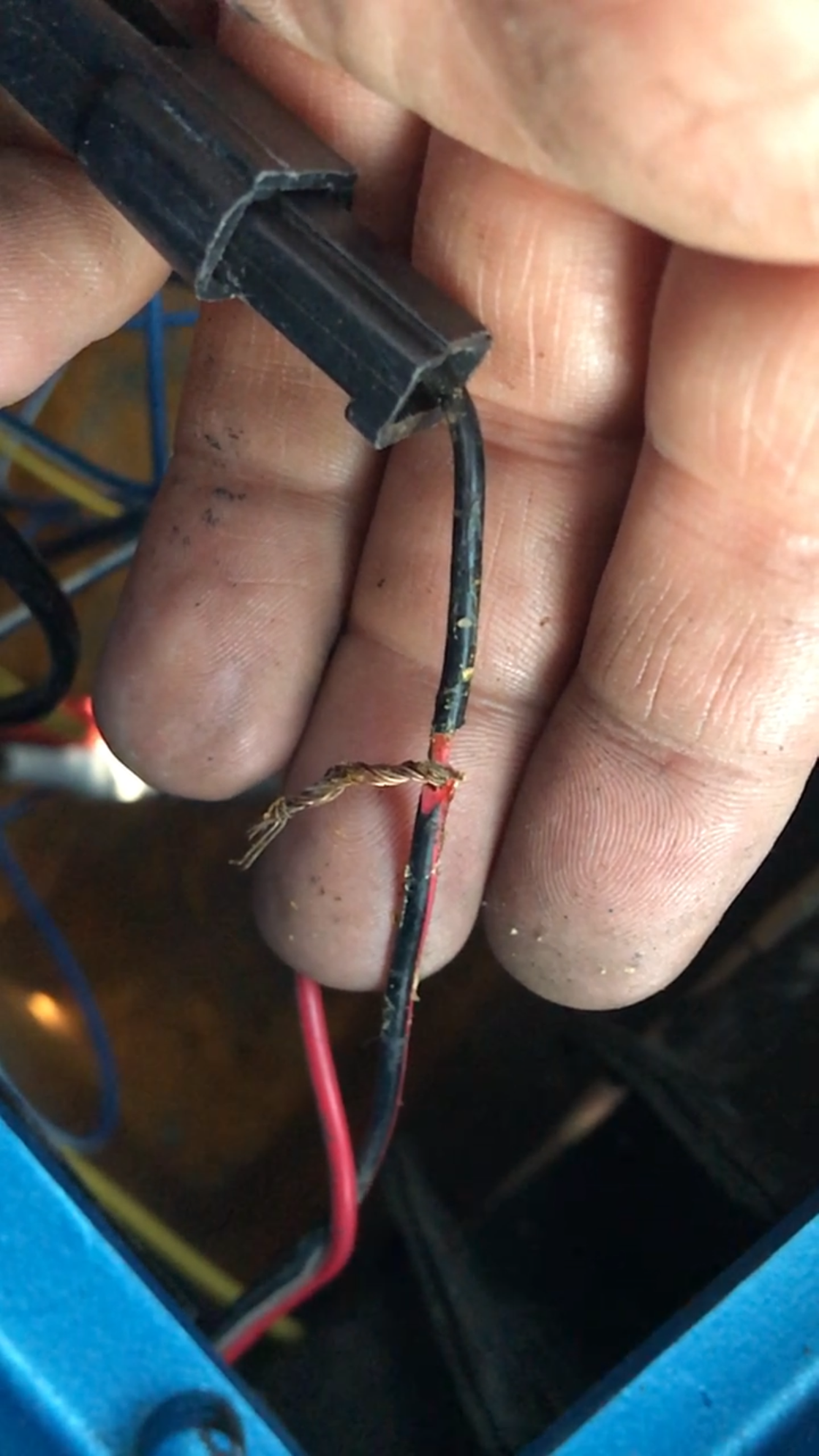

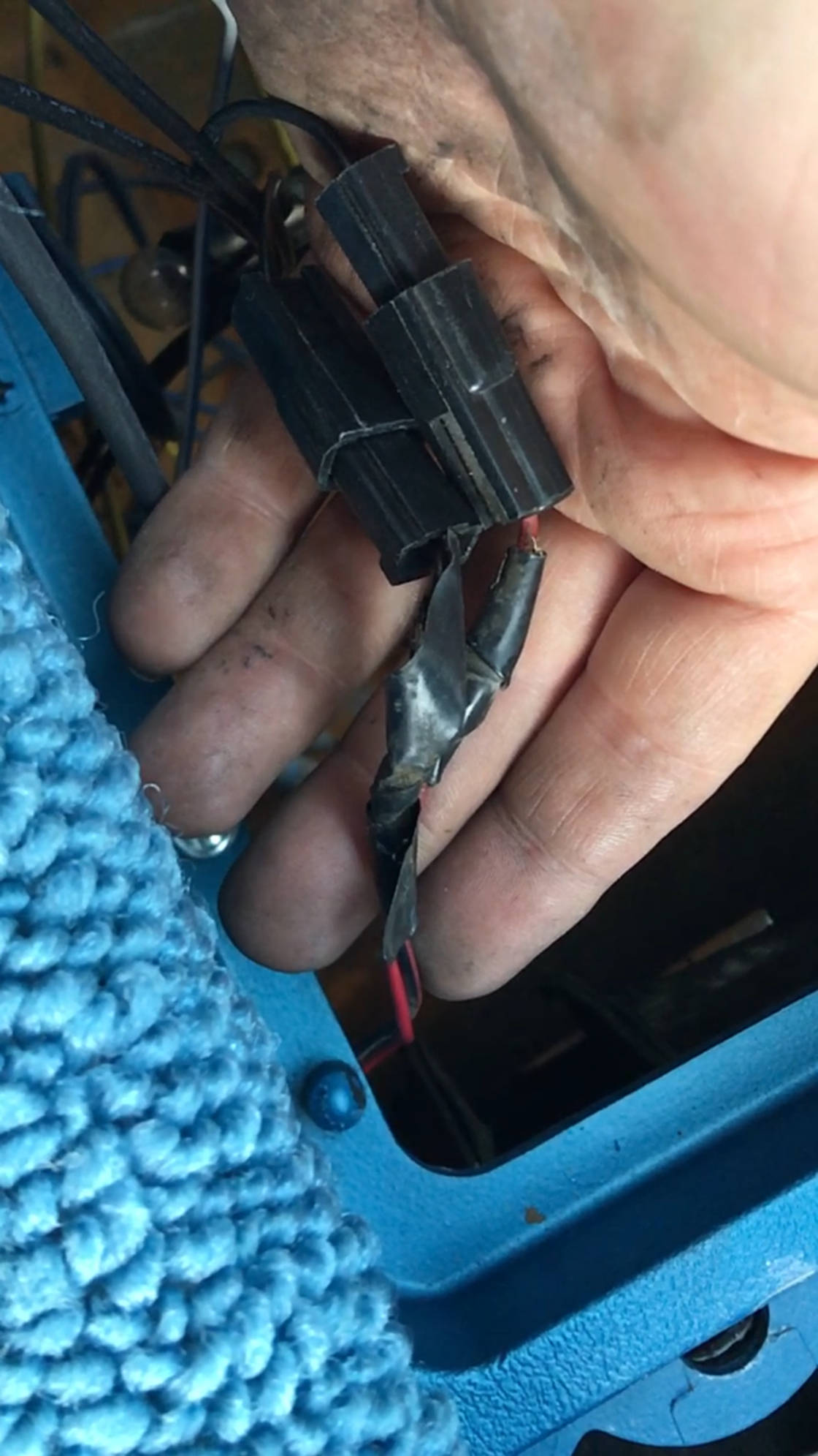

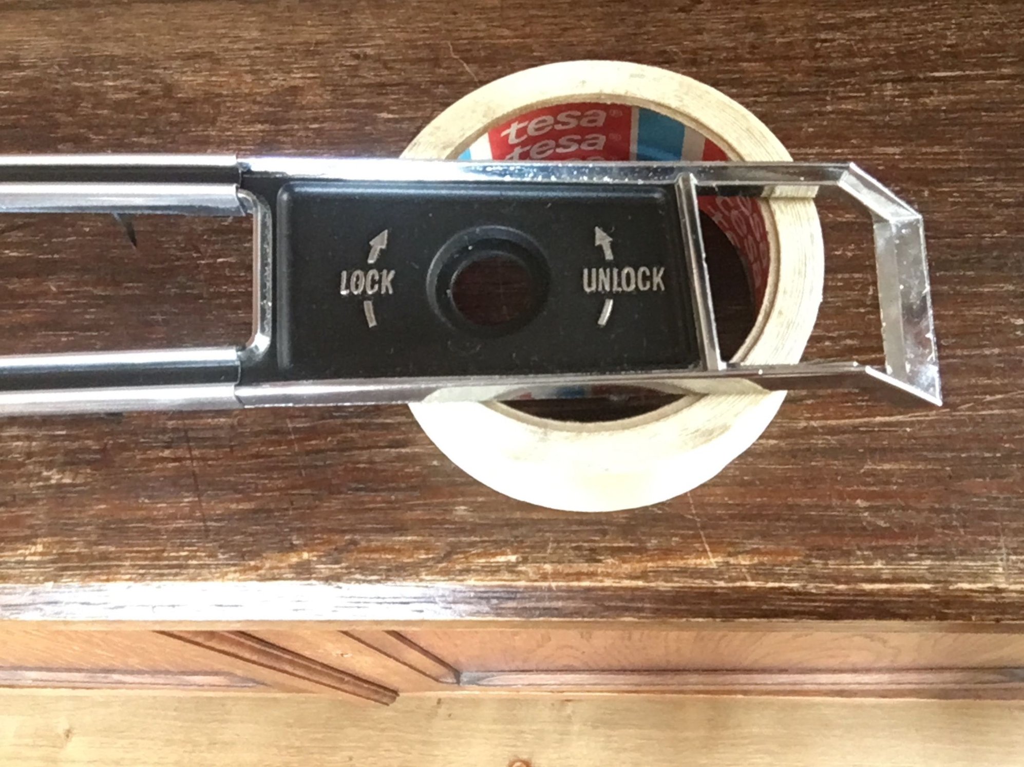

And Bubba strikes again. If I EVER catch him I’ll put his nuts in vice and feed him pickled herring.
Who wants to bet what I'll find under the sticky tape?!!?!
The Infamous Bubba Twist !!!!
Aaaah the little details make me so happy

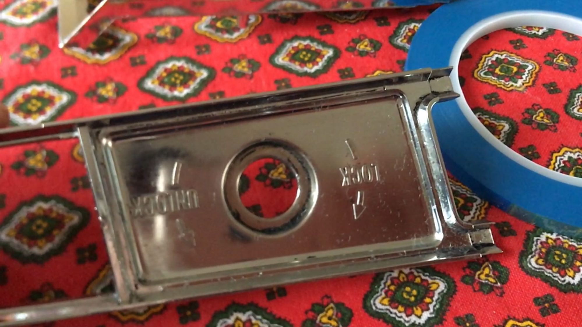

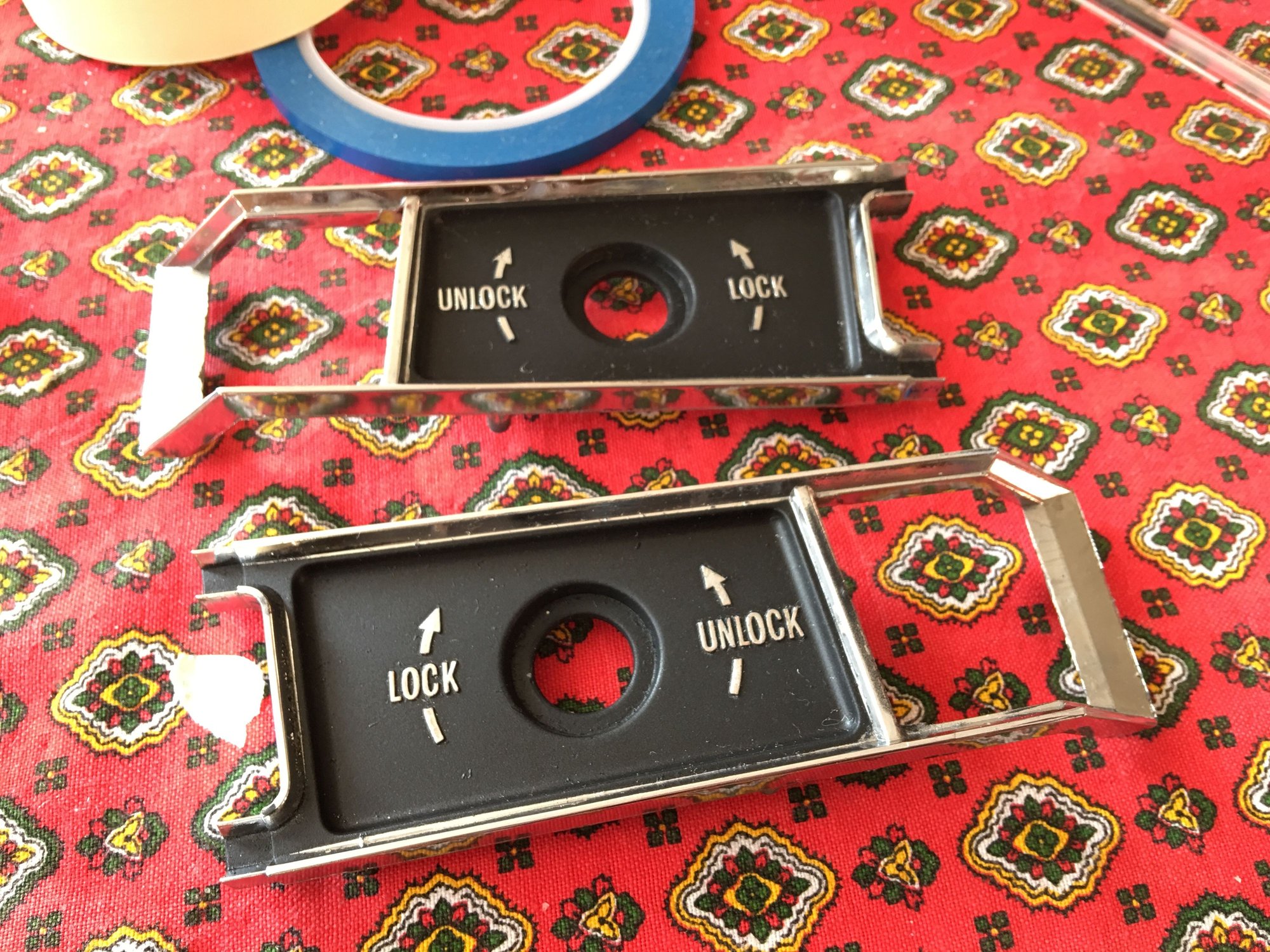

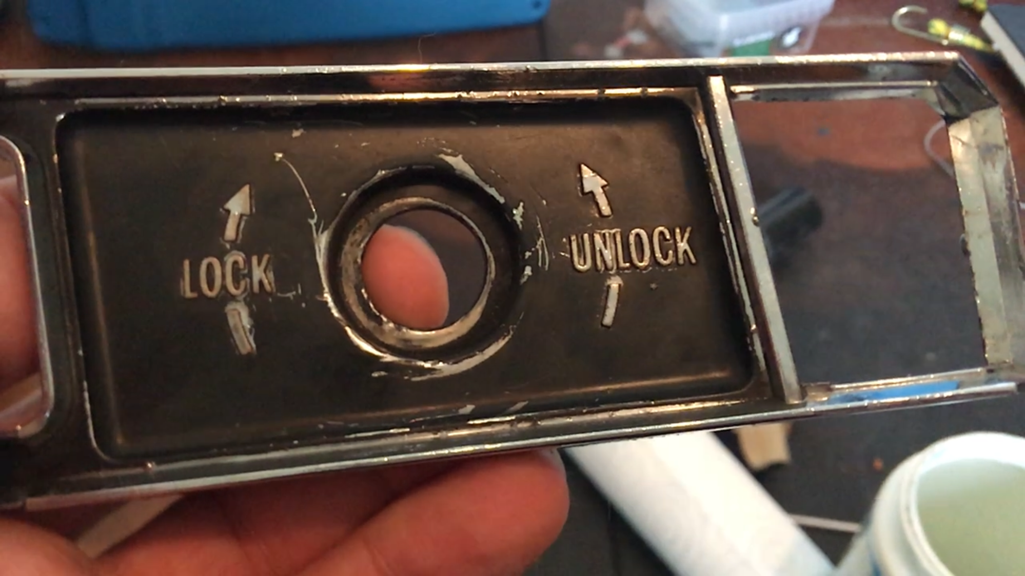

Let’s clean up door trim

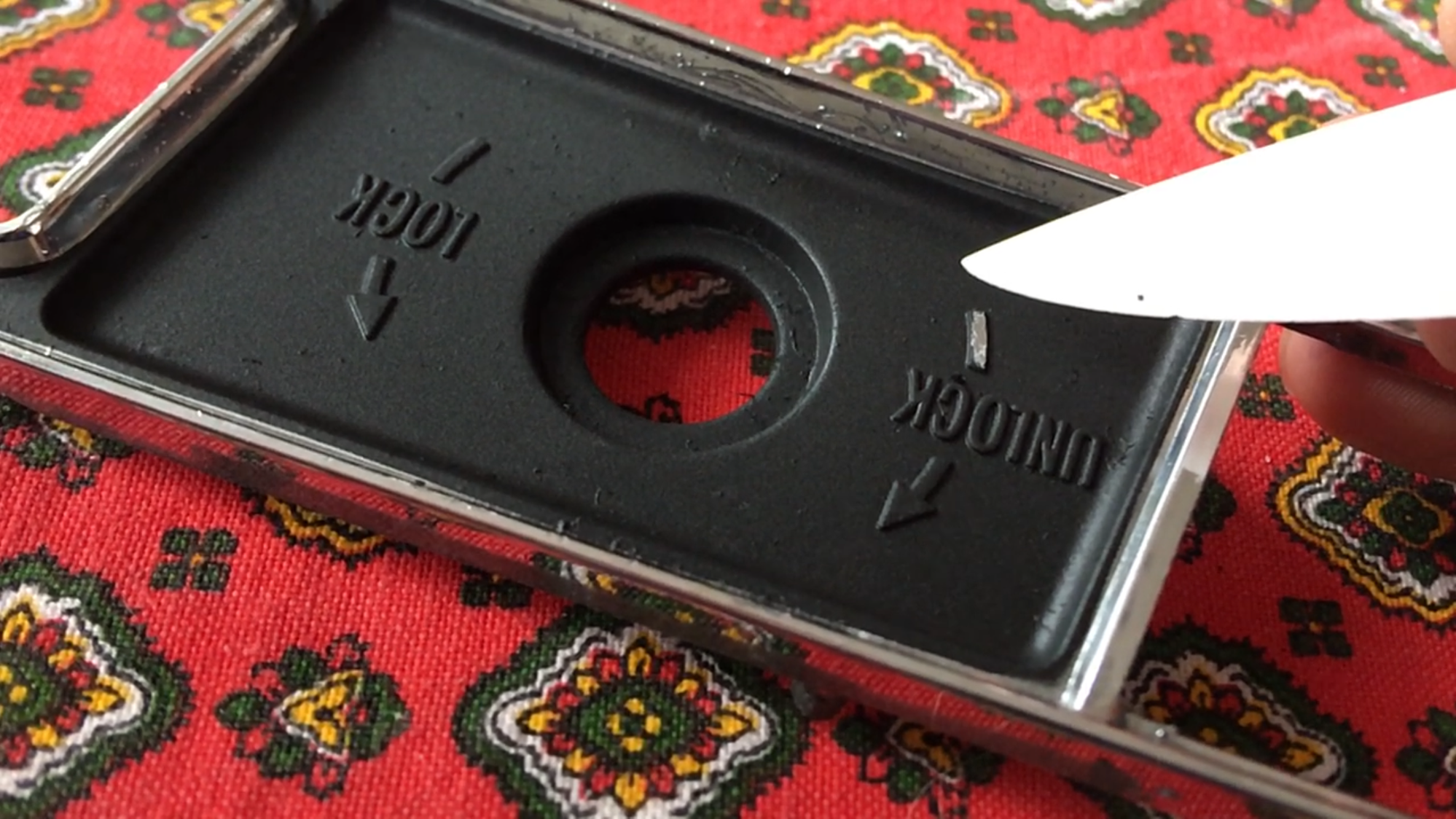

Hopefully some used door lock mechanisms too...

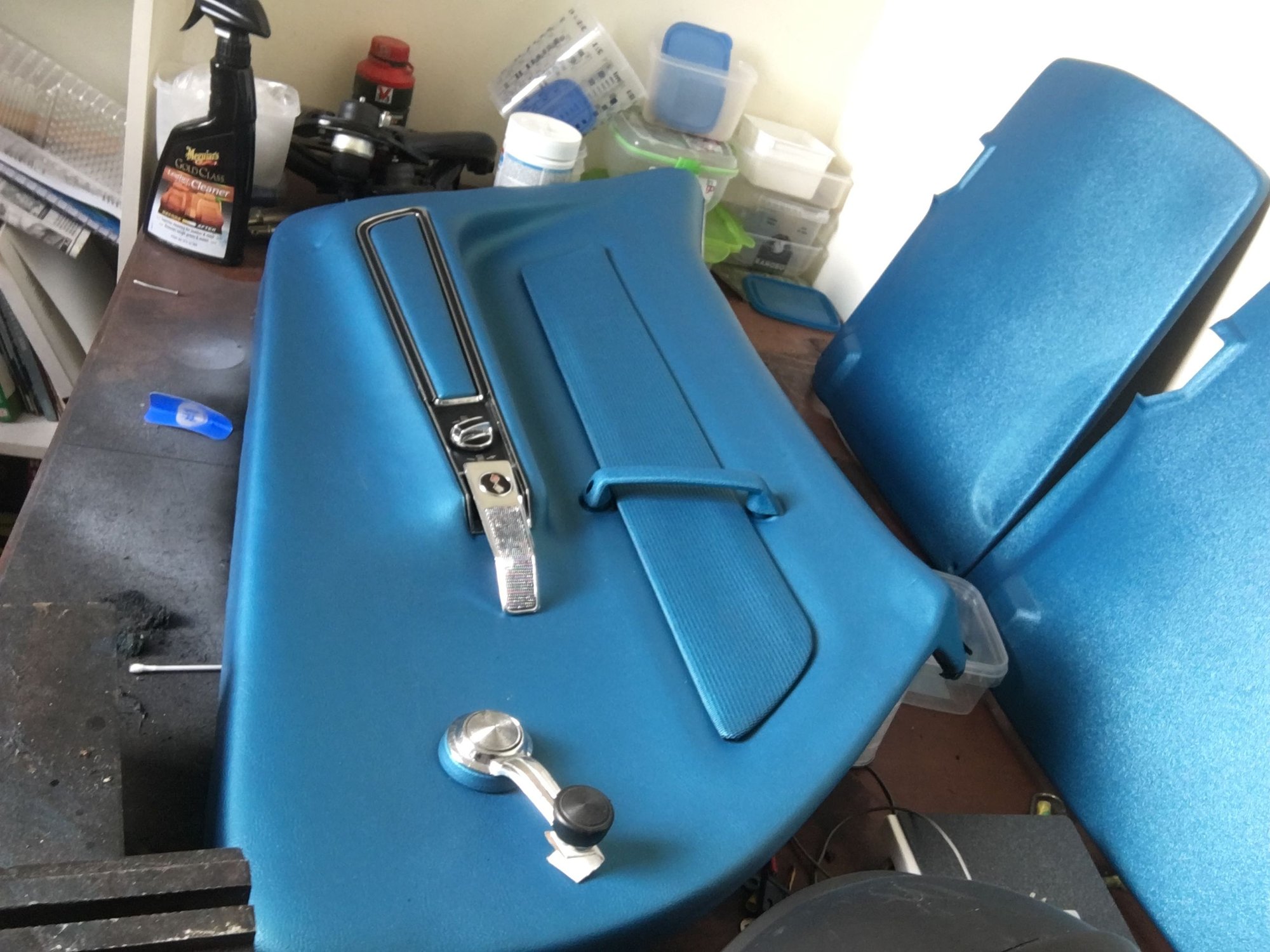

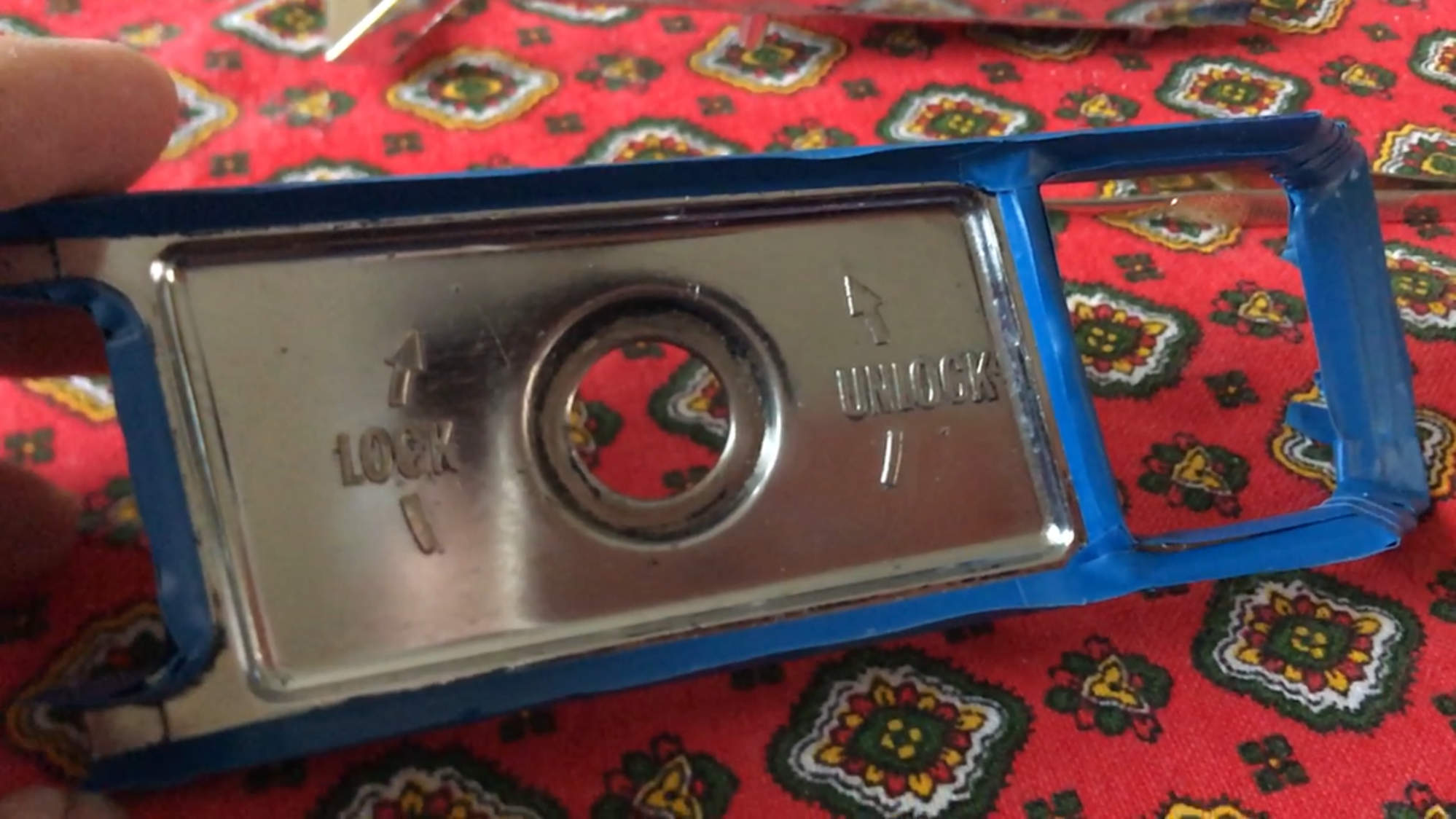

Door panel is also getting closer to finish.

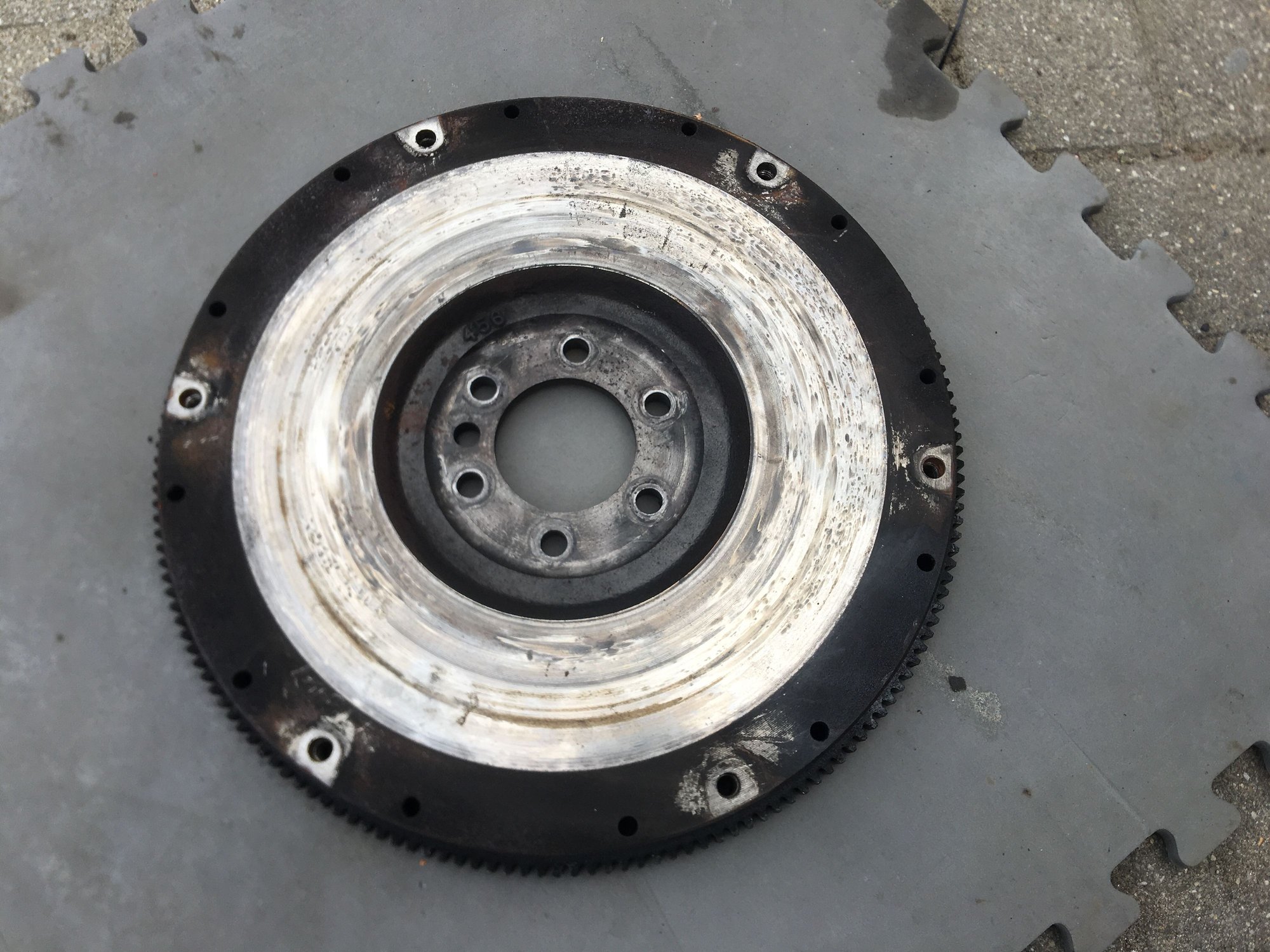

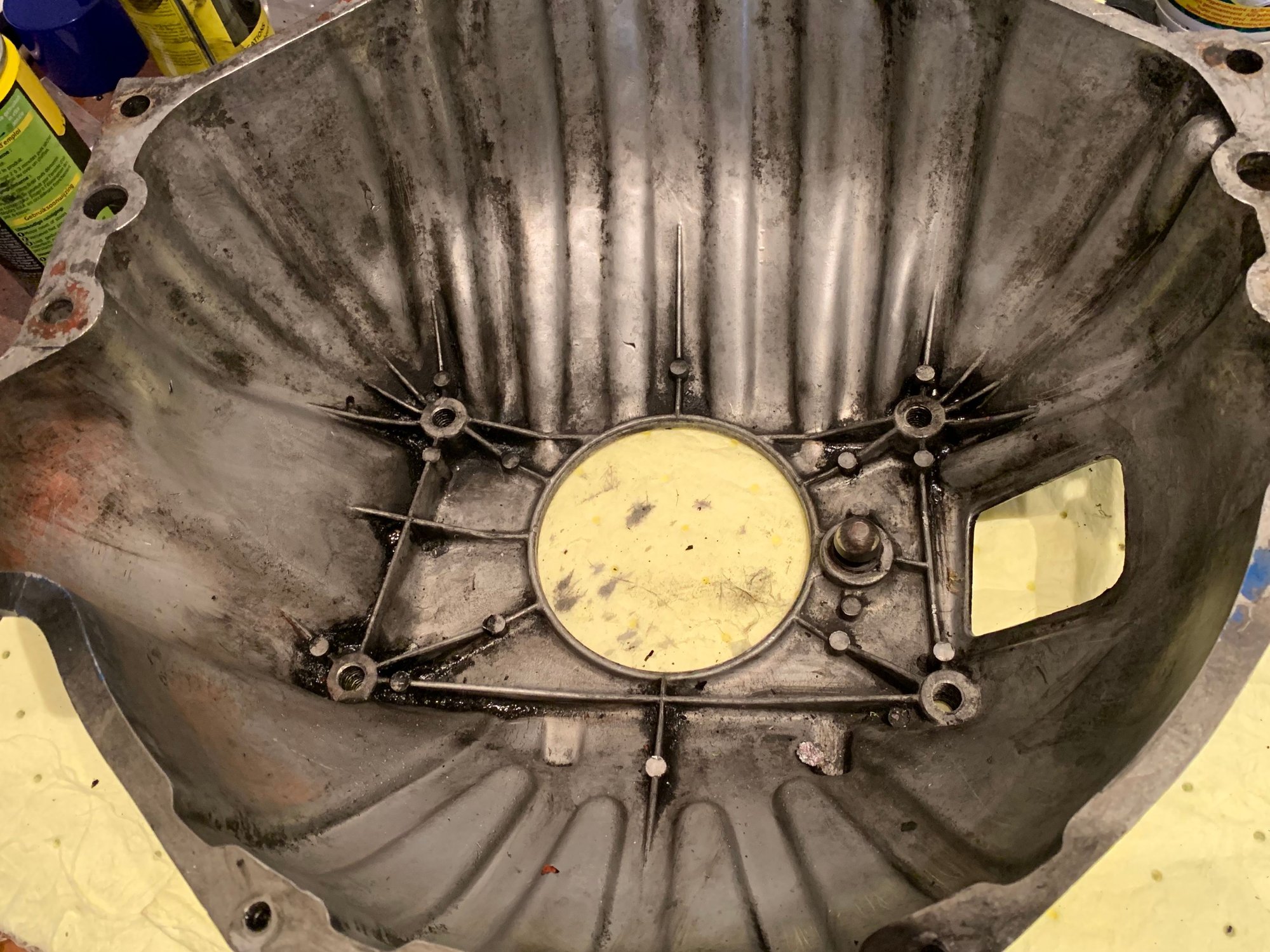

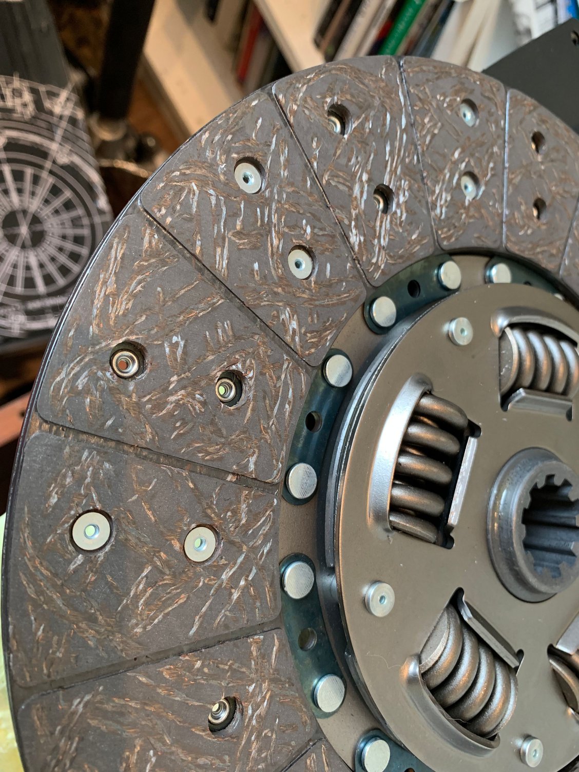

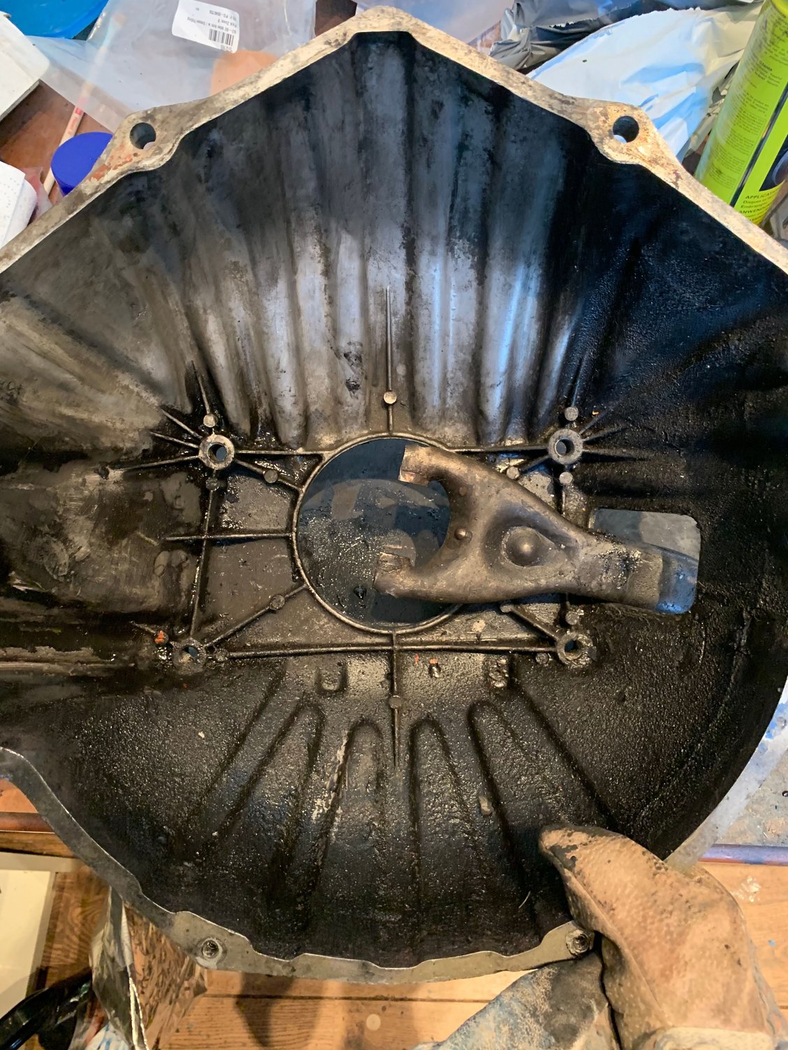

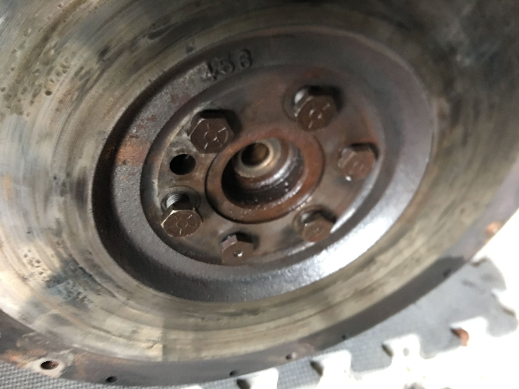

The clutch kit came in. I’ve never really worked on manuals before, but I think we can safely say that the disc was worn. I am hoping that, along with the dry rotted motor mounts, this was the source of vibration when cruising at 60 mph. The vibration was mild but rather annoying. I also noticed that the pilot bearing was rather sloppy - that is going to come out too.
The corvette was also quite difficult to get moving. Comparing with the new clutch disc, it’s quite obvious why.

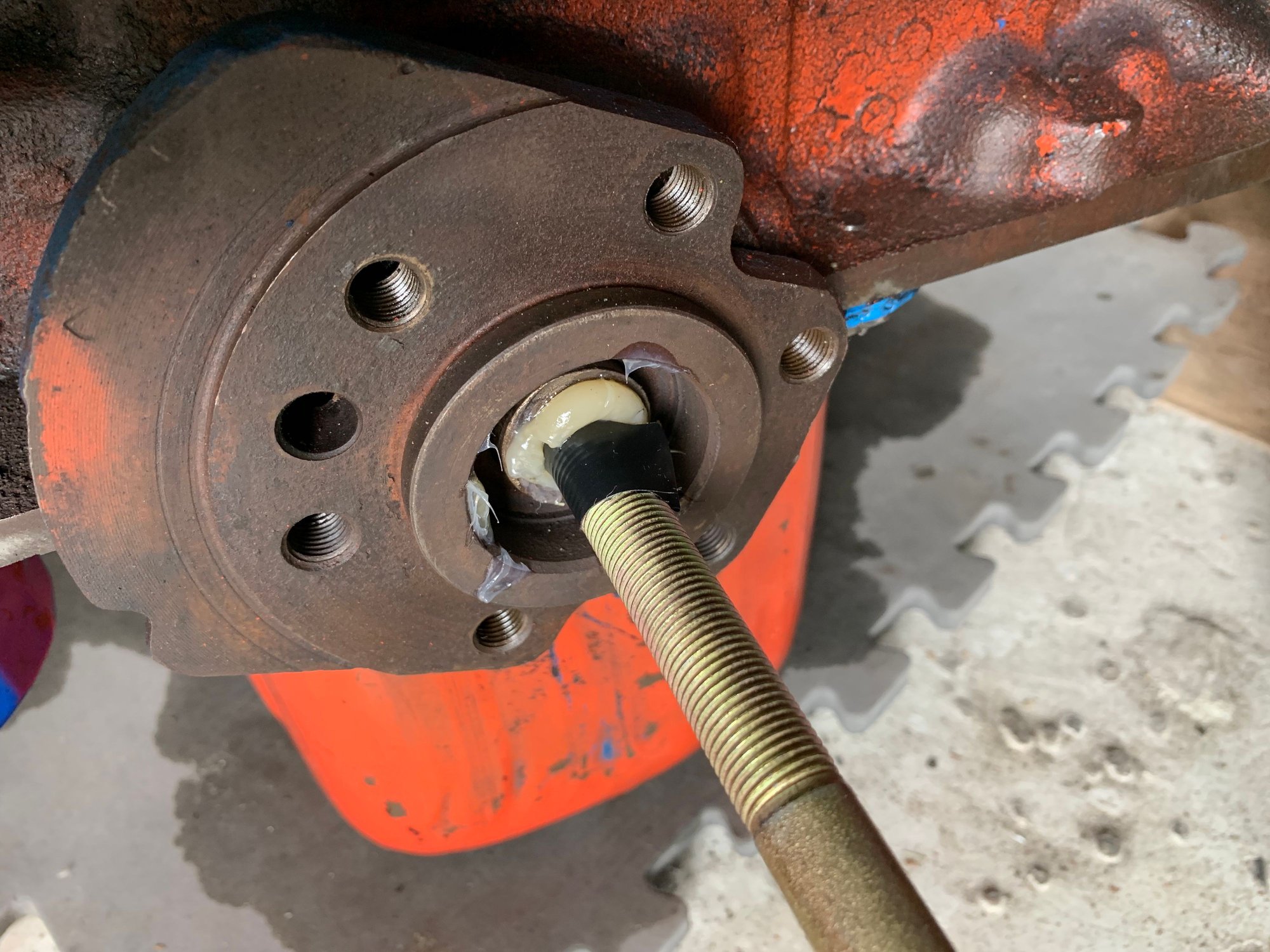

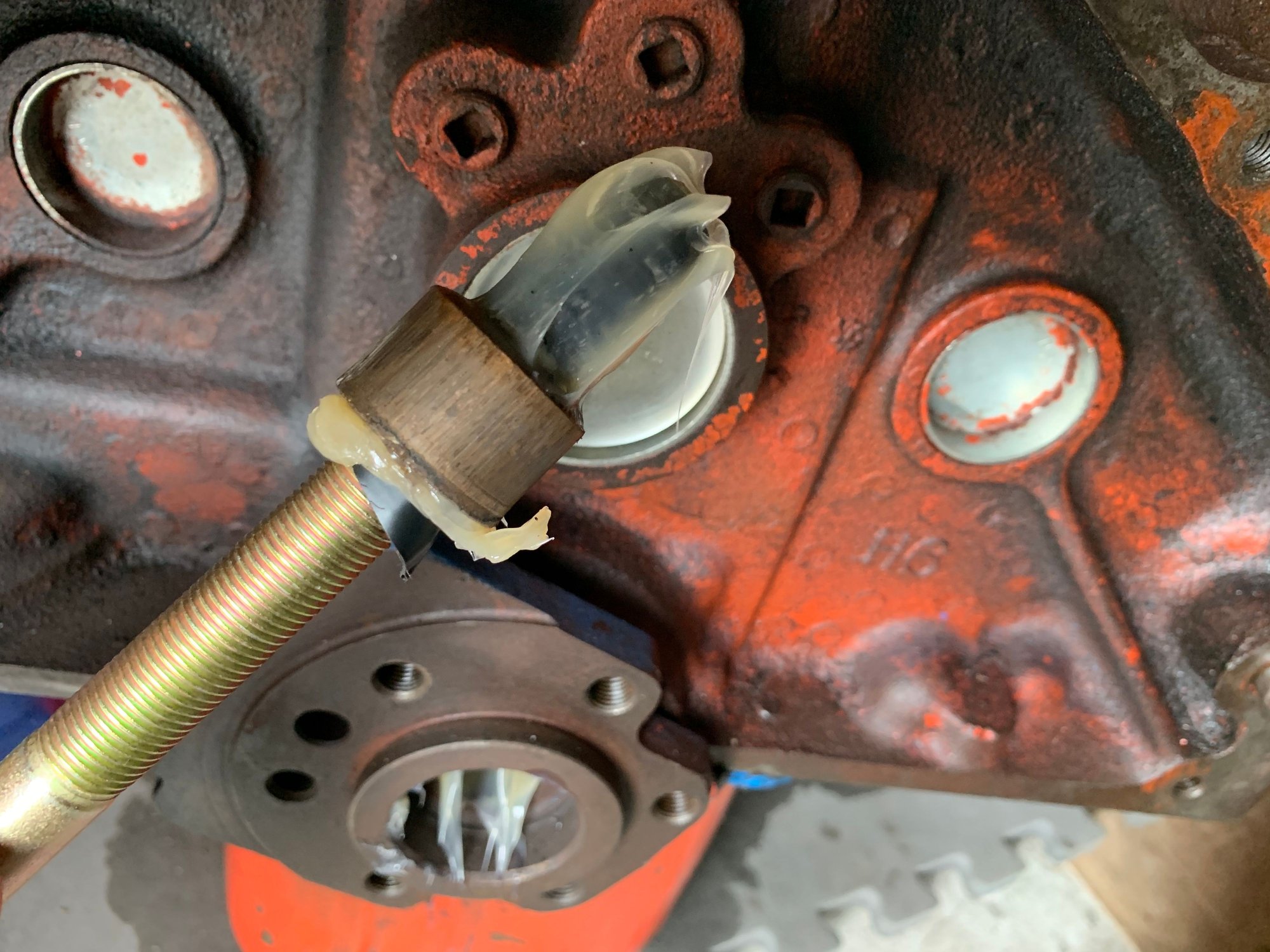

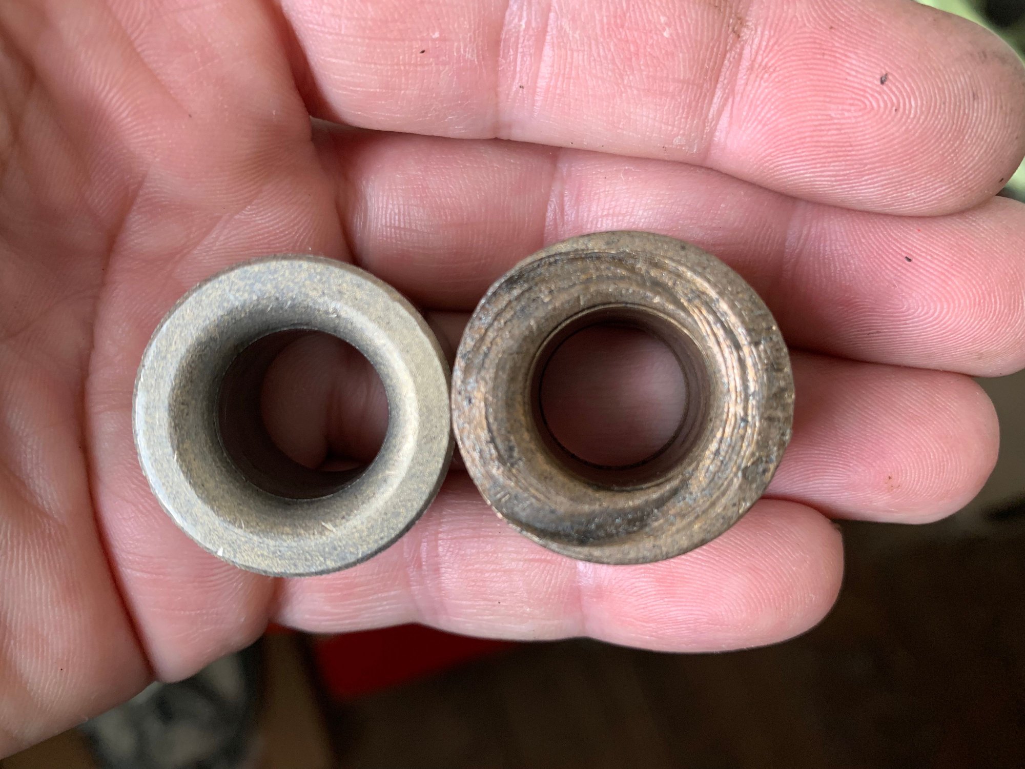

And with a little help from my friends, out comes the pilot bushing/bearing ?
I used a bolt, wrapped twice in electric tape and packed the cavity with grease. It came out immediately
It was silly easy... for once !!!

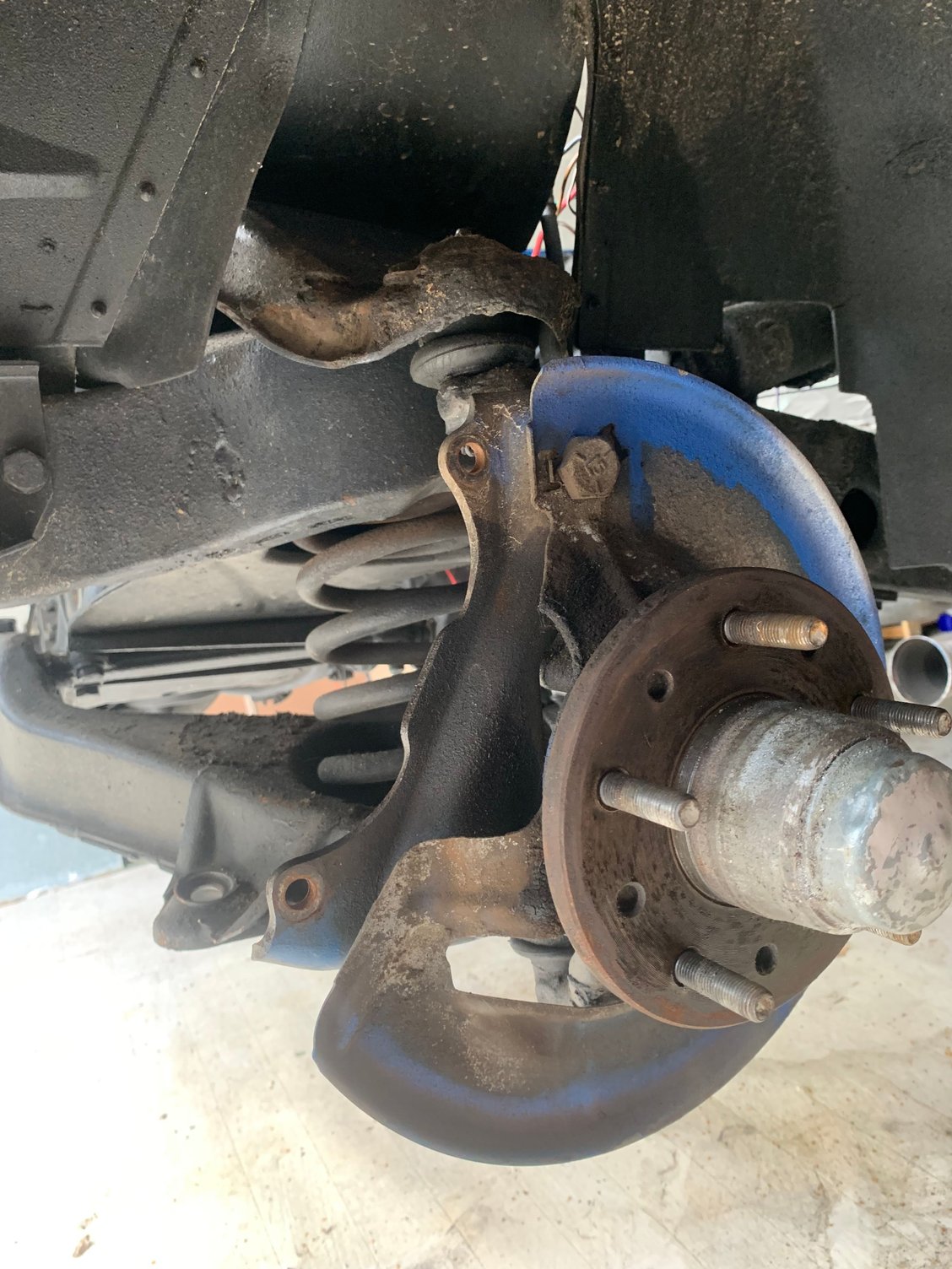

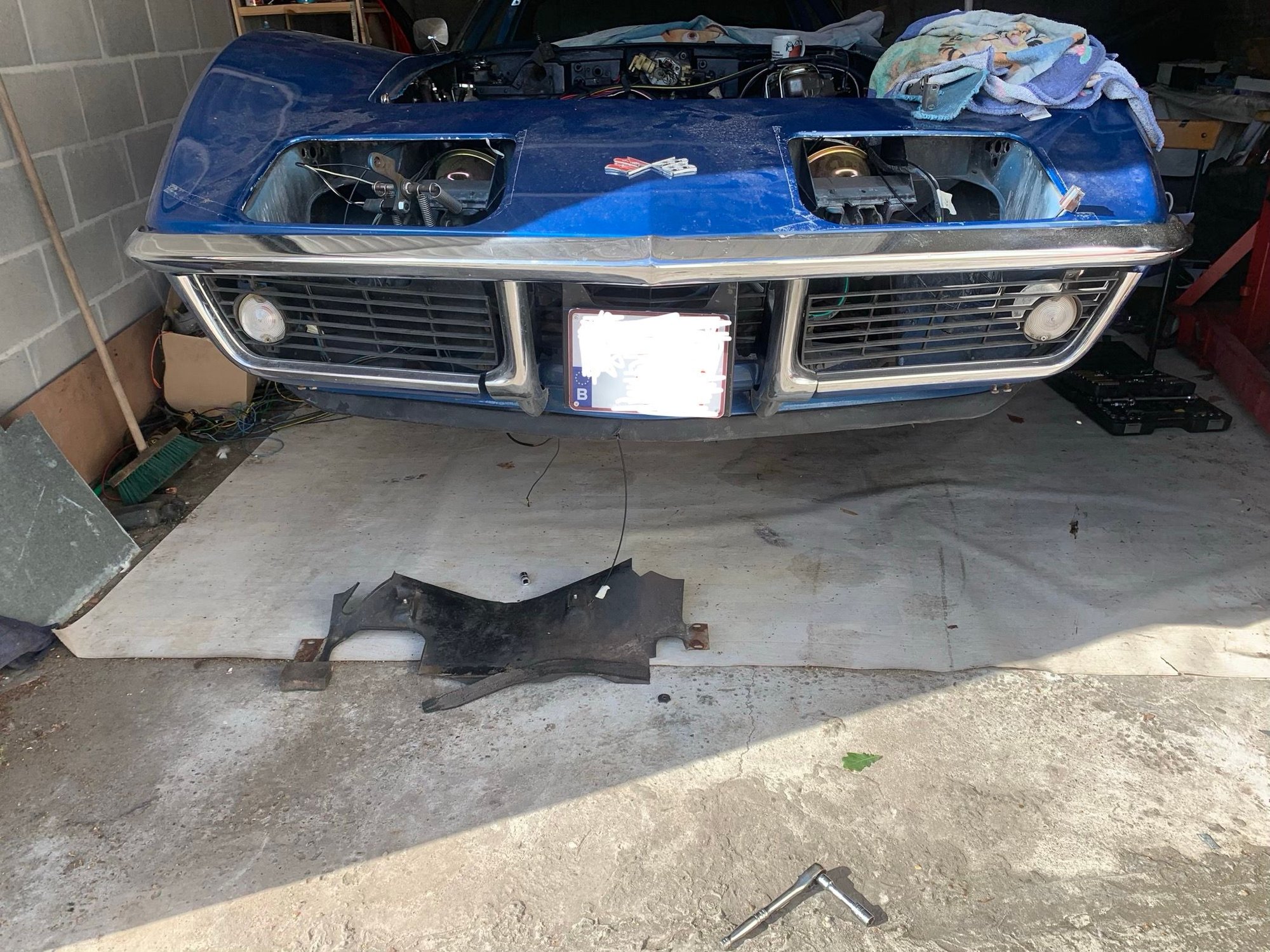

Today, we begin the suspension rebuild and upgrade the steering with a Borgeson kit.
More bubba was found. Surprisingly, not a scratch... not even a single nick on me
So first we turn the car around.
Remove wheel and raised as high as I could.

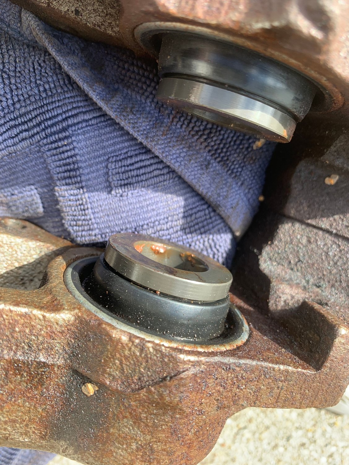

I tried removing only the rubber brake lines, but it got so kinked up it seemed more of a hassle than to just remove the caliper entirely. I couldn’t detect anything wrong with the bearings.
As far as I can tell these the seals look in good shape. I don’t think these are OEM pistons. At this point I’m not sure I will bother sanding and painting. This show needs to keep moving. Detailing can come later. Then again, I’m very wishywashy.

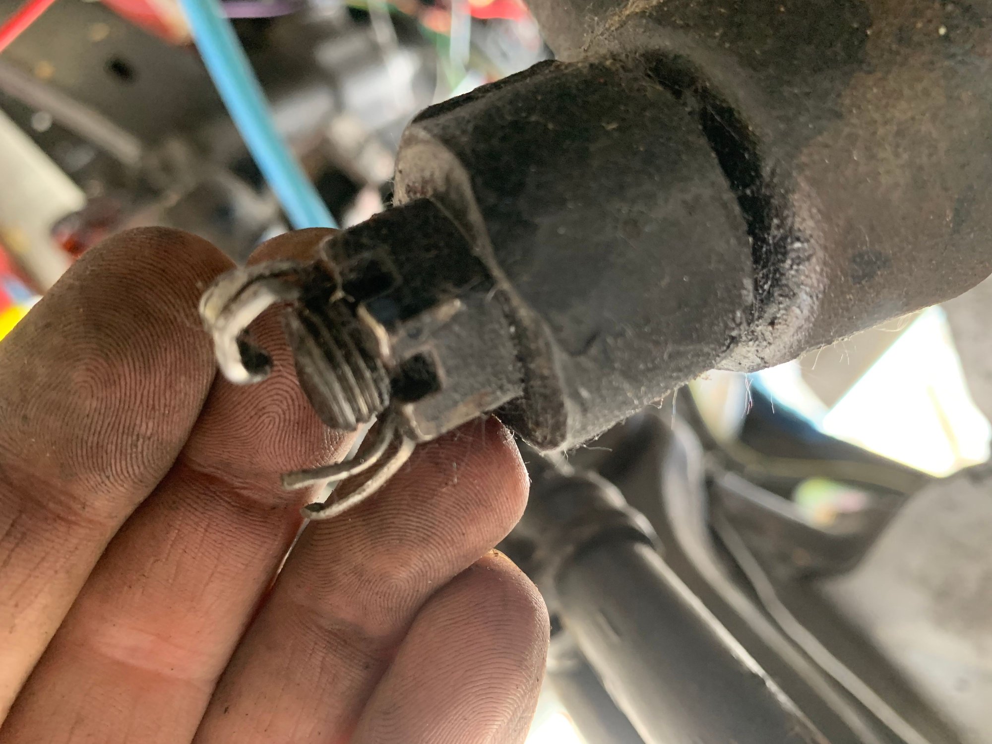

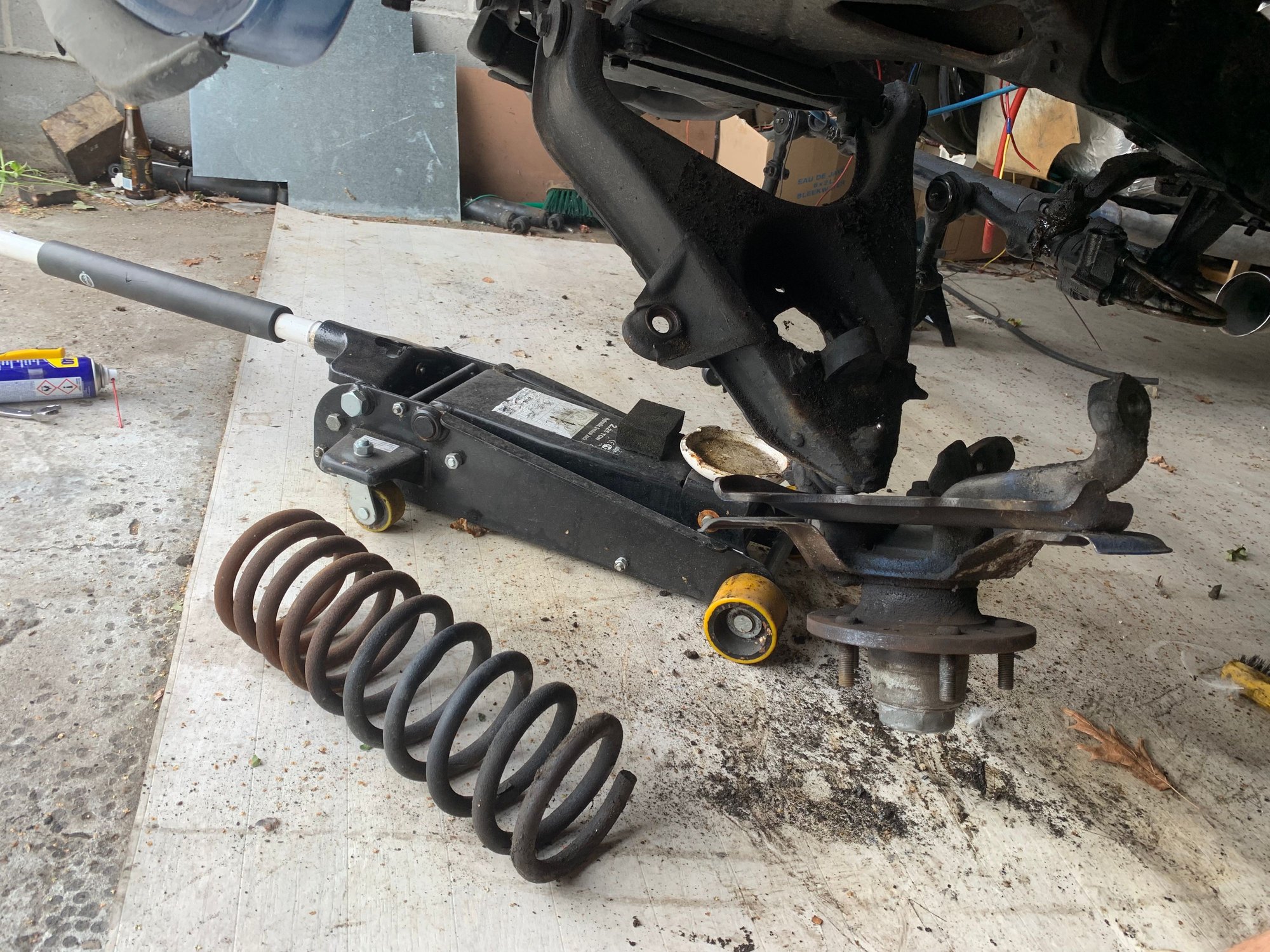

Here we have bubba cotter pins. There were a few of these around.

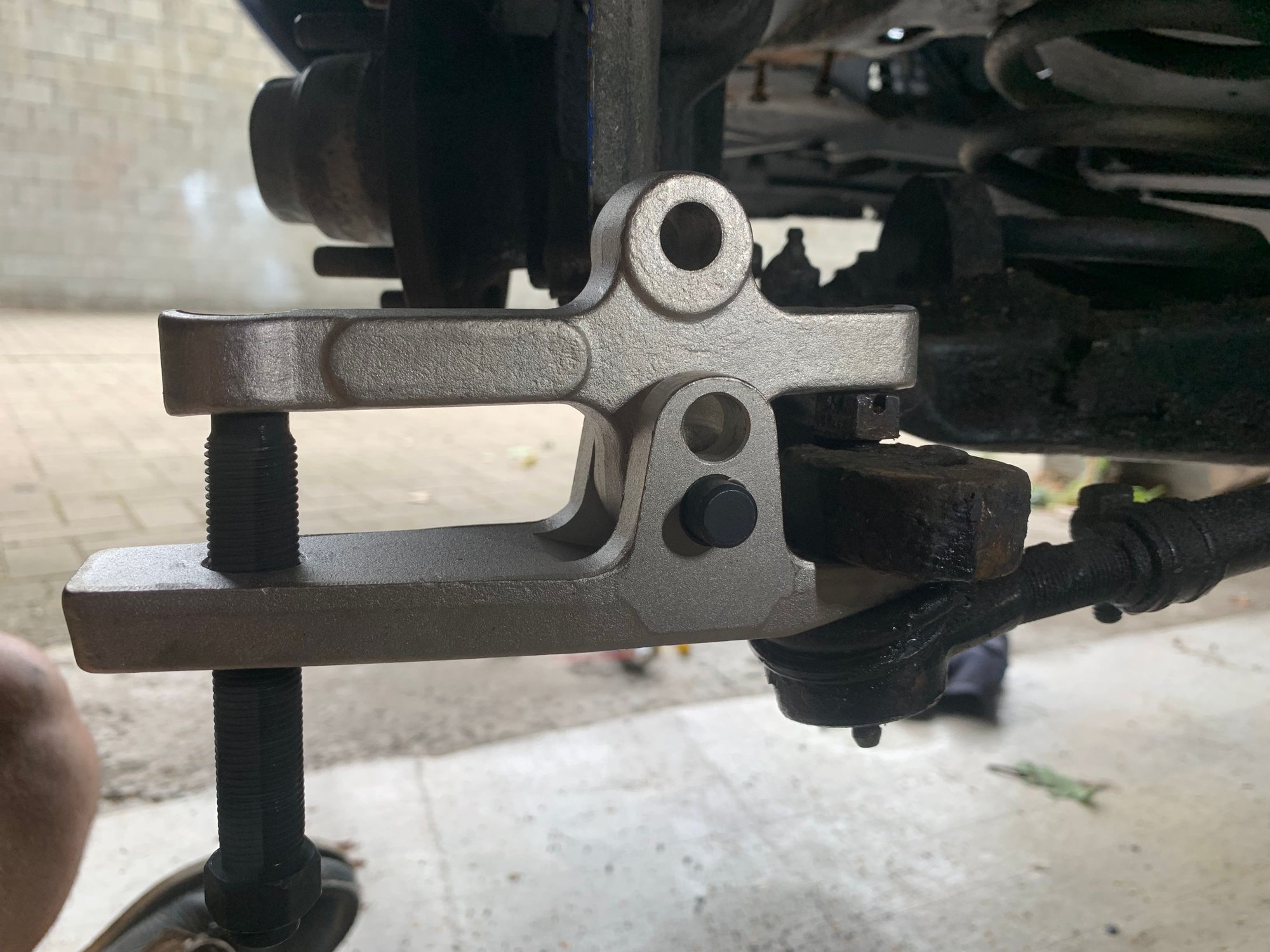

This tool was fabulous. So much so that I never had to use a pickle fork. The first couple of pops required a change of underwear - but I quickly got the hang of it and popped every single ball joint with it.

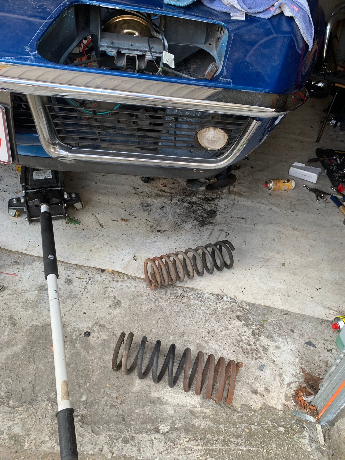

With the engine out, there wasn’t enough weight to slightly compress. I learned this trick from working on air-cooled VW rear suspensions.
First spring out without a compressor.
Two out. This turned out to be easier than expected. Much !

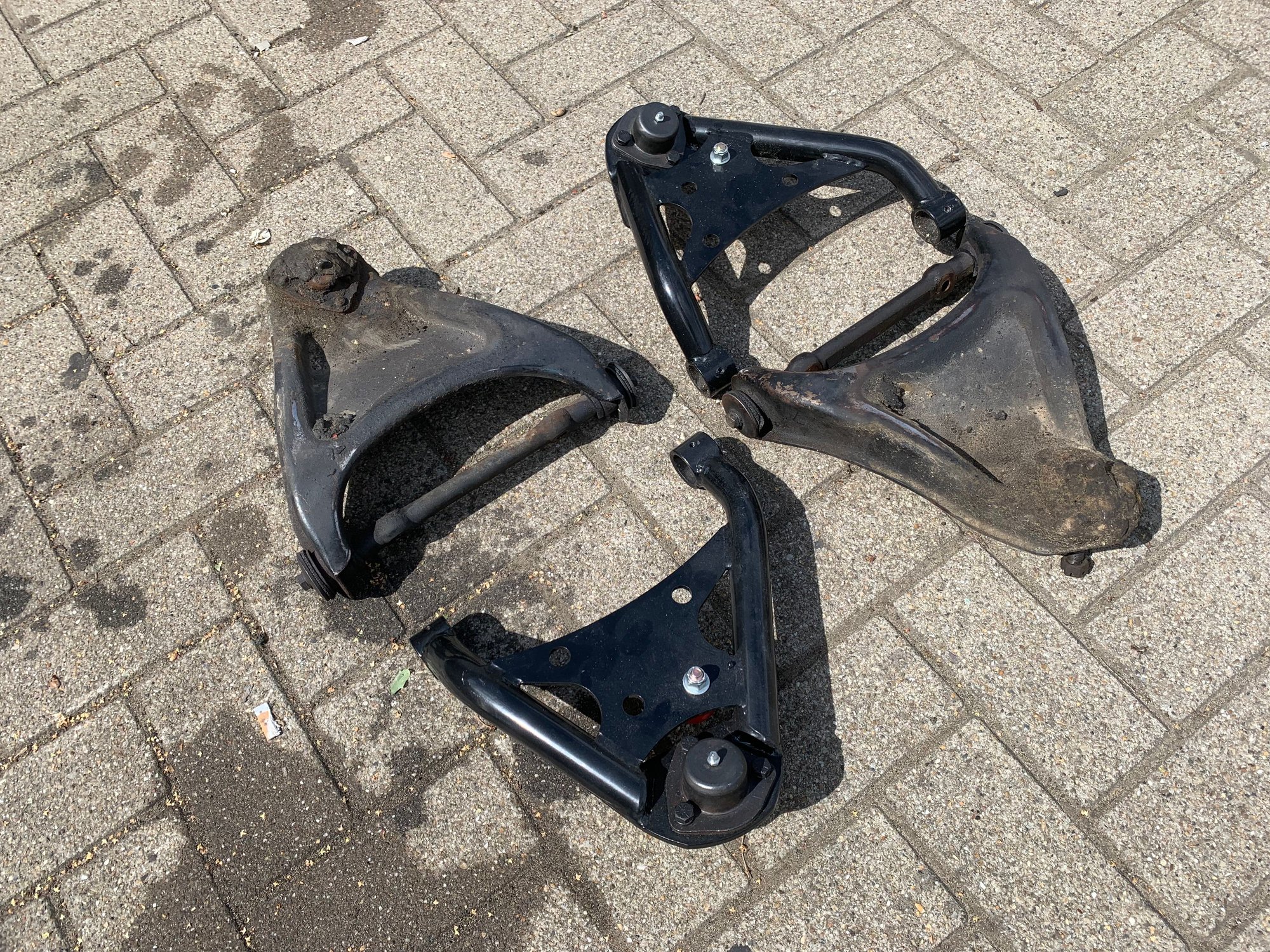

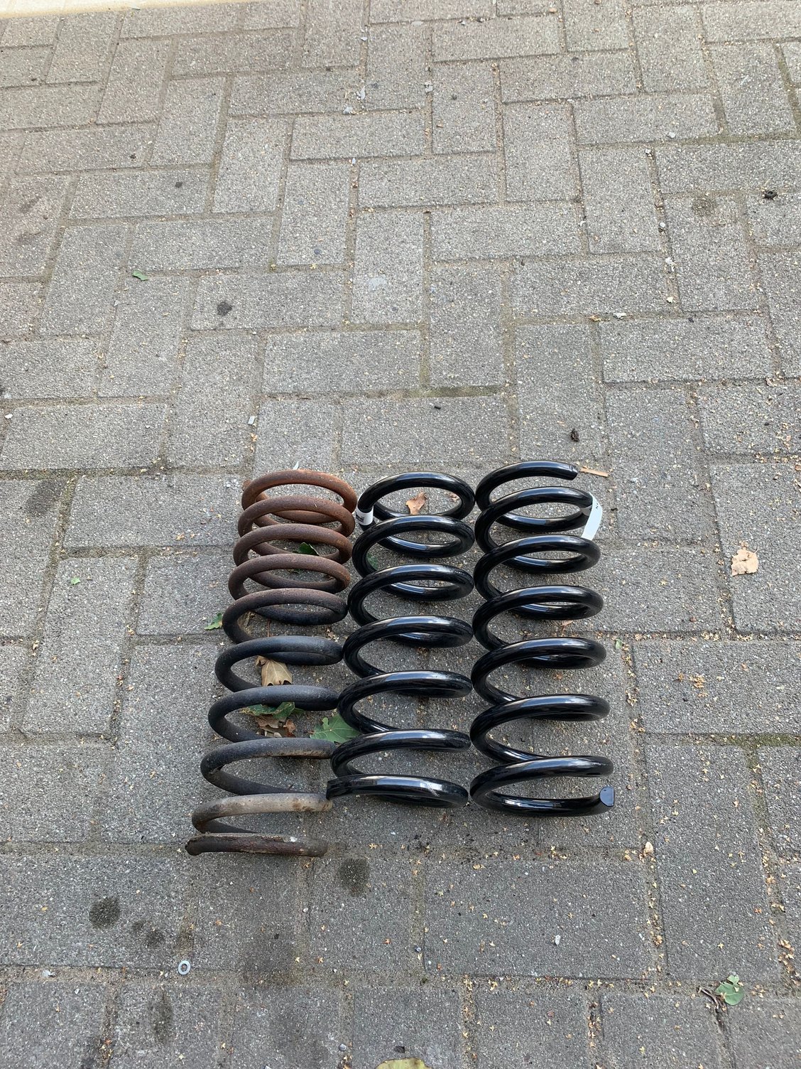

The old upper control arms will not be reused. So I won’t bother cleaning them up. They seem to line up fairly well with the new ones. The tubular ones came with aluminum bushings.

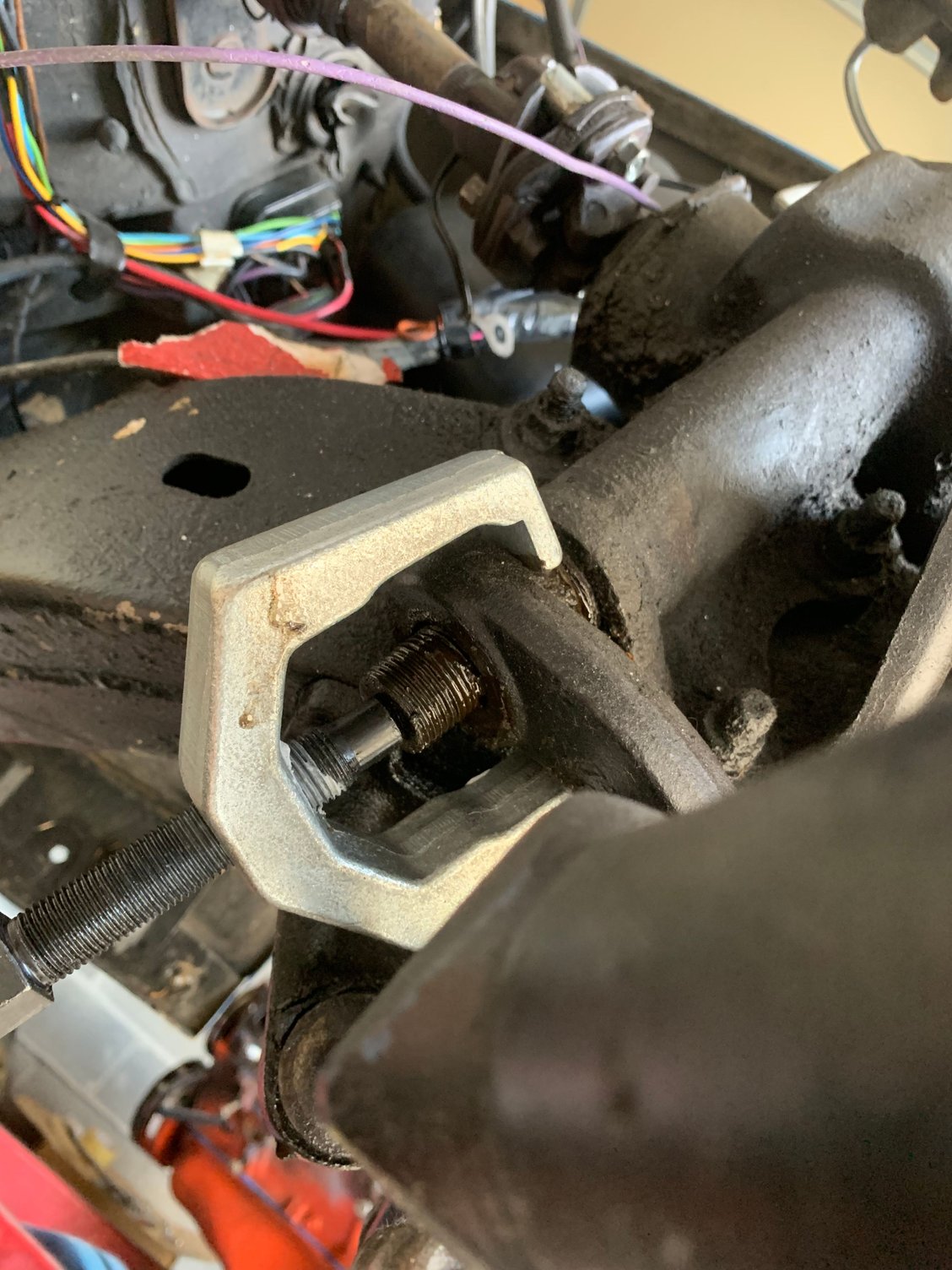

New springs. Clearly shorter, these are rated at 440#/inch. They were less than $100 for the pair. I wanted to go with a higher rate, but they cost twice as much. This is a good start. It will be a significant improvement nonetheless.
This was interesting. The nut retaining the arm was loose ! The puller hardly had to work to get it off.
