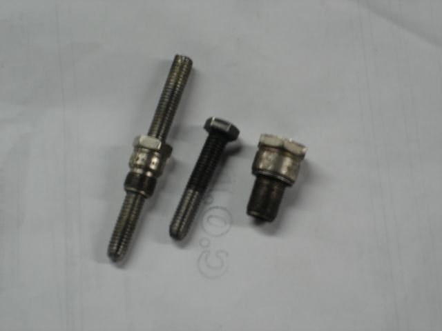

Originally Posted by DorianC3
. (Anyone have a tutorial on converting a spark plug into a piston stop?)
All I did was bust out the porcelain. Grind off the tang. and use a tap and I believe it is a 3/8-16 tap and tapped out the metal portion of the plug an put in a long bolt that I ground and polished round so it would not nick or gouge the top of the piston when it makes light contact with it.
I will post a photo of mine tomorrow.
Just keep in mind and I do not know if it has been mentioned before...but I would remove and cap off all unneeded vacuum hoses from the intake vacuum fitting and tune your engine without them attached.

Here are two that I made due to different types of spark plug types.
I have the bolt out of one of them.
Sometimes I need that long threaded rod due to the cylinder head design.

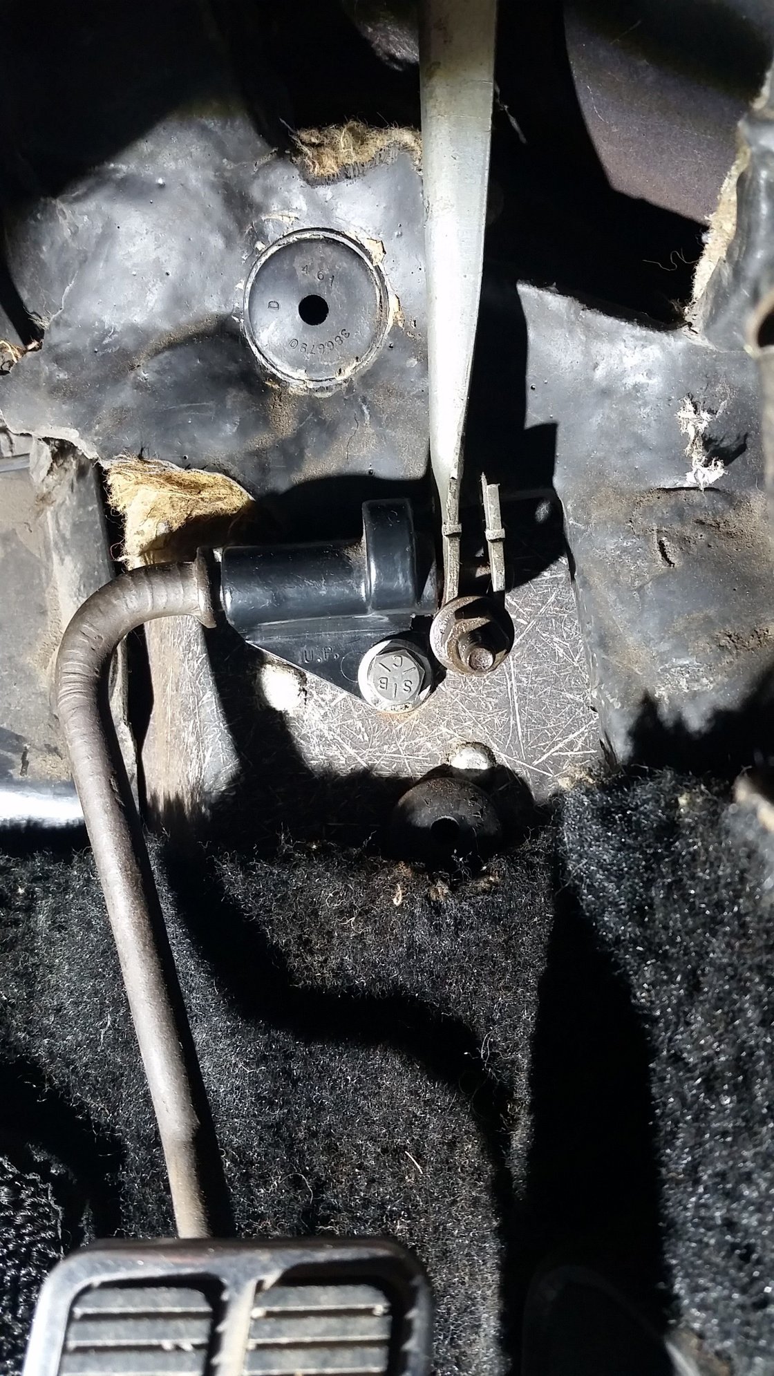

Also - regarding your higher RPM sluggishness. Take a look at your accelerator pedal pivot system on the floor. You had mentioned this as being one of your early issues. I found mine to have a loose clinch bolt, which caused it never to actually open the throttle fully, even when mashed to the floor. Needed to make sure all the slack was out of the system with the pedal at "rest" by tightening that bolt where it clinches around the pedal rod. Then adjusted the cable until you can SEE the throttle opening fully when the pedal is floored.
I had driven mine for about 6 months before I discovered this, and it was like I had installed a super charger after I fixed it!!!

As for the gas pedal, I think you are onto something... but on the other side of the spectrum. When the pedal is if fully down, the carb is at WOT. However, I think I noticed that there is slack in the gas pedal so that at tip-in the input is not relayed to the carb. That would make moving off the line more difficult. This weekend, if I am not sent out on some damned fool-mission, I'll get a closer look.

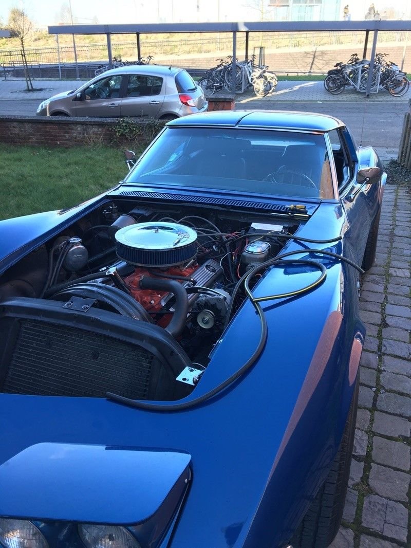

Ever hear of the car known as "La Jamais Contente"? Built in 1899 in Belgium, it was purportedly the first car to break 100kph (62mph). It was battery powered and shaped like a torpedo.
https://en.wikipedia.org/wiki/La_Jamais_Contente
La Jamais Contente means: 'The Never Satisfied'. Which pretty much sums up my feelings about my C3 for the moment.
I have had it a few months and have yet to reach fully daily driver status. There always seems to be some ****ling detail that keeps any of my projects for being 100% complete. That pesky oil pan drip, post cam swap, is a good example. It is not a big drip but enough that little wisps of smoke emanate from the "gills". This drives me nuts!
I know. I know. I am spoiled. With a couple of wiped cam lobes, it could have been much worse.
Well, I replaced all the vacuum hoses and switches. (Freezing here but fortunately dry... note the Belgian cobblestone, or 'pavé', driveway) Fortunately, most of the vacuum circuit seemed to be intact; very little Bubba there. Even better, the behind-the-tach solenoid and headlight switch work fine and did not require replacement.
I also replaced the wiper-motor. It turns out the motor that was on there was from a later model not designed to be used with a wiper-door. It had no independent power provision.
OEM, the wiper motor only gets power once the wiper-door is fully open. In my case the inhibiting switch was still there but bypassed and then led... nowhere. This in addition to having no independent power provision on the wiper-motor.
This led to the wipers slamming into the door before it could open, thereby destroying the wiper transmission. PO must have been using the under dash bypass prior to engaging the wipers.
Well... all that is fixed... sorta. Enter La Jamais Contente. The dash switch is very crappy and not working well. I had replaced the defective one that was on there, but the replacement one is as bad. Its operation is vague and inconsistent. No clear slide-click-engage. (Anybody can recommend a good source that works!?)
Other than that, I am very pleased to see my headlights AND wipers working and not requiring the override switch. As a bonus, if it rains, I now no longer have to pull over.
