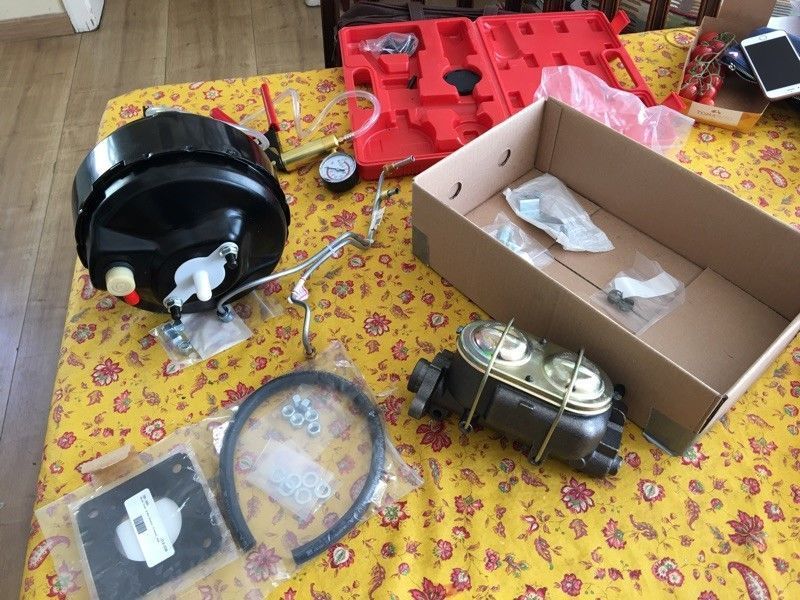

Finally, not this weekend but next, I will be doing a power brake conversion. The brakes on there now are adequate... but... come on !

I did the power brake conversion. For details, see here: https://www.corvetteforum.com/forums...onversion.html
I am quite pleased with the brakes, tho some more tweaking seems required.

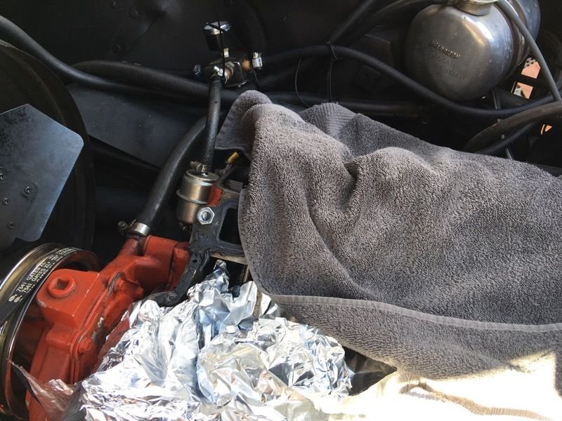

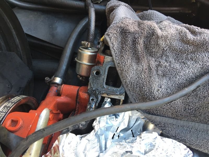

I was running quite rich at idle according to my plugs and popping in mufflers. I hate popping in mufflers.

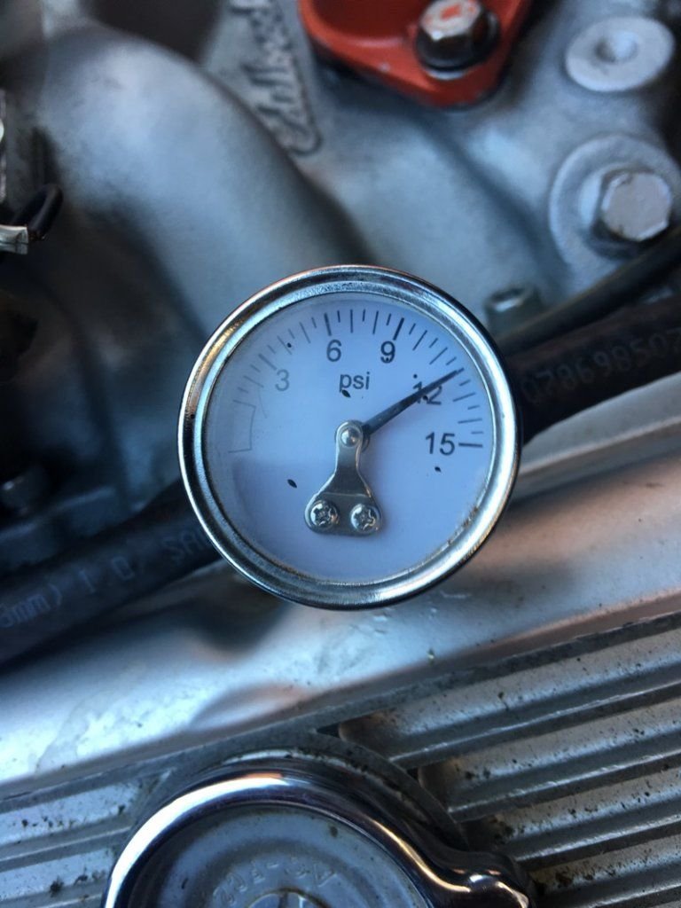

Having ruled out everything I could there was one last thing to check: fuel pressure to the carb.
A quick check and... well, that's unequivocal.
I temporarily cannibalized the pressure regulator from my Karmann Ghia and, sure enough... popping was gone and the plugs started cleaning up. But we are not there yet.

Just to confirm, that fuel pressure seems high, no?
How did you adjust it?

I kind of have to agree that 12 psi is kind of on the high side. I am more into it being 6 to 9 psi. But what do I know.
I fell that with it being that high the only issue that could occur is the fuel gets past the needle and seat and can fill up the front blow to the point where you have geyser and fuel flows out of the vent of the carb or drips in the carb depending on what carb you have and it causes for a really rich condition at idle.

6-9 psi is perfect.
For a moderately modified engine, closer to the 6 psi range.

The reading above of 12 PSI is in prior to me borrowing the fuel pressure regulator off of my Karmann Ghia. I cranked it down to 5 PSI and immediately, it cleaned things up.
I did not take a picture of how I installed the fuel pressure regulator, because it was simply ghastly.
I did order, however, a new one, off of Summit and this weekend, assuming the delivery arrives by then, I will be installing it.

I am glad that the problem was only in you adjusting the fuel pressure. Funny how something so simple can fix a problem.
I know you did not ask for this reply.. But I will write this. I work on so many fuel delivery system to the carburetor that are so screwed up that it would make your head spin. Often times the person who installed it used rubber fuel hose and that is fine if you want to get it running. The problem; with rubber fuel hose from the fuel pump to the carburetor is that IN TIME...if the hose is not periodically checked and inspected. The hose can get hard and possible crack THUS causing for fuel leak. Which in turn...if not caught soon enough can cause the car to catch on fire due to often times this fuel spray works its way back to the distributor or to the firewall where the micro switch is for the wiper door equipped Corvettes and that can set one on fire if the fuel gets to an area where a SPARK is.
SO...on the fuel delivery system I often times custom make them so from the fuel pump to the carburetor it is hard lined with NO rubber hose and hose clamps or it is converted over to the stainless steel braided fuel hose and the correct fittings for it. I try at all cost to keep the number of fittings or places where fuel can leak to the bare minimum. So if a fuel pressure gauge or what have you is wanting to be added into the fuel line from the pump to the carburetor...I am very watchful of how I do it and try to make the set-up bullet proof even if it requires me to custom make brackets and clamps to secure these parts so they are supported and not able to move around or be stressed due to not having a support.

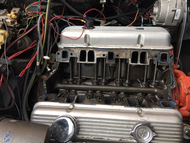

This had been annoying me for quite a while. A neighbor had a cheap welder. It was enough to weld a nut on there and get it off. The reason it was broken off? The bolt was metric.
A good basis to start...

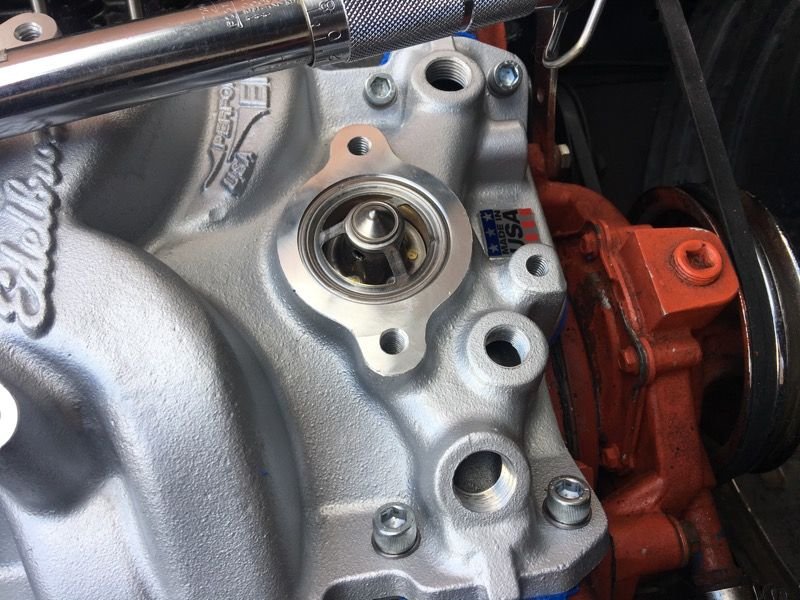

I hate the way aluminium corrodes... a little engine paint an no one is the wiser... I selected the EPS for price/performance/clearance
Neighbour kid works at BMW and wanted some hands on experience....
A Stewart thermostat. Expensive, but the last two failed very fast...

Also....GLAD to see you got a thermostat that already has a hole drilled in it .
