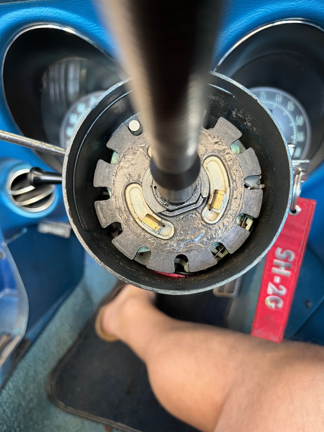

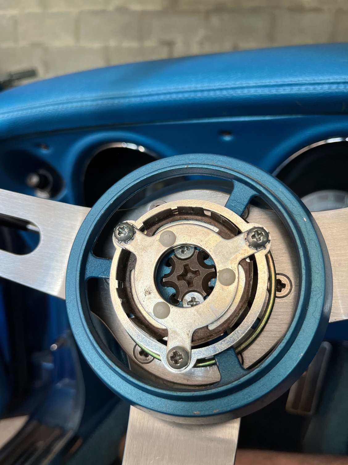

Enough being lazy. For the first half of 2021 I decided to simply enjoy the car and take it to car meets, etc. Finally, the play in the steering column got on my nerves to the point I decided it was time to rebuild it.
There are several things bothering me. The most annoying are the excessive play in the tilt steps and the steering wheel play.
Other things not working: horn stuck on, hazard lights not working, turn signal doesn’t cancel correctly and possibly a bad ground.
So it begins:

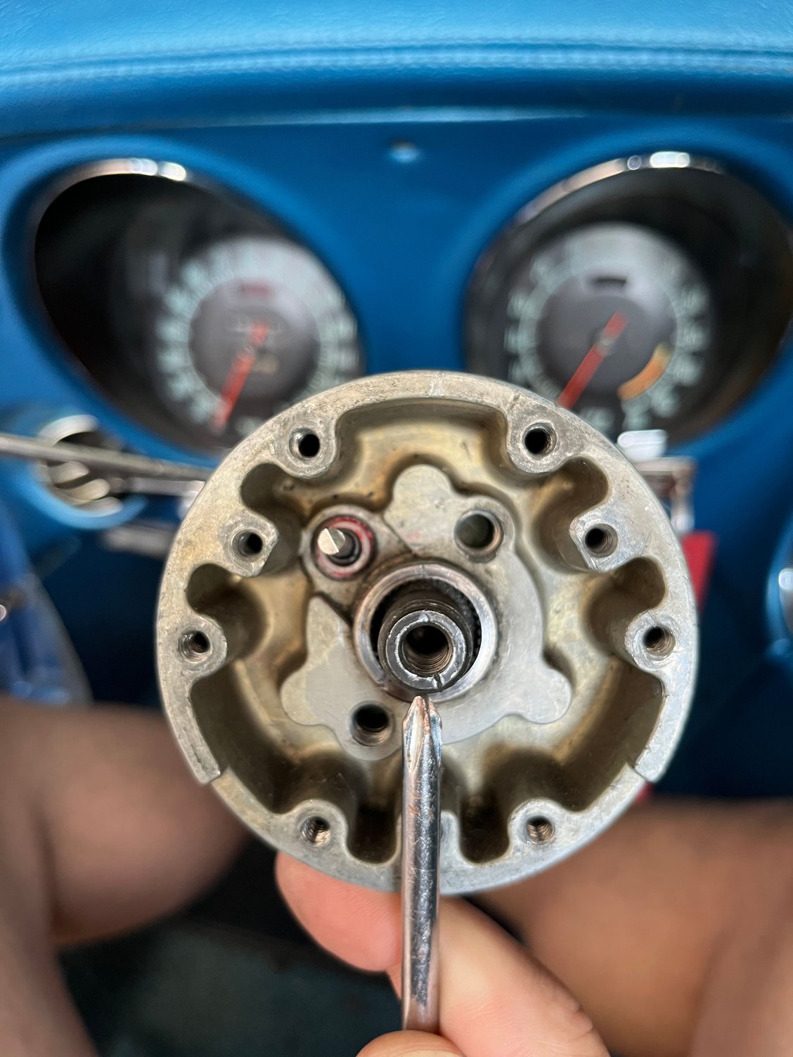

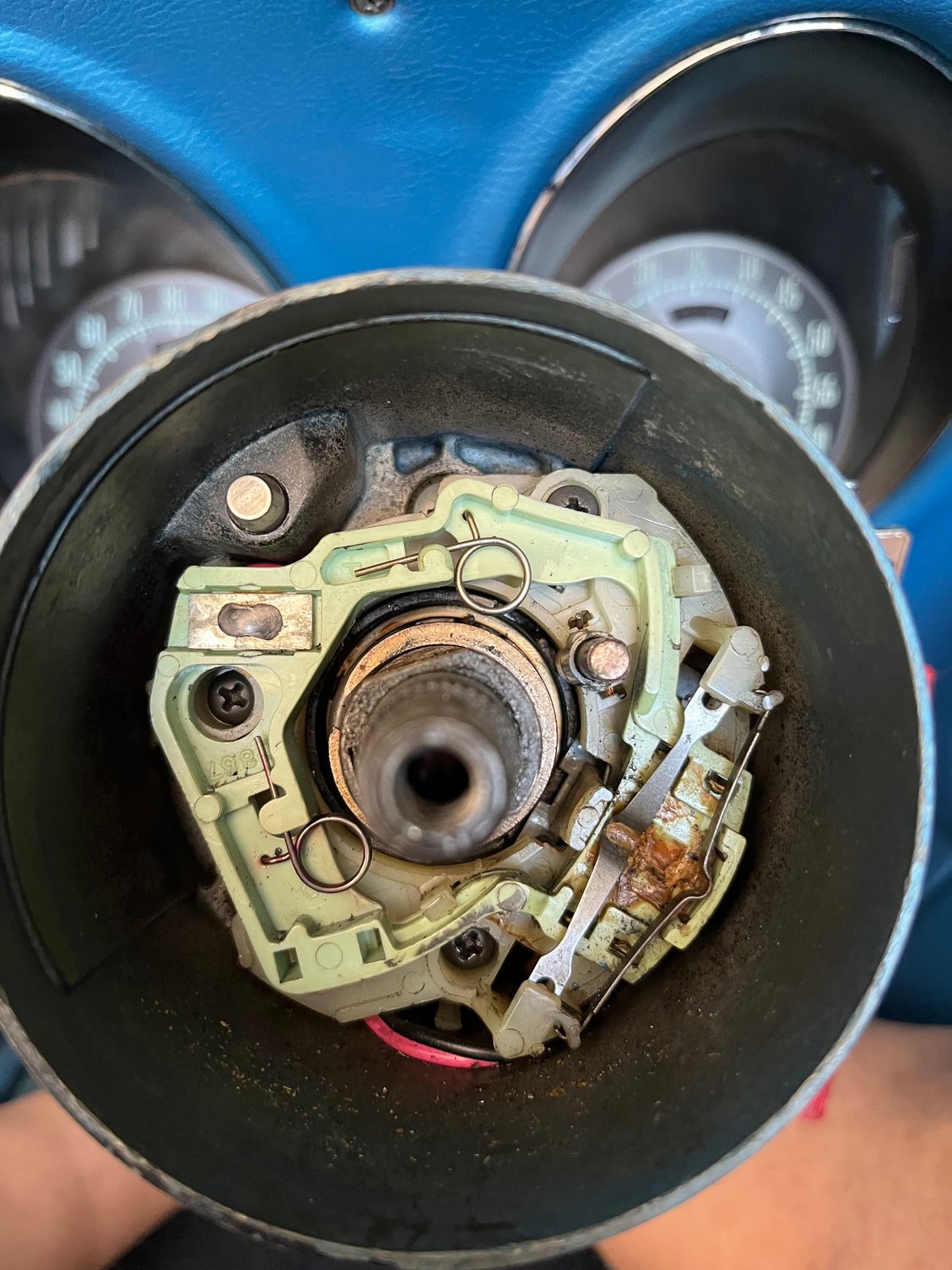

Hm. That mark probably should be straight down. As it is the steering wheel is off center when tracking straight.
I put a screw in there to prevent telescopic collapse
This cheap tool makes it easy. You still need to be careful though.
And first problem solved, the canceling cam is 180 degrees out.

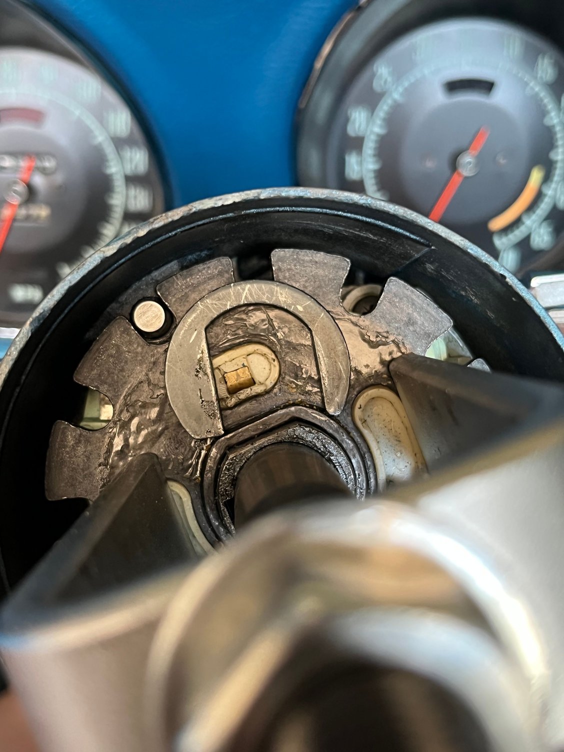

Stripped as far as I can go with the column in the car. Until now it was a useful way of holding in place while I worked on it.

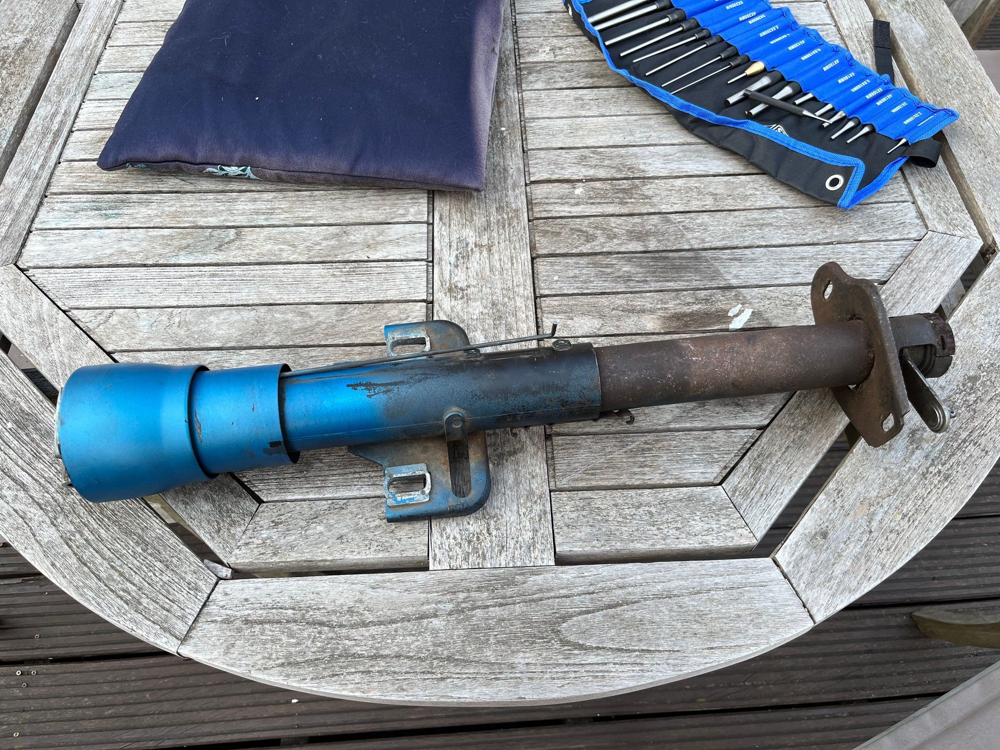

Out comes the column. This shield needs to come out.
As does this one.
The weird spring for the ignition rack.
Parking pawl.

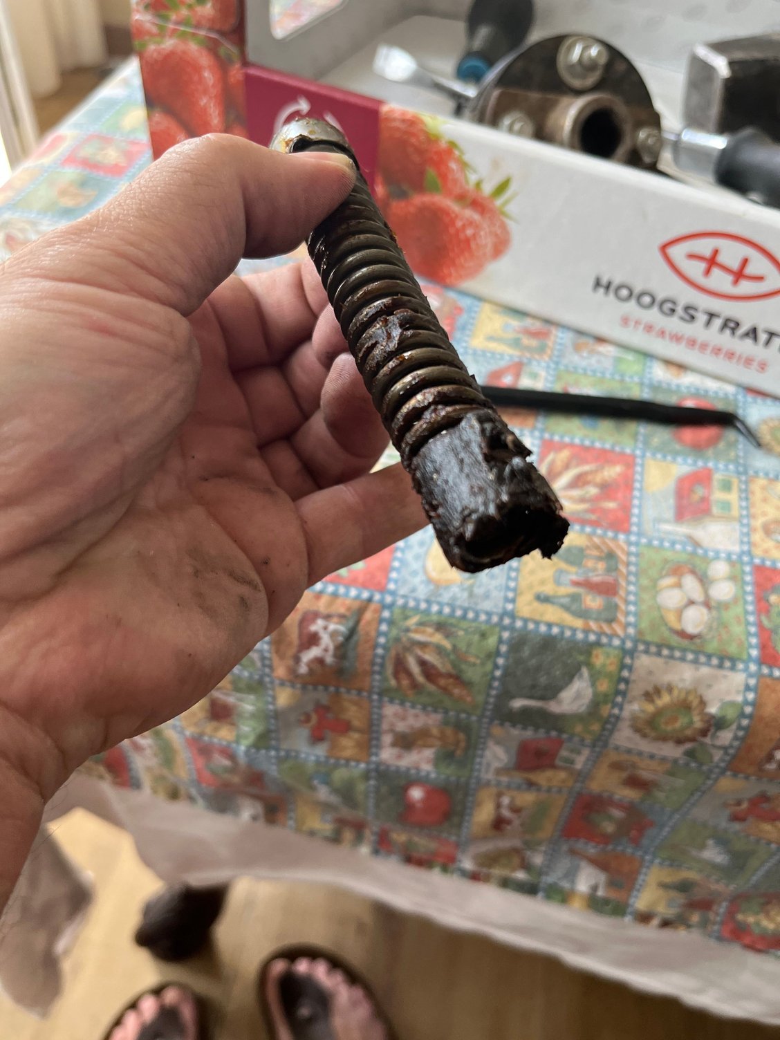

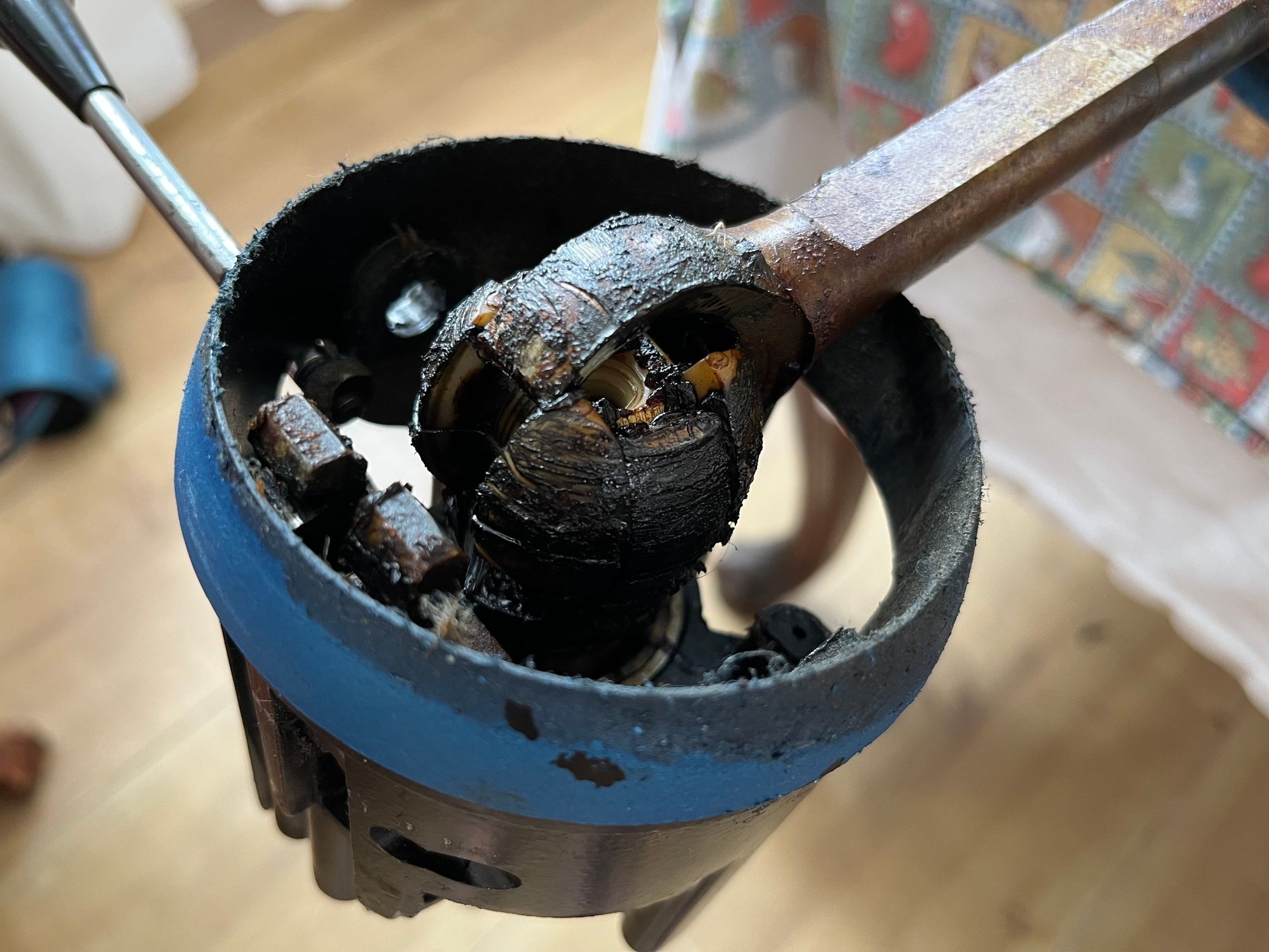

Spring for tilt. Extremely grimy.
Yanking these out took some nerves and persuasion.
We’re going to have to clean this up.
This explains the loose feel to steering. The set screw was sliding off the edge. My bad I tapped the steering shaft in too far when doing the Borgeson conversion. An easy fix.

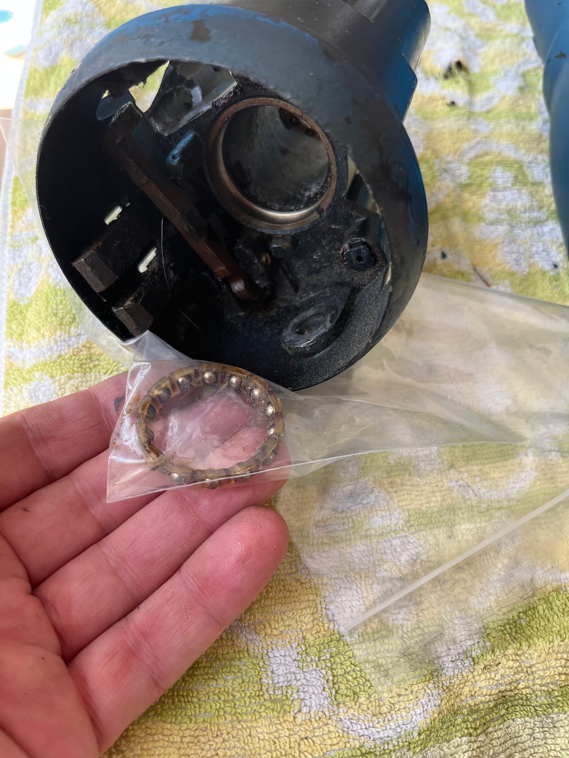

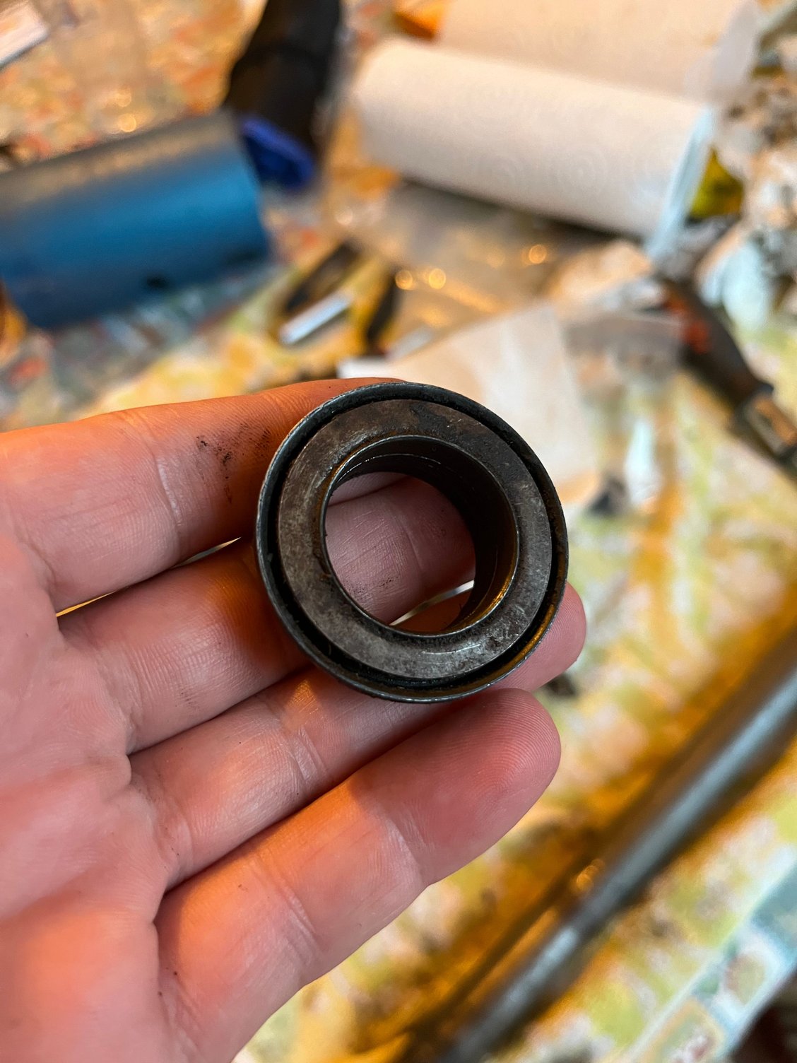

Lower bearing. Somewhat grotty. I will be replacing it.

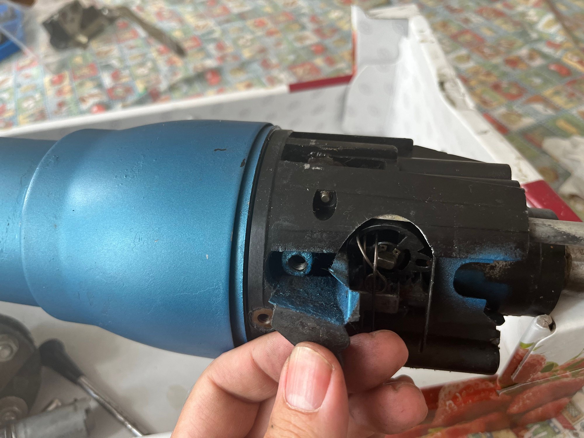

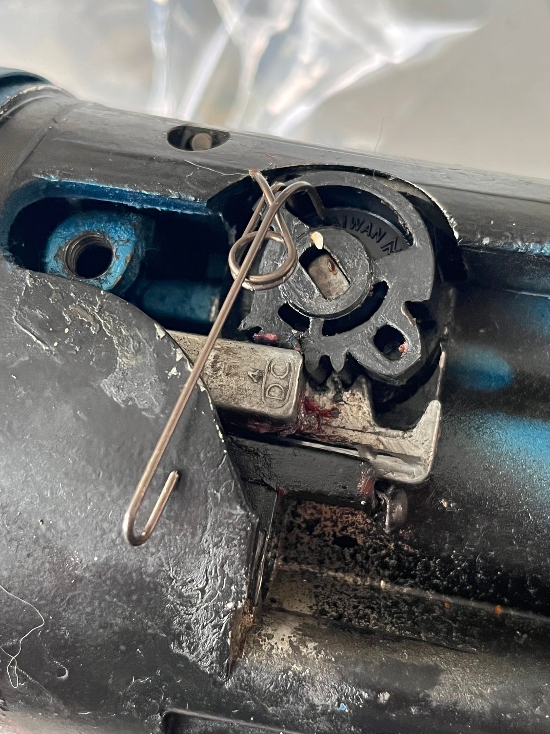

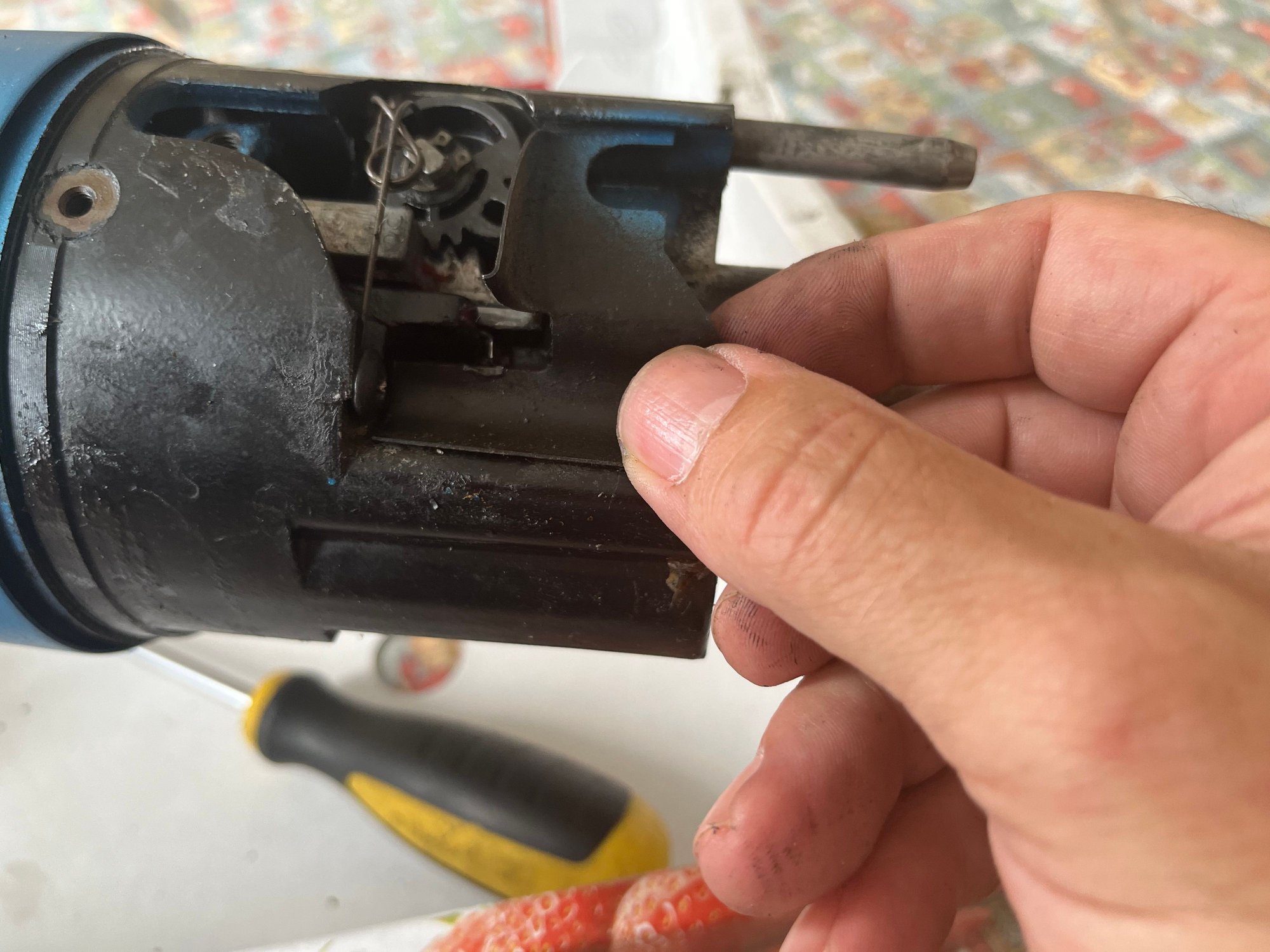

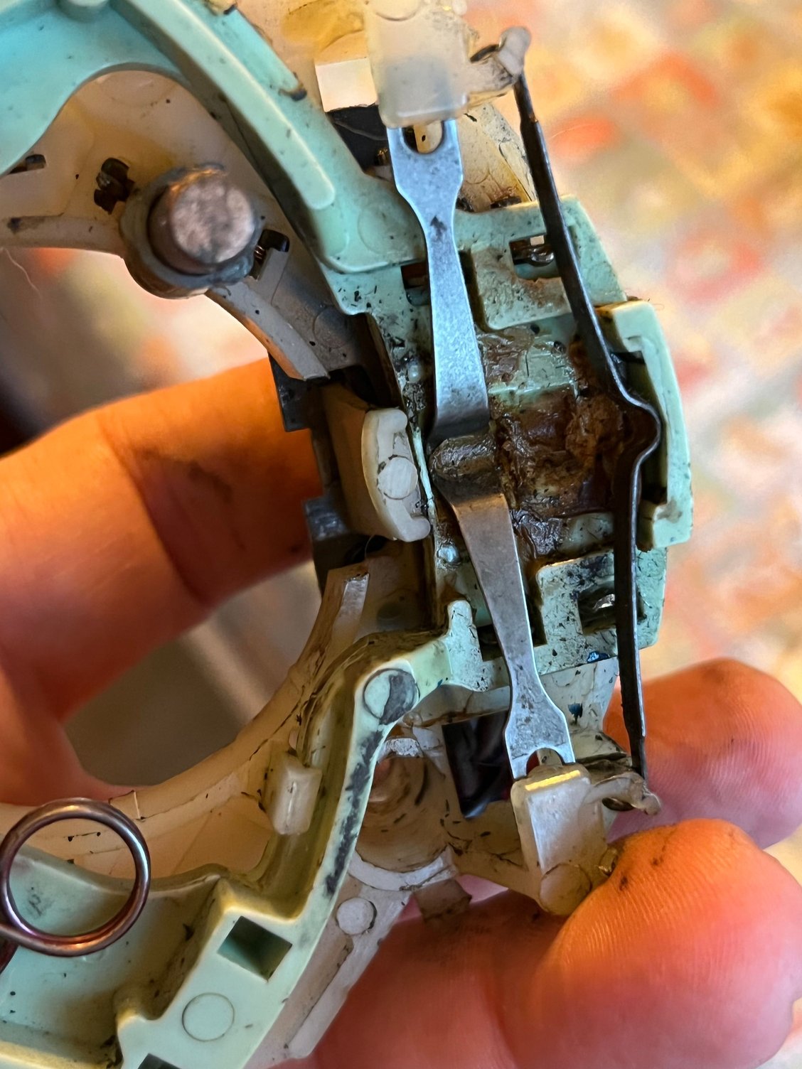

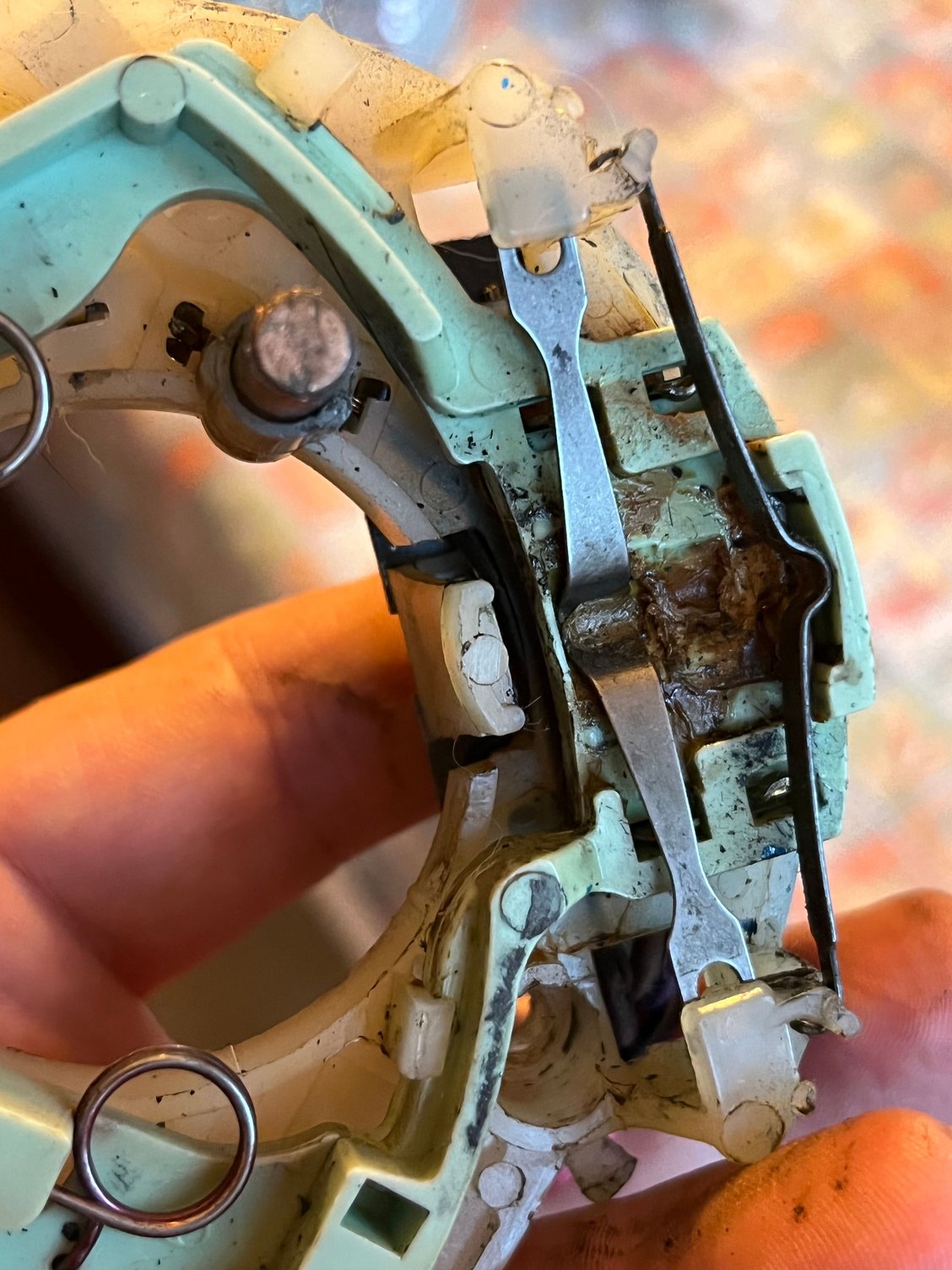

And here is issue with hazard flasher. The plastic tab which it insert into is broken off and preventing from pulling out
And pushing in.

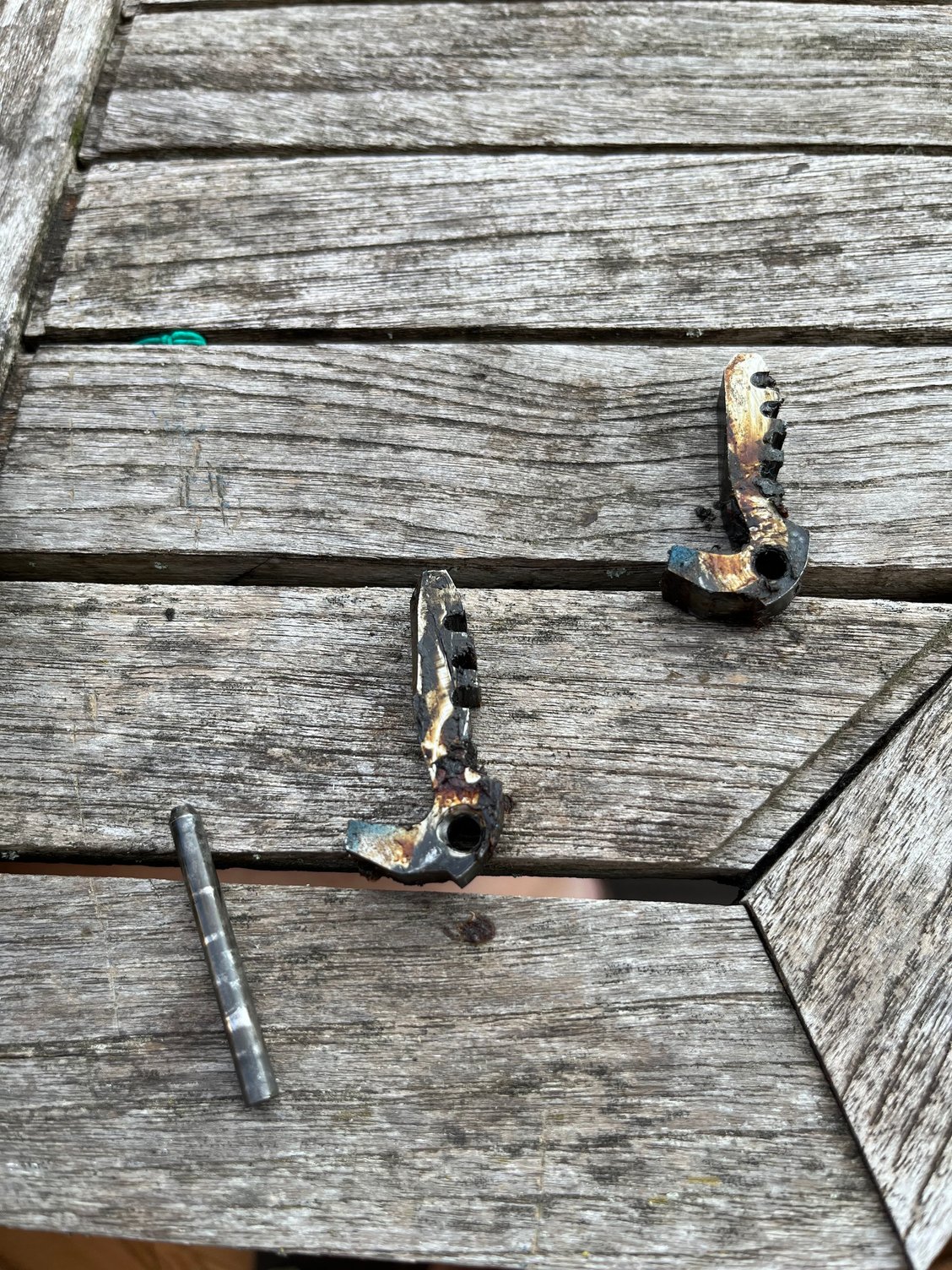

Upper bearings in better shape, but will be replaced too. Everything gets ziplocked.

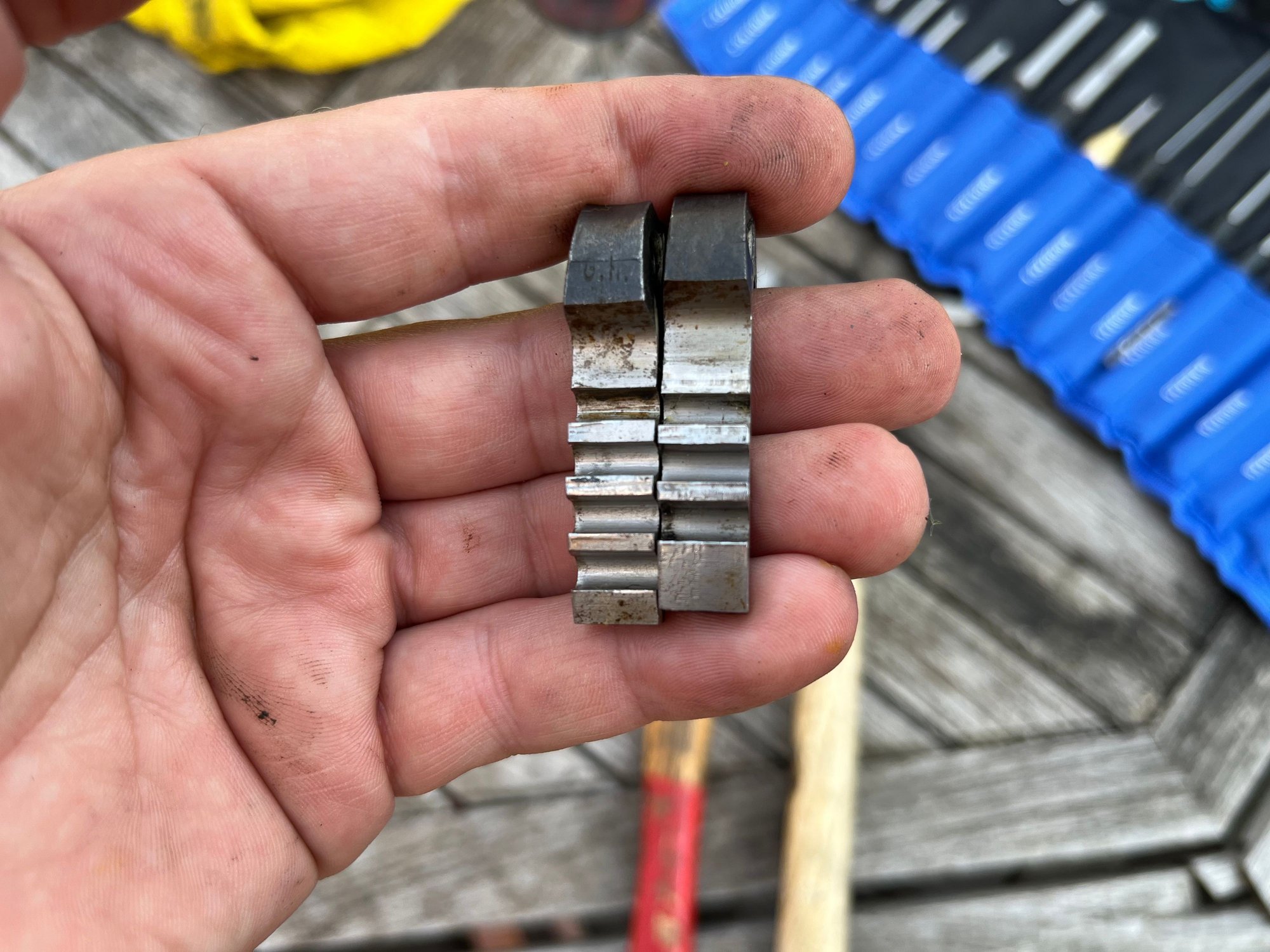

These are the fellows that should (foreshadowing here) be causing the play in the tilt due to wear.

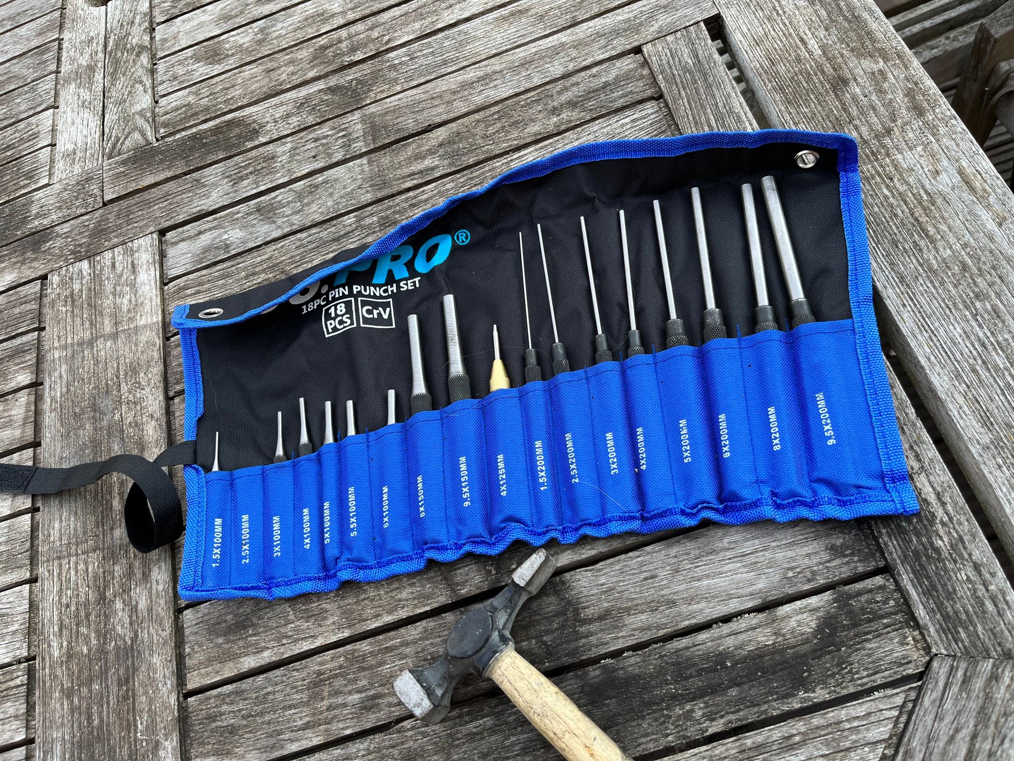

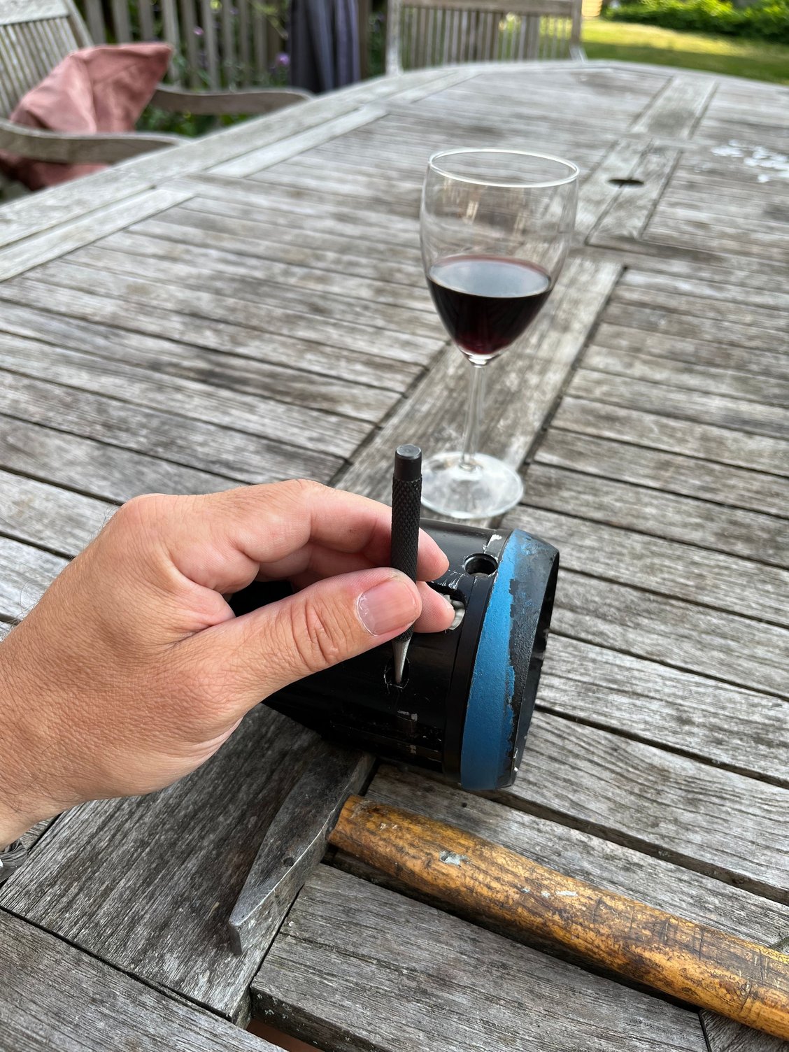

Tap the retaining pin out and out they come. Chianti ? Yes, we are doing things in style.

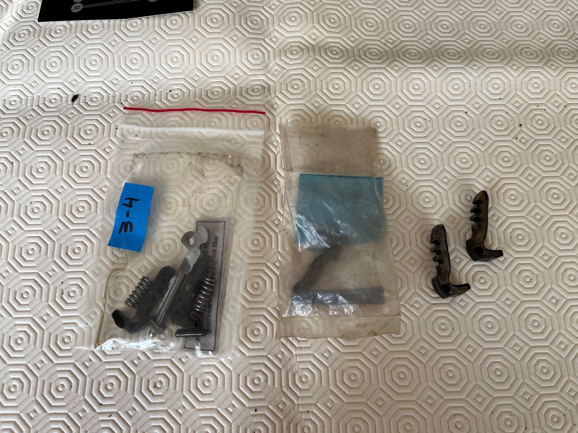

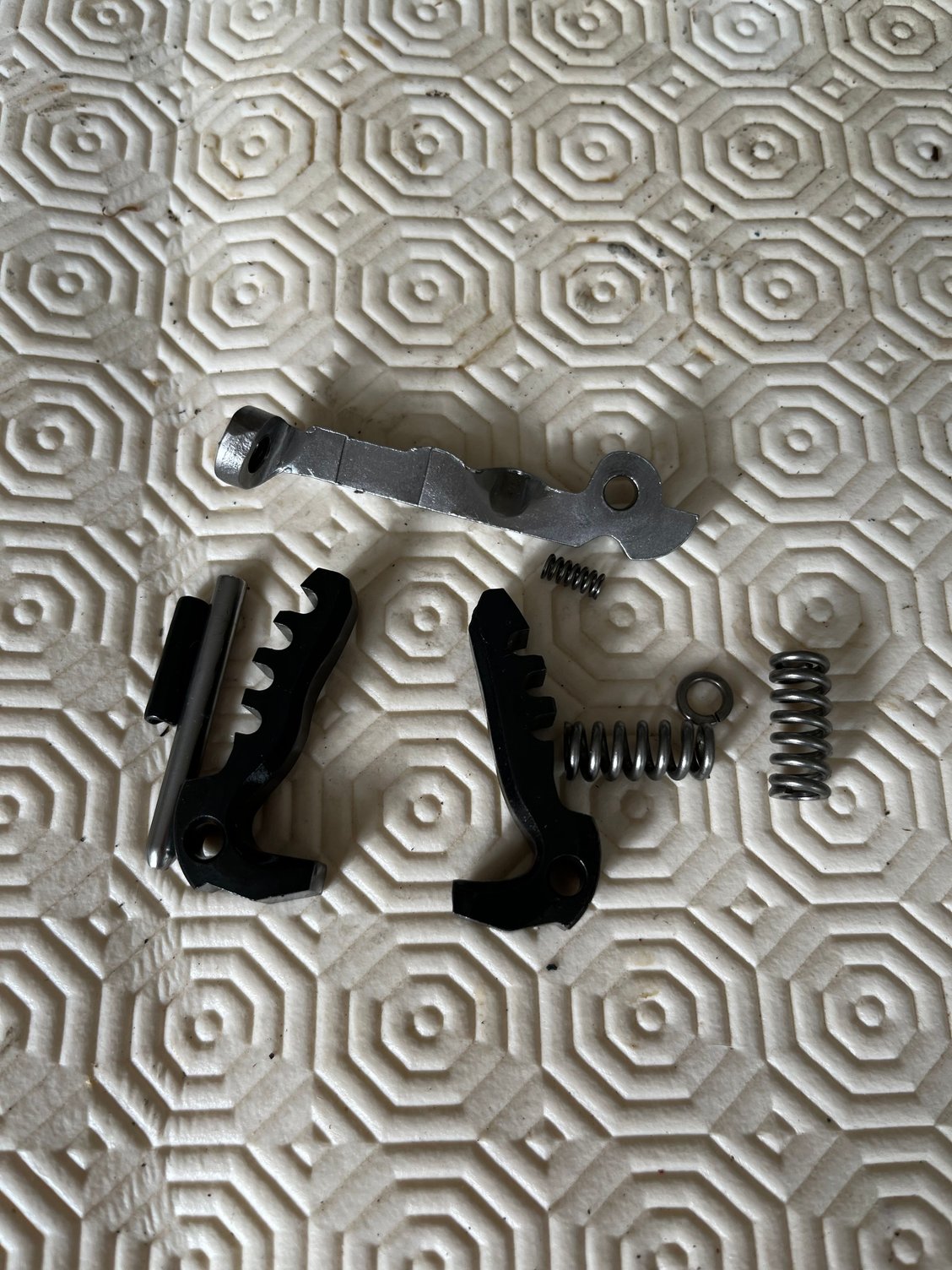

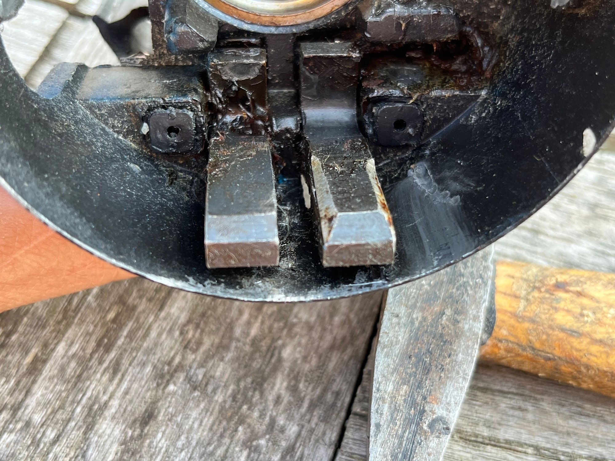

The lock shoes will need to be cleaned and inspected, both the teeth and the shaft. They will be replaced with NOS if I can find them.
The seem to have some wear.

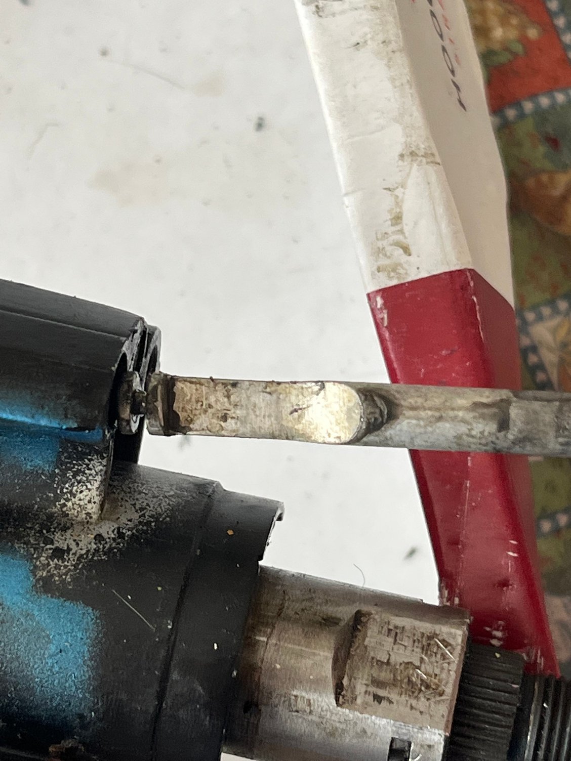

I struggled for several hours and finally ordered this of of Amazon. I should have bought this years ago. It took me minutes thereafter.

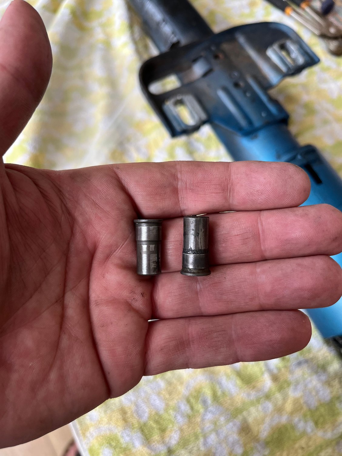

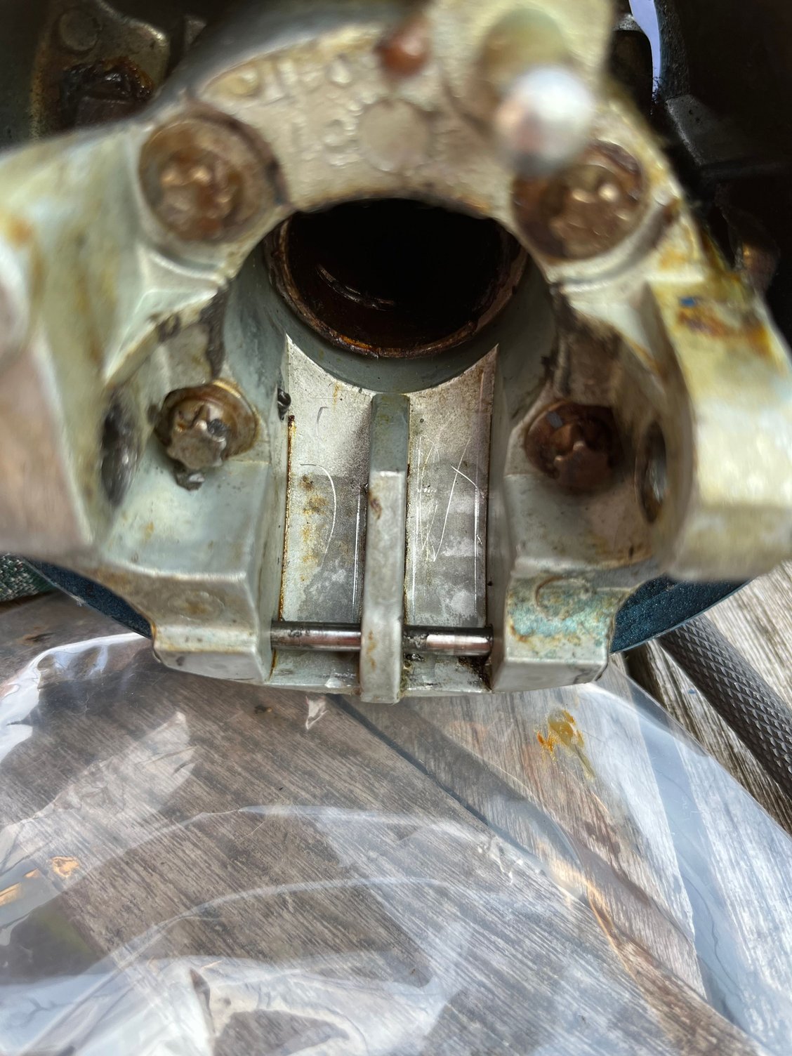

It turns out most of the play is coming from this loose pin in the housing and not so much the lock shoes. The pivot pin seems to have worked its way loose and backed out of the carrier leading to unwanted play. I tapped it home after a first clean. It seems that most of the play is gone. I think I will have to stake down this pin with some dimples in the housing. I’ll think about it.
The steering column as it is now.

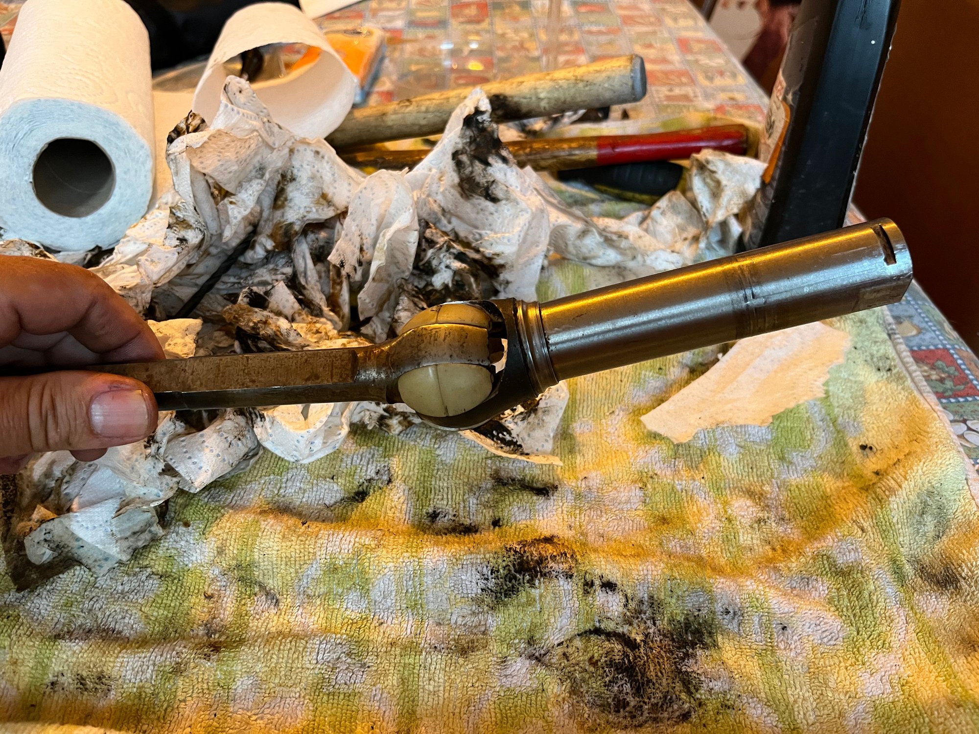

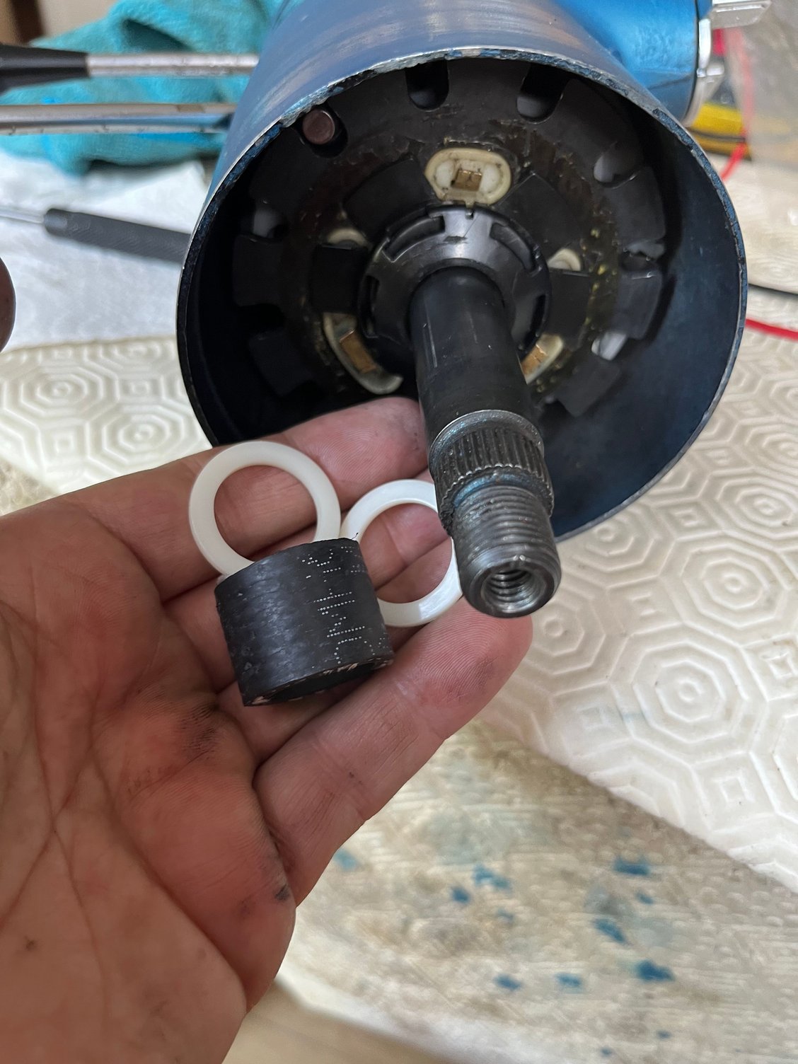

A couple of things with your column , the chisel stake marks on the tele shaft and the steering wheel hub should line up at the top of the column , ie; facing the front of the car . Also those 4 bolts that hold the cast alloy tilt base against the top of the steel tube (2nd last of your pics ) did you use lock-tite when you re-assembled ? they are known to come loose
How tight was the main lock nut on the steering wheel hub , that being loose can cause the horn to stay on !
There are , I think 3 dust shields that originally went in the T&T column , very rare to find all 3 these days ! I found them when I had the luck to dig into an unmolested 72 column that had those 4 screws loose I mentioned above .
Dude ! Thanks. This is a slice of fried gold !
Copy on the chisel marks. I thought they were supposed to go straight down
I think you might be onto something with the loose lock nut. The lock washer is missing and it did seem loose.
i have not pulled the base out yet. I’m trying to find a socket that will fit the star heads. Locktite for sure.
Sadly I did not see a third dust shield.

where's the metal spring that goes within those plastic spheres ? hopefully its in there .

Thanks. Yes the spring is in there. However, I may replace the sphere with a new one I have in order.

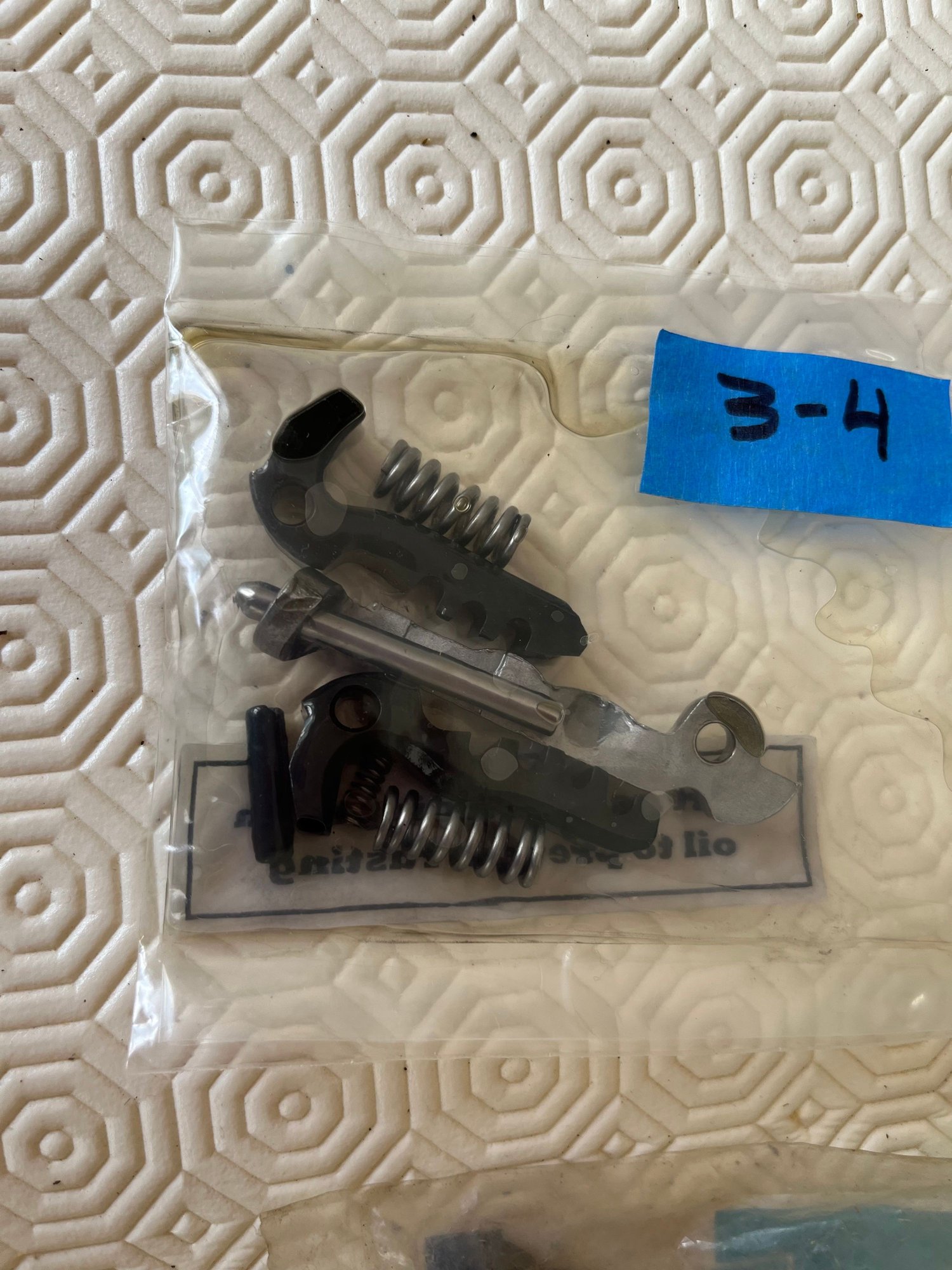

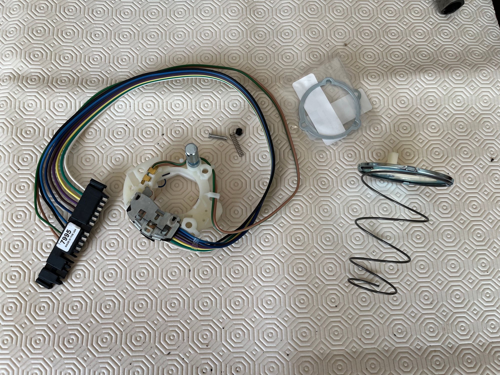

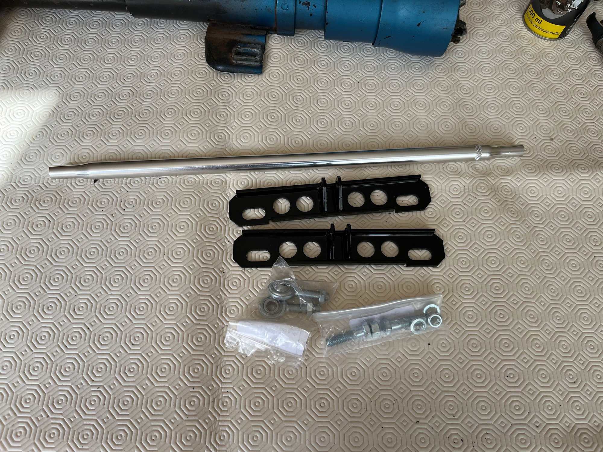

Parts are in

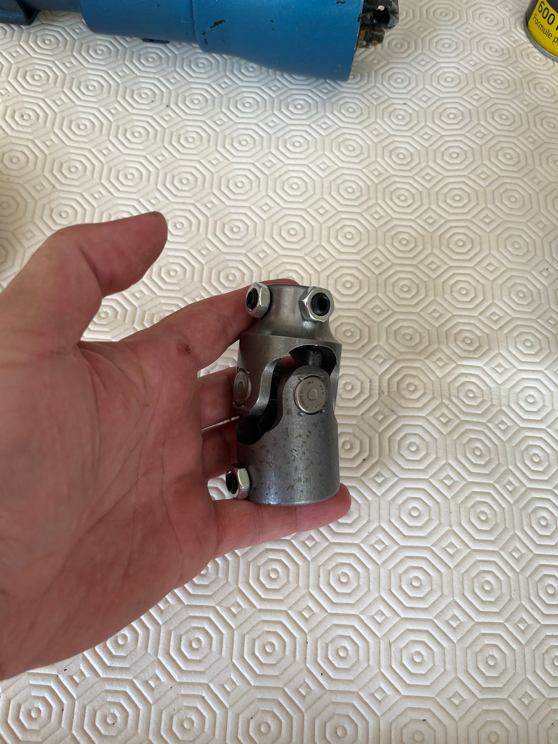

Tunn signal switch. Hazard was broken.
Various bearings.
Particularly happy with this find
Same

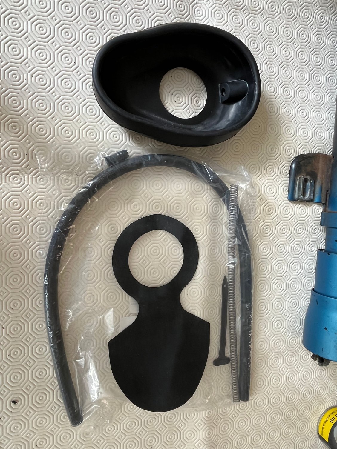

New sphere joint.
Picked this up while I was at it.
And this
This should also help
And because I’m tired of seeing my tank.
Picked the best parts to make for the tightest fit
More details
No idea what this is… it just showed up in the box.

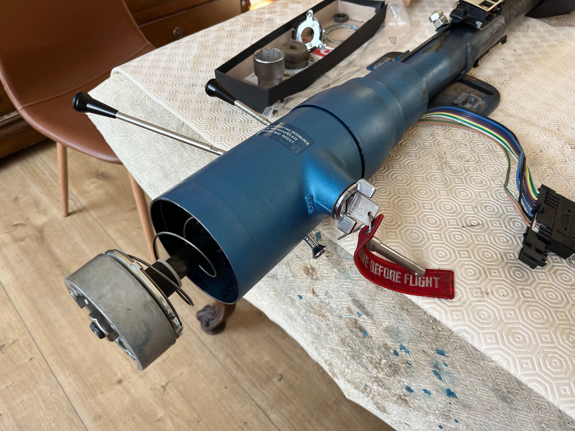

The rebuild went as smoothly as one could wish. There were a few set backs (like forgetting the leaf spring to the key rack ) but overall - smooth sailing. In fact, I dare say, it was easier than I thought.
The steering column, though not yet mounted in the car, feels very solid. I look forward to experiencing in the car.
One small frustration was the key buzzer switch. That broke. Unwisely I did not order a spare. That will have to be for some other time.
One of my favorite additions was the bumper for telescoping feature. I never did like the was it slammed.
